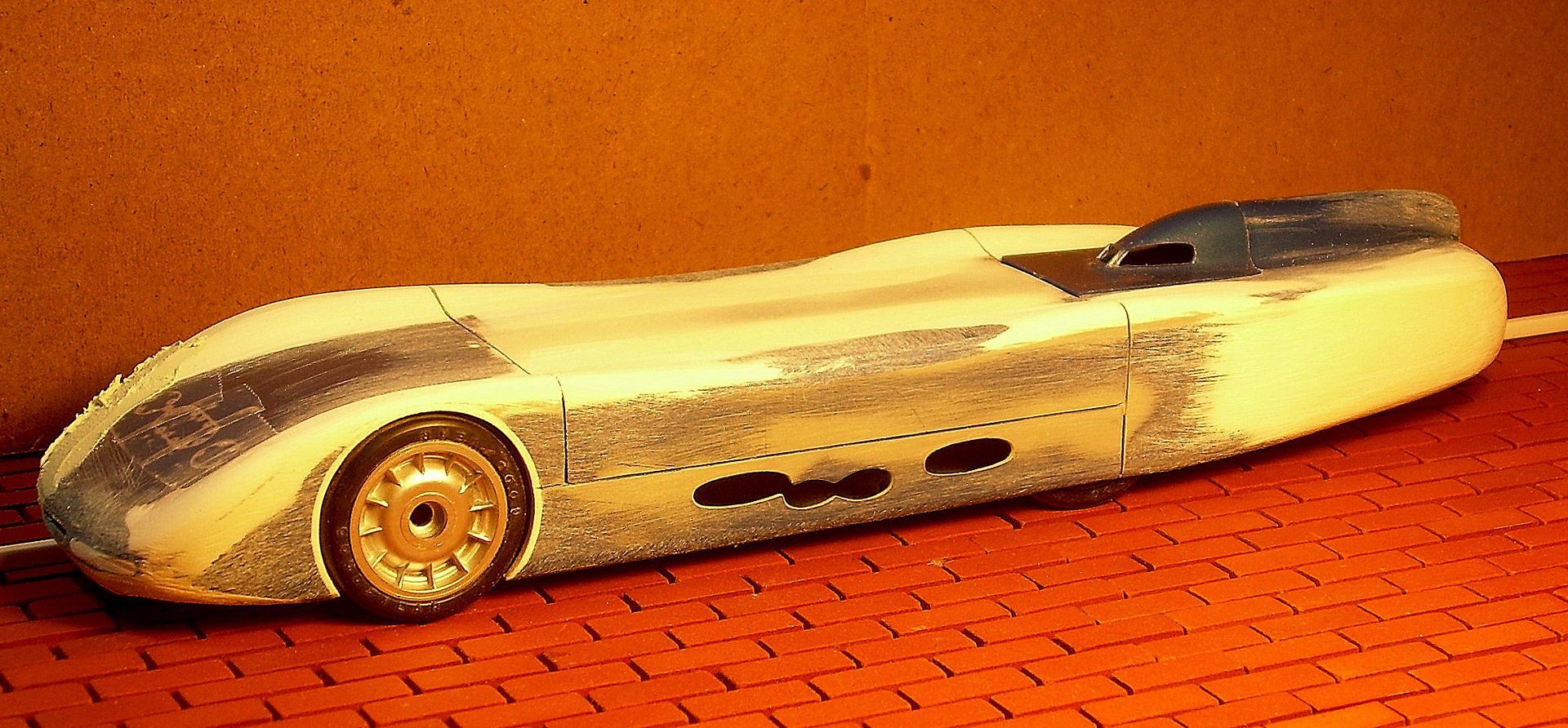

Ace-Garageguy Posted January 3, 2018 Posted January 3, 2018 You MAY find something useful in this build thread. It is the last time I did major mods using micro, and was swearing by the West System epoxy...though it has to cure 12 hours to sand...but it adheres and featheredges beautifully. Be advised: using 5-minute epoxy, or even 30 minute, will DRASTICALLY affect the adhesion, which is directly related to how well it feathers and whether or not featheredges come unstuck when you hit the work with primer.
