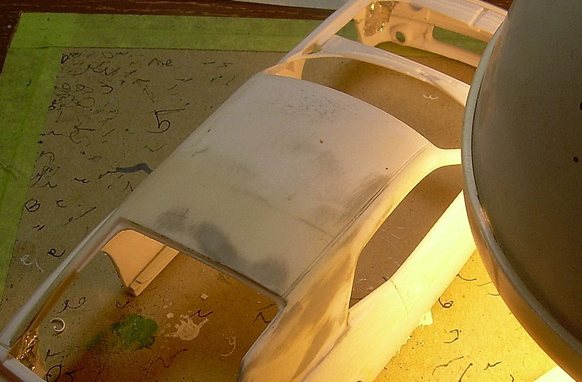

Ace-Garageguy Posted March 7, 2017 Posted March 7, 2017 (edited) Microballoons are NOT water-soluble whatsoever. There are two types of them: If they are "white", they are micro-sized GLASS balloons, if a yellowish color, the same thing but made from Phenolic resin. They came into hobby use in the very late 1970's when R/C aircraft builders discovered their extremely light weight, and their ability to add bulk (and sandability) to common ordinary epoxy glue. Mix a sufficient amount of microballoons with epoxy (and with all due respect to Bill Engwer), 5-minute epoxy works quite well in this application) to a paste-like consistency, the resulting "putty" can be spread easily with any tool used as a spatula--used to do that very thing back years ago. As I wrote above, it's also quite possible to lay up complete body shells with this material, mixed in epoxy as I mentioned, AND the added bulk of the microballoons to even the cheapest of 5-minute epoxy pretty much negates any shrinkage of that epoxy, at least when taken down to the sizes and scales that most modelers work in. Art I agree with most everything Art has to say here...except...in my own experience, I've had adhesion issues with 5-minute I haven't had with the longer-cure stuff I generally use. What this has translated to for me has been a failure to featheredge as nicely, and an occasional tendency to pull up at the edge when subsequently hit with hot-solvent primers. This would be in keeping with the general rule-of-thumb regarding epoxies...the longer they take to set and cure fully, the harder, tougher and more chemical resistant they are, and the better they adhere to a substrate. PS. This is the phenolic product, reddish-brown. There is another lightweight inert filler / thickening agent you all may be interested in called "fumed silica". http://www.christinedemerchant.com/filler-silica.html Edited March 7, 2017 by Ace-Garageguy
