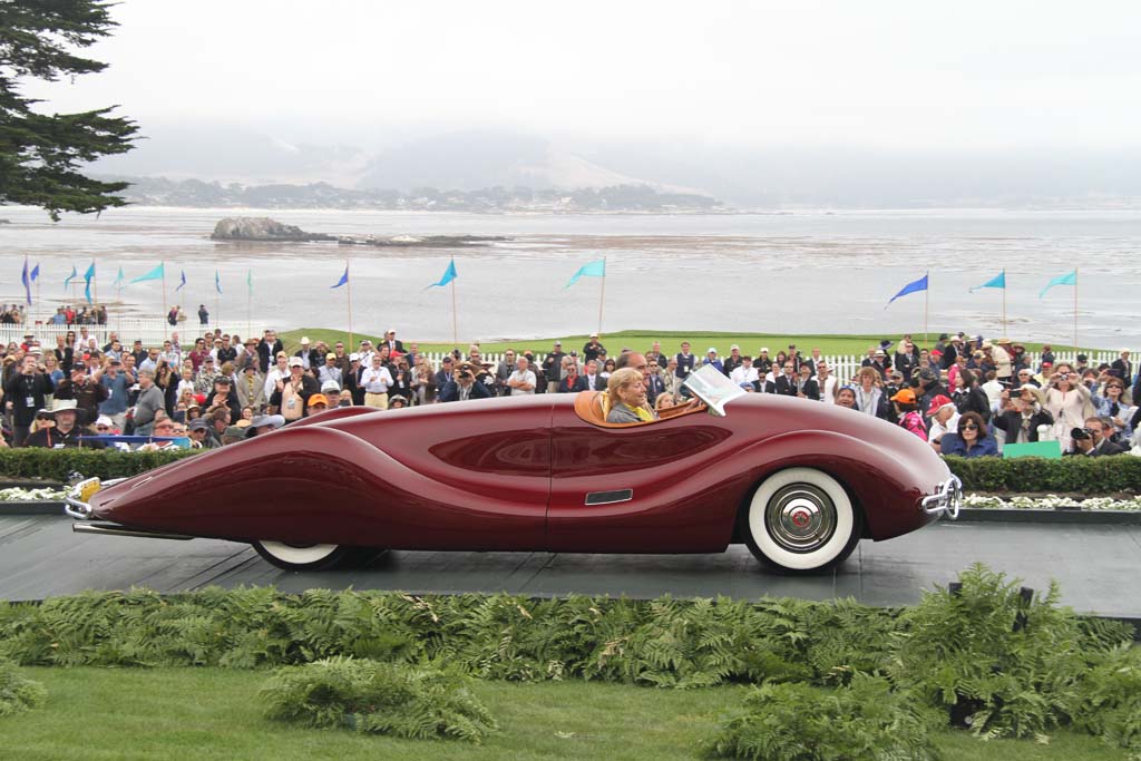

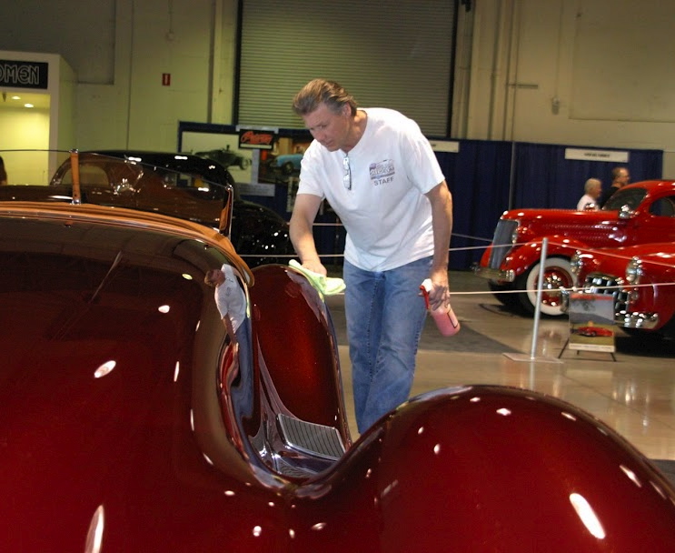

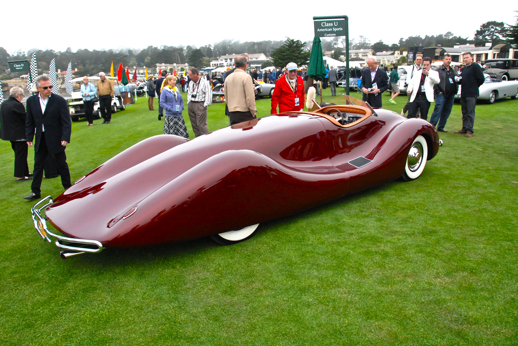

I worked on this car many time preparing it for the shows. It actually has real gold ground up and mixed
in the paint - about 3oz's to be exact. It's a wonderful story and resurrection. Gary just called me a couple
weeks ago to come over and prep it for a museum exhibit.
I've been very fortunate to work on many great cars in my career and I'm excited to see some builds on this
forum that builders are doing of some of these cars.
Here's a couple other shots - me prepping it at a show for example, pic at Pebble Beach and misc ….. Enjoy
