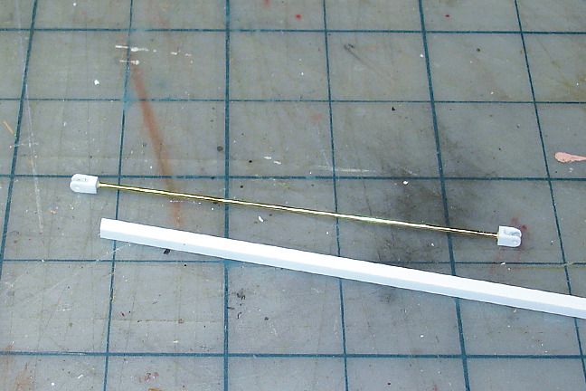

Harry P. Posted June 28, 2015 Author Posted June 28, 2015 There are a lot of levers and rods and linkages that have to be scratchbuilt... all the stuff Pocher conveniently left out of the kit. Here is how I make scale clevises for the various control rods... I start with some square styrene rod, and using a razor saw with a thick blade, I cut a slot into the end of the square rod about 3/16" or so deep. Then I drill the holes crosswise to the slot for the "bolt" that will ultimately pass through them, then I use a sanding stick to round the ends of the clevis, then cut to length, and finally drill out the hole on the cut face to accept the brass rod. It sounds harder than it is. Making one clevis takes about 5 minutes or less.

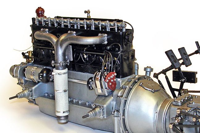

Harry P. Posted June 28, 2015 Author Posted June 28, 2015 Here's something you haven't seen before... the left side of the engine. Some of the details are hard to see, like the horizontal magneto control rod (seen unpainted in the previous photo), now installed. The rear end of it is attached to a bell crank that a short vertical rod and return spring are also attached to... and those attach to the magneto. The front of the rod attaches to a crosswise control rod at the front of the engine. Ultimately there will be another set of rods and linkages that connect to this front crosswise rod on the right side of the engine, that will lead to the control lever on the steering wheel hub. That's a lot of rods and levers... and that's just one of the many mechanical control linkages on this engine (no way will I be adding them all!). Also you can see the scratchbuilt vacuum pump I showed you earlier in unpainted form, now installed at the left front corner of the engine, on top of the timing case. This pump also had a guide that accepts that crosswise control rod. I paint and foil detailed the generator and magneto. The "asbestos" insulation on the down pipe of the exhaust manifold was cut from the body of a pen, then wrapped with masking tape for texture... painted a "dirty white," then I rubbed a pencil on some sandpaper to create graphite dust. I put some of the graphite on my fingers and then rubbed the "asbestos" with the graphite to emphasize the masking tape texture. The clamps are just strips of aluminum duct tape. I also added a heat shield made of styrene sheet to the back side of the exhaust manifold... this shield was actually a thin sandwich of asbestos and sheet metal, and was meant to protect the ignition wires, which run through that wiring loom directly behind the exhaust manifold. I hit the exhaust manifold with several coats of Dullcote, but it still looks too shiny. Gonna hafta fix that...

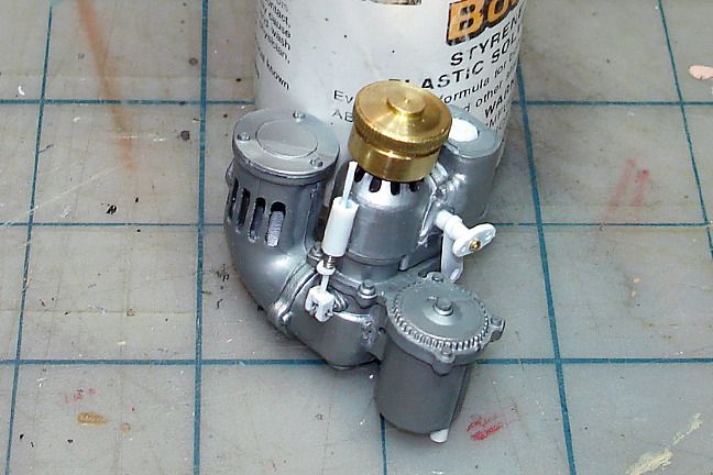

Harry P. Posted June 28, 2015 Author Posted June 28, 2015 Back to the right side of the engine... the carburetor. First of all, the Pocher kit carb/air cleaner is incorrect for this particular model (1934 Phantom II). The carb in the kit actually depicts the model year 1932 and earlier version. RR went to a new carb/air cleaner design in January 1932. Pocher obviously cut corners here, using the carb from their 1932 Sedanca kit instead of tooling up a correct post-1932 version. But the visual differences are pretty minor, and only a mid-1930s RR expert (or a nut!) would ever spot the differences... so I'm going to use the carb as is, incorrect or not. As with the rest of the engine, pretty much all the linkages are AWOL in the kit. Here I've started to add some of the missing details... and I'm just getting started! There are still a lot more details yet to be added! Pocher did some weird things in their kits. As you can see, the top of the carb is actually a machined brass piece instead of molded plastic, like the rest of the assembly. Why? Who knows! There are other seemingly random parts that are machined brass instead of plastic. No reason I can think of for it. Just "because," I guess...

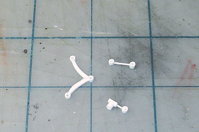

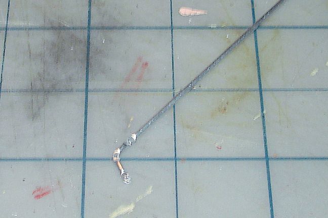

Harry P. Posted July 1, 2015 Author Posted July 1, 2015 Still adding linkages to the engine. There are so many of them, it's insane. A few scratchbuilt of styrene... Another way to do it... aluminum tubing. I flatten the areas where the linkage will attach with needle-nose pliers, then drill the hole in the linkage, then cut it off the rest of the tubing, and file the ends round. Paint and attach. I use both ways (styrene and aluminum), depending on the specific application...

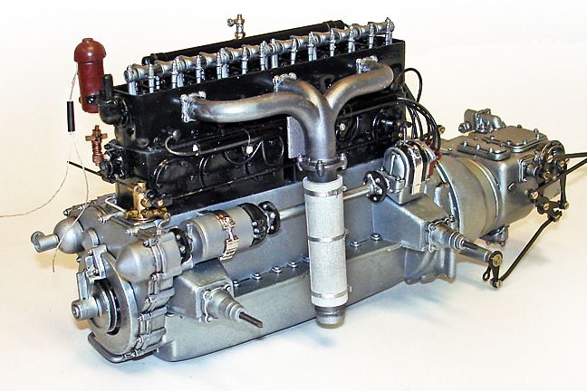

Harry P. Posted July 1, 2015 Author Posted July 1, 2015 I'm still building linkages! Holy krapp! There are so many mechanical linkages on this engine, it's taken me several days just to add them all. I hope to have finished engine pix up tonite or tomorrow.
