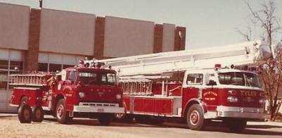

gator52 Posted July 8, 2015 Author Posted July 8, 2015 Thanks for the info, I appreciate it. I plan to use the chassis & cab as the basis for a fire-rescue truck like the one pictured below. My best guess is it's a Darley; so far I haven't found any info on fire manufacturers other than Darley that used Ford cabs.
Jim B Posted July 8, 2015 Posted July 8, 2015 Should be an interesting project. That's a nice looking AeroChief sitting next to it.
gator52 Posted July 8, 2015 Author Posted July 8, 2015 (edited) Yes, the Snorkel is on my list too. I've got some better photos of it, and I've got the AMT Aero Chief kit to use as a basis. The biggest change will be the addition of a second rear axle. Jonah Edited July 8, 2015 by gator52

explorer2770 Posted July 8, 2015 Posted July 8, 2015 Lots of fire apparatus manufacturers used the Ford C cab chassis, the only way to tell which one made your truck would be to find the manufacturer plate in the photos. It could be an American LaFrance, Pierce, Sutphen, E-One, Grumman, Oren, Hahn, or any number of local/smaller fire truck builders. Do you know if the Ford C was sold to Dixie FD? Then it could be a Fire Boss. http://yngfire.com/index.php/topic,9557.msg59410.html#msg59410 The Century Series AeroChief (snorkel) is most likely a 1977 with serial number CE 145165. http://yngfire.com/index.php/topic,9890.msg61689.html#msg61689 Many have made the conversion to the twin drive for the AeroChief and Ladder Chief over at the ScaleFirehouse.com Check them out. Other Tyler TX fire trucks that might interest you: http://yngfire.com/index.php/topic,1307.msg46011.html#msg46011 http://yngfire.com/index.php/topic,1303.msg41419.html#msg41419 http://yngfire.com/index.php/topic,2013.msg75008.html#msg75008 http://yngfire.com/index.php/topic,7250.msg35642.html#msg35642 http://yngfire.com/index.php/topic,9935.msg61907.html#msg61907

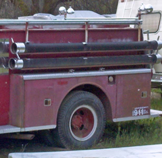

Aaronw Posted July 31, 2015 Posted July 31, 2015 Fuel tanks on fire trucks (custom and Ford C series) are usually mounted between the frame rails behind the rear axle(s). I agree with Brandon, if you look closely you will find most Ford C fire engines have a fuel fill (or small door covering the fuel fill) right behind the rear wheel. This is a 1963 or 64 Ford C950 / Seagrave pumper You can see the fuel cap behind the rear wheel
leafsprings Posted January 17, 2016 Posted January 17, 2016 This is a 1963 or 64 Ford C950 / Seagrave pumper This one can be pin pointed to '61 or '62, the spear emblem is the give away. This truck has the "extra long" spear emblem, so this one has the Super Duty engine. Also, note the big Eaton 22 or 23K rear axle, something the Amt kit unfortunately never came with. The rear axle on the Amt tilt was incorrect, it was super small, almost looks like a trailer axle cap.
Aaronw Posted January 18, 2016 Posted January 18, 2016 You are of course right on the year, that is what I get for not checking my notes.On the rear axle, any suggestions for the right one? Does the Louisville have a better axle to use or does it suffer from the same issue?
