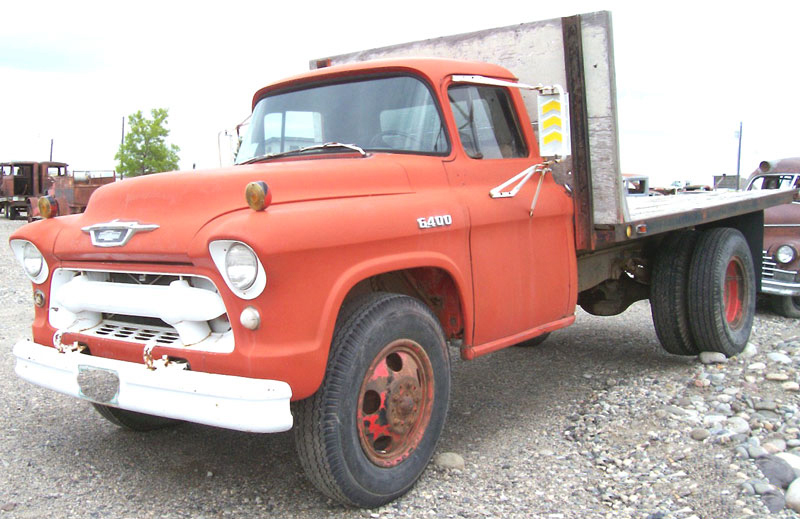

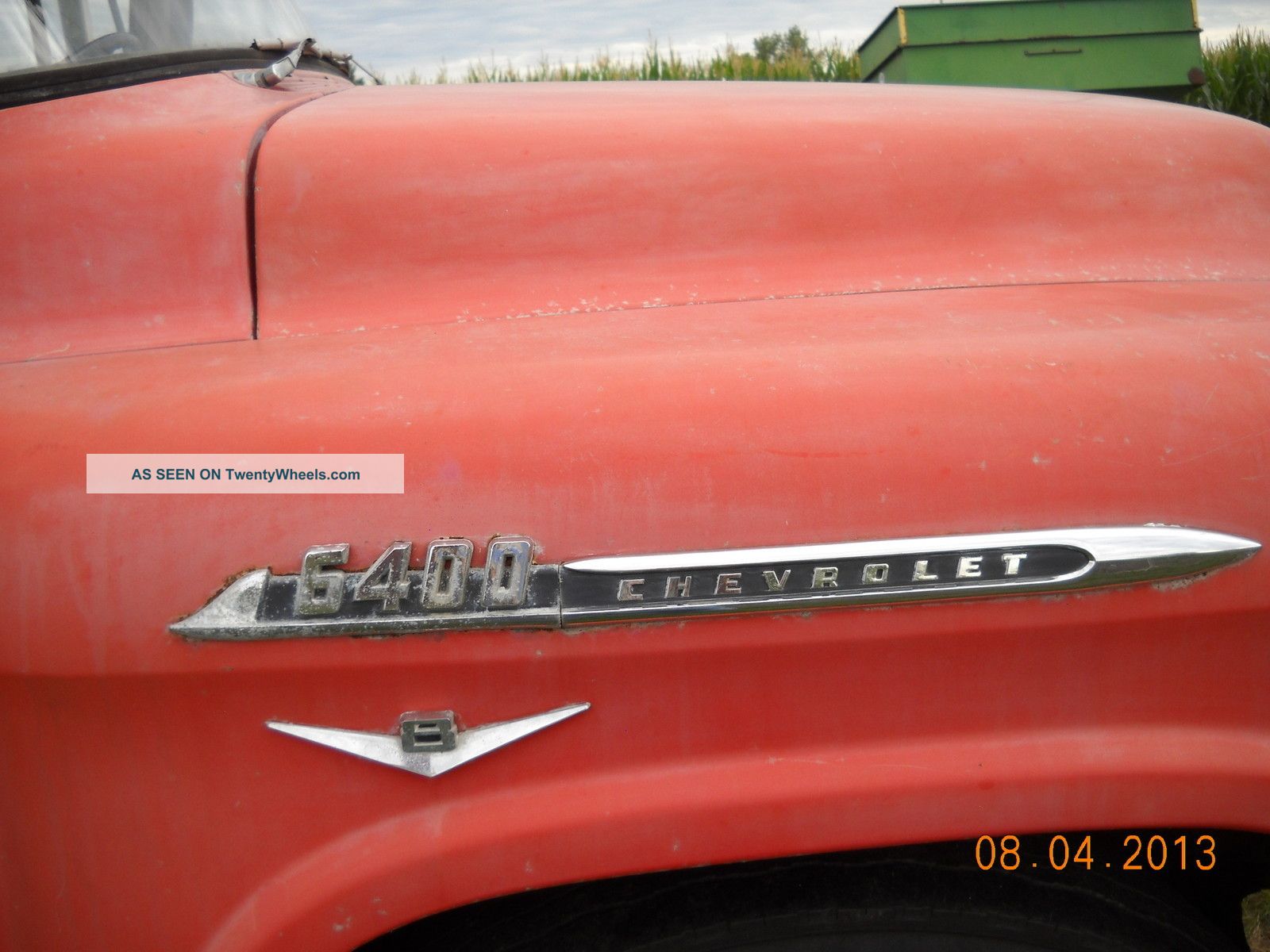

Longbox55 Posted August 4, 2015 Author Posted August 4, 2015 (edited) Now for the '56. The '56 really didn't see much in the line of changes beyond a few mechanical improvement, new paint colors, and a few trim changes. The big mechanical changes include a new head for the 235 6 cylinder (the famed "848" head), plus the V8 gained a full flow oil filter (the '55 did not have an oil filter standard, the only year that lacks that feature). Other new mechanical changes include the new Powermatic transmission in HD models, plus a new 2 1/2 ton model in both single and tandem axle, as well as Conventional (8000 and 10000) and LCF (7000 and 9000) cab configurations. There was also a new engine for the 2 1/2 ton models, the Loadmaster V8, which is a 322 cid engine sourced from Buick. Also, as with 1955, all LCF trucks, the 5000 plus the new for '56 2 1/2 ton models (7000, 8000, 9000, and 10000) were the only models with a V8 as standard equipment. Cosmetically, the '56 has a few easily overlooked changes, as much of the look stayed the same. The grille has no change at all, but the hood ornament is inverted in shape. The indent, which is the same color scheme, curves around the bottom of the emblem. It also has ribbed pattern instead of checkerboard. V8 models also incorporate a "V" just under the Bowtie. The other major trim change is the fender badge, which is still the same basic shape, but is now mounted above the fender crease. The emblem is not the same as the '55, and they do not interchange, as they are shaped different on the back side. The '56 emblem is also 2 piece, with the split being just before the model designation number. They did that so that the forward part can be used on all models, and only the rear piece needs to be specific. The area around the Chevrolet lettering is also now black, instead of white on the '55. Inside, there were some new interior options, a Charcoal/Black, 2 tone green, and 2 tone blue. Some trucks also have a '56 specific horn button, the jury is still out as to which is actually "correct" as both the '55 button (which dates back to the '54) and the "56" button have been found on known unrestored trucks, as well as spotted in factory literature. One theory is that it might be tied in with the dual horn option. '56 3200 with the chrome package, chrome bumpers, and door handle scratch shields. Note the differences in the emblems. Cameo, fully loaded truck. Note the "V" on the hood emblem. 6400 this truck also has an aftermarket 4x4 system, most likely a NAPCO or Coleman. Close up of the '56 badge, showing the split. New for '56 Tandem. This is the lubrication chart from the '56 manual supplement for the Tandem Axle truck. They used an "over the shoulder" drive system, each axle has its own driveshaft. The rear axle is normally not driven, and is only engaged when the power divider, a combination transfer case and 3 speed transmission, is put into the "puller" gear, or if the decluthing lever is engaged in any gear. There is no center differential between the axles. Next up, '57. Edited December 27, 2015 by Longbox55 corrected information

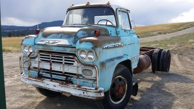

Longbox55 Posted August 4, 2015 Author Posted August 4, 2015 1958 saw some major changes in the Task Force line. All new front end sheetmetal, 3 new models in the LD line, new engines for both the LD and HD lines, plus new model names for the trucks, one of which was synonymous with "Chevy Truck" for many years, and even is used by some as the model name for all years of Task Force. Sheetmetal changes were drastic for '58, quad headlamps, new grill, new hood and fenders. The fenders, while similar in shape, are actually wider than the earlier single headlamp trucks to accommodate the dual lamps. They also had some extra sculpting at the front of the fender opening leading into the new much wider grille. The fenders are also 2" longer that the earlier truck, requiring the frame to be 2" longer as well. The new grill is a wide, inverted T shape, with integral parking/signal lamps, and the Chevrolet name spelled out in block letter between the lamps. The hood is narrower, and now has a deeply sculpted recess in the center. The hinges are now attached to the inner fender instead of the cab. The hood badge, at first glance, looks similar to the '56/'57, but the center recess now goes over the top of the badge instead of below. Fender badges are all new as well, with a "jet" theme. The badges also only call out the first 2 numbers of the model, ex. 31 for a 1/2 ton. The Cameo is still available at the beginning to the year, but is phased out by midyear and replaced with the new for '58 Fleetside. '58 is the lowest production year for the Cameo, and among collectors, the least desirable. The new Fleetside is available in both the short and long 1/2 tons, as well as 3/4 ton, and in a 4x4 version for the short 1/2 and 3/4 tons (4x4 was not offered on the long 1/2 ton). New model names are also introduced, Apache for 1/2 through 1 ton, Viking for 1 1/2 ton and 2 ton, and Spartan for the 2 1/2 ton. The Apache name, which Chevrolet used on light trucks through '62, is associated enough with the Task Force body that even if folks ar looking at a '55, they will invariably ask if it's an "A[ache". I've actually had that happen to me at shows. Mechanically, the 283 is now available in all models, and the new for '58 348 is available on HD models. The Loadmaster 322 is also still available, though mostly relegated to bare chassis and School Bus models, as the 348 replaces it in most other applications. A reasonably well optioned 3100 The new for '58 Fleetside, model 3134 1/2 ton. This particular truck also has the extremely rare for '58 bedside trim. Very few '58s got this, most believe it to be a '59 only option, though some possibly late production '58s got it. Last of the Cameo Carrier trucks 4400 1 1/2 ton LCF Spartan w/tandem equipment. Next up, 1959

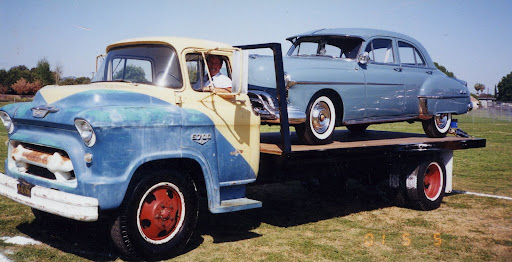

Superpeterbilt Posted September 6, 2015 Posted September 6, 2015 I'm glad you posted this. I've been collecting materials for a 58 tandem build. Do you have any more info/photos of that "over the shoulder" tandem set up? Thanks
Longbox55 Posted September 6, 2015 Author Posted September 6, 2015 http://chevy.oldcarmanualproject.com/shop/1956sctsm/56sctsm0438.html http://chevy.oldcarmanualproject.com/shop/1956sctsm/56sctsm0792.htmlhttps://www.gmheritagecenter.com/docs/gm-heritage-archive/vehicle-information-kits/Chevrolet-Trucks/1956-Chevrolet-Truck.pdfCheck page 147 on that last link.
