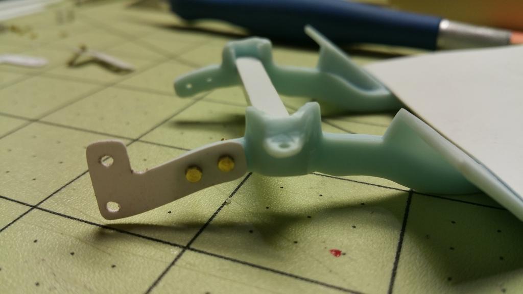

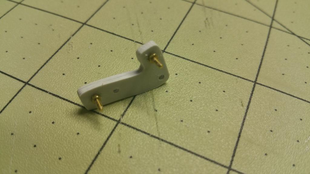

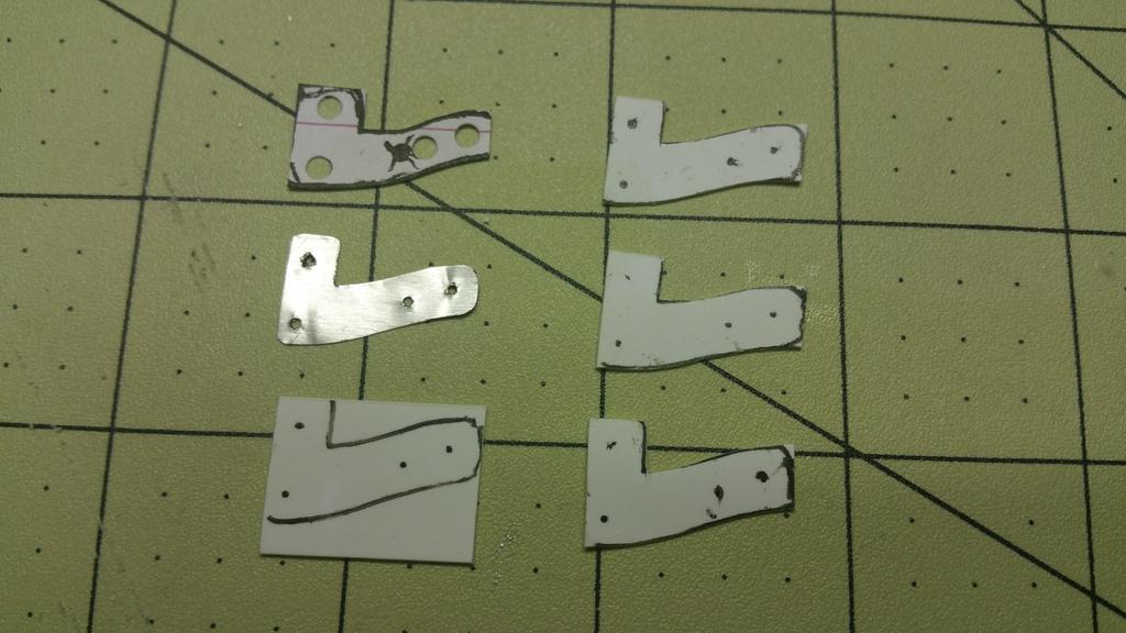

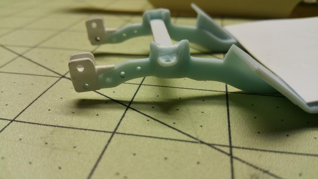

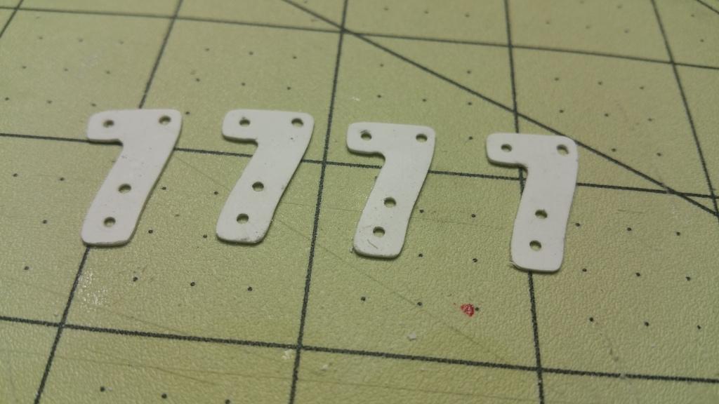

Aside from another rampaging bout of depression, here's what's been slowing me up. I wasn't happy with the body hinge point when I tried to add mounting holes for the front leaf springs. Suddenly the strength of the bracket came into question.
I decided to go with individual frame mounted brackets. My first attempt was metal, but it was too thin and my supply of sheet metal is in drastic need of variety. I put one to good use as a template. Once I got the basic shape down, I bolted all four pieces together so that all of the parts would be the same during final sanding and drilling.
If this works, I'll have the front springs done later today. Just feeling a little guilty about the absence. Sorry.
20151011_102553.thumb.jpg.7901a7d783e6d120151011_105736.thumb.jpg.07605eb9e6273c20151011_110156.thumb.jpg.919ed51af5a44920151012_122542.thumb.jpg.572a3f140f783c20151012_123921.thumb.jpg.9f4b652e5a5730
Bring it on Brad. What I have now is roof flashing. It's either .03 or .05. I'm thinking .03. Easily bent while being worked.

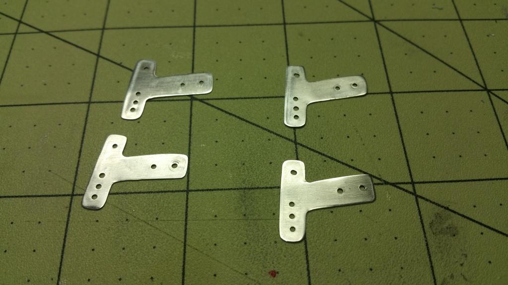

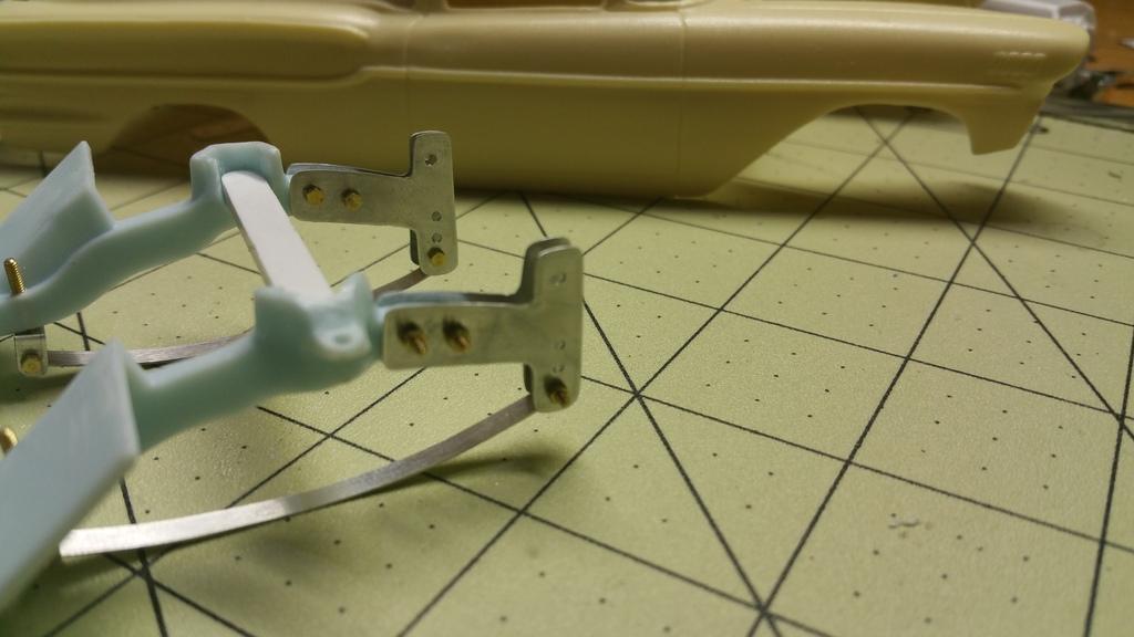

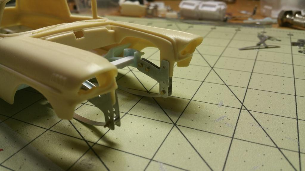

Thanks everybody. Well, I did a stupid, then fixed it.
My main problem was, I thought I was making brackets out of my thickest metal, but it was the thinnest. I forgot I had bought a cookie sheet and cut it up to add to my "metal file." Waaaay too thin for a bracket that size.
Now I've made new ones from the roof flashing and they make me very happy. Tomorrow I'll drill out the leaf springs and get them assembled. After that, front and rear axles.

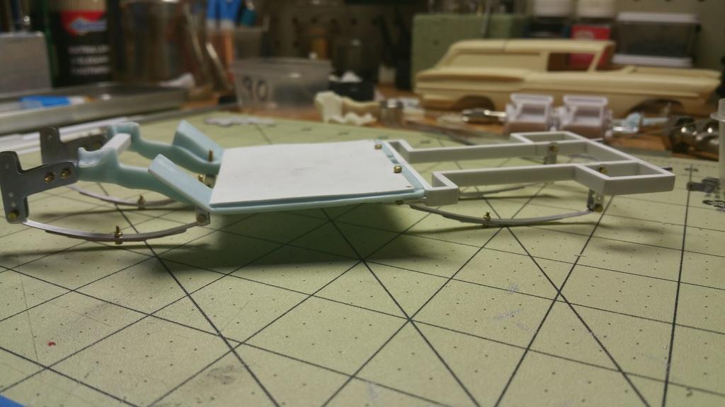

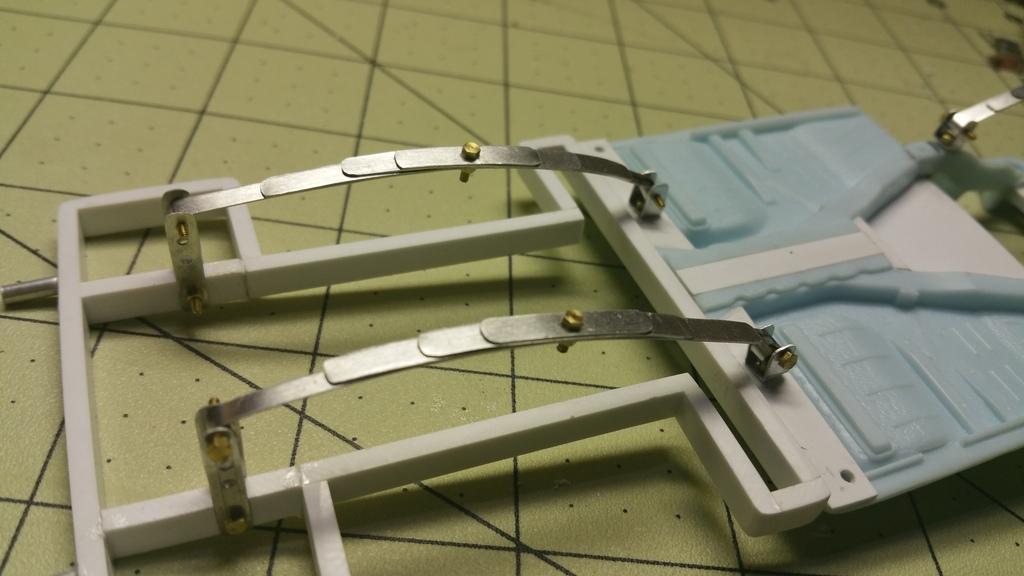

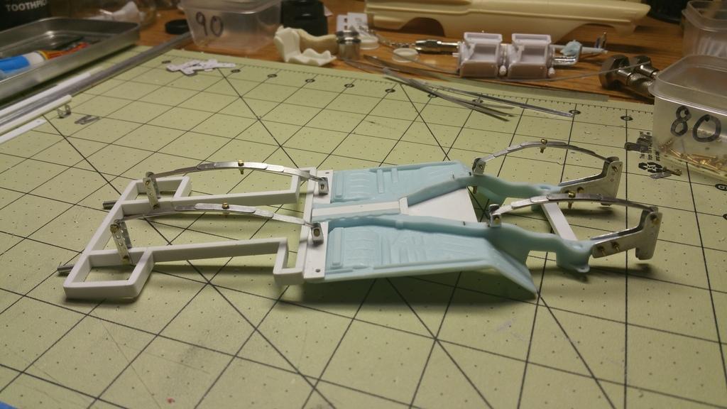

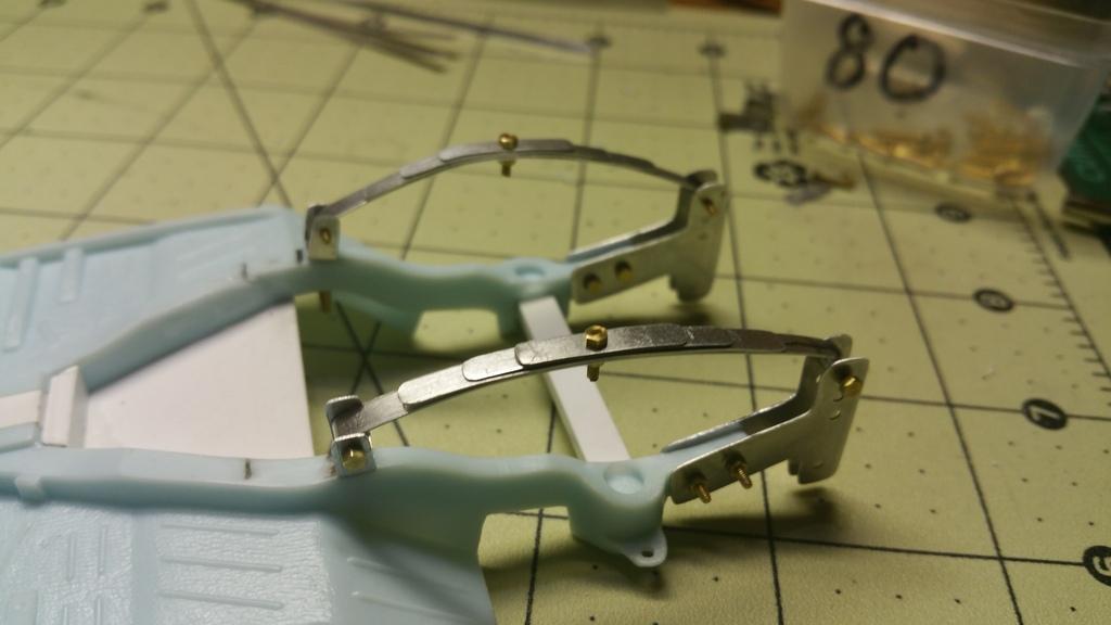

I got the leaf springs at 90% ready. Still need to do the leaf retainer clips, then figure out what I'm going to use for axles. I guess I've got some U-Bolts to make with some mounting plates too. I saw one that used wire for the U-Bolts, then the nuts self threaded themselves into the soft wire.
See ya then. Enjoy the pics if they show up.......
20151017_213945.thumb.jpg.5484718c94039220151017_214005.thumb.jpg.653752cf675cb720151017_214012.thumb.jpg.6e2213cc59f20220151017_214028.thumb.jpg.65bd6b4dfc5dfd
Those springs look very good. They are not very easy to make, but once done they are done, they look very good. I like how it looks so far, keep it coming.B)
