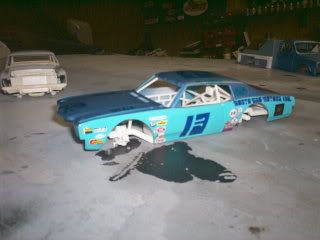

Longbox55 Posted October 14, 2015 Share Posted October 14, 2015 The Testors program is very basic, primarily just premade designs, some blank license plates, letter fonts, and a freeform blank page. They also have an expanded content option from the Sure Thing (which is their supplier) site that greatly expands the available premade content. The freeform blank page is really the best part of the program, great for making signage, plus you can resize images to whatever size you need. I use it with images of plates I have from other sources. The Testors decal paper is ok, Sure Thing is identical. I find that the best way to do them is to let the ink dry overnight to get a full cure before applying the bonder. Clear lacquer which is what their bonder essentially is) will also work for sealing them. The decals on this one, except for the contingency decals on the fenders, were all made using the Testors/Sure Thing program and paper. Quote Link to comment Share on other sites More sharing options...

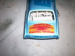

Tom Geiger Posted October 14, 2015 Share Posted October 14, 2015 (edited) Here's a few thoughts... most of us will be making an occasional decal with a inkjet printer. I have been using BMF brand decal paper. It comes in 8.5" x 11" sheets. I have a Canon brand inkjet printer. I build light commercial primarily so I produce company logos and lettering. I will find images on the Internet, photograph images and create simple graphics like lettering. I use Microsoft Word to set up my decal sheets. It's easy to use, and easy to import and resize jpg images. It comes with a large quantity of lettering fonts and you can download more fonts if needed. In Word you can scale your images up and down by exact measurements or you can play if you don't know exactly the size you need. I'll sometimes print a row of the same image, incrementally smaller. I'll then print a copy on paper, cut the images out and place against my model body to get the right look. Then I'll go back and print the images I need at the size I need.I never need a lot of decals at the same time, so I never use a whole sheet of valuable decal paper. There's no sense in filling up a sheet with images you will never use just to fill the page. I pretty much print about 1/3 a page per project. I set up my images in Word at the top of a page. I will either line them up next to each other or set up a chart (set border to invisible so it doesn't print) and place an image in each box for spacing. Important note - print several to many of each image. Inkjet decals often have misprints, so you want to be able to choose the best one for your project. And the decal paper is thin so if you mess one up applying it to your model, oh well we have more!Once you are satisfied, save your project so you don't lose your work. I have a folder with all my old deal sheets in it, so I can go back and print more at any time. I then will do a sample print on regular white paper. Measure off how far down the page your images go, then cut your decal sheet to match this. I typically use a 1/3rd page. Then tape the cut decal sheet to the white paper so that it covers the images. I put one piece of tape across the entire top edge (the edge that feeds first) so that it's attached and will go through the printer smoothly. I don't tape the sides or bottom of the sheet so it can flex with the paper as it prints. As said above, don't touch your newly printed images! I generally put mine aside overnight. The next day I will give it several to many light coats of the "Testors Decal Bonder Spray". Then I'll wait another day to apply the decals. I print on the clear sheets. As said by others inkjet decals are thin and opaque and don't look good when applied over dark color paints. I try to plan my color schemes so I put my decals over white or light color areas. I will print dark color or black lettering to go over colors, and usually over light colors. I just did a commercial Dodge Caravan in silver with red and blue lettering. That scheme worked well. If your model body color shows through your decal you can double up the decals (one of the reasons to print many of any design!) I also have a bunch of small decal sheets in colors that I will use to underlay a clear decal. I wouldn't print on these directly, but cut them to size, then apply the clear decal over them. Sometimes that's needed for white to show through your decal since inkjets don't print white, You will figure it out.I print a lot of license plates from the Acme License Plate Maker. All my models get plates! I don't print these on decal paper. Since these need to have some thickness to them and are glued onto the model, I print these on white 60lb bond paper. This is a report cover thickness. You can buy a pack of 250 sheets at Staples for less then $10 and that will last a lifetime. It's also good for printing signs, business cards and other general printing. The Acme plates get scaled down to 23% in Word, to fit inside the Model Car Garage photo etch license plate frames. The same with dashboard gauges. I have an assortment of printed ones that I've saved from a variety of sources. When I was building my 1965 Chevy pickup, I went to eBay and found someone selling a 1:1 dash panel. There was a good enough photo there that I reduced to size. I print these on regular paper since they can be glued into place with canopy glue and then sealed in with a coating of it over the face.I'm no expert and can always learn more. I hope I added a few details here... Edited October 14, 2015 by Tom Geiger Quote Link to comment Share on other sites More sharing options...
