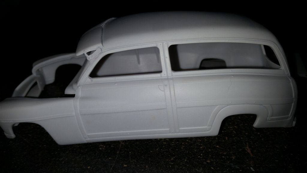

These pics are "what not to do" when using a dehydrator to dry the paint on your model. My dehydrator has 5 trays, I used the lowest tray for the body...WRONG PLACE TO PUT IT!

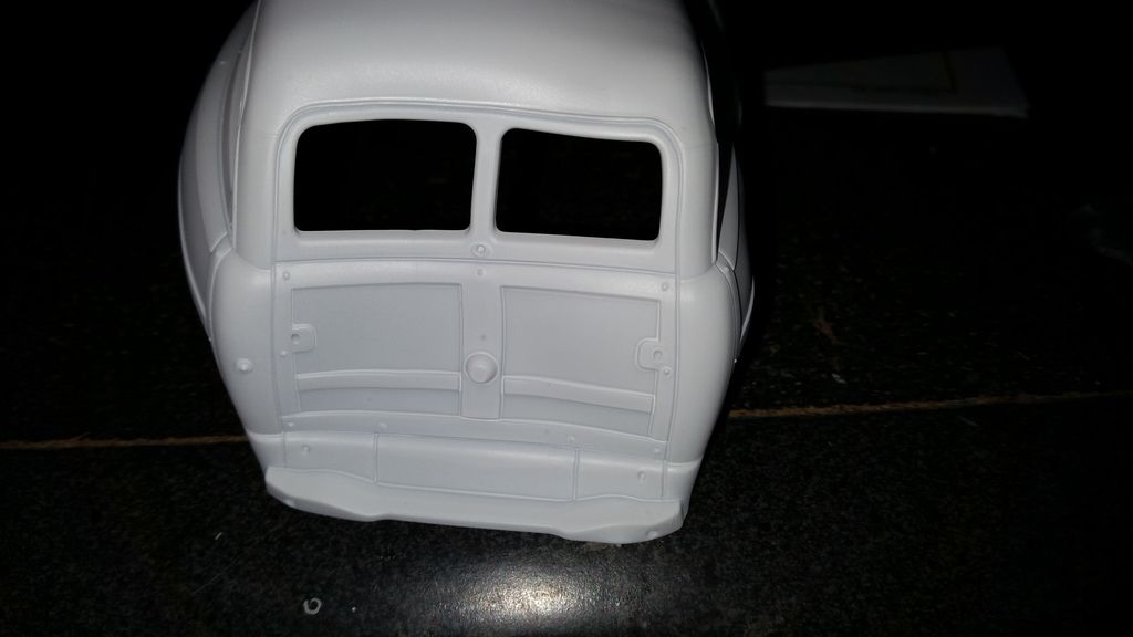

This almost made me cry!  At first I thought that this might have been a godsend thinking that I could go ahead and put this body on the frame...WRONG! :wacko::angry::rolleyes:

Looks like not all dehydrators are equal.  I have a small round one and the temperature doesn't get any higher in it than around 120 deg. F.  Plenty safe for polystyrene and resins (at least all the ones I stuffed in it).
Does tha food dehydrator dry the paint quicker so you can wet sand or shoot clear sooner? Does it cure the paint?
Thanks for the question, yes, it drys the paint as if it was 1:1 like they do in a real auto body paint booth. With Enamel it can take considerable time to dry even here in dry Colorado, with the dehydrator it cuts the drying time dramatically. You can wet sand etc normally in one day, tops 2. without it your looking at a week for the paint to completely degas. I have been using a dehydrator for about 5 years now and this is the first time that it has done this.
Mine is a small round one as well, I think I got it from Ron Popeil back in the days when he was hawking them on late nite TV.  I have never had this happen before, but I know what I did wrong, I placed the body on the base tray just above the heating coil, then like a idiot I started to walk away  (this was in my work shed) but had a paper towel so I just slung it without realizing that it had landed on top of the dehydrator there by holding in too much heat. When I went back out to get the body about an hour later and I saw the paper on the top covering the vents I knew I was in trouble!
