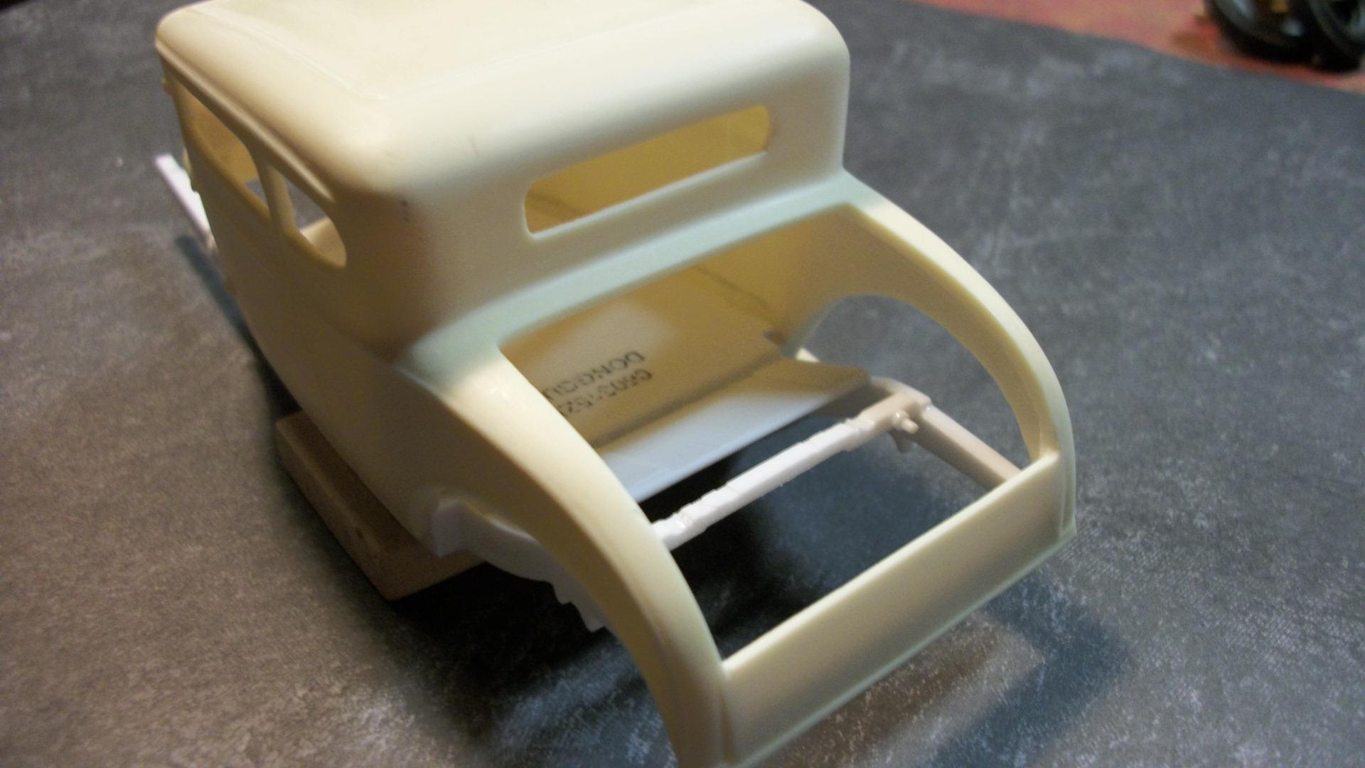

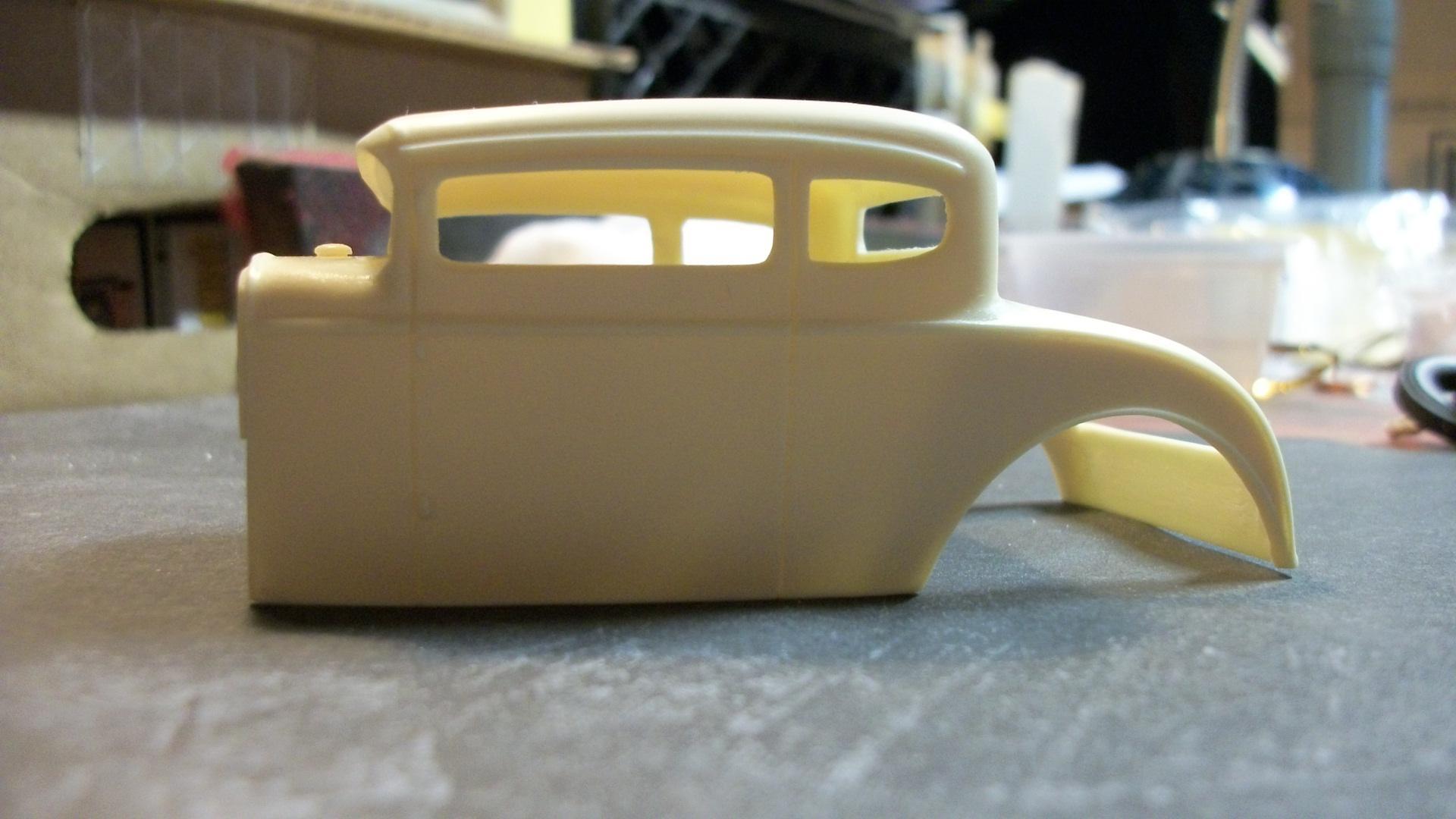

mod3l Lover Posted December 2, 2015 Posted December 2, 2015 Hello all, This is my very first build thread, and my first resin kit ever built! The body is a Jimmy Flintstone body my wife got me for Christmas last year, and when the '29 Ford roadster kit came out, I knew I had a frame to use. I have started some of the cleaning up the body work. I knew that would take me a bit, and it did.
Dennis Lacy Posted December 2, 2015 Posted December 2, 2015 Chopped Model A coupes make fantastic hot rods and combining one with parts from the new roadster kit sounds like a solid plan.

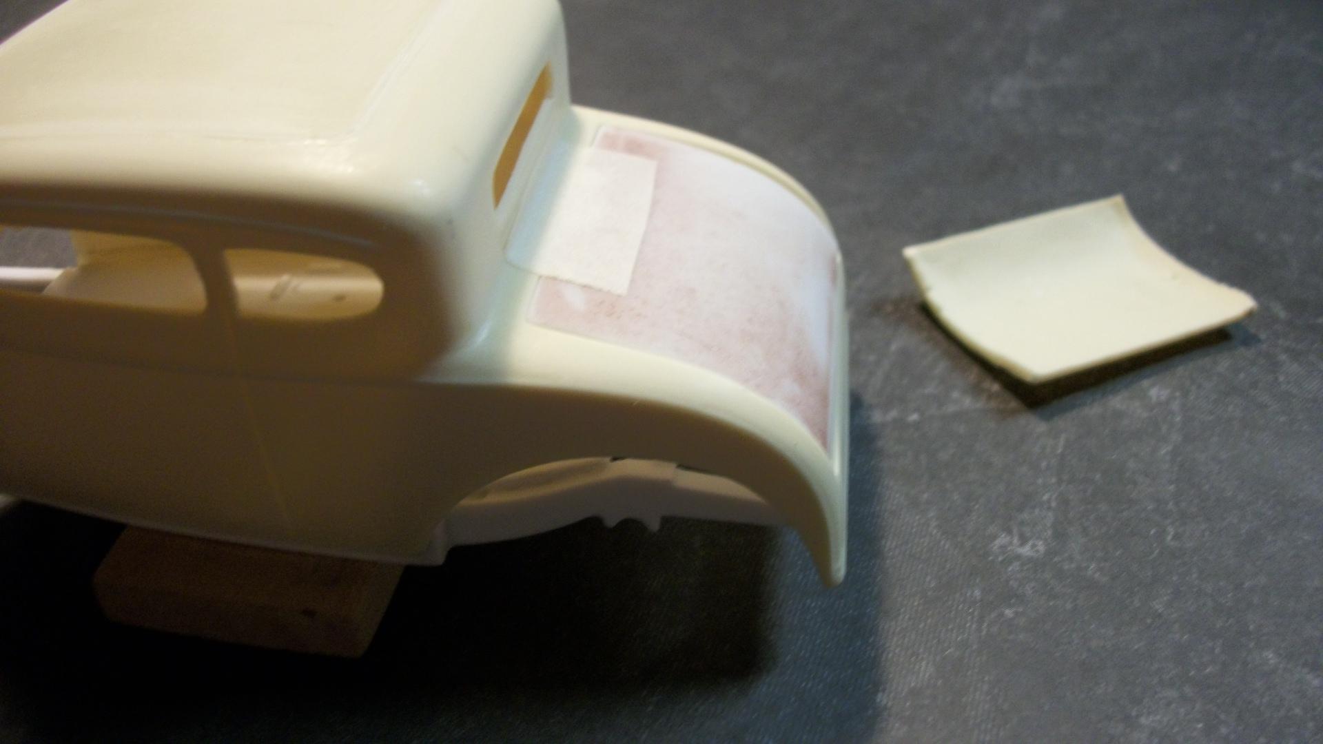

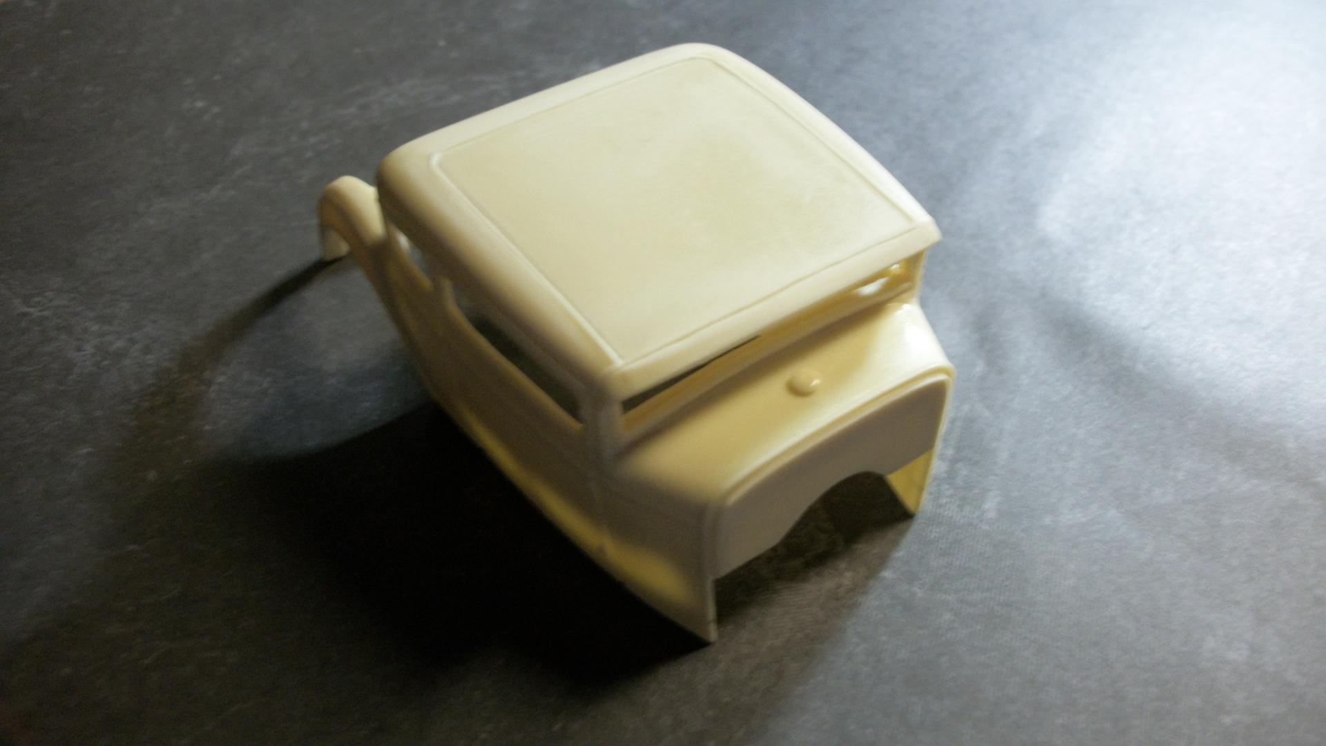

mod3l Lover Posted December 2, 2015 Author Posted December 2, 2015 I did a few more things with this project. And I'm going to post some pics later today. My hopes are that you good people can give me some input on a few choices also. It's a bit of that "I just can't decide" kinda thing going on! I opened up the trunk for viewing the few goodies that come with the '29 kit, but then wanted to add all new goodies instead.

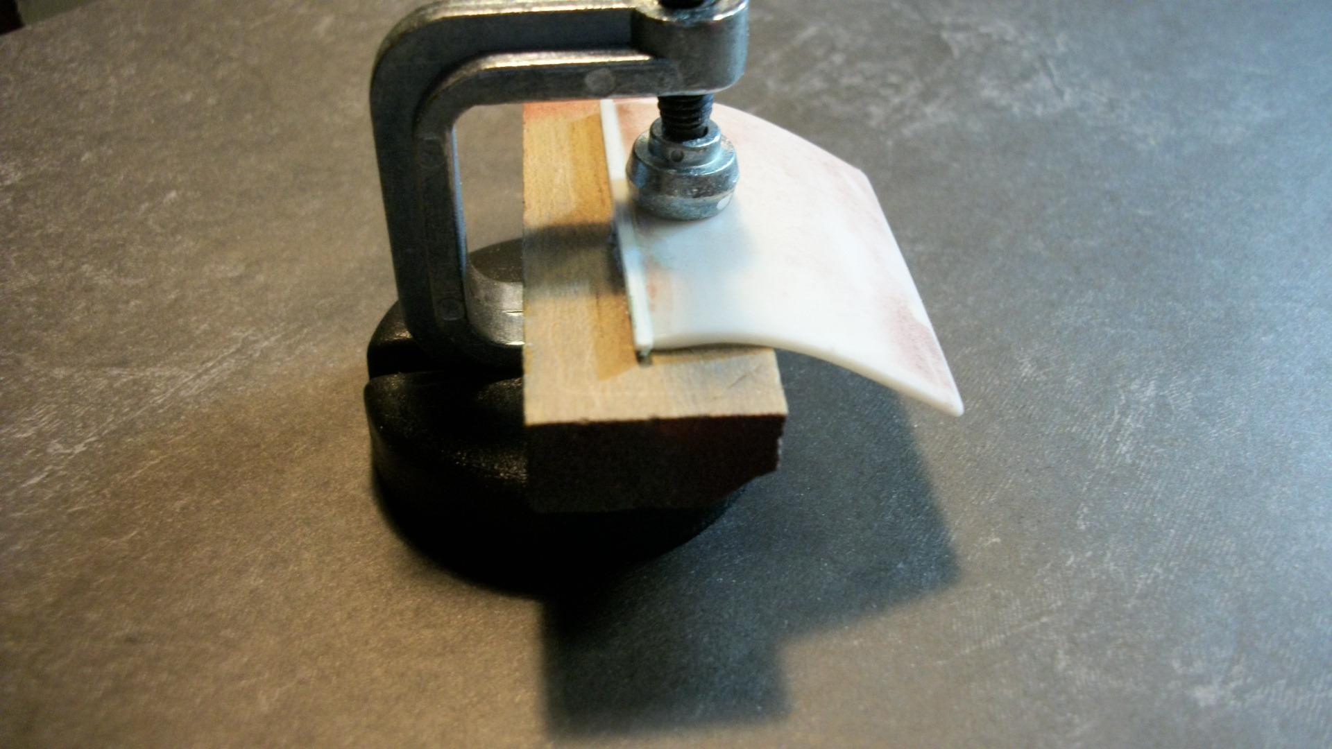

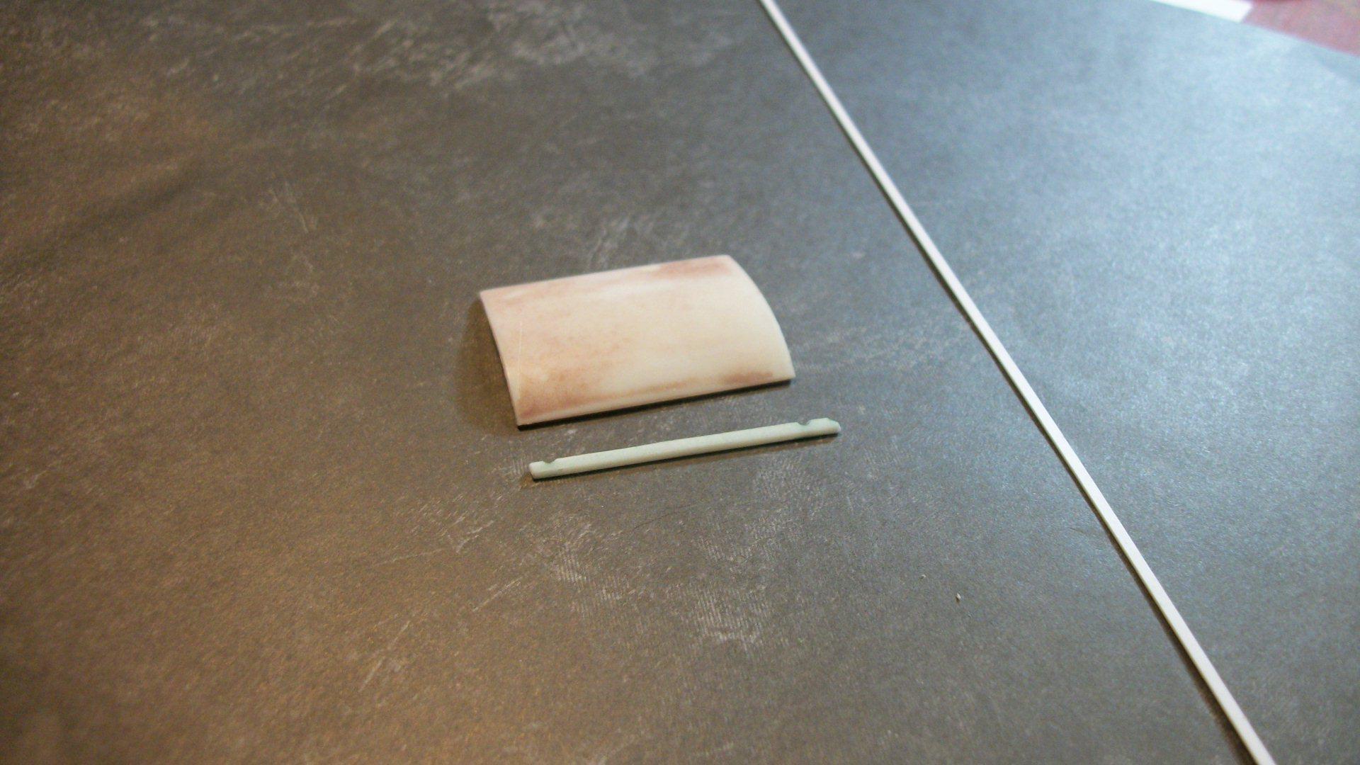

mod3l Lover Posted December 2, 2015 Author Posted December 2, 2015 The new trunk lid is a styrene one, much easier towork with than that resin chuck that came out of there! But it's in need of some sizing to fit perfectly.

mod3l Lover Posted December 2, 2015 Author Posted December 2, 2015 Thank you Dave, all the kind comments arehelpful indeed! I was afraid when I started it,and then I realized why. I had the body crackright below the trunk opening! It was pretty easily mended with some CAtype glue. By the way, I love dirt track cars of all types!Do you have any builds posted here? David S.

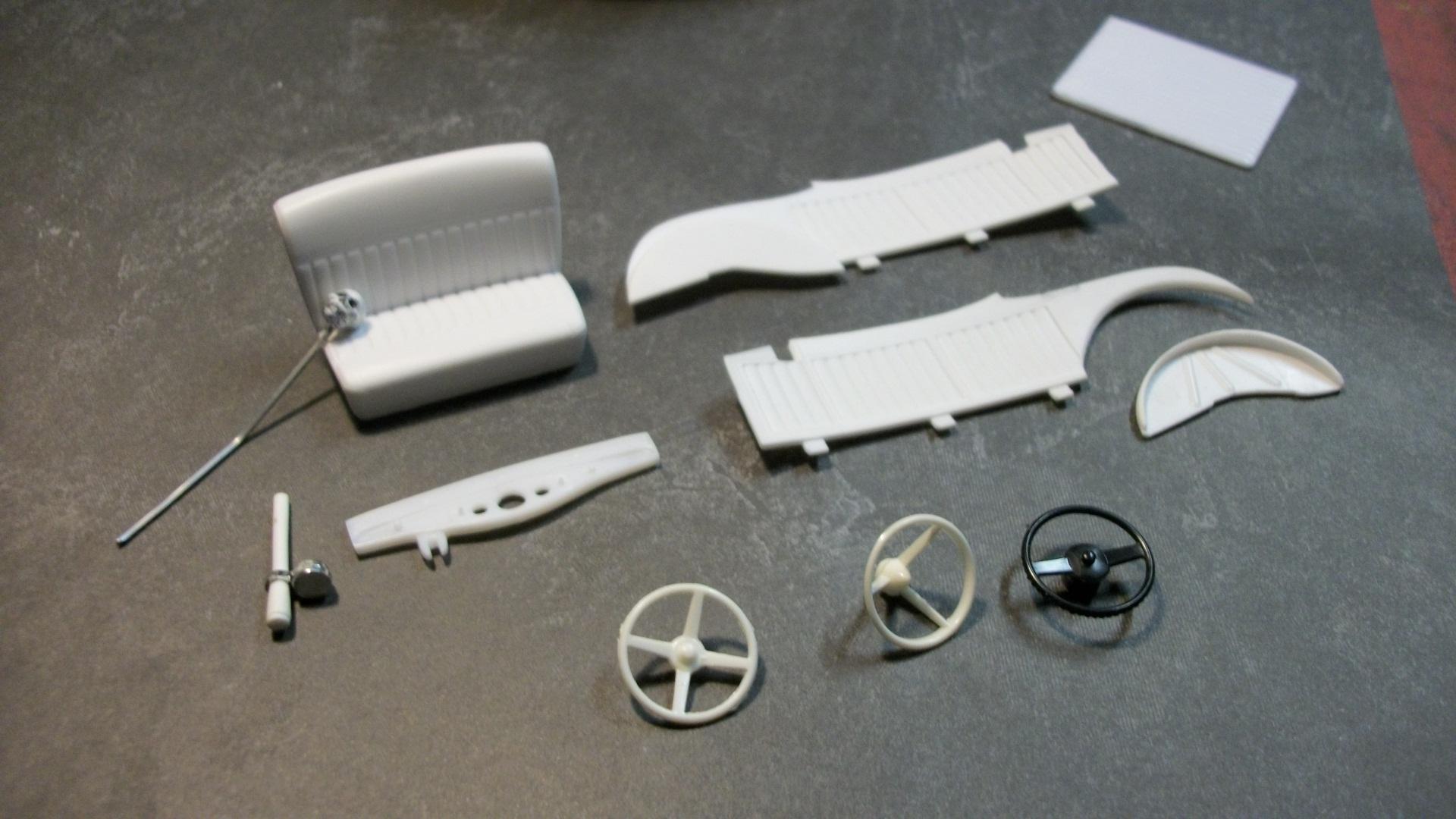

mod3l Lover Posted December 3, 2015 Author Posted December 3, 2015 Today I'm hoping for a bit of input on some choices for interior stuff. I have door panels, the seat, dash and a few other things thought out, but I can't decide on the steering wheel choice for this car! Here is a couple pics on what I got so far.

Spex84 Posted December 3, 2015 Posted December 3, 2015 Looks like some good parts so far...I love "A" coupes.I'm fond of the center steering wheel, the tri-spoke design with the bullet center. I guess it depends on the overall style goal.
Mr. Metallic Posted December 3, 2015 Posted December 3, 2015 I'm digging the center steering wheel also. However, you may want to mock up the interior to make sure that wheel doesn't get too close to the seat. Otherwise you may have to choose one that doesn't have such a deep dish to it.
mod3l Lover Posted December 3, 2015 Author Posted December 3, 2015 I'm going with that wheel in middle for sure, or as long as it fits! Thanks for the advice on that issue Craig. I spent a bit of time on adding a little length to the deck lid. It needs yet material added in the width also. But then I'm back to the rest of the build, I hope!?! Thank you all for any comments and help!

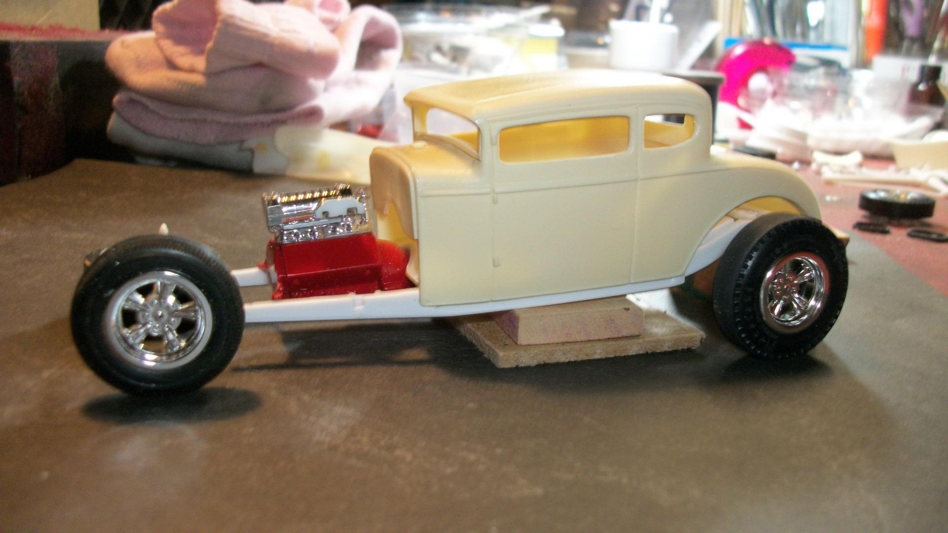

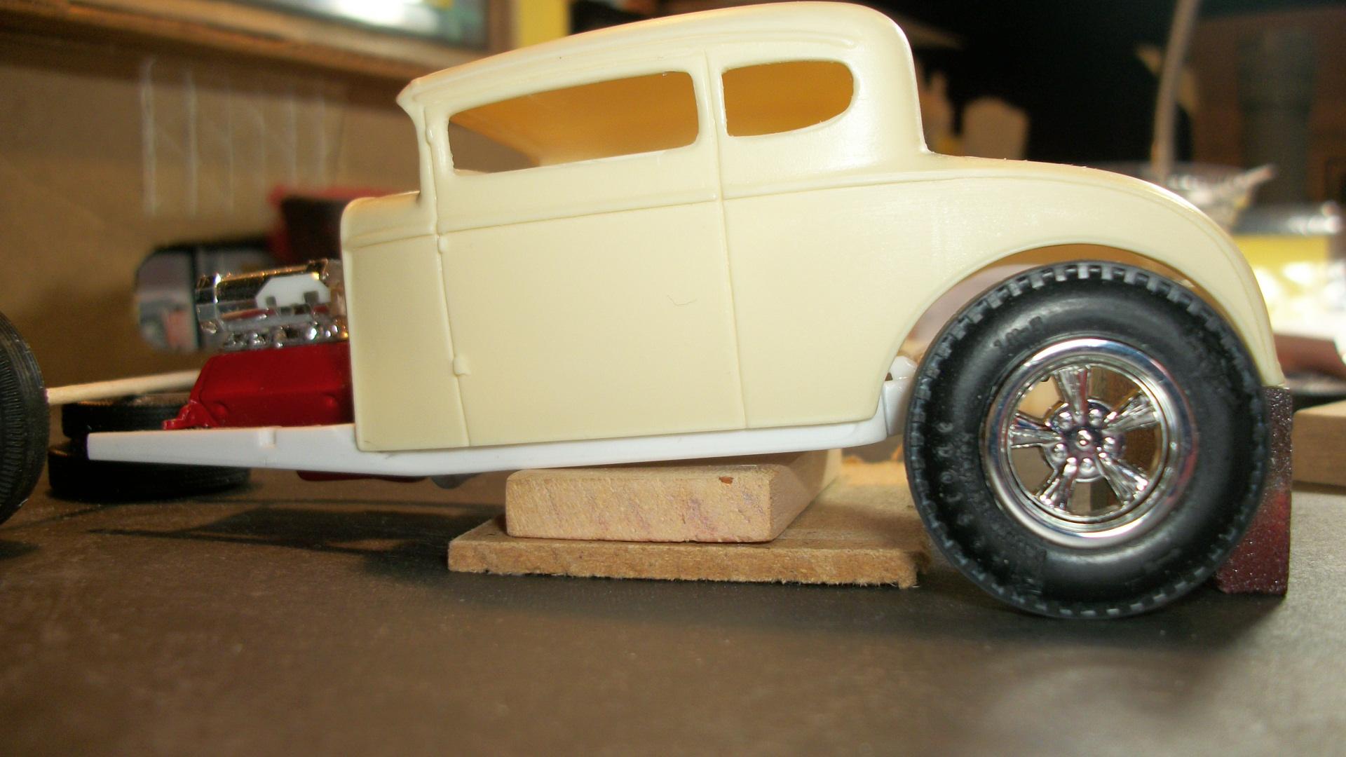

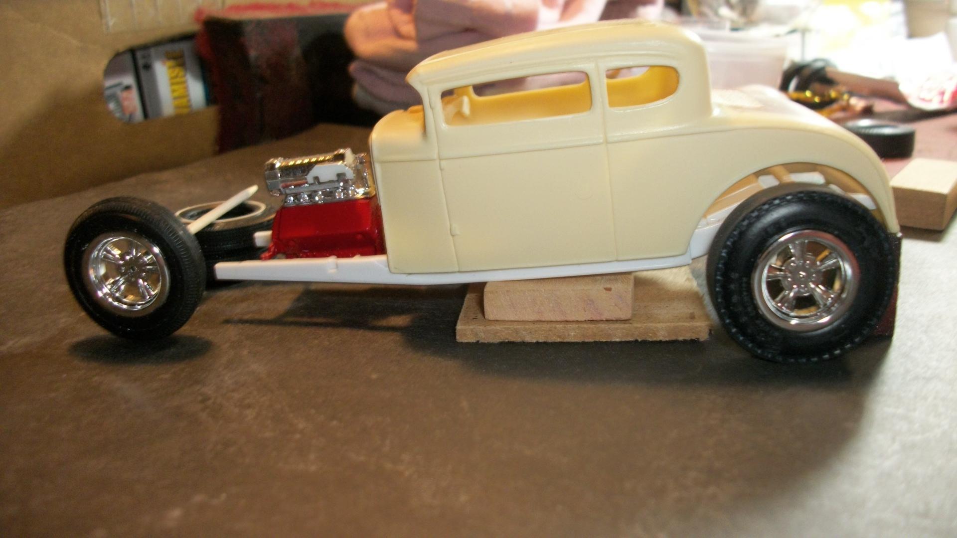

mod3l Lover Posted December 3, 2015 Author Posted December 3, 2015 I also want to mention how pleased I am with the way the '29 roadster frame fits in the '30 coupe body. There was quite a bit of hogging out of the body needed to make it work. But I wanted that kinda thing for the skills I need for future resin builds! Anyway, I think it fits in there pretty darn good!!

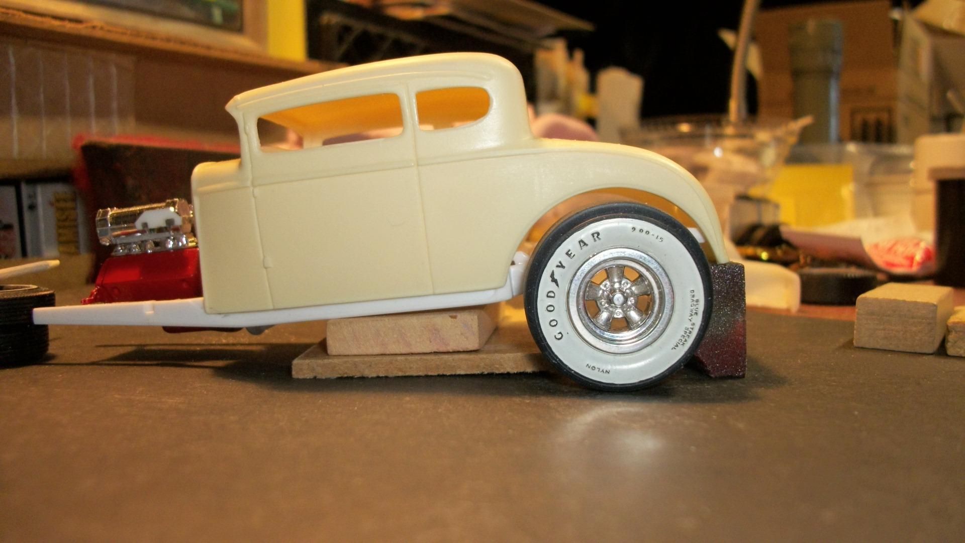

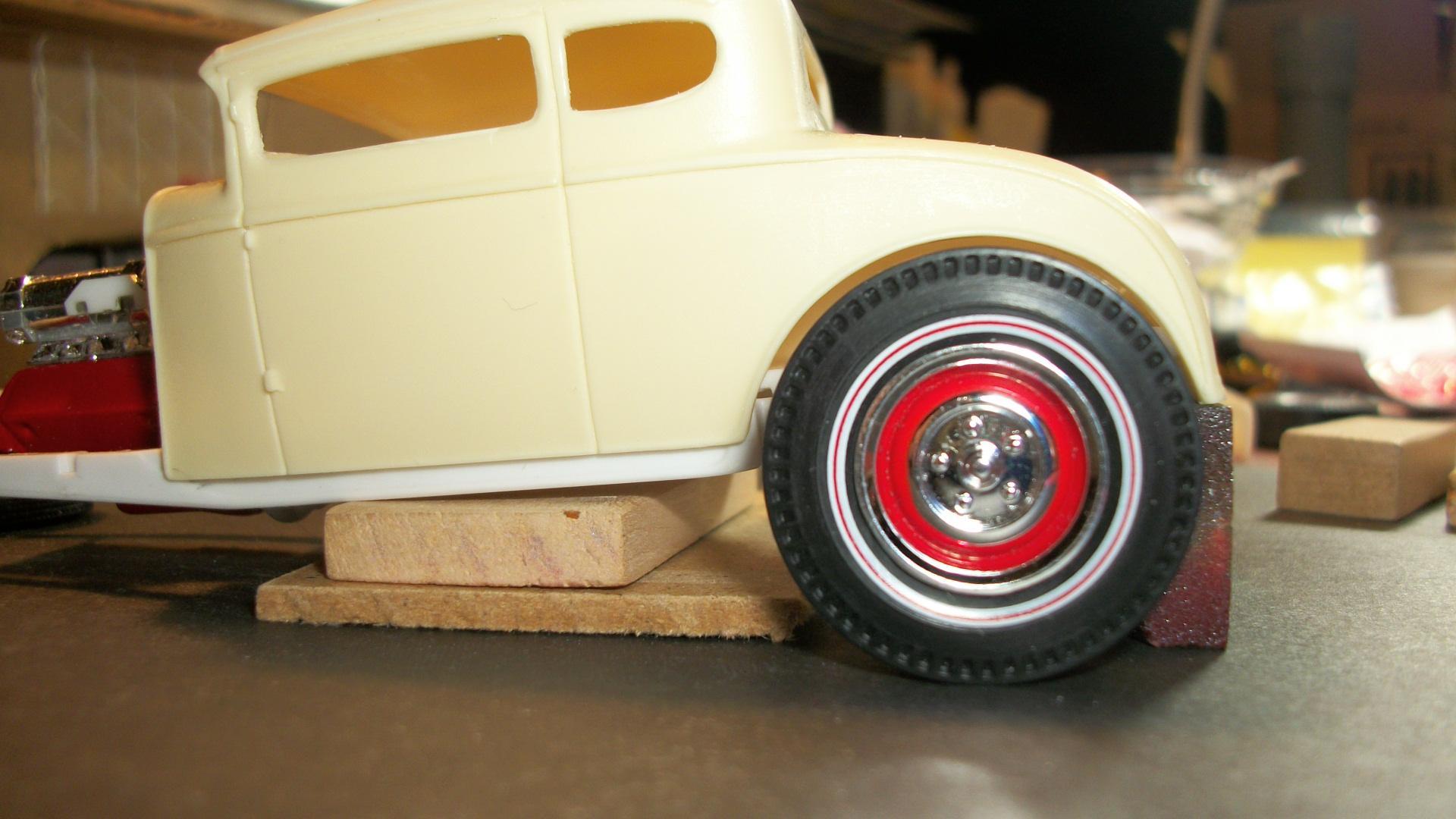

mod3l Lover Posted December 4, 2015 Author Posted December 4, 2015 Well good people, . . . I think my mind is made up regarding the stance and frame length. But like many of you would agree, picking out the wheel and tire choice can be a trial in itself! I want the car to sit pretty much like the 2 pics I am posting below.
mod3l Lover Posted December 4, 2015 Author Posted December 4, 2015 But then the wheel and tire choice is likely going to be one of those things that will keep changing maybe right to the end. Here are a few of my choices for now. I would very much like some input on this matter also! Thanks, >David
mod3l Lover Posted December 4, 2015 Author Posted December 4, 2015 Hey John, Thanks for the input, I'm leaning that way too!The way I look at it, a blown flathead will needat least a 9 inch wide tire! But the American Racing wheels are kindaworn out. I want to maybe use some castaluminum wheels of some type. David S.
Spex84 Posted December 4, 2015 Posted December 4, 2015 Lookin' good!For optimal proportions, try moving the front wheels back by about 1cm or a half inch. It's looking very long in front right now.All of those wheel-tire choices look good; I'm fond of the first one. The chrome-reverse/painted wheel in the second photo is very cool, but with the double white/red stripe slicks it's a little busy looking.

crazyrichard Posted December 5, 2015 Posted December 5, 2015 (edited) nice !! and i love the red wheels / steelies ! .. and yes bit long now .. i would mock up the engine radiator and grilleshell and then place the axle so it fits ps with this body .. try a mock up with the frame low to the ground .. real low i'll bet that would look killer ... z frame .. hmmmmm Edited December 5, 2015 by crazyrichard

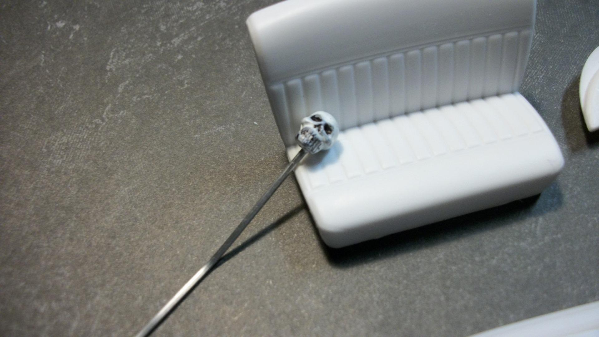

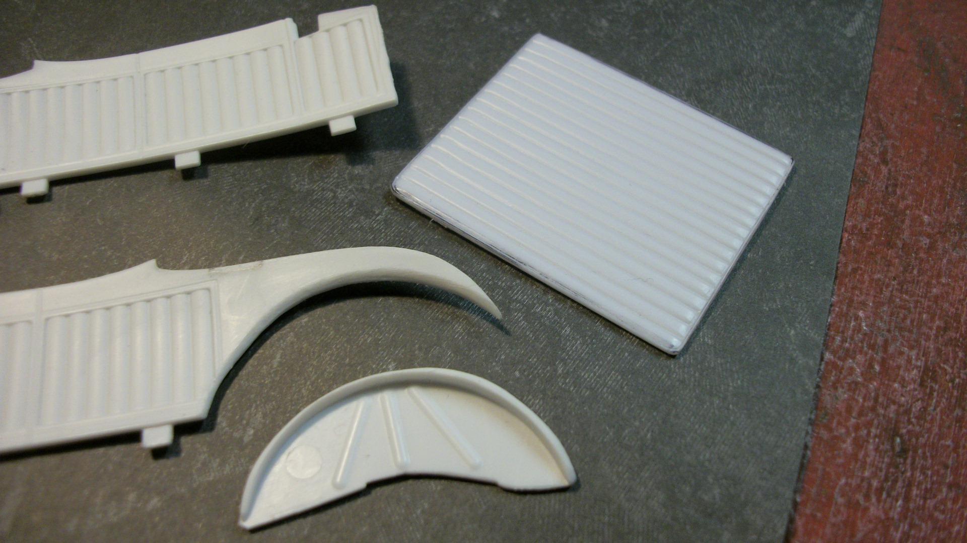

squirrel886 Posted December 5, 2015 Posted December 5, 2015 I also want to mention how pleased I am with the way the '29 roadster frame fits in the '30 coupe body. There was quite a bit of hogging out of the body needed to make it work. But I wanted that kinda thing for the skills I need for future resin builds! Anyway, I think it fits in there pretty darn good!! I hope the trans mount isn't glued in. That's the location for the radius arm mounting points. Looking good so far. I like the body! Have you considered the louvered trunk panel from the '32 5w? Or are you going for the smooth look? I'd go w/ the center steering wheel also if you're installing the shifter w/ the skull.
mod3l Lover Posted December 5, 2015 Author Posted December 5, 2015 nice !! and i love the red wheels / steelies ! .. and yes bit long now .. i would mock up the engine radiator and grilleshell and then place the axle so it fits ps with this body .. try a mock up with the frame low to the ground .. real low i'll bet that would look killer ... z frame .. hmmmmm Thanks for the help Richard, I do enjoy the feedbackbecause this is a rather new undertaking for me. To get it a lot lower I will lose the trunk view I was afterwhen cutting it open! But, the mock up idea is very helpful! I was just fiddlingwith it a moment ago, and I realized that I will have to domany such mock ups to make this one work out. I also think that I might just have to buy a couple moreof those bodies to do in different ways. Very low with a Z'd frame and no open trunk will be myfirst one! David S.
