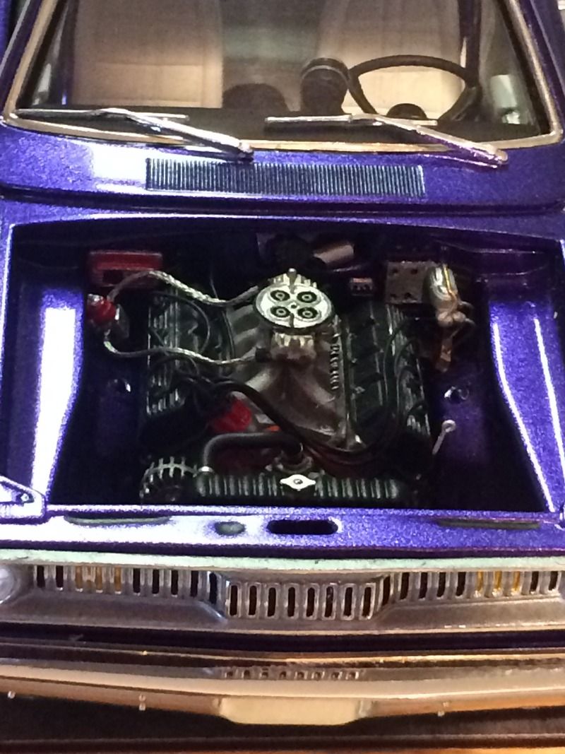

started making a waterpump , the pullys , powersteering stuff
used these .. but i have much more hemi pictures .. a lot look slightly different because they have been altered
bare with the waterpump
one with the pullys
WORK ON THESE PICS IS ALL VERY ROUGH WORK .. NEEDS CLEANING , PRIMER ETC ..
started by making a waterpump .. most wont be visible with everything in place so .. i make like the circle with the pipe going down sideways ad the other hose connection on top
the kit engine also was a glue bomb all wasted .. now the kit provided a second pully and belt system .. one was all busted on the engine and this one was still in the sprue .. now it looks like the one on the pic above exept the thing on top .. (what is that?)
saw different powersteering reservoirs .. so i didnt make it round but just square , still a rough version
complete set up so far , on the empty pully will sit the alternator with a bracket connected to the engine
dryfit .. fits nice , the front of the frame with the holes will be changed ...
yes it does :) .. the alternator is on the engine with a bracket the pulley slides on that .. tis seemed the best way to get it on level and lined up ..
also sprayed it with some primer .. when its dry i will post some pics
and yes could be a a/c ..hmm dont need that :)
out the alternator on the engine with a bracket , later i will paint it chrome .. now the pulley sits on it perfect , this was the best fitment / alignement option..
also primered it all the waterpump looks nice now
made the breathers on the covers ... tiny stuff lol , the tops are actually tear drop revell taillights (clear red styrene)
puleys and powersteering tank primered
all together
belt and pulleys are painted , added the correct fan , luckely i fund a nice one in my engine parts box .. wich also had the blades in  angle
all losse dryfitted , the alternator shaft and pulley is painted in a bronze color , later i will give it a drybrush with gold to mimick the gold-ish color
front hight .. i didnt want it way up in the air , for a charger wich is quite long that looked weird . still pretty high .. rear is just sitting on the tyres , need to start on the rear axle and suspension
i'm in doubt .. should i make the rear wells round .. to fit the tyre shape .. as you often see done on gassers or keep the stock shape ...
peeking onder its skirt   :lol:
together with the 69 charger on airride i did earlyer .. now i think i should have just kept it low nd not totally slammed but at the time i loved it

this is turning into the most detailed engine i ever build :) .... started on the carb .. and i decided to scratch build it ...looked at a ton of carbs and decided to make a single crb , a large version ... tryed to mimick it as nice as possible .. now the size is a restriction off course so are my hudge hands ...lol
started like this >
till this , used several drill bits to get a conical shape , even the top ring is made out of square plastic ...
gued some chrome beads in the holes
now its very rough in this picture , needed sanding etc.. but on the foreground you see the spring i made using tiny steel wire wrapped around a pin
after the pic below i altered the spring a bit . so it sits a tad closer against the body of the carb ...
dryfit with the other parts
at first i was woryed that the spring was too big .. but in the end after some tweaking i think i can get away with it .. i should have used the steel pins without the round head on ..

i did spray the intake and carb with chrome , did the vale covers and master brake cilinder as well ..
now parts of the carb will get some gold over the chrome same as the master brake cilinder ..
also inside the carb bowl in the holes i will put some cool small round bars , hope to paint those transparent red ....spring is off i wont paint that .. i think the clor of the mterial itself is more convinsing then my spray chrome , also gives a bit variety in tones
thnx james , well lots of people have asked me what that is .. its only available here in holland .. its just a big rattle can from a diy store called gamma ..
its their own brand rattle cans ... here in holland modelbuilders call it "gamma chrome" not how its called for real...
it sys its silver metallic .. but it turns out like this ....not real chrome .. not silver its a bit in betwene ...
its handy because you have a hudge can , always ready for spraying ... its sprays without any wrinkles .. this stuff > you can not spray wrong , the worst person thinkable could not screw this up .. weirdly you can spray it very thick also

went right at it .. note they can be sanded / filed more in a shape when the glue is dry ..
now on the front i will glue a piece under the small one , needed that to get level .. but start is there .. and much apriciated !! i'd rather put in more time and get it looking better ..
tbh i was thinking people would say it was to big with float bowls like that .. i saw some weird carbs where they where very small so i ended up with what i showed ... just kind of winged it on the carb , like look at a lot of carbs and then just build something .. not really build from a certain pic ..
bit od sanding corners a tad squared .. and some chrome
now i also need to make a throttle cable , arm next to the spring , 4 pipes in the holes ... fuel line ...

painted it gold , i tried to give it more of a gold haze so it would be between silver and gold.. man that didnt work :(  so now its gold  , added the first small details pipes in the holes ..next i want to make the throttle with cable next to the spring i already put on ....>
