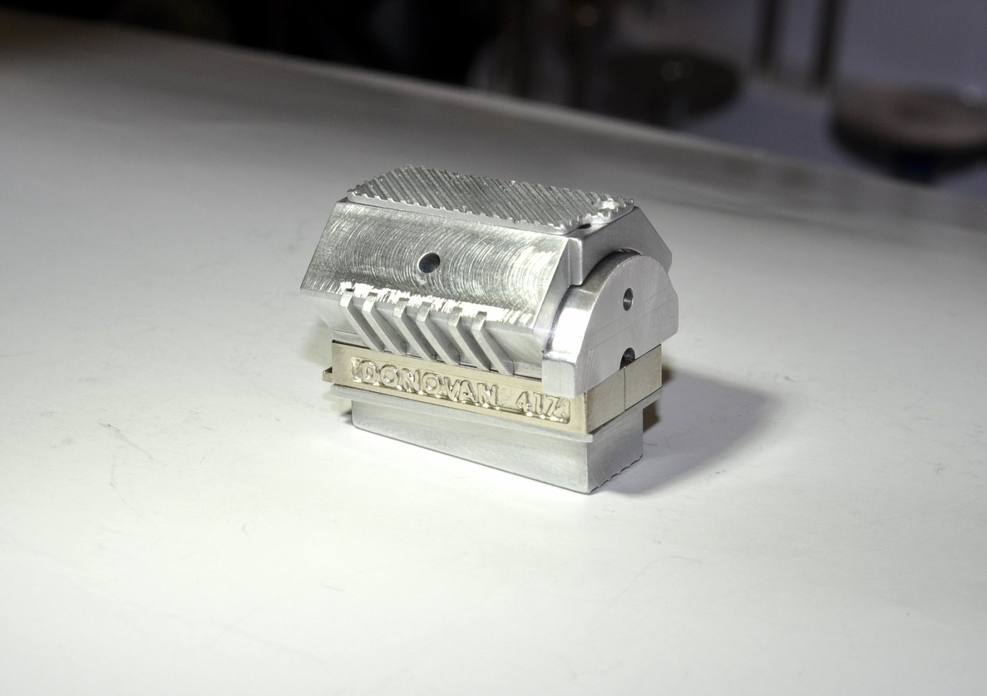

Today I got the lifter valley cover made.  Wanted something a little different so I put the ribs on a 45 degree angle.  The 2mm hole you see if for oil fill, I have to make a simple cap for it.  Cheers, tim
REAR ENGINED MUSTANG LIFTER VALLEY COVER 015
The ribs are 1/64" btw and the piece is .6mm thick.
REAR ENGINED MUSTANG LIFTER VALLEY COVER 026
REAR ENGINED MUSTANG LIFTER VALLEY COVER 004

Thanks Chris.  I am anxious to get the next couple of parts made, that should really set it off.  Took a little time to put the ribs in the block.  A small step but gives the Donovan one of its identifier traits. chip, chip, chip..............cheers
REAR ENGINED MUSTANG DONOVAN RIBS 060
