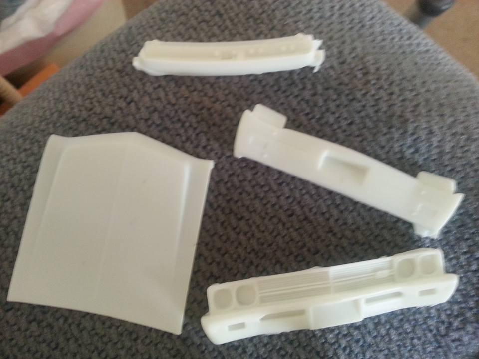

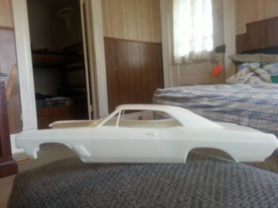

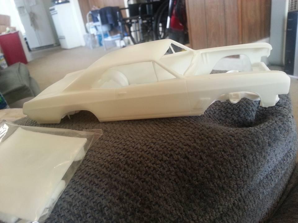

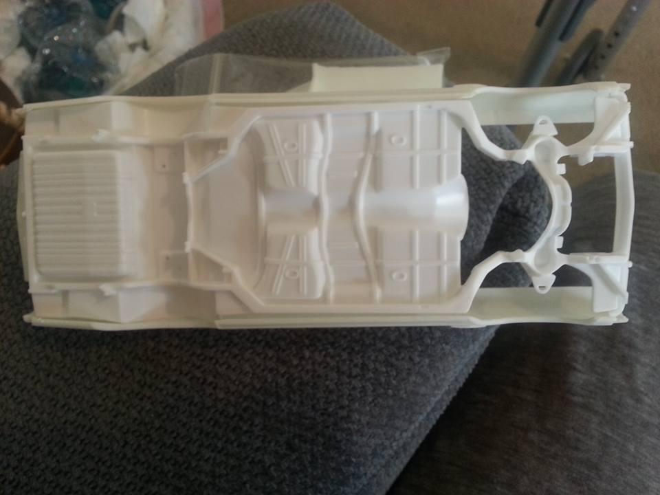

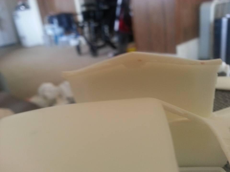

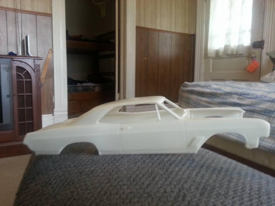

I haven't built mine as of yet, but I had a while back removed  the  molded in hood, and cleaned up a little of the flash on front grill/bumper, still some flash on rear bumper and dash. I test fitted a chassis from the most recent lindberg '66 chevelle, fits very good, a little snug, would need just the tiniest amount of adjusting. The front of the underside of the hood would need some attention if displayed open and not pictured are the two hood scoops that are seperate small resin castings, Hope this helps.

Also, they evidently started with an original AMT '66, which has a wonky body line on the left side (the right side is okay) that needs correcting. Fortunately this isn't difficult to do, you just need to notice that it needs to be done. I think this thread on my '66 rebuild shows the problem and solution:
