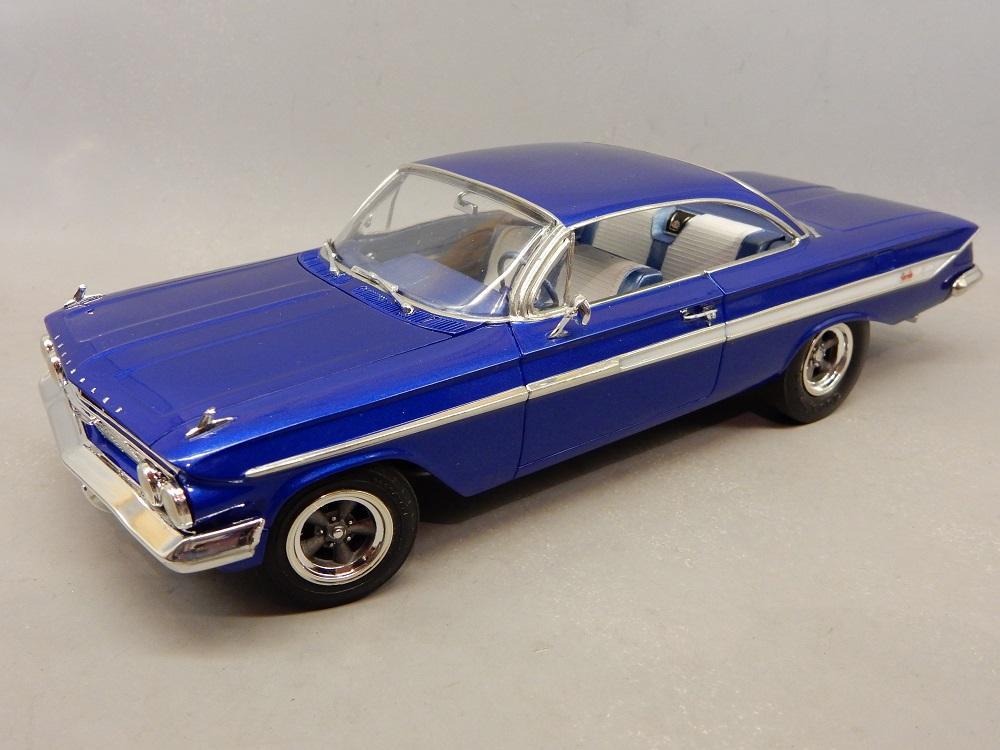

pack rat Posted April 17, 2016 Posted April 17, 2016 Everything piece of chrome you see on this build was installed using two part epoxy-no pins. If you mess up and get some on the paint (as I did with the driver's mirror) it can be buffed away with no damage (I use lacquers, with a clear coat...not sure about enamels). I found a small smear of dried epoxy on this one hours after it was completed and removed it using Novus #2. I'm about to pack it up and ship it 350 miles out of the country; I've been doing it this way for awhile and I'm not aware of any loose pieces (yet).
crowe-t Posted April 17, 2016 Author Posted April 17, 2016 Thanks guys for all the good ideas. Mike, you did a beautiful job on this one. I love the blue!
