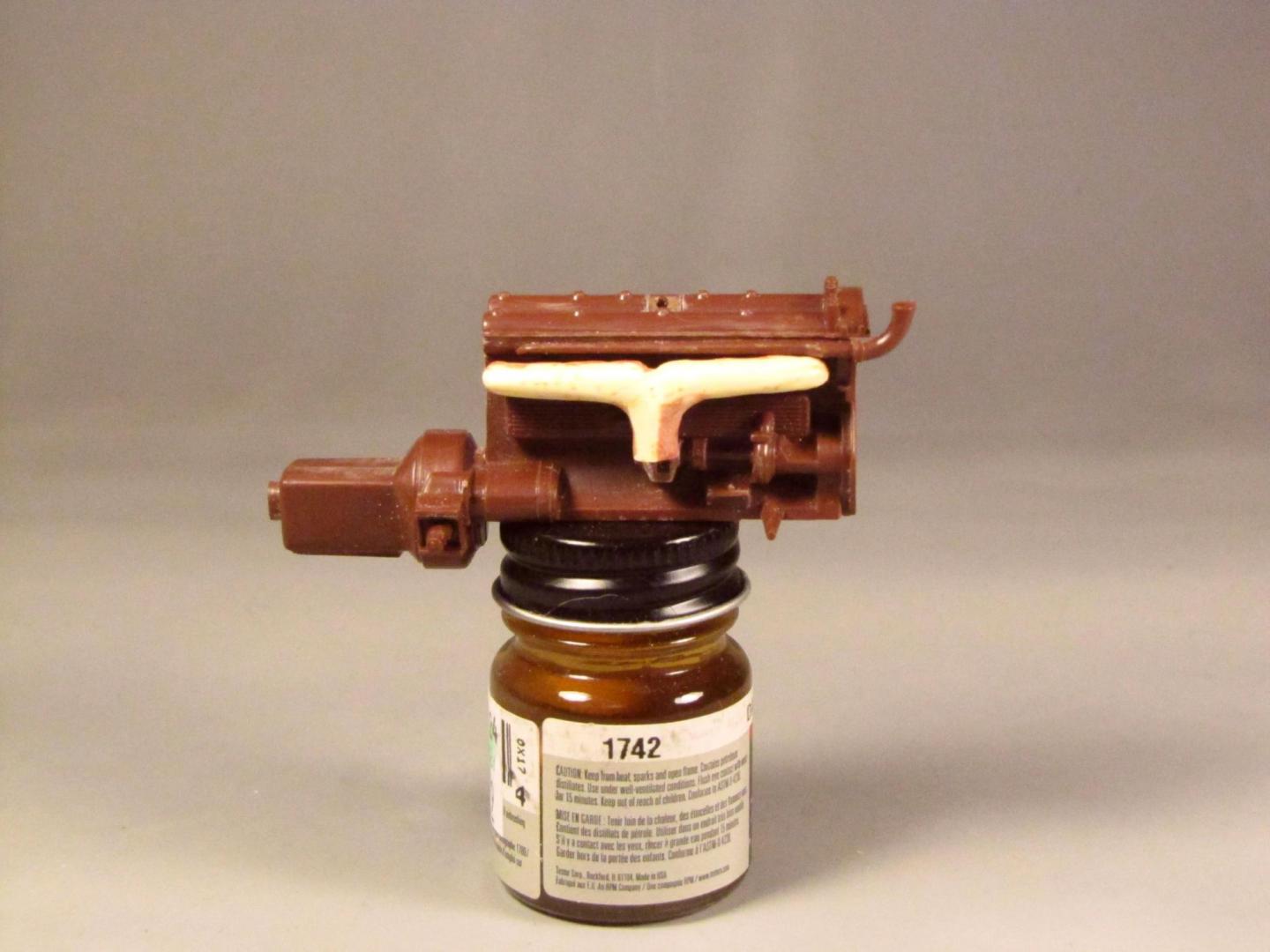

Did some work on the engine this week:  First up was to correct some deficiencies in my exhaust manifold casting (note: the original Model J exhaust manifold is quite different from the SJ supercharger manifold, and different from later-year manifold as well--having it's "exit" at the center rather than at the rear end of the casting)  Done, but not visible in this picture of the unpainted engine is my "defining" of the cam covers.
Even though a DOHC engine, a Model J straight 8 has THREE cam covers, due to the distributor being driven off the middle of the intake camshaft, and non of the cam covers are at all defined on the model engine.  So, my trusty razor saw to the rescue, to scribe the joints between cam covers and cylinder head, which will show up once the engine is painted (Apple Green for all the cast iron parts, varying shades of silver for the aluminum parts.

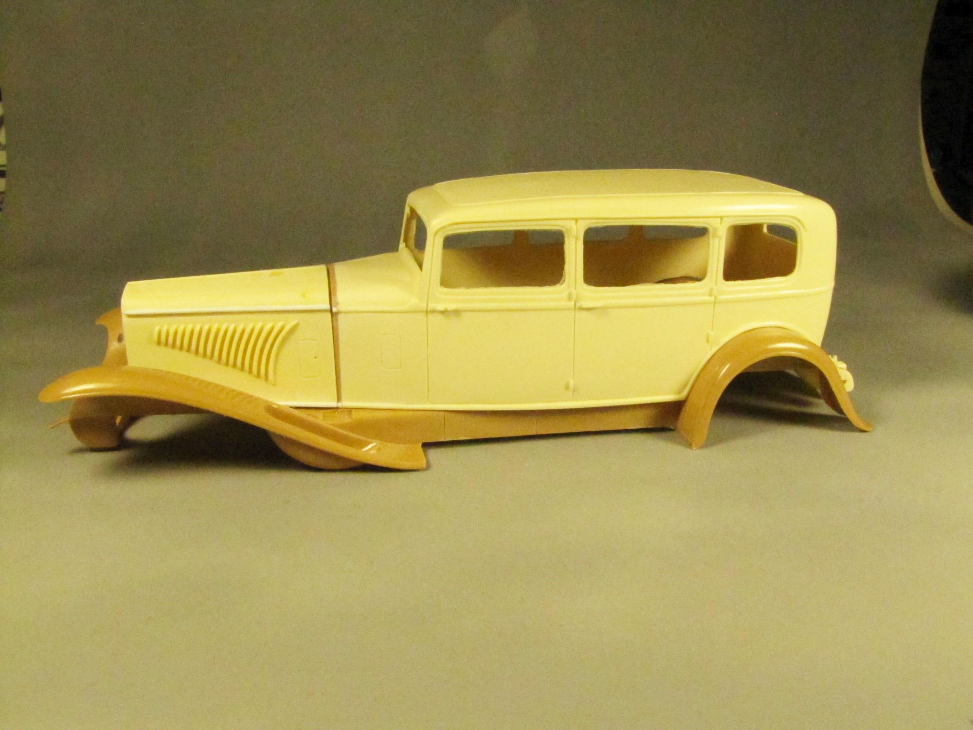

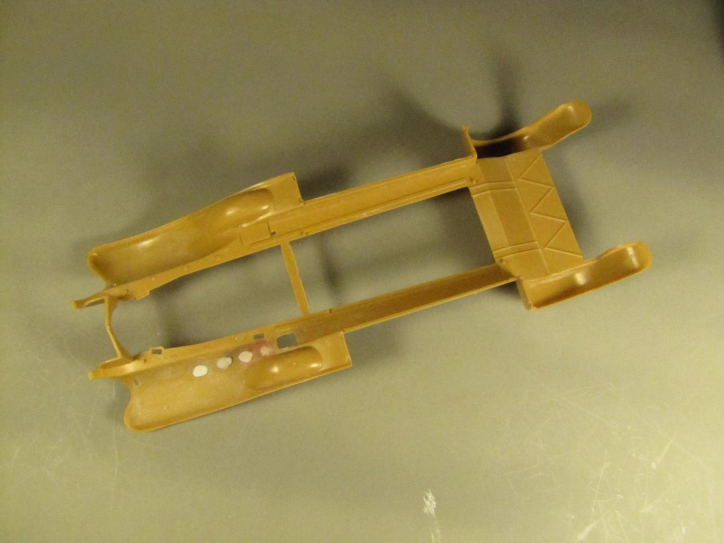

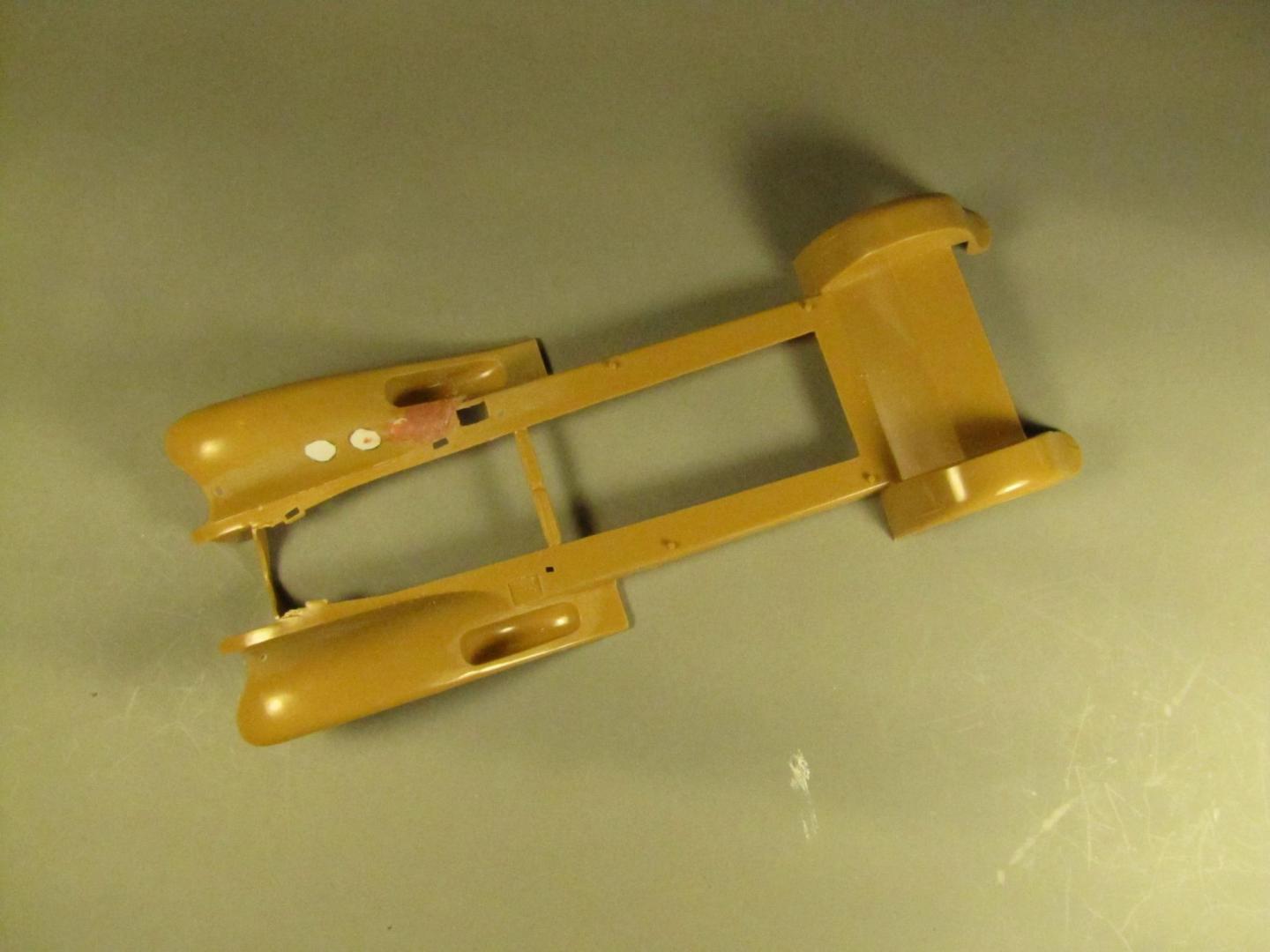

I've not had a lot of time to work on this Duesenberg since I started the topic (work, plus some free-lance stuff) but here goes: As the car is to be non-supercharged, I had to plug the exhaust ports in the Monogram kit's right front fender.  While I used chunks of thick Evergreen, glued in with Zap-A-Gap, filing and sanding those to shape gave me fits due to making for a very thin section where the fender meets the splash apron--hence the putty work there. In this process, the thin chrome bead around each spare tire well had to go, which is unlamented, as this Berline is to be a bit understated as to brightwork.

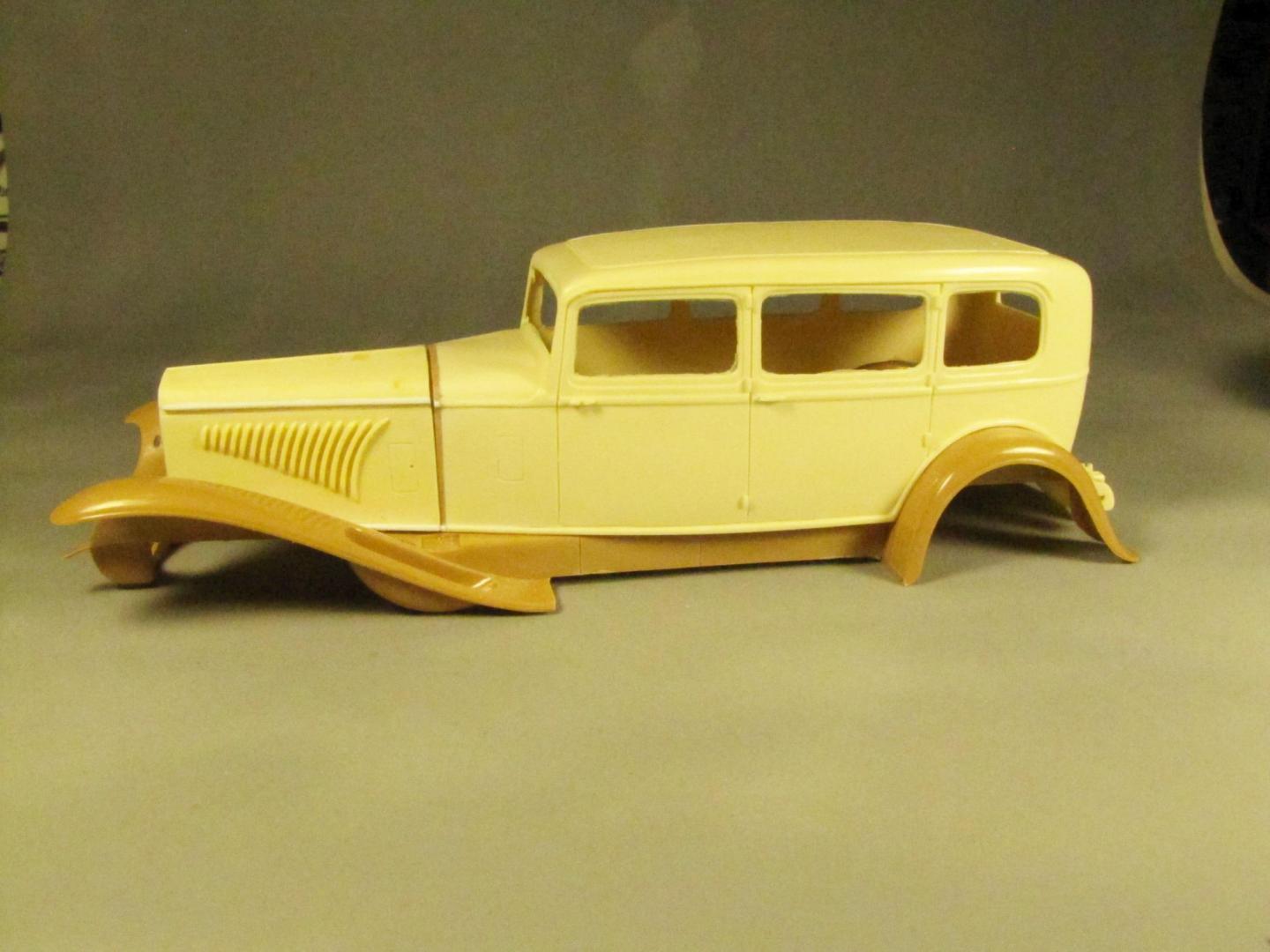

The body presented some problems, mostly due to my inattention when I received the master from Lee--I really should have tested the master on a mule kit, made sure that the cowling and front quarters mated up and blended into the hood as they needed to--but no matter now!  After some filling, filing and sanding, and corrections to body moldings, it all blends well together, even though you cannot see it in this picture.  I did add raised moldings to the hood top panels and at the bottom of the side panels, to carry those lines from the body forward to the radiator shell. Fiddly, tedious work, but I think I am going to like the end result!

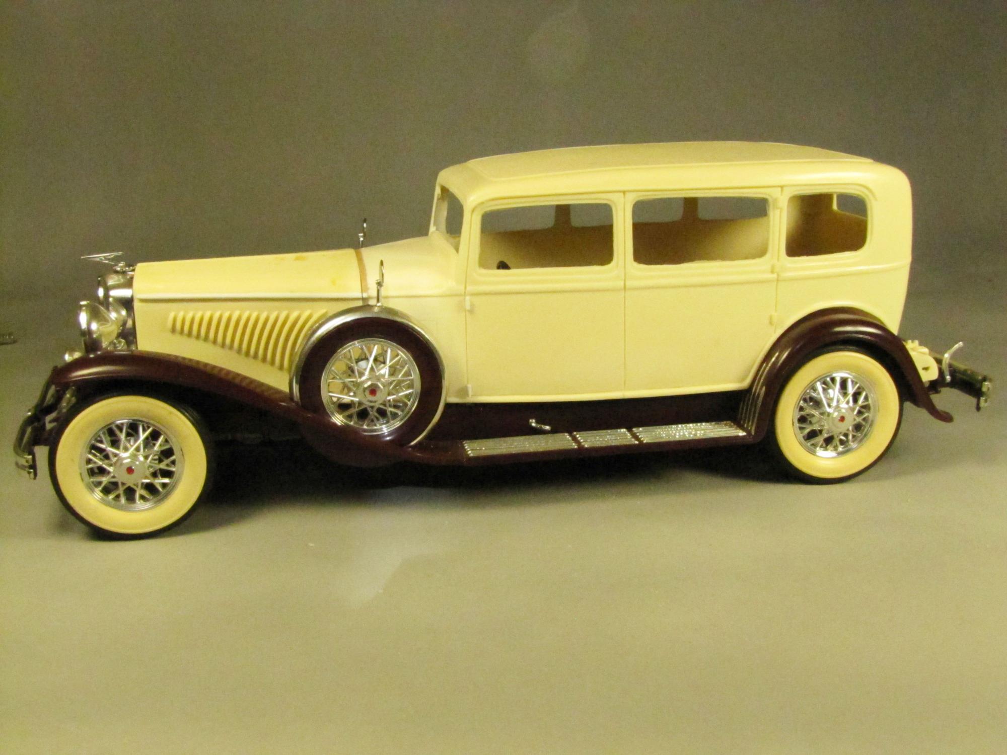

While studying this project, I had a very uncomfortable thought:  As the resin body already had its firewall installed and I had cut it out, when I mounted a fresh firewall, I realized that the firewall on these kits attaches TO THE FRONT of the cowling not "inside of it", thus making the overall bodyshell a good 1/16" longer.  What if this made fitting the hood in between the body and radiator shell?

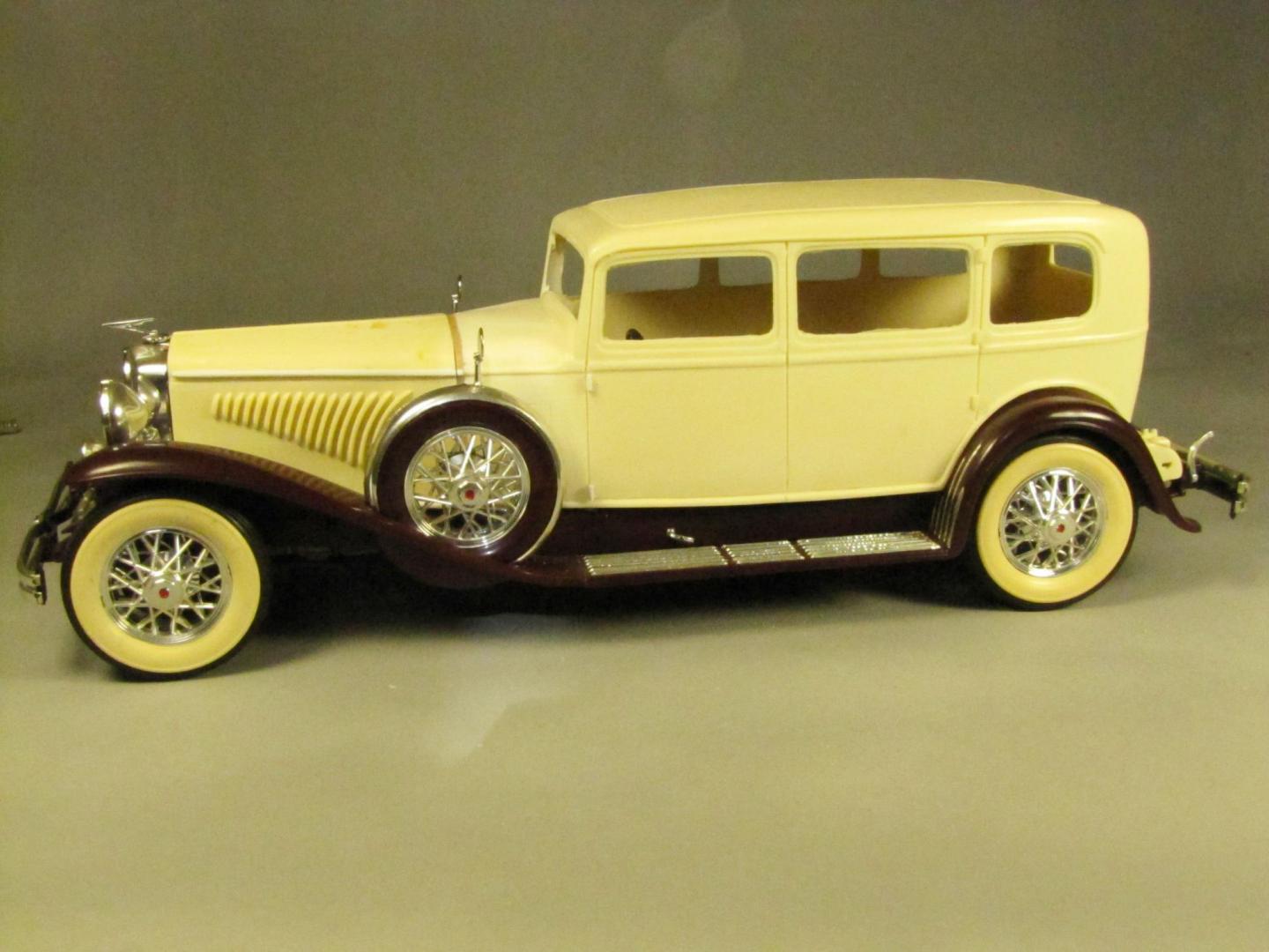

Fortunately, I have a new badly deteriorated Duesenberg Convertible Coupe model on which the body had come loose, along with many other parts--why not test fit the Berline body and non-supercharged hood on that, see what gives?   Phew!  body and hood fit perfectly for length,
