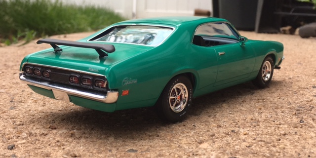

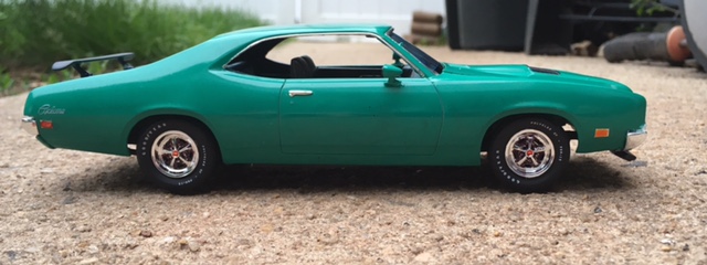

Porscheman Posted May 25, 2016 Posted May 25, 2016 Here's pictures of the final Missing Link kit build. The only modification I made to the Revell kit, was to move the rear suspension forward 1/16 of an inch. Hosted on Fotki Hosted on Fotki Hosted on Fotki
Merkur XR4Ti Posted May 25, 2016 Posted May 25, 2016 (edited) That looks really sweet! Did you use the Torino GT or the Torino Cobra kit as a base? Edited May 25, 2016 by Merkur XR4Ti
