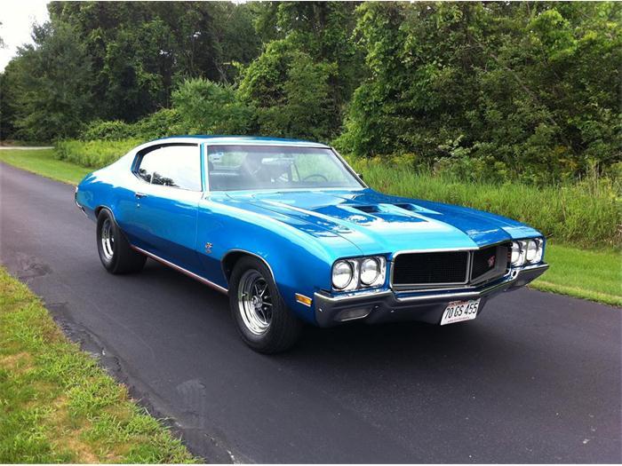

Can't wait to see your progress Jerry-----------that blue one you posted is a beautiful car! B)
Thank you. That is a beautiful GS. But sadly not an original color that I can locate. The color charts show nothing close. There is a deeper shade of blue listed. I thought about dark green but not sure which shade to go with. Red to me is too much SS454 LS6. Any suggestions would be appreciated. Thanks again for the positive commentary.

Well if you're not going with an original factory paint scheme then by all means the GSX kit will be the easier of the two to build.
That's a Maaco re-spray. Used to see that coming out of their shop all the time as their standard blue for people who didn't want to pay the extra $50-75 for an approximate factory match.
Tamiya Brilliant Blue Metallic isn't too far off from that. Tamyia's spray paints are excellent- they cover well over primer (although you can use them on bare plastic-I have with good results,) and dry very quickly (about 30 mintues.) Be warned, though, that they (and Testors lacquers) are synthetic lacquer which use a kissin' cousin to nitrocellulose (I don't have a can handy, but I saw something that appeared to be a derivative of wood alcohol, and nitro-lac isn't too far removed from that,) and they are very, very pungent. If you're married or share the house, DO NOT paint upstairs with that stuff.
I would recommend spraying outside or in the cellar with your door open and a fan blowing out. It would also be prudent to grab a spray mask. Most Auto Parts stores have good respirators for about $25 that are good for about 40-45 hours of work. Just be sure to store it in its bag and to press as much air out of the bag as possible while closing it. A 10-ream paper box makes a decent "spray booth."

You would be happy using Tamiya TS-19 spray.  I've used it to get a similar color on several cars.  Its my go to paint for something close to that color.  I always use a white primer under this color.
Tamiya lacquer goes on flat so you'll want to also do a clear coat.    My preference is Testors Wet Look clear lacquer, but there are just as many who like the Tamiya TS clear.

This will be my inspiration for the GS/GSX
Would love to add the proper GS Stage 1 fender badges, the GS by Buick trunk badge, and the GS grille. All I've seen is a photo etched set but am unsure how to attach the metal to styrene and not sure as a novice I should be attempting it? Thoughts, and suggestions are welcome. Thanks
