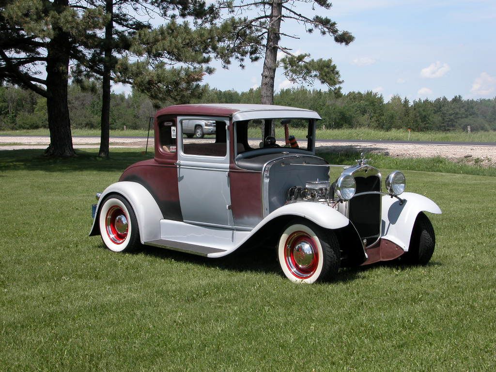

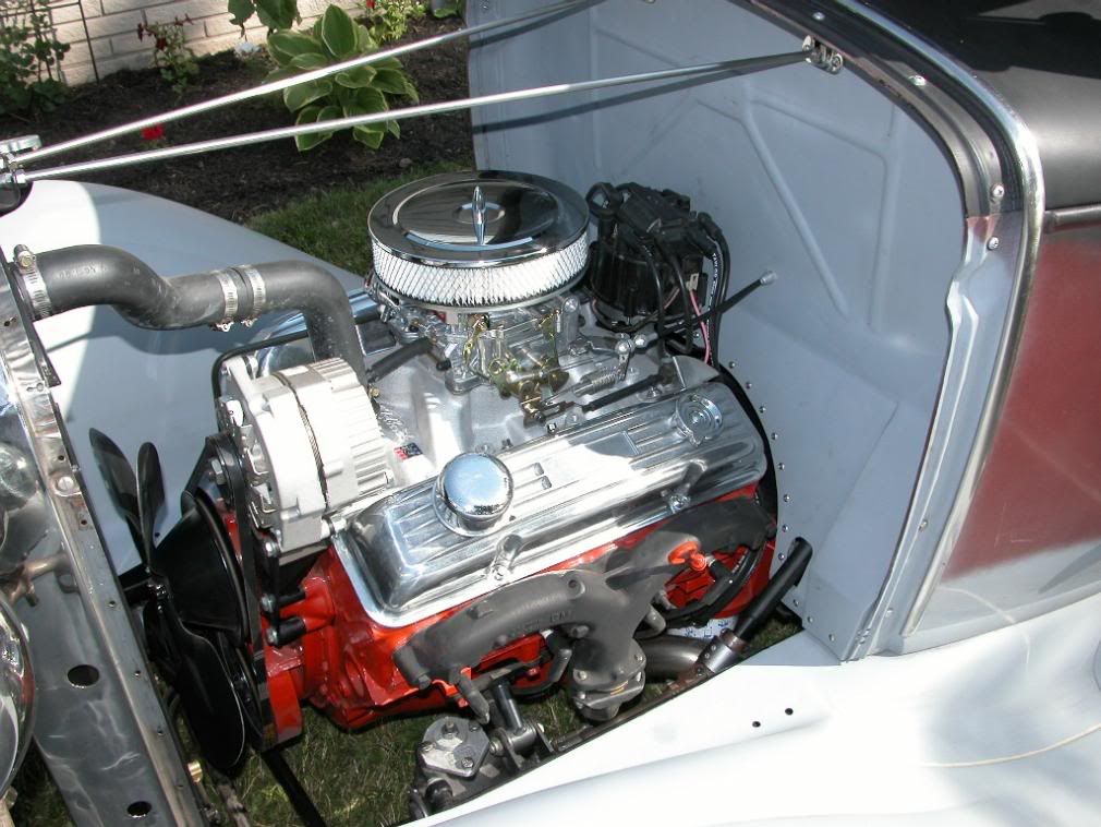

horsepower Posted July 18, 2016 Posted July 18, 2016 On 7/18/2016 at 5:30 AM, Toner283 said: :Actually, that one will be easy. The firewall is flipped in our car. I will get it for you tomorrow afternoon. Doesn't looking at the picture of this 1:1 A make you wonder why the headers on Revell's coupe have to have that funky kink in them to clear the steering shaft, and why did they do it on the other side too, unless they plan on putting a right hand steering dash in for those who are from the areas who have them.

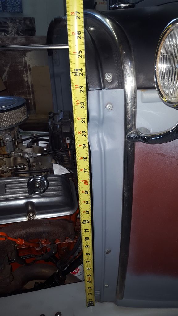

Toner283 Posted July 20, 2016 Posted July 20, 2016 Ok folks, a day later than I planned but here are the measurements off of a real deal Henry steel 1930 Model A Coupe. This is an unchopped unmolested original steel body. The only reproduction parts on the car are the rear fenders. Putting up the pictures will take a few posts so bear with me. First off, the measurement that Bill asked for. This is the width where the gas tank top meets the cowl sides on each side. The gas tank top is black and the cowl sides are grey primer. The second pic is from the bottom edge of the body to where the cowl side and the gas tank to meet.

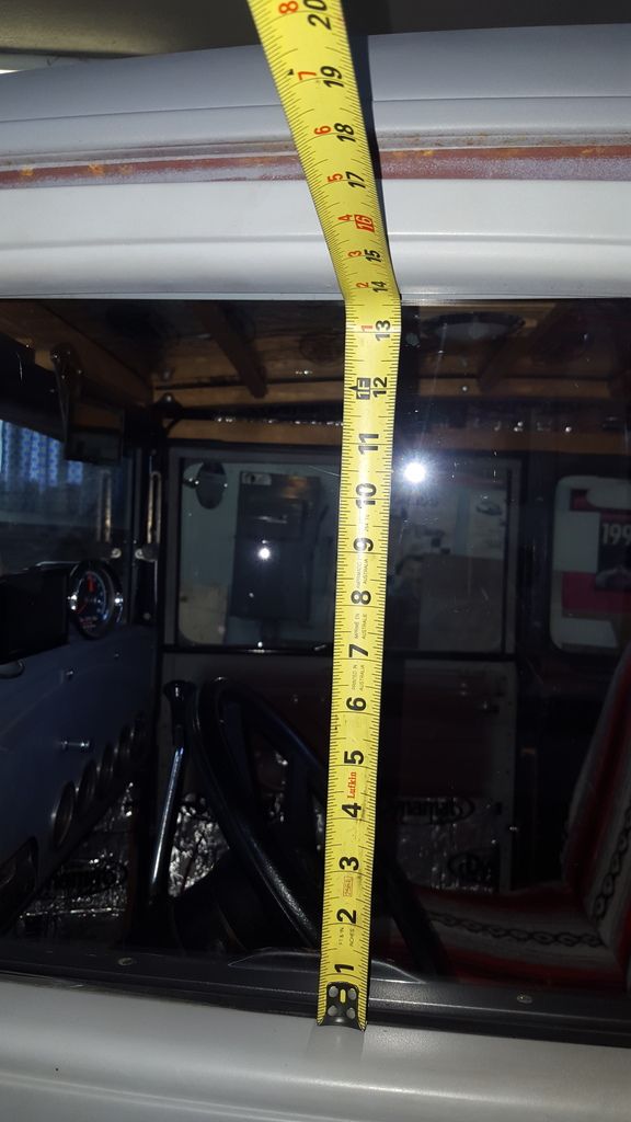

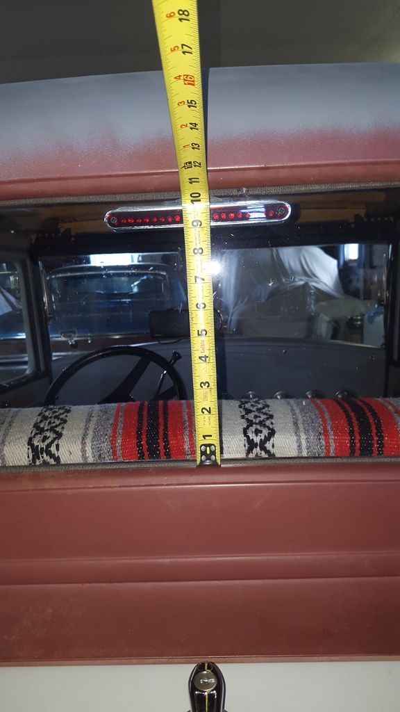

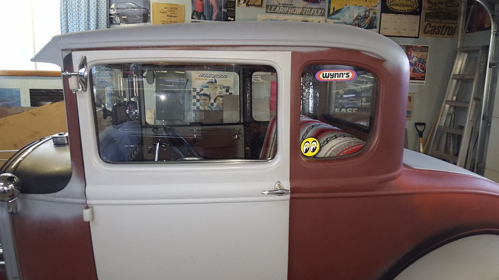

Toner283 Posted July 20, 2016 Posted July 20, 2016 (edited) Someone asked how much the new kit is chopped. Here is the measurements for a stock height roof. Note the shape of the quarter windows. Also note that the top of the door window is not straight but has an arch to it. Edited July 20, 2016 by Toner283
