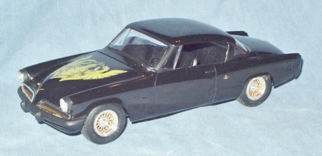

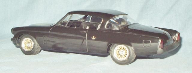

Shooting black is no different from shooting any other color. It's not magic or evil.
What it DOES do is tend to show up any flaws in bodywork (like wavy panels, because it acts like a mirror, and reflections will not be 'true' if there are flaws in the surface).
It also shows orange peel or dry spray, for much the same reason.
High quality black has a lot of pigment and will completely cover ANY color undercoat. It just doesn't matter.
Do your prep right, shoot several decent coats, sand and polish it like you'd do any quality paint job, and it will look great.
There's no magic. This is the cheapest rattlecan black lacquer from Ace Hardware. The minor orange peel will polish out.
Same body after a light sanding and hand-compounding.

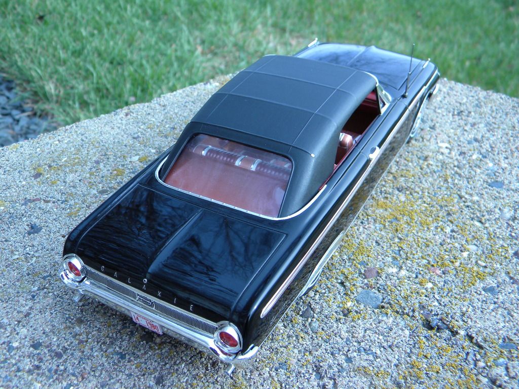

^That looks really nice
Is the top masking tape?
Steve, that convertible top is the perfect finish. What paint?
:lol:
Testors flat black guys, right over the kit plastic.
Then rubbed over with fingers tips.
I've been amazed at how many people I've had ask me how I finished this top.
The answer is so simple that I don't think some people believe me. :P
Steve
Steve
