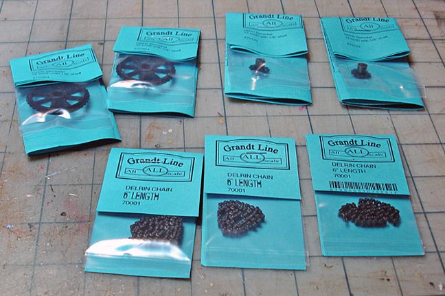

Harry P. Posted August 22, 2016 Author Posted August 22, 2016 The Grandt Line chains and sprockets came today... The chain is sold in 6" lengths, I need two finished drive chains 8" long, so I had to buy three chains.

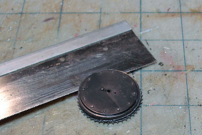

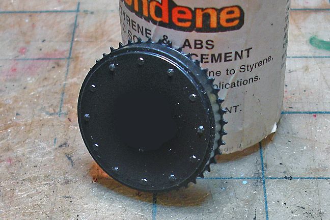

Harry P. Posted August 22, 2016 Author Posted August 22, 2016 The pitch of a roller chain is the distance between the rollers. The Grandt Line chain has a slightly larger pitch than the kit-supplied chain, so I couldn't use the kit sprockets... the aftermarket chain would not fit properly onto the teeth of the kit sprockets. That's why I had to buy new sprockets, too. Here is one of the two kit rear sprockets... First step is to use a razor saw to cut the ring of teeth off the kit sprockets...

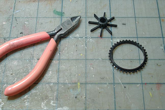

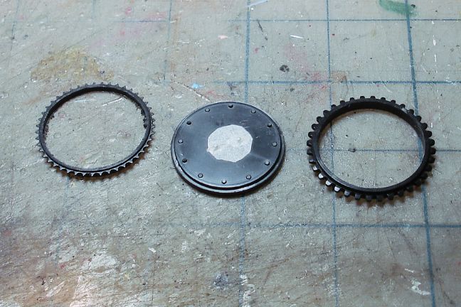

Harry P. Posted August 22, 2016 Author Posted August 22, 2016 Next, the spokes and hub of the Grandt Line sprockets had to be removed. All I want is the ring of teeth...
Harry P. Posted August 22, 2016 Author Posted August 22, 2016 Here is the kit sprocket teeth removed from the kit sprocket (center), and the replacement teeth on the right... The circle of tape on the sprocket is where it glues to the back of the rear wheel. By taping off the area now, I can then paint the sprocket, peel off the tape and reveal the bare plastic gluing surface. No paint scraping necessary!

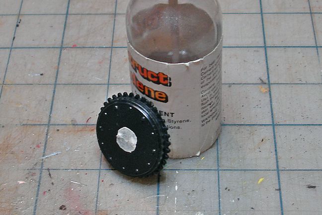

Harry P. Posted August 23, 2016 Author Posted August 23, 2016 Revised sprocket with Grandt Line gear teeth... I got lucky. The diameter of the aftermarket gear ring and the kit sprocket front is identical! In fact, in this photo it's almost impossible to see the joint (as in real life).

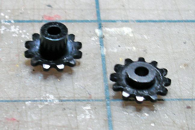

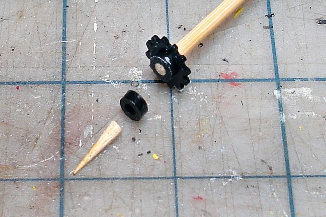

Harry P. Posted August 23, 2016 Author Posted August 23, 2016 The Grandt Line front sprockets also needed changes made so they would work on the model. First, about half of the protruding mounting shaft was sawn off with a razor saw. Before (left) and after (right)... A brave shish-ka-bob skewer gave its life in this operation (man, those things really have 1,001 uses!).
