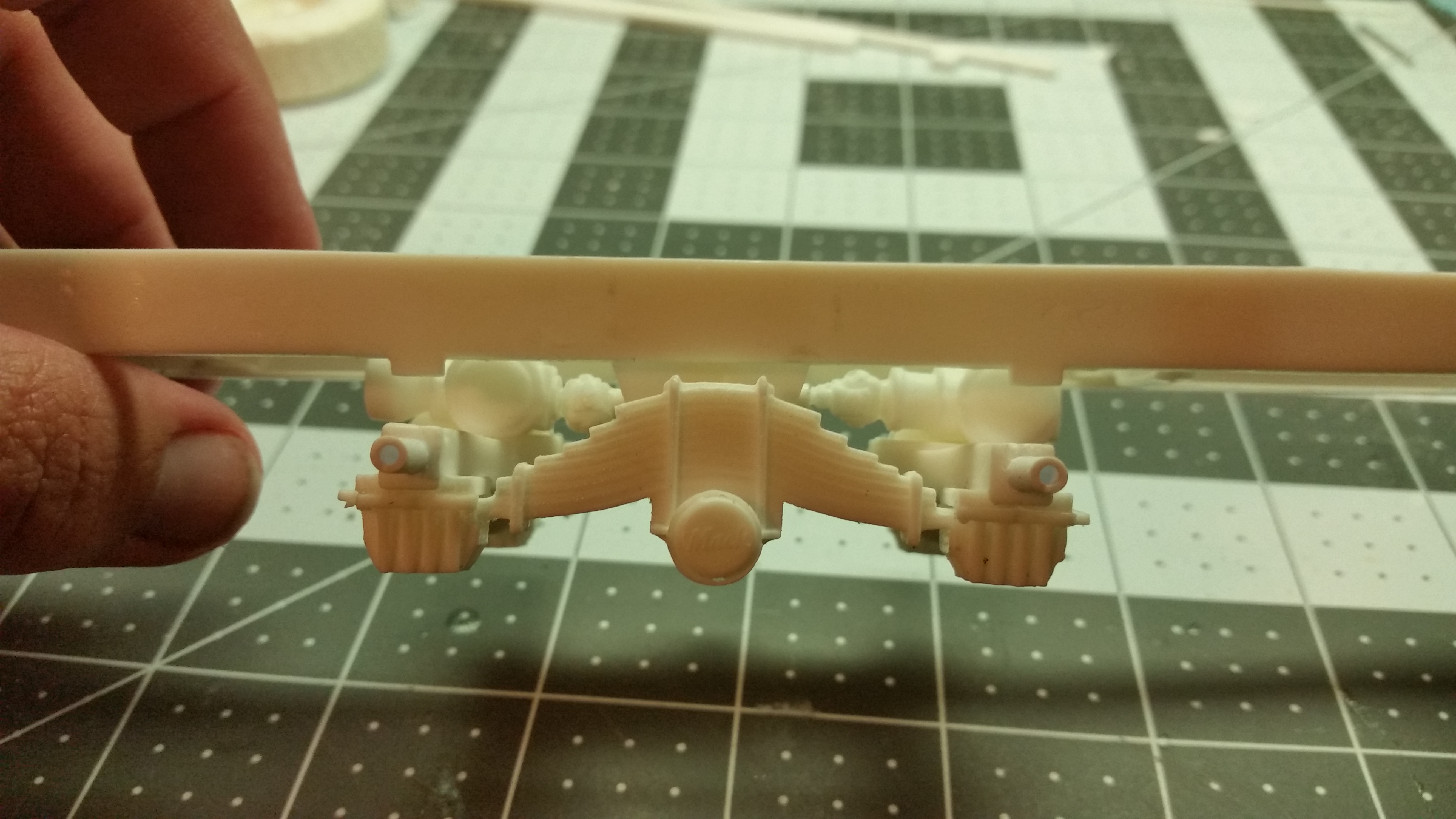

gotnitro? Posted August 8, 2016 Posted August 8, 2016 (edited) well guys, its been a long time since my last build. My wife and I was blessed to have a beautiful baby girl enter our lives!! A few months of getting into a routine..which I never thought would happen..well our little angel sleeps enough to grant me a few hours to build. This time around, I'll be building a truck commonly seen around our roads. This project is fun for me since the majority of the needed parts are available thru the AM, and I wont need to fab everything. The list of goodies includes- DM 800 mixer Frame, resin Mack 6 spoke wheels, MTM McNeilus mixer mastered by Chris Davis, cast thru AITM trucks. I'll be using a Mack 690 cab from GW trucks..and a few surprises along the way. The major part for me is the scratch built Theam conveyor belt . The main reference Ive been using is riding along on a Paystar.. I started by mocking up the DM 800 frame..which everyone here has seen..so pics wont be needed! I left off the fish plates so the new Mack camelback suspension Gary Wallace has, will properly fit the frames.These trucks commonly had double frames, and the mixer kit has these already. Adding the plates made an almost triple frame much heavier than the truck I'm portraying. Edited March 1, 2018 by gotnitro? Fixing hosting issue

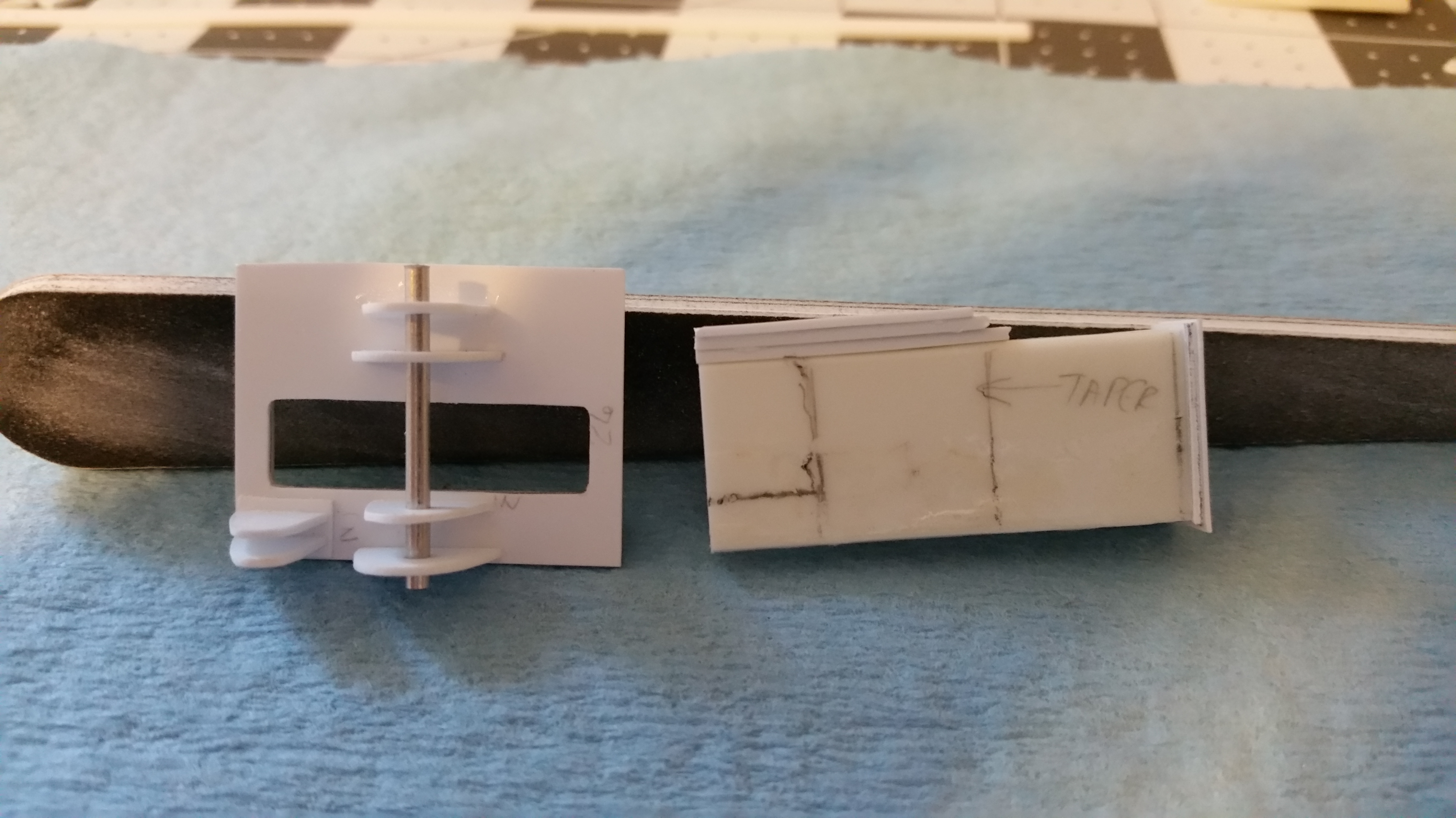

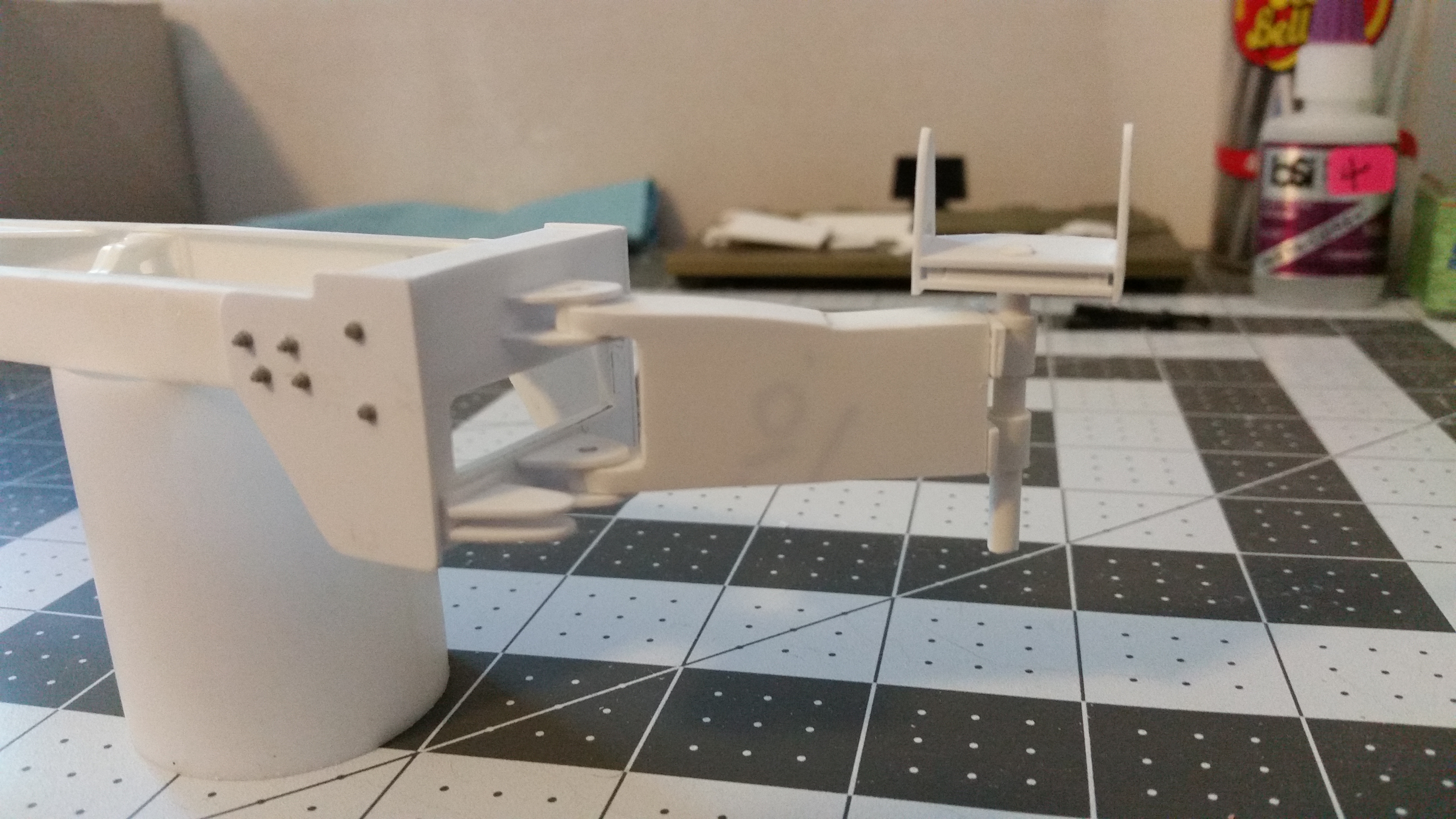

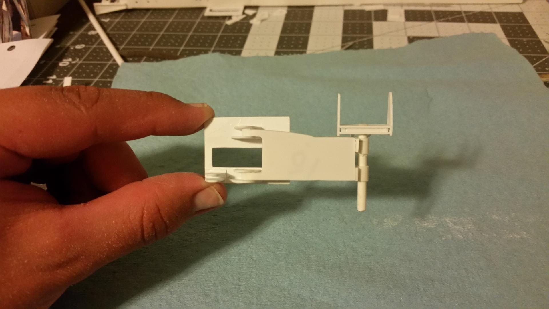

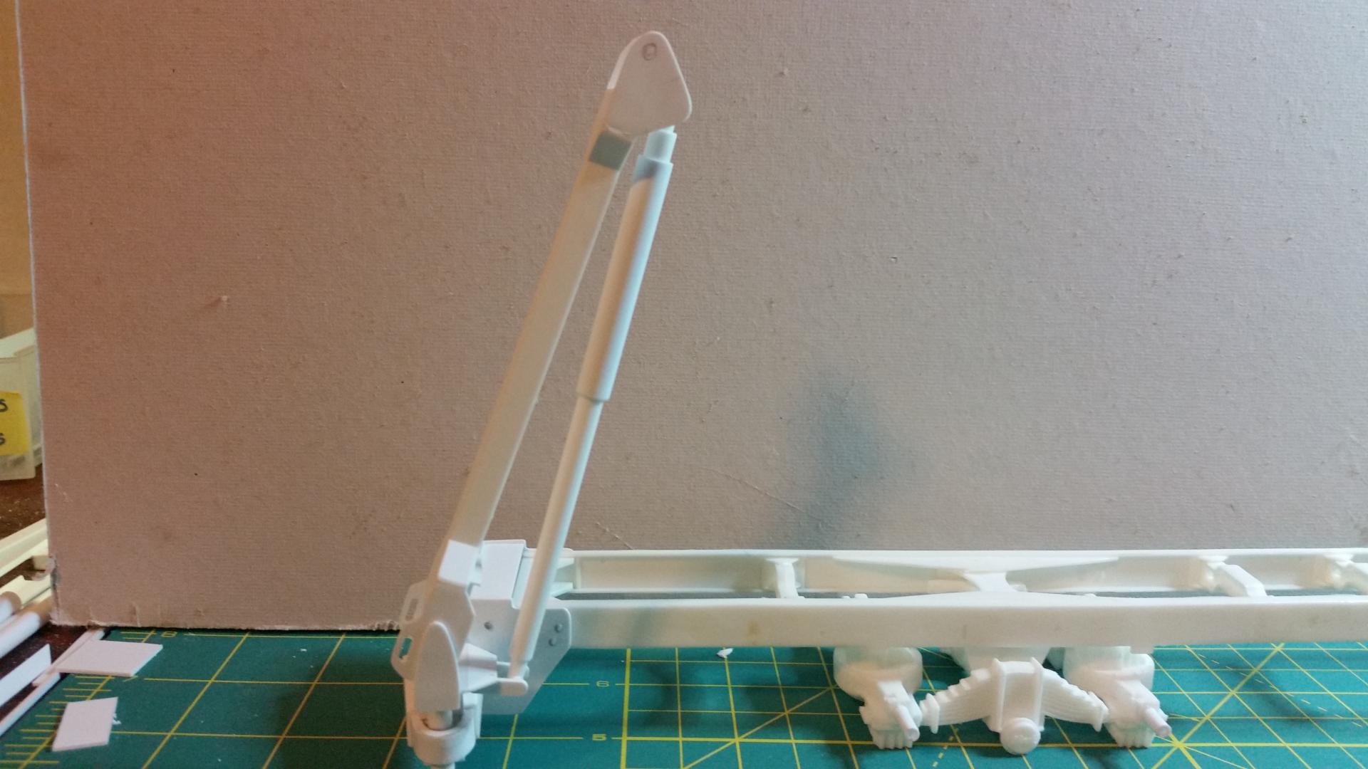

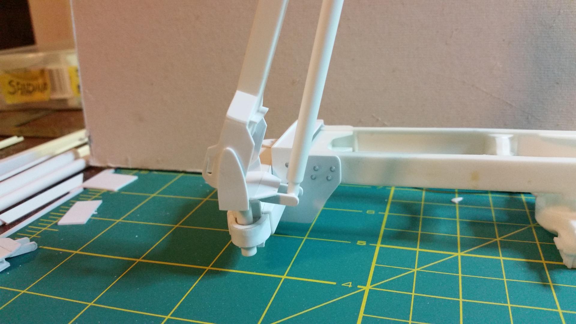

gotnitro? Posted August 8, 2016 Author Posted August 8, 2016 (edited) I started the main mount for the conveyor using .030 sheet. A few Meng bolts will add details later. The "Maxi -Pivot" arm is a focal point on these truck. This arm carries the entire belt on a chain driven , rotating arm. Normally stowed/ folded along the side of the truck , once at the jobsite, the operator will remotely unfold the arm, pouring the cement into place keeping the truck a distance away! Watching the driver curl the arm , reminded me of a scorpion. The arm was built using the fish plates, and laminated strips . Using pics, I later sanded the taper and profile into the main body. The conveyor pedestal came next, a few hours later I had this..a working Maxi Pivot arm !! Thanks for looking , any feedback welcome! Jeff Edited March 1, 2018 by gotnitro? Fixing hosting issue

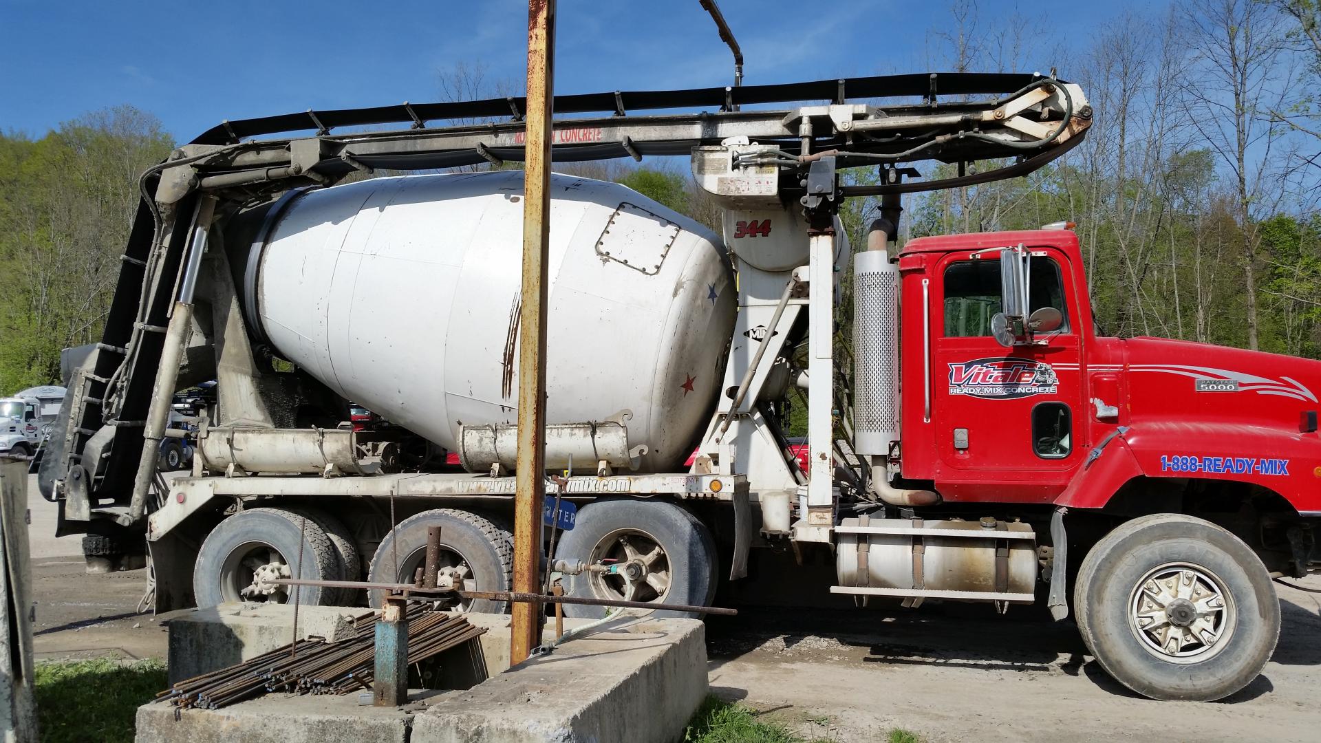

gotnitro? Posted August 8, 2016 Author Posted August 8, 2016 (edited) Thanks everyone, I appreciate the feedback !! I had a surprise last night while working on a few parts. My little girl came and hung out , so I stashed all the toxic stuff and found a few toys for her to play with. Dan- about the truck, the DMM is usually a twin steer heavy duty truck. They also built several in single front axle, but normally all have all wheel drive capability. This truck is a 6X6. The Theam conveyor is a bolt on rear mounted assembly, allowing more flexibility to placing the cement. The unfolded belt on this model is around 40 ft. The cool part is the ability to swing the entire unit getting into tighter places then a "normal" mixer allows. I just received a large box from Egg Harbor so I'll have another update shortly Jeff Edited March 1, 2018 by gotnitro?

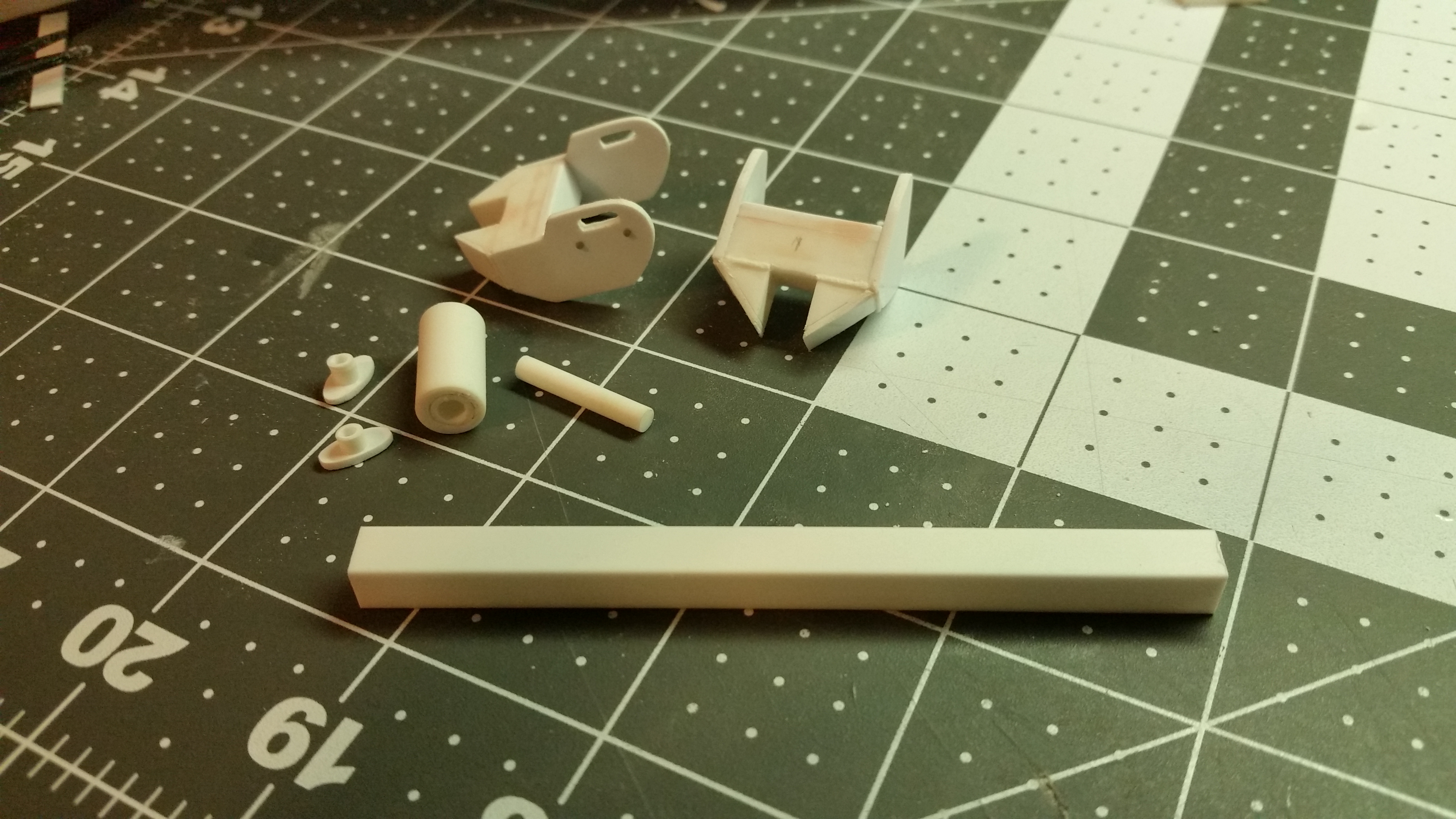

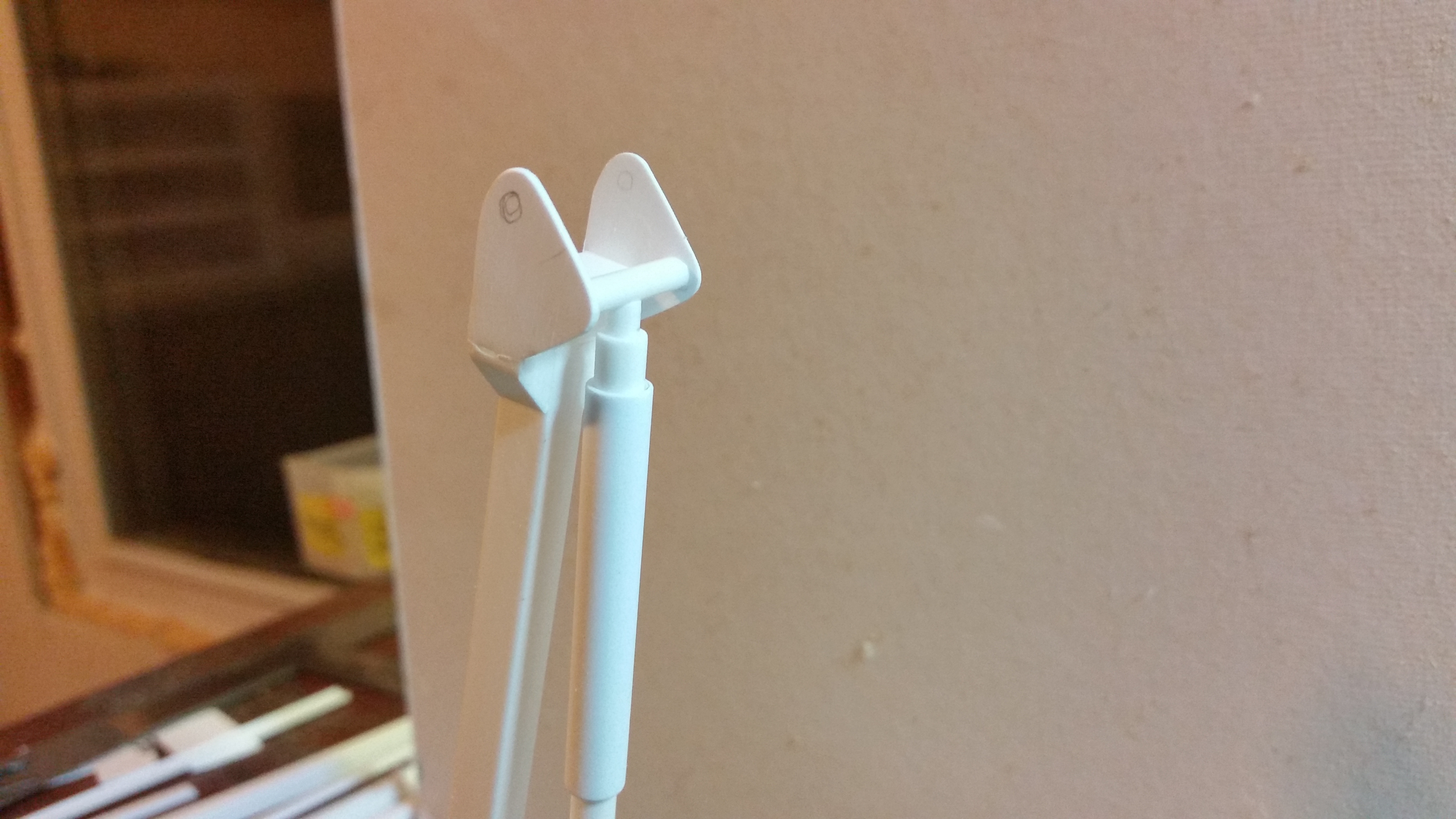

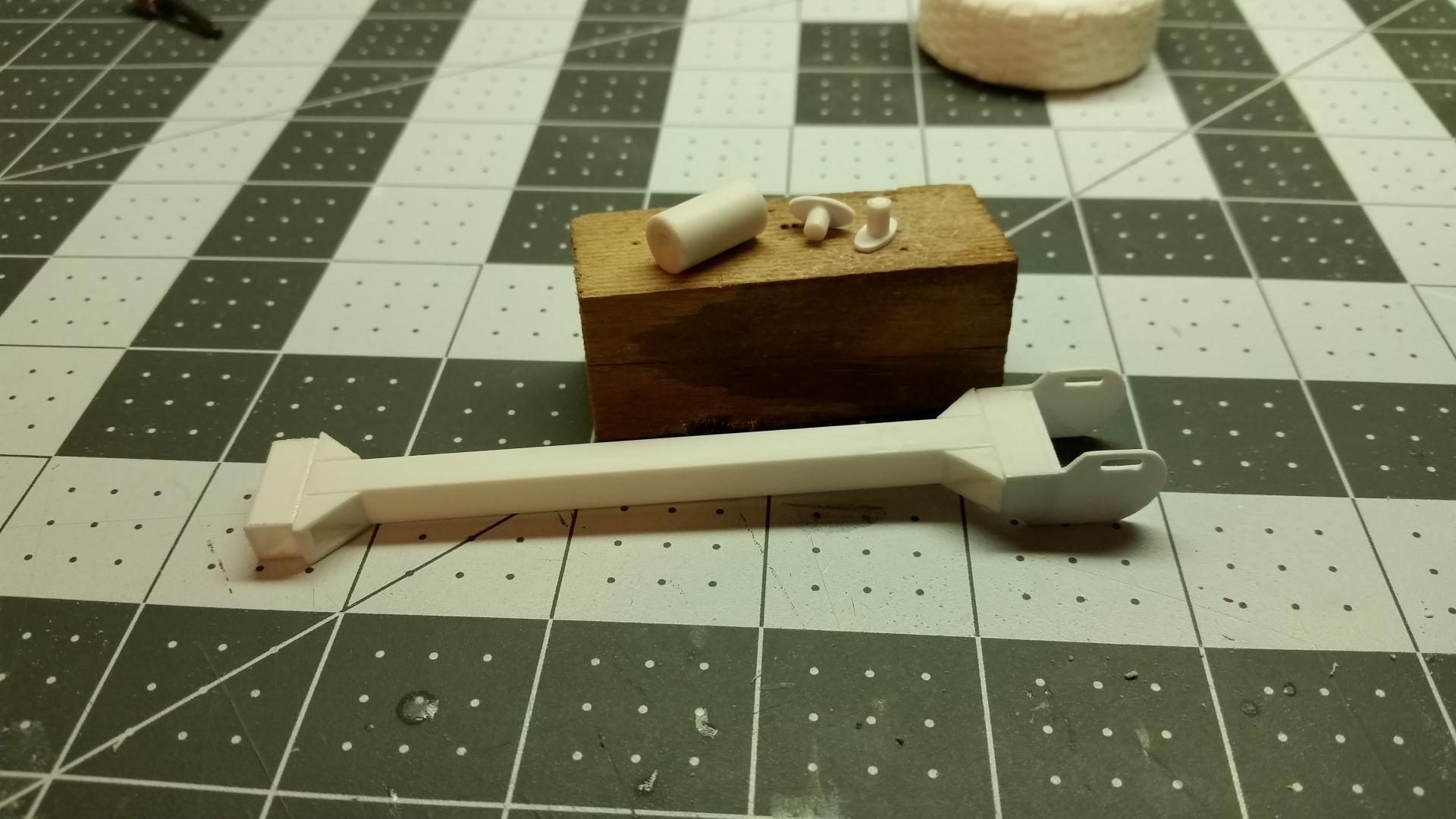

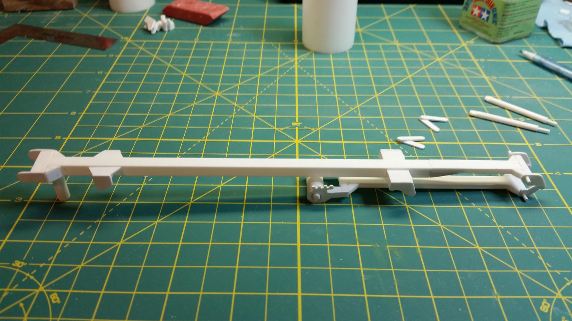

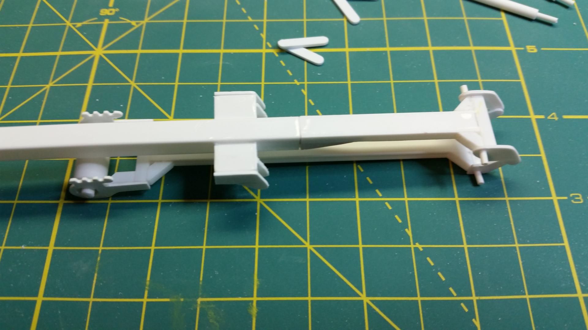

gotnitro? Posted August 12, 2016 Author Posted August 12, 2016 (edited) Thanks on the comments about my daughter, she's been keeping us on our toes! I forgot what 2 hrs sleep felt like...finally sleeping a full night! Glad everyone likes the progress, I started the first of the 3 folding sections, basically just square tubing for the boom body and telescopic tubing for the hydraulic cylinder that extends the sections . Found a couple pics didn't show the detail I'd hoped, so it's back to the plant ! Jeff Edited March 1, 2018 by gotnitro?

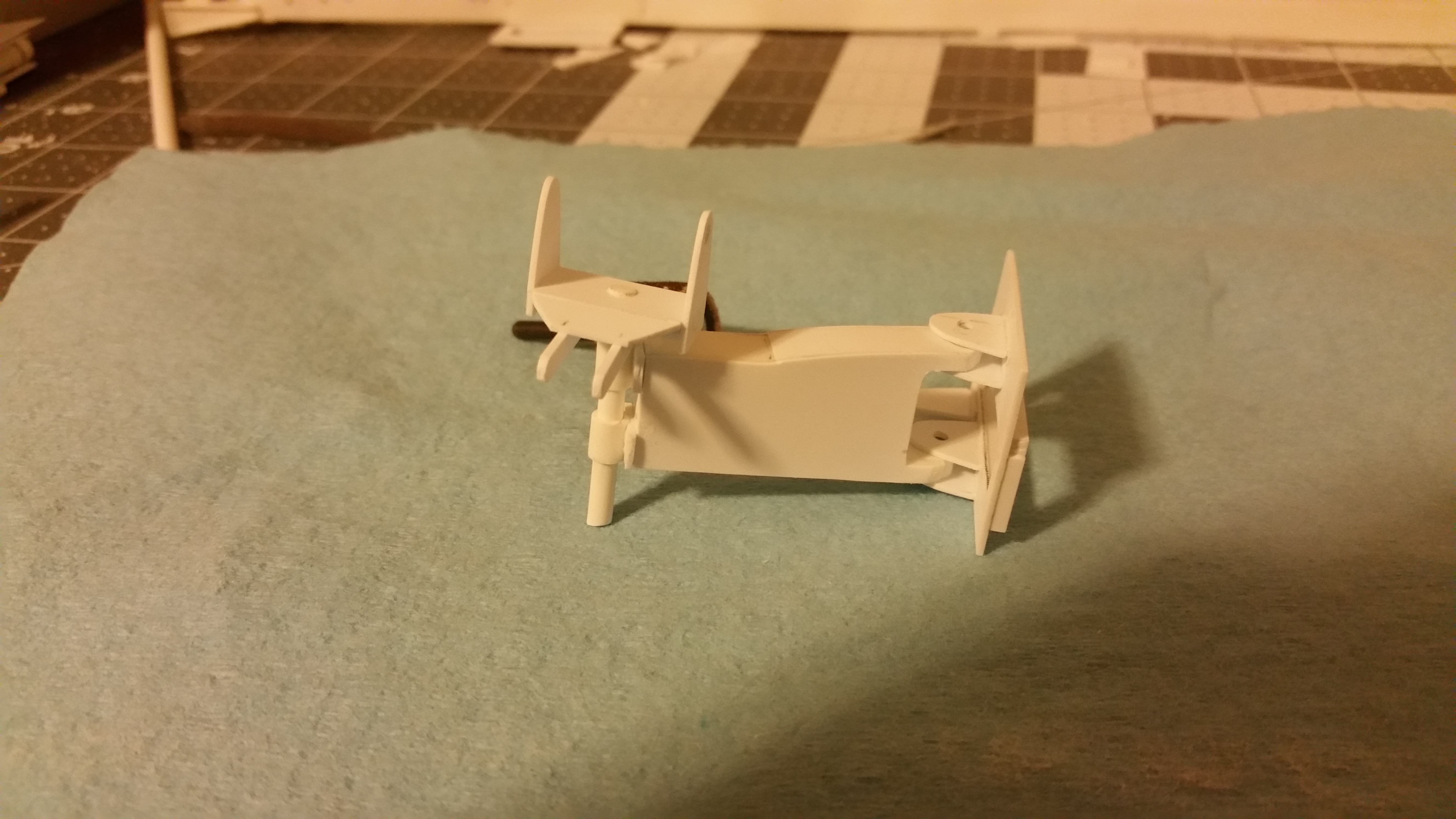

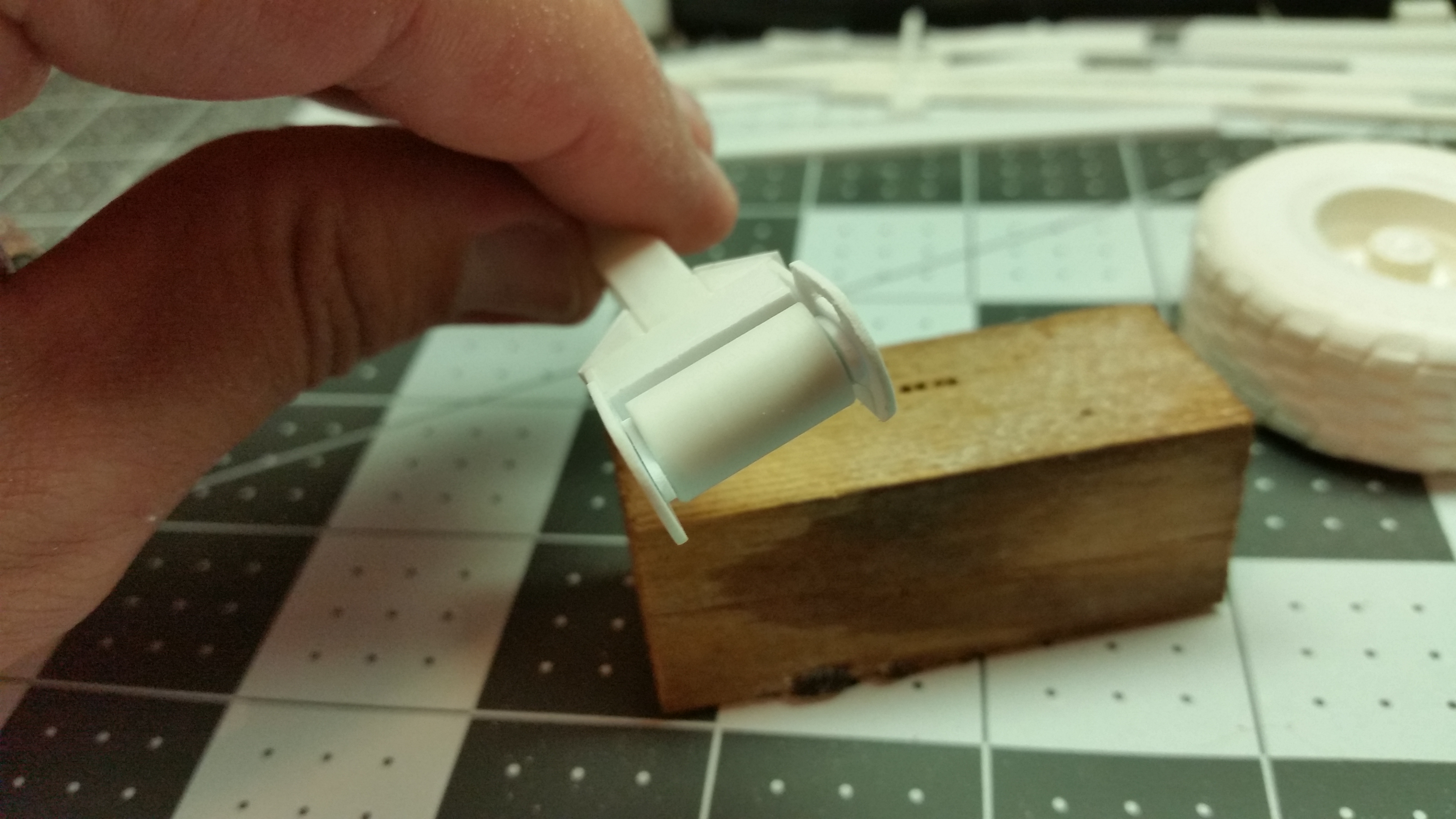

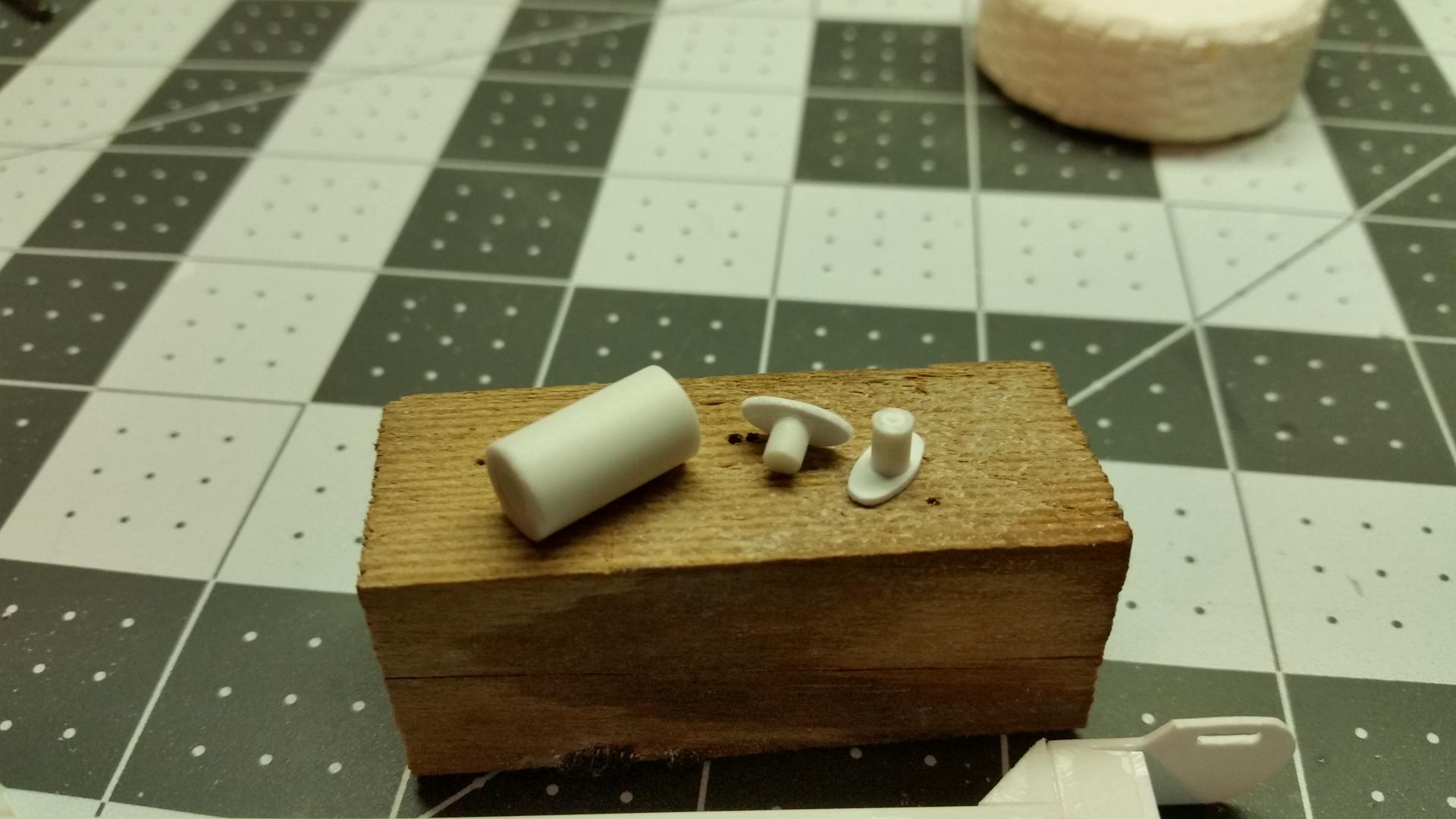

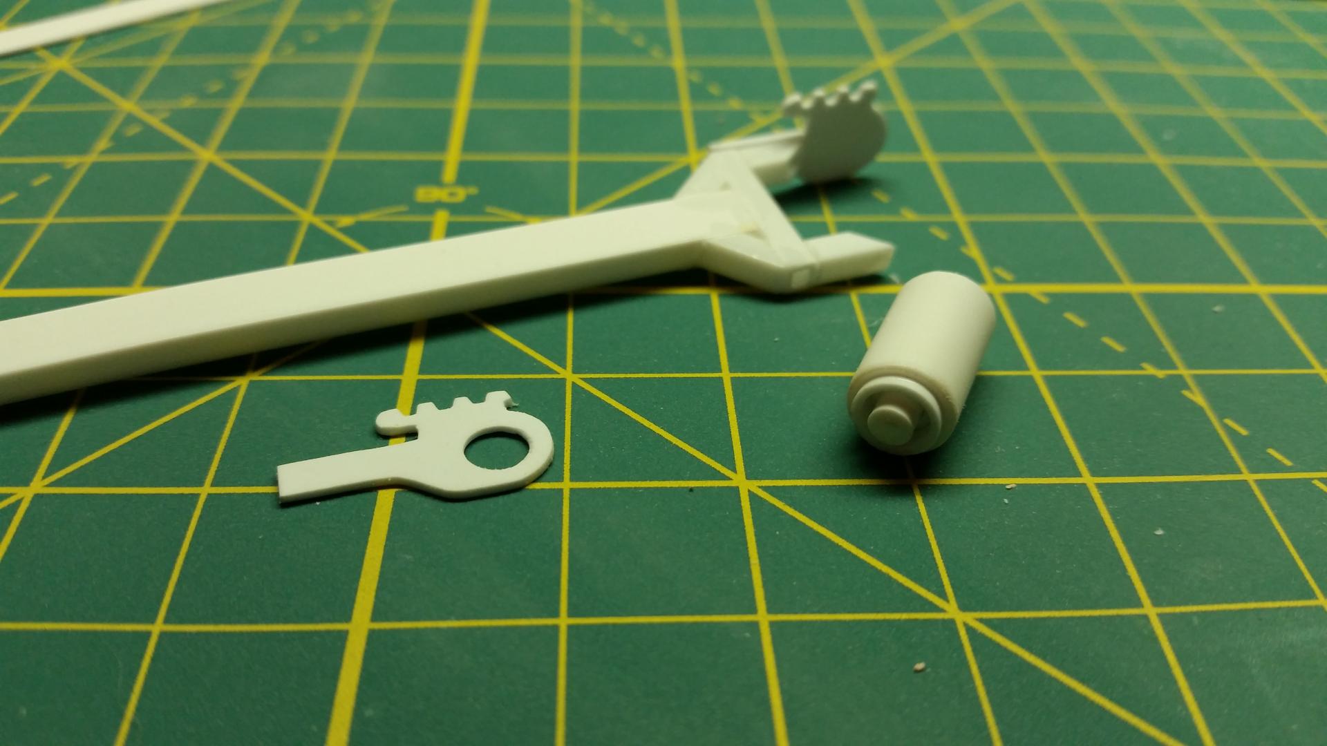

gotnitro? Posted October 19, 2016 Author Posted October 19, 2016 (edited) ok, back at it !! sorry for the long delay..I've been busy getting the major parts built. I needed better pics so a visit to the repair shop luckily had a conveyor apart for maintenance the first section had the "head roller " rolling on bearings..so..I made everything I could thanks for looking! Edited March 1, 2018 by gotnitro?

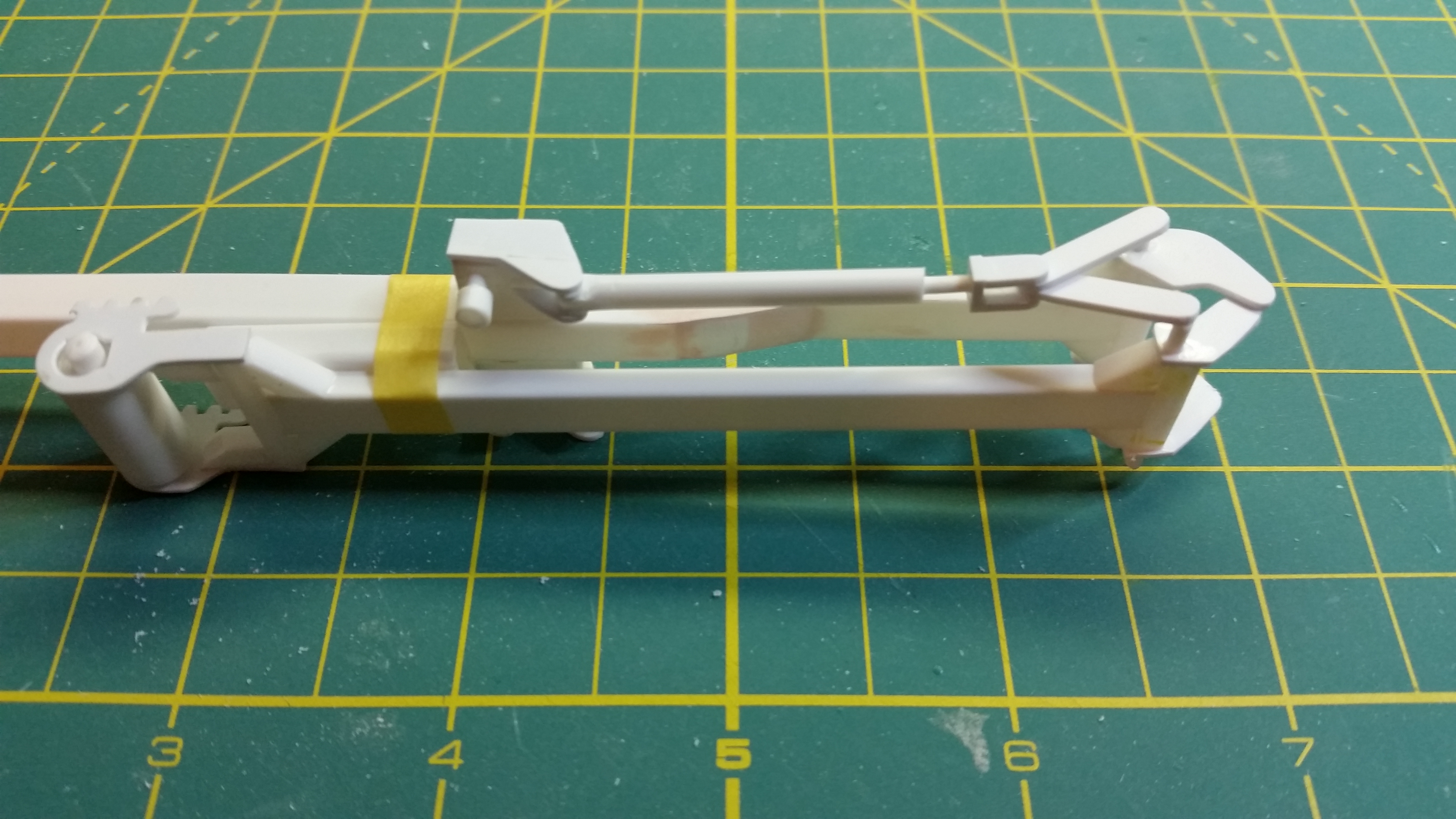

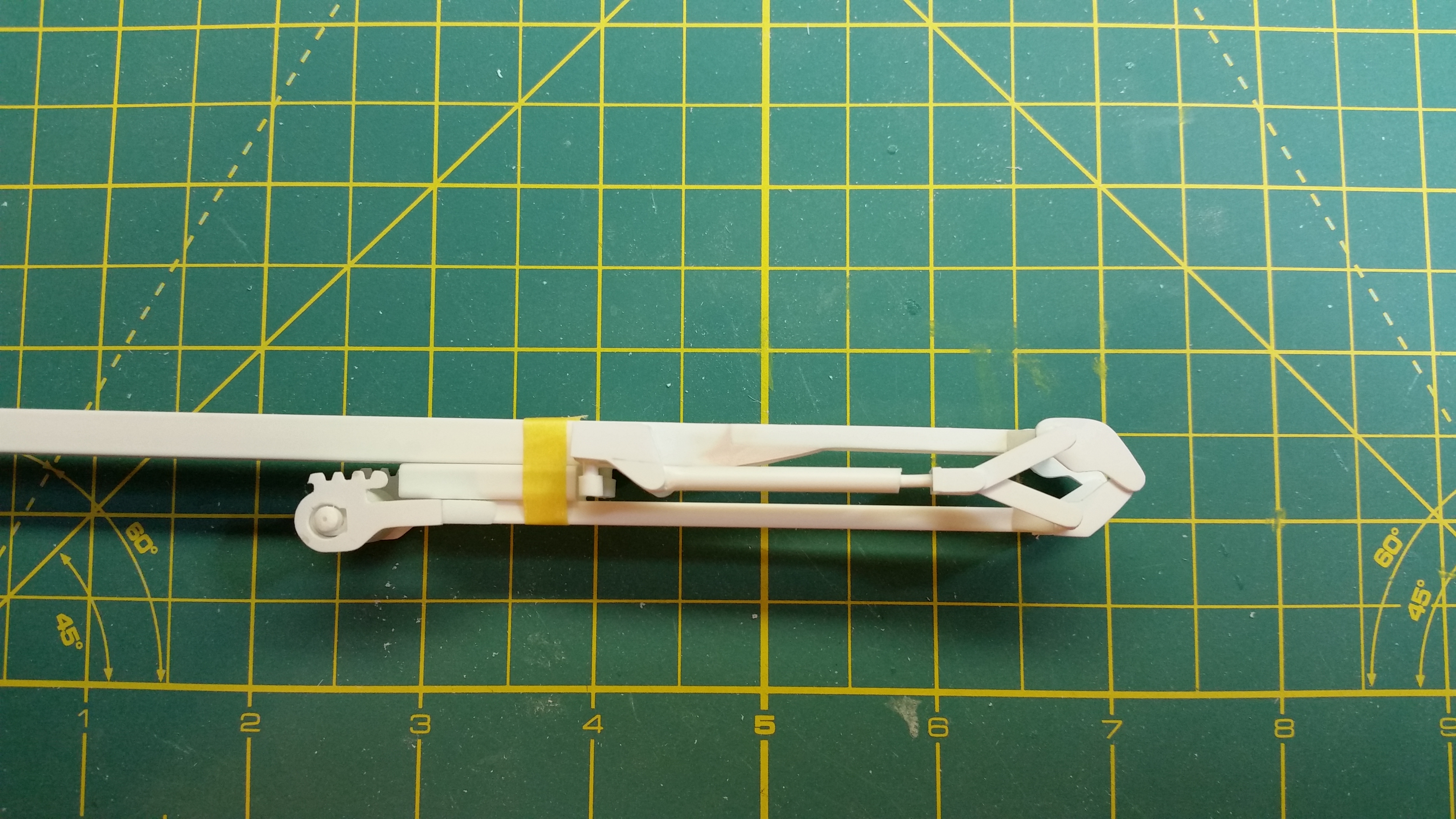

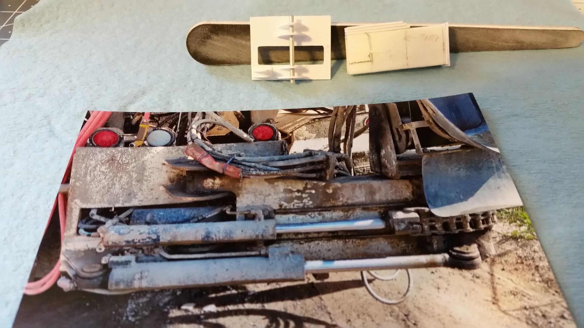

gotnitro? Posted October 19, 2016 Author Posted October 19, 2016 (edited) ok..now skip ahead to the "folding section" I call the stinger. Here we have the driven main roller, the side plates, and support framework ! All these parts were built from images from pics Gary W and I have taken, or the parts manual.. I used plastic tubing of random sizes based off the images, once I had the "stinger" length I wanted., the center section was next !! Square tubing was used for the main boom w a smaller size inside for added strength . The accessories were added then my favorite part ..MOCK UP !! Edited March 1, 2018 by gotnitro?

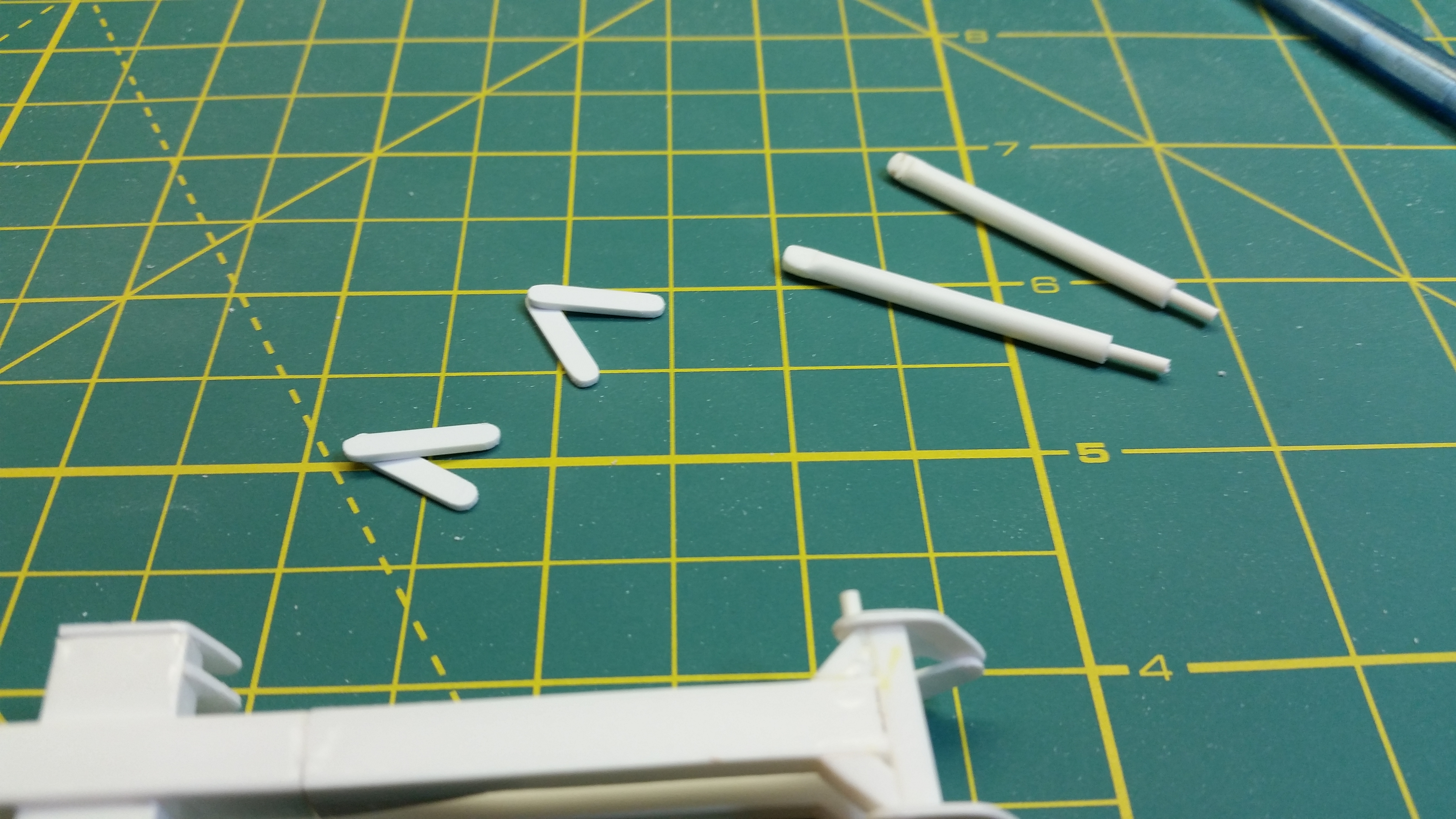

gotnitro? Posted October 19, 2016 Author Posted October 19, 2016 (edited) lurking in the background, you"ll notice the parts for the next step. A few tubes pretending to be cylinders, flat strips for plates..and other bits. glue together and its ready for another mock up !!! That's it for now !!! thanks for looking ! Jeff Edited March 1, 2018 by gotnitro? Fixing hosting issue
