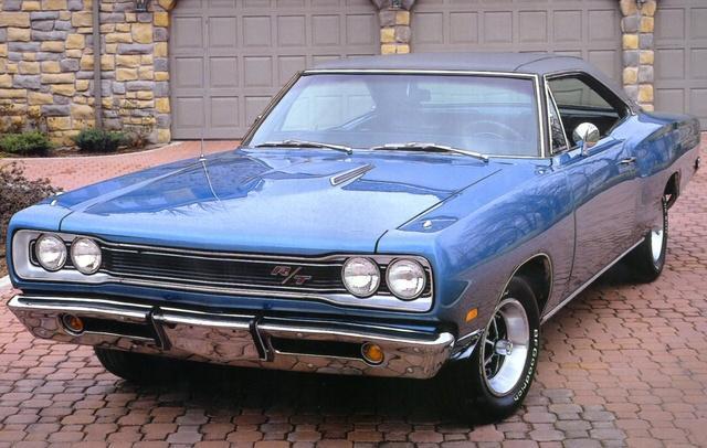

StevenGuthmiller Posted September 28, 2016 Author Posted September 28, 2016 (edited) The AO1 light pkg was optional. But am pretty sure wheel lip mouldings as well as rocker mldgs were standard on an R/T That's kind of what I was thinking. Which is why I was a little baffled to see pictures like this. Steve Edited September 28, 2016 by StevenGuthmiller
gtx6970 Posted September 28, 2016 Posted September 28, 2016 Just ckd, both wheel lip and rocker mouldings were standard equipment on a 1969 Coronet R/T . Thats not to say the restorer didn't like them ( or didn't have them ) and just decided to leave them off.http://www.hamtramck-historical.com/images/dealerships/DealershipDataBook/1969/69_Coronet0021.jpg

StevenGuthmiller Posted September 29, 2016 Author Posted September 29, 2016 Just ckd, both wheel lip and rocker mouldings were standard equipment on a 1969 Coronet R/T . Thats not to say the restorer didn't like them ( or didn't have them ) and just decided to leave them off. http://www.hamtramck-historical.com/images/dealerships/DealershipDataBook/1969/69_Coronet0021.jpg I see by the list Bill, that the bumble bee stripe was also standard. Now, if I'm doing this as a stripe delete, my question would be, if you could get it without the stripe, do you think you could get it without the wheel trim? Because that's my story, & I'm stickin' to it. Steve

1972coronet Posted September 30, 2016 Posted September 30, 2016 There's also the assumption that the lineworkers at Hamtramck, Los Angeles, et al. , read the buildsheet(s) ... or the mouldings weren't available when the car was built ... or the purchaser specified "delete" when the order was placed ( which likely equated to the dealer removing the mouldings upon delivery ).Could be that the blue beauty in that photo is an R/T clone .'Stripe Delete' was V88' ( "V"=Vinyl (or paint in certain instances) , "8"= Location , followed by W , X , G , R , Y , or 8 ; the second 8 indicates "delete" , with the other letters indicating colour)

High octane Posted September 30, 2016 Posted September 30, 2016 I see by the list Bill, that the bumble bee stripe was also standard. Now, if I'm doing this as a stripe delete, my question would be, if you could get it without the stripe, do you think you could get it without the wheel trim? Because that's my story, & I'm stickin' to it. Steve I believe the stripe could be deleted, but not the wheel trim.

Carmak Posted October 1, 2016 Posted October 1, 2016 That's kind of what I was thinking. Which is why I was a little baffled to see pictures like this. Steve This car is also missing the filler piece between the hood and the grille. The 68 and 69 hoods are the same except for the bolt on filler. As the filler is bolt on there is a panel line also.
StevenGuthmiller Posted October 1, 2016 Author Posted October 1, 2016 This car is also missing the filler piece between the hood and the grille. The 68 and 69 hoods are the same except for the bolt on filler. As the filler is bolt on there is a panel line also. Too late for any more panel lines now. Body has been painted for a while. I did manage to remember to scribe in the panel lines on the cowl & tulip panel though, something that the original kit lacked & one of those things that I sometimes have a hard time remembering to do. Steve
StevenGuthmiller Posted October 1, 2016 Author Posted October 1, 2016 This car is also missing the filler piece between the hood and the grille. The 68 and 69 hoods are the same except for the bolt on filler. As the filler is bolt on there is a panel line also. One thing that I just noticed from your photo also Craig is that the 1:1 doesn't seem to have the "vent" slots under the grille, yet the kit does. Something else I hadn't noticed until now. Oh well, I probably wouldn't have bothered to mess with that anyway. Steve
MrObsessive Posted October 1, 2016 Posted October 1, 2016 One thing that I just noticed from your photo also Craig is that the 1:1 doesn't seem to have the "vent" slots under the grille, yet the kit does. Something else I hadn't noticed until now. Oh well, I probably wouldn't have bothered to mess with that anyway. Steve Looks like those vents are there. You can just barely see the split of the vent in the middle of the bumper. BEAUTIFUL job so far as always on this car Steven!
