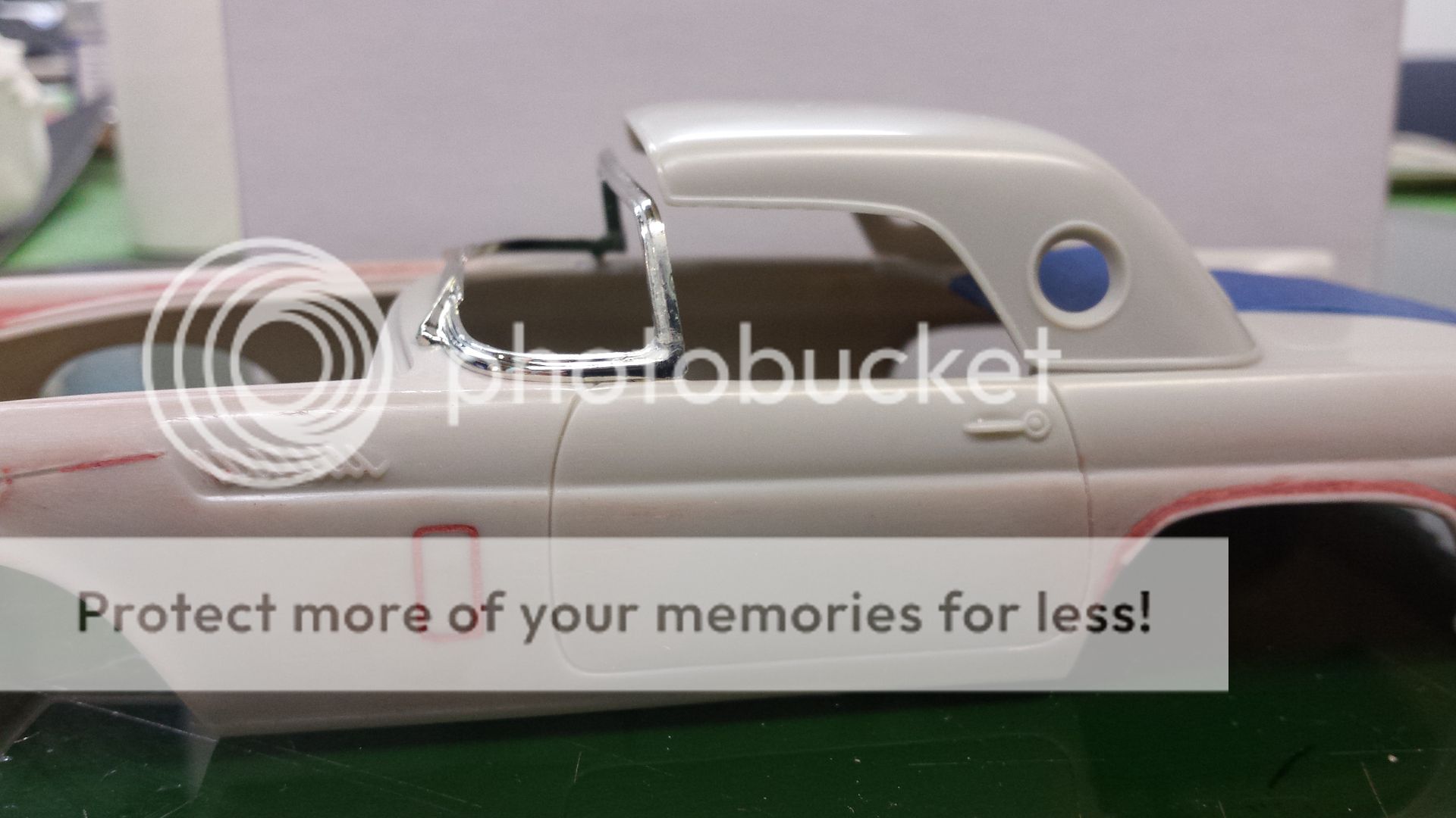

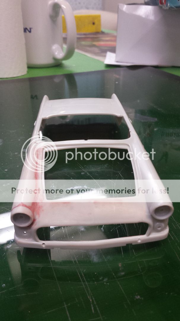

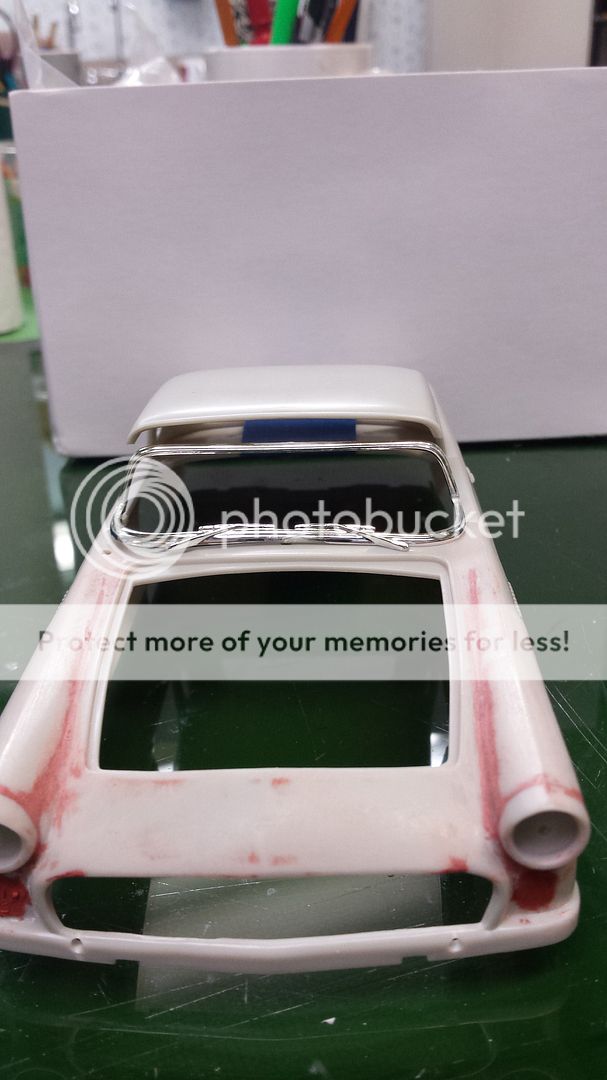

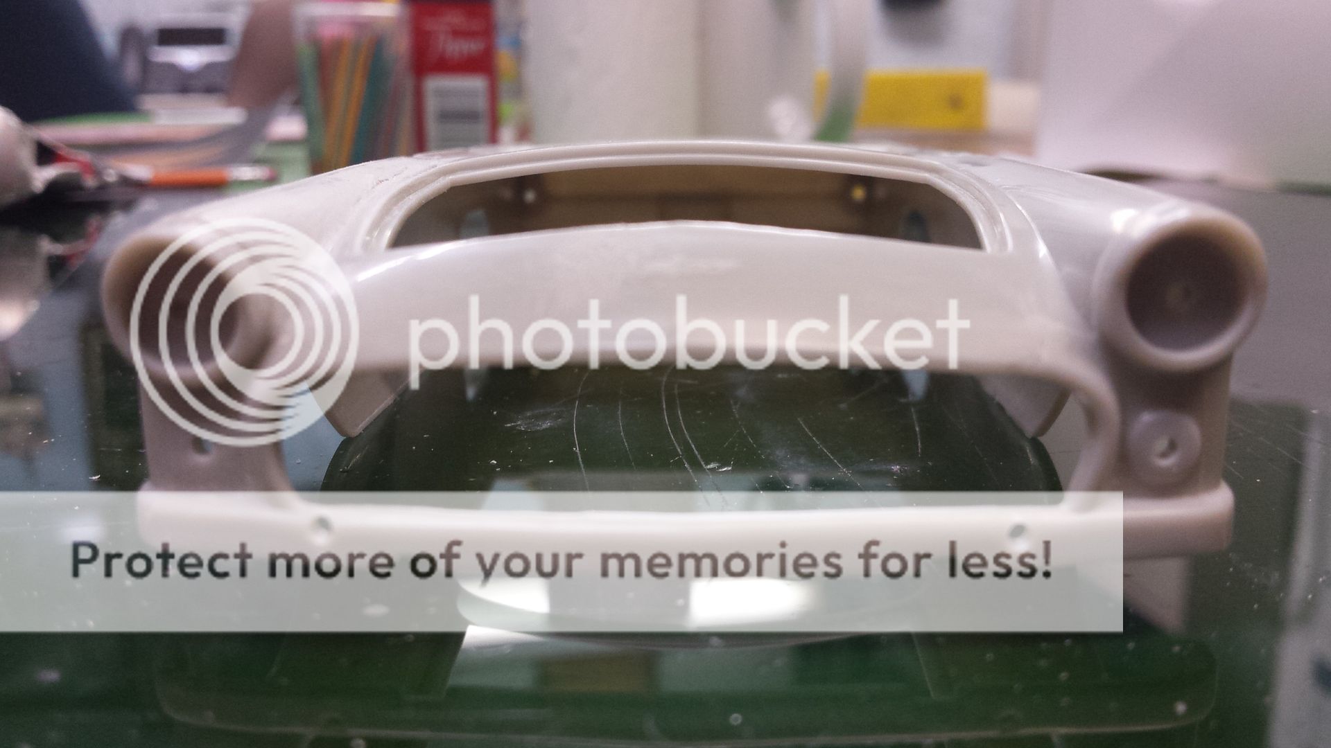

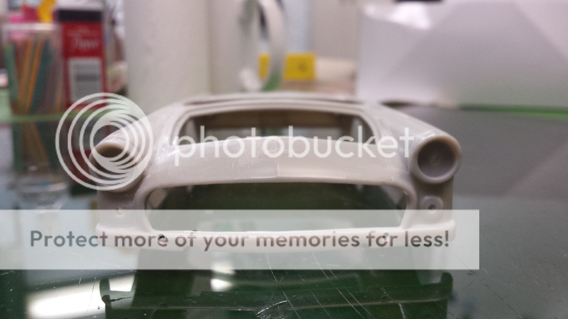

I began by lowering the headlights by cutting off the bezels and then pie cutting the fender. Then I reattached the bezel. Here you can see the passenger headlight on the left has been lowered. Driver's side is stock.
http://
http://
http://
 I also chopped the windshield frame, molded in the side vents and opened up the rear wheel wells and installed fender lip.
http://
http://
Lastly, I removed the hoodscoop.

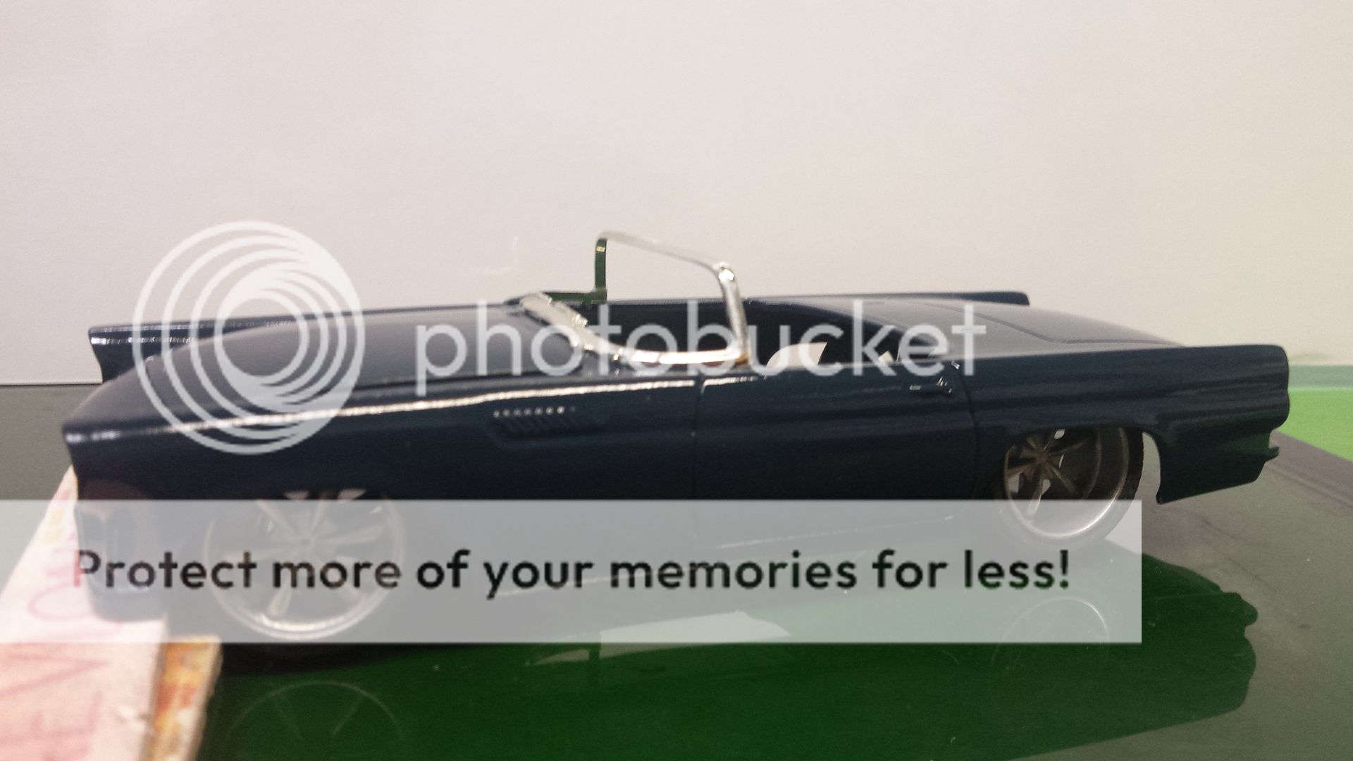

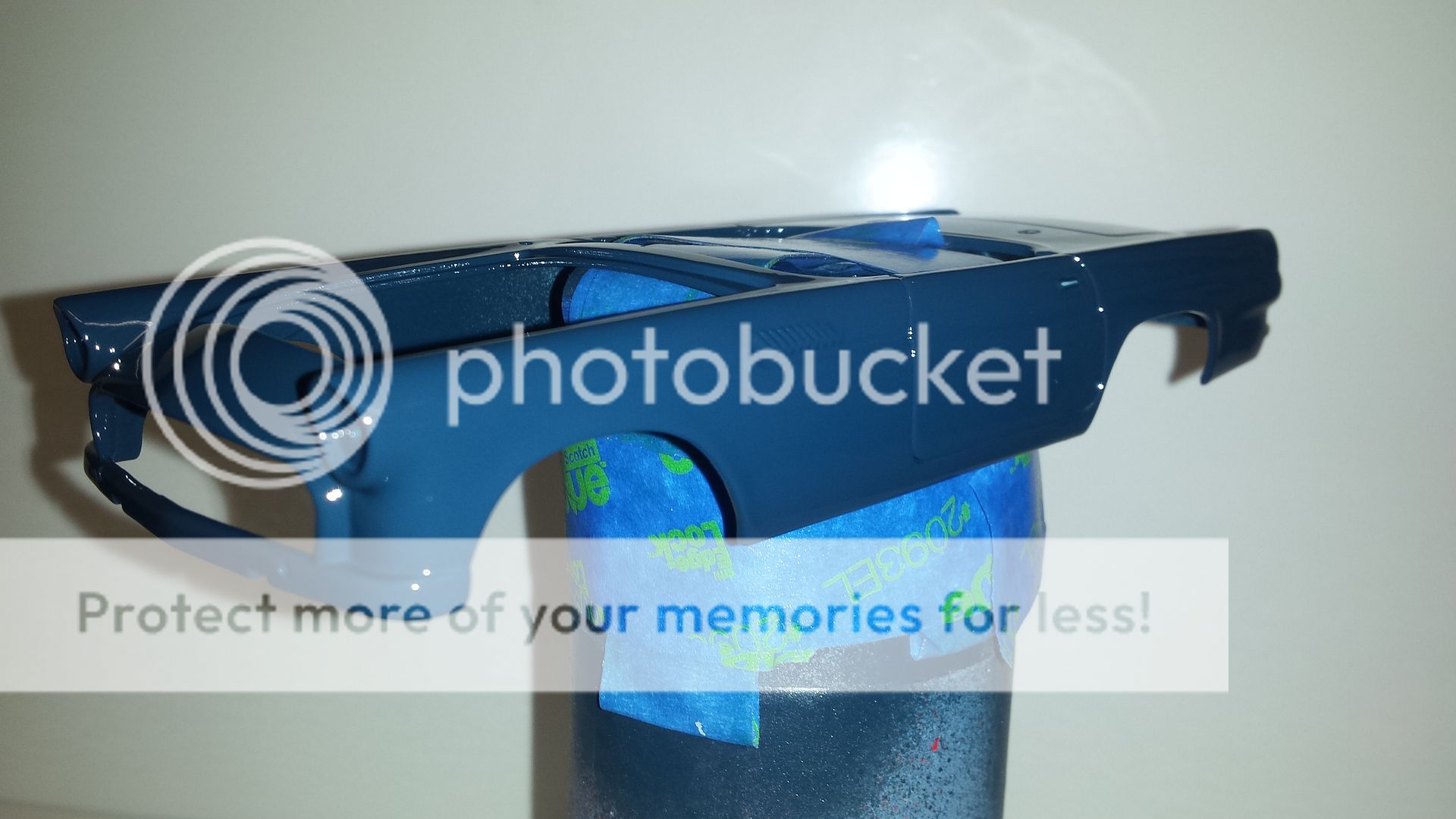

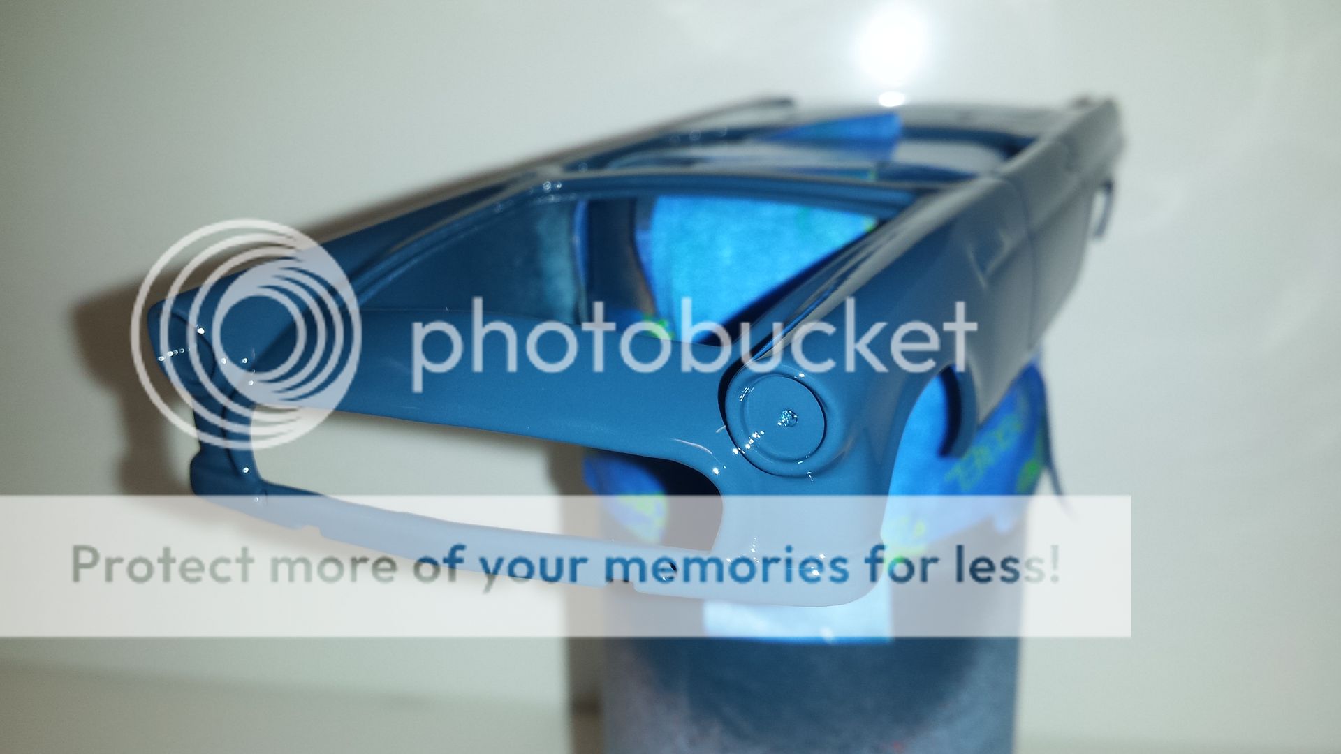

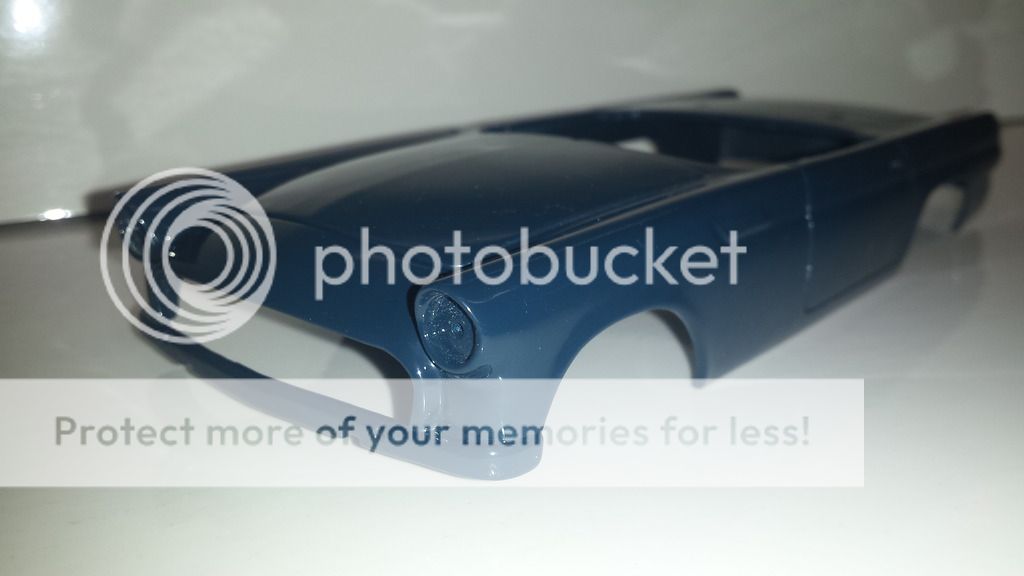

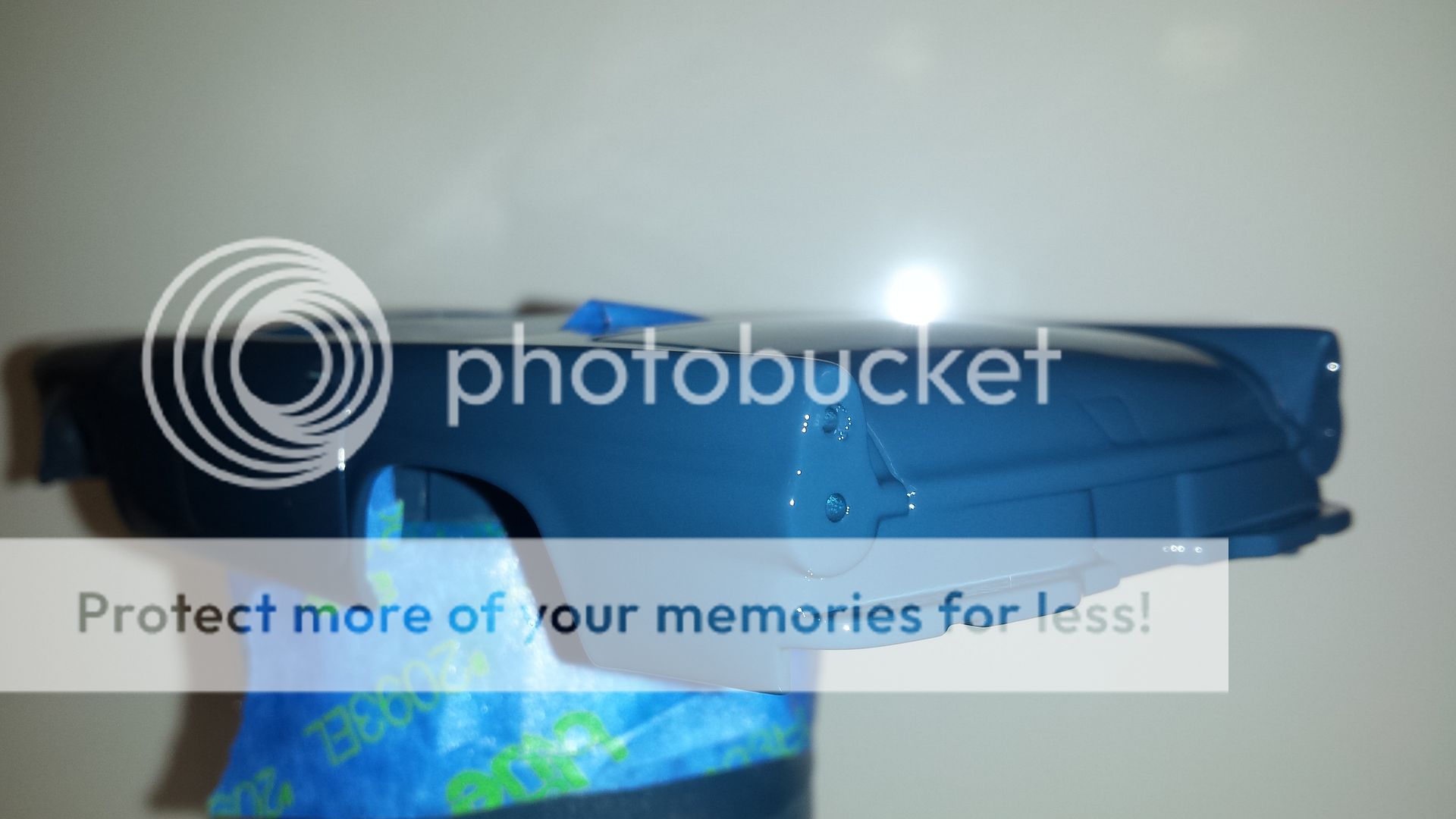

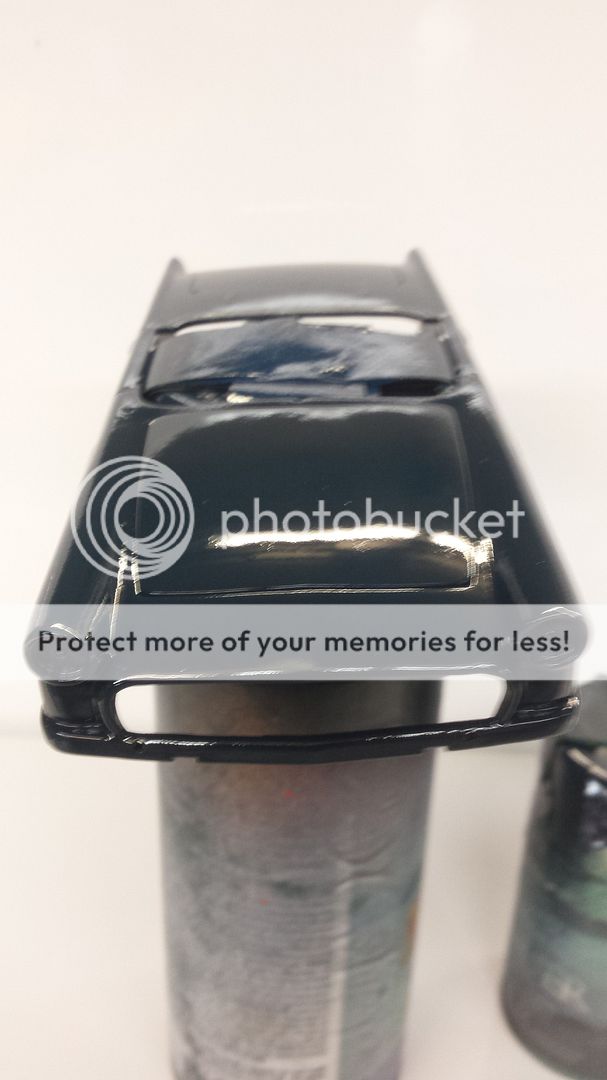

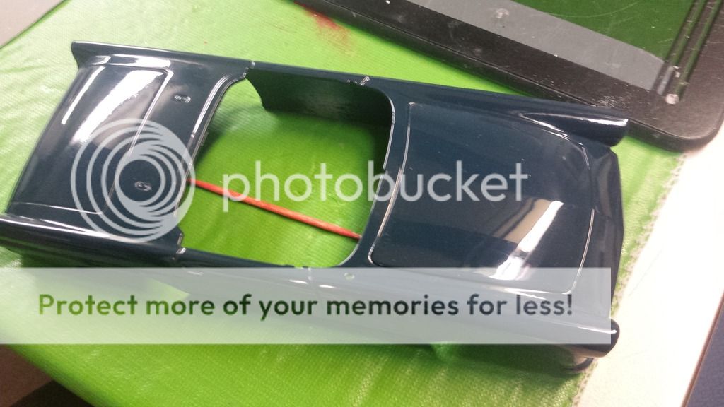

Today I was able to put the final coats of color on. It is a dark blue nail polish called Navy Fleet. I got a couple of coats of Wet Look Clear on it too.
http://
http://
http://
Hopefully I can get some time this weekend to polish it out.

More pictures this coming week. I didn't bring it home with me this weekend. I figured that would give the clear enough time to harden without messing it up. I figured I will hit it with 6000 or 8000 grit and then clear it again. Then I'll  hit it with 8000 and 12000 and then polish it. Should work.....

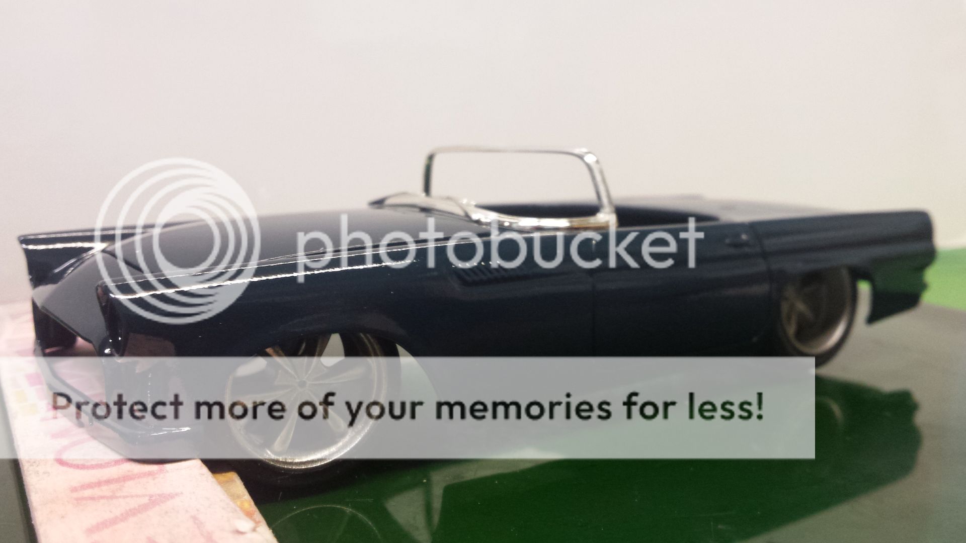

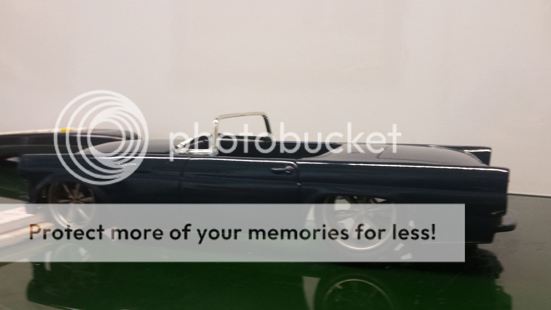

Small update.
I forgot to bring my polishing kit back to work this morning so my lunch break was enough time to paint the wheels and get them mocked up. Hopefully I can get this to sit like this once completed.

It does. I am in the process of building a triangulated 4-link for the rear. I took the easy way out and relocated the pins higher for the front suspension. I realized not long ago that I am about the only one who ever sees the underside. With that I have decided to try to make it look realistic but not go overboard.
As it sits in these pics the rear tires are hitting the underside of the body, so, realistically, it can't go any lower.

Thanks for the comment on the paint job. Going to do the final polishing either this weekend or early next week. Giving it plenty of time to harden. I've been working on the interior and chassis.

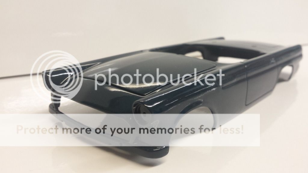

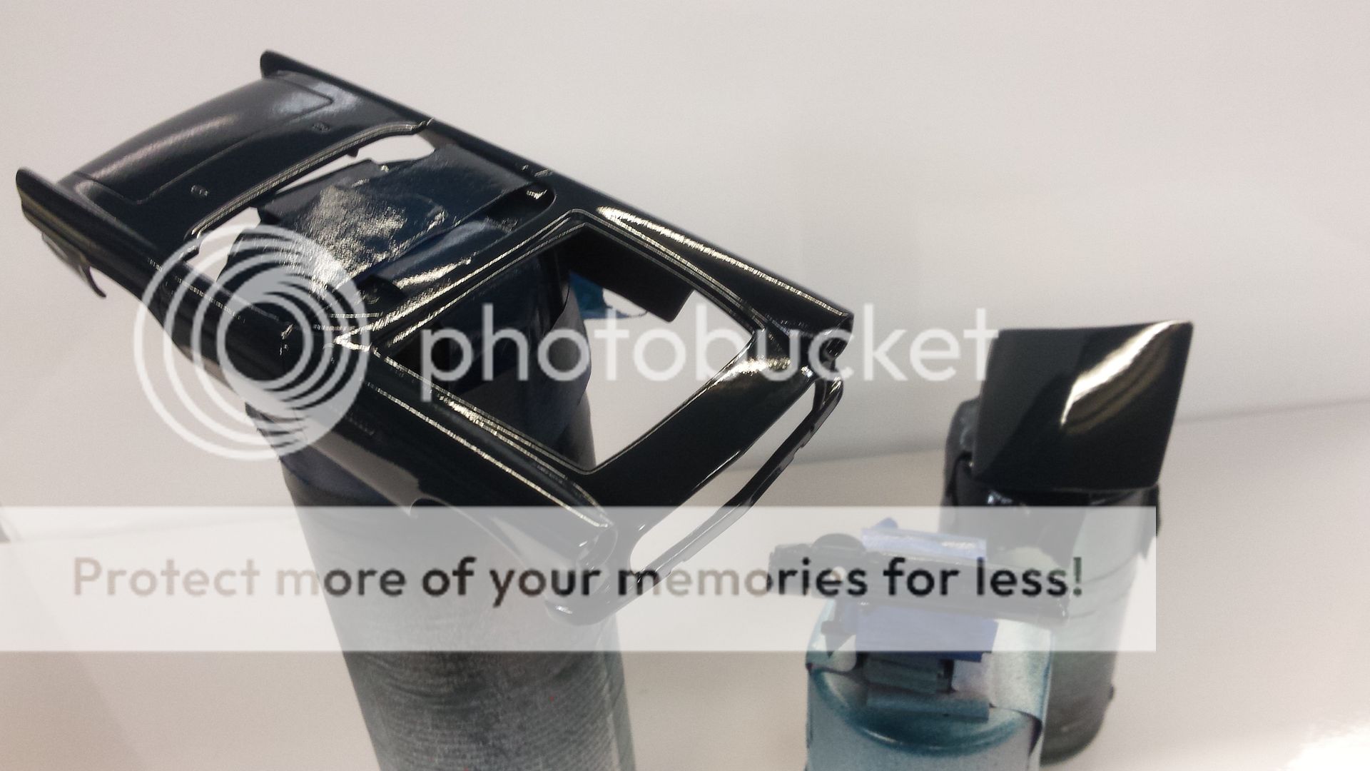

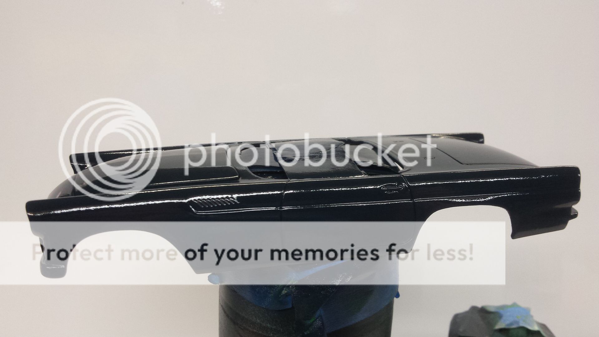

Got a bit of time this last week and today to get somewhere on this. I managed today to hit the body with some 12000 grit and some Tamiya Fine and Finish polishes.
http://
 http://
http://

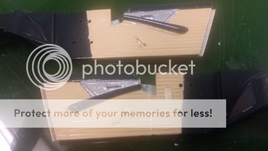

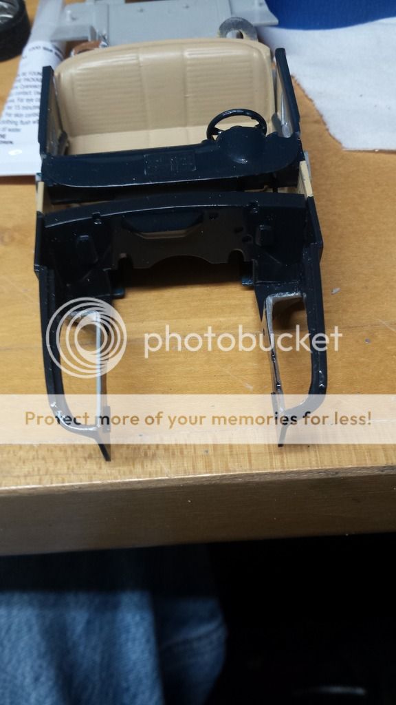

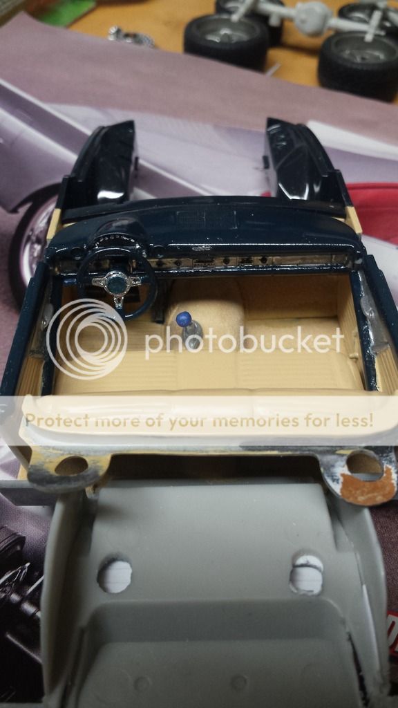

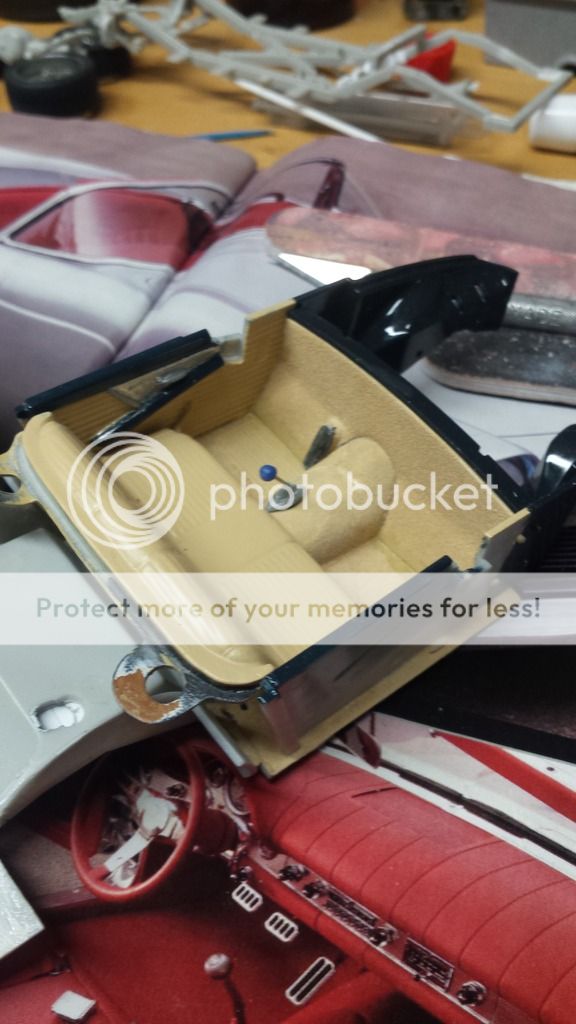

Nowhere near perfect, but good enough for me. Got some done on the interior. Still a bit to go. Made a third pedal since it will be a manual tranny- whatever it ends up being. Still looking for a powerplant.

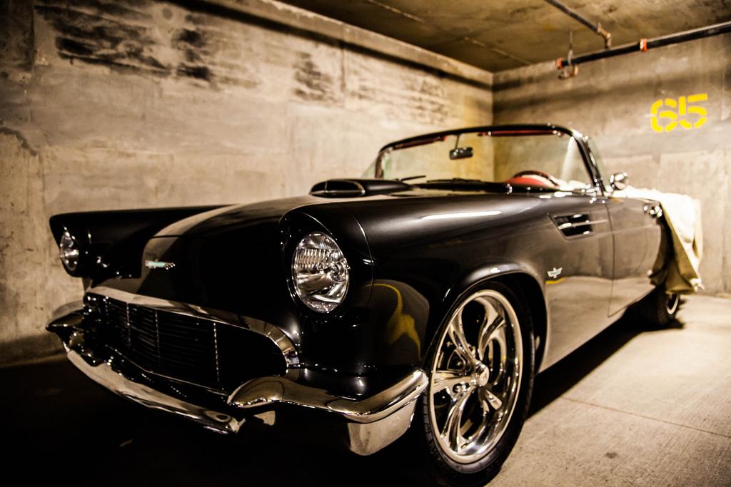

Worked in this project a bit last night. For a bit of back story, I started this project after seeing an artist's rendering in an older magazine that i had. After atarting the build I stumbled upon the finished car in another magazine. Here is the car that this build is "loosely" based on.

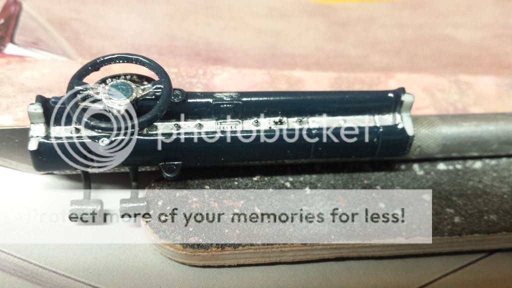

Finished the dash last night and made  a shifter.
http://

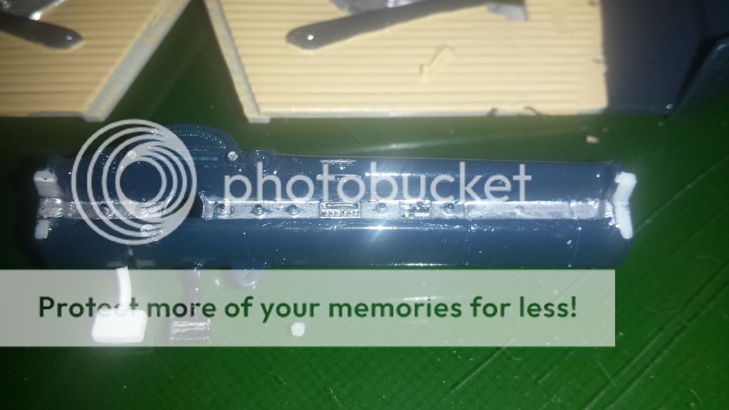

I have been modifying the bumpers. I removed the Connie section on the rear and made a full length smooth bumper. No pics of them yet because they are at work.
Last night I realized that in order to get the front end to sit as low as I want I had to modify the front fender wells...aaarrg! Always something else.
