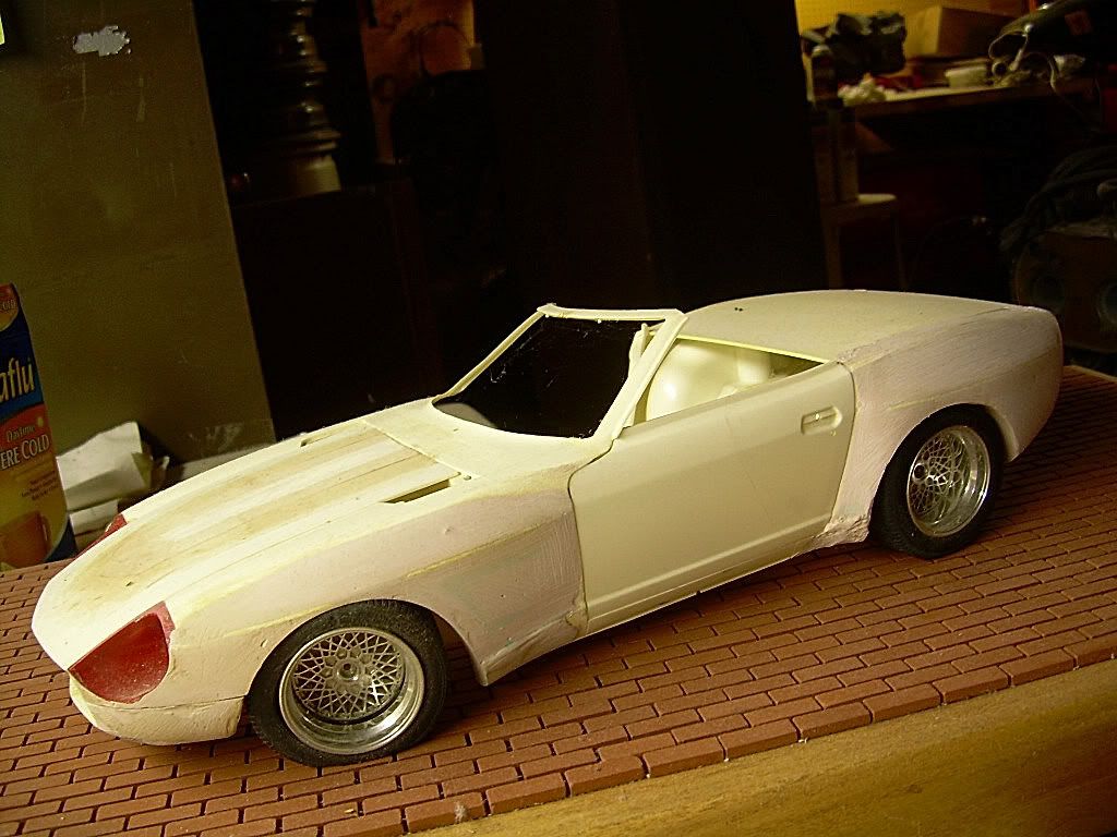

Ace-Garageguy Posted November 2, 2016 Posted November 2, 2016 (edited) I do a lot of heavy re-styling, both on models and in full scale. What I'd recommend for models is just about any 2-part POLYESTER automotive glazing putty (made for real cars). It's basically a finer-grained "bondo", and is available at auto-body supply stores and many general car-parts places. The best quality I've found so far is USC "Icing", but it comes in a tube that is too big for modeling...unless you do a LOT of custom work, and it's only available at bodyshop supply places. A very good second choice that is available in modeler-friendly packaging is the Bondo brand 2-part "PROFESSIONAL" glazing putty. It's stocked at stores like Advance, Carquest, Napa, etc. This custom body kit for a Datsun 240 Z is being built using these products. Be absolutely certain you buy the "PROFESSIONAL" labeled product if you go with the Bondo brand. It has its own catalyst packaged with the tube. You do NOT want to use ordinary lacquer putties (like Squadron or Testors or the Bondo ONE-PART) for heavy fill work because they will take forever to dry, and tend to shrink and crack if piled on thick. This is the good stuff in the Bondo brand... Edited November 3, 2016 by Ace-Garageguy

Ace-Garageguy Posted November 3, 2016 Posted November 3, 2016 (edited) On 11/3/2016 at 12:59 AM, SSNJim said: One thing no one has mentioned so far is that the bulk of the bodywork should be done using plastic and cement. With flares for example, you need to build the basic structure out of plastic, then use the putty to cover the flaws. Most of the filler/putty should be sanded away, leaving what is required (a very thin layer) to fill seams and other flaws. Don't build your body kit of filler alone so that there is 1/4" of putty and nothing else. The first time the body flexes, it will pop off. Well...I've built an awful lot of custom stuff, and I'll have to elaborate. Thinner filler is always better in principle, but it takes a lot more time to do the fab work very close to final-contour in styrene. If you look at the 1/12 scale Z-car model i posted above, you'll see the main lines were established with styrene, and the contours were filled in with a pretty fair amount of "bondo". There's nowhere near enough "flexing" to pop the filler off, and the styrene was roughed up with 180 to help with adhesion anyway. Another problem with very thick fender flares that are primarily bondo is that they'll be too thick to allow the tires to go up in the wheel wells to look right. You can grind the filler off the backside of a fender to remedy this, but you'll have to do some reinforcing as shown on the model below. This is a 1/25 scale model I'm almost finished with. The shapes were again established with styrene, and contoured with "bondo". Actually, on this particular model, I ran into some minor problems because I let the filler get TOO thin on certain areas...and that's where "flexing" played merry hell with the stability of the substrate while sanding the primer. I had to reinforce the underside of the custom work with fiberglass to stabilize it in order to be able to block-sand it straight enough for paint. (It wasn't a long-term problem on this model, as the finished body is a plug for a set of molds, and it only has to function as a master, so the underside thickness isn't an issue.) Edited November 4, 2016 by Ace-Garageguy

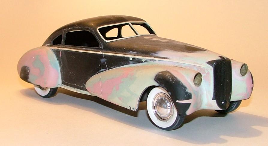

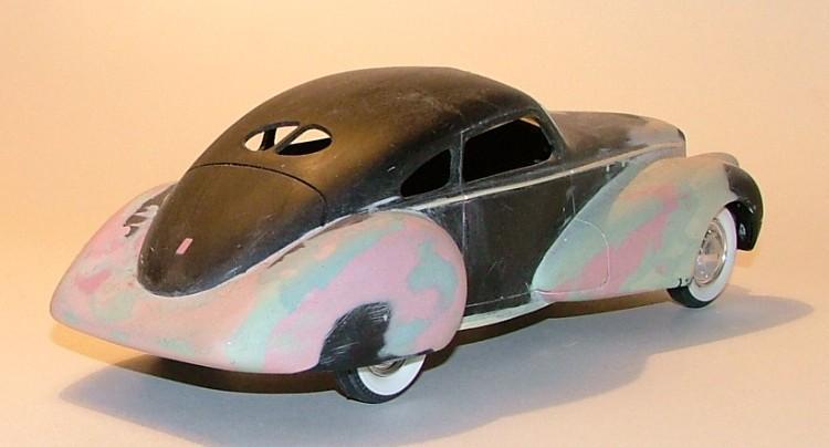

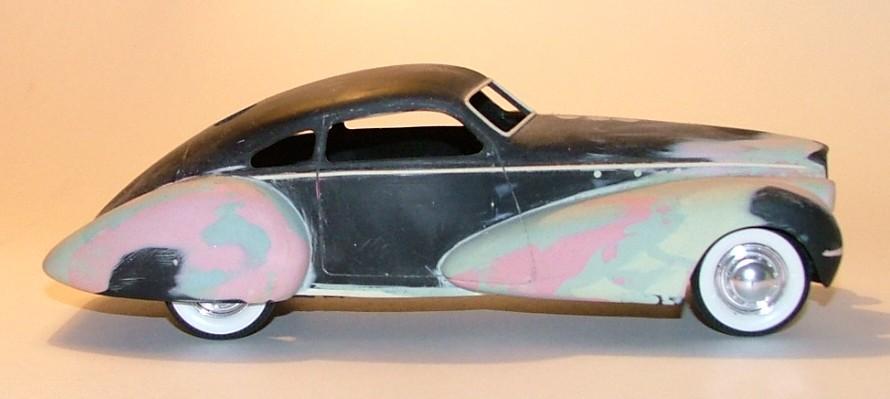

Art Anderson Posted November 4, 2016 Posted November 4, 2016 On 11/4/2016 at 1:14 AM, Rider said: Bill, I have a two questions for you. Do you have issues with the heat from the two part bondo and has it caused any warping issues for you and do you every use MEK and make your own liquid plastic? I have always wanted to use the two part stuff but the heat has been a concern. I've used 2-part polyester body putty many times over the years to create shapes, even a complete body shell on occasion. I've never had any problem with the heat coming from the curing process--even though as Bill and others have said, the more catalyst used the more heat is generated as the putty cures. This is a still-stalled restyling project, using the OOP AMT/Ertl "Black Force" custom car snap kit from the late 1990's/early 2000's. Called a "1941 Duesenberg Model J, all the bodywork you see was done with USC Icing, the same product Bill mentions above. I tend to over-catalyze the stuff a bit, as I needed it to begin setting up fairly quickly--probably used about double the recommended proportion of catalyst to putty--yes, those fender extensions did get warm, but not nearly enough to even be uncomfortably hot to the touch. To ensure absolute adhesion of the putty to the styrene plastic, I drilled a number of small holes in the styrene plastic surfaces onto which I was going to apply the putty--those holes, once filled with the putty, act like built-in rivets--this in addition to roughing up the surface of the plastic as well. You will note that the Icing has a bit of a mottled look--that's because I used two different colors of catalyst, red and blue. This was so that as I shaped the raw puttywork, I could see where more putty was needed, so a contrasting color of putty helped me in that regard as well. Once I get back on this project, wnen I have the polyester putty work as smooth as I can get it, I'll shoot some red oxide primer on it, then lightly sand that, to find any surface imperfections, which will get filled with ordinary lacquer-based spot & glaze putty. This is a system for bodywork that I've used, off and on, since about 1969-70--it's never failed me yet! Art
Rider Posted November 5, 2016 Posted November 5, 2016 Thanks very much Art for taking the time to provide this in depth information, much appreciated. I like that you use different colour kicker to help you. Now that I know you guys have great succes with this stuff I will give it a go.Nice looking work btw, it will look pretty slick once your done with it.
