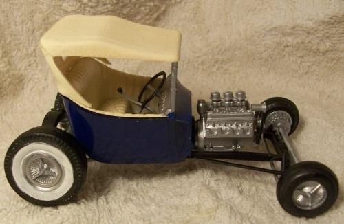

Deuce Coupe Posted December 3, 2016 Posted December 3, 2016 Hi, I have a small question, It's a 1:32 scale question. First a little about me. I am just starting to build 1:32 scale Lindberg car kits from the 1920's to 1940's. I'm building these to use on dioramas on a G-scale train layout. I realize that G-scale trains are 1:29 scale (at least the ones I have are). But I chose to go with 1:32 scale cars instead of 1:24 scale because the smaller cars will work better for my layout. Plus they are a lot cheaper to buy and I want lots of them. The trains will just look a bit large. But I can deal with that. In any case, I've noticed that most of the Lindberg kits come without an engine. Yet many of the 1930 models actually have removable hoods. So my question is this: Does anyone make kits of just 1:32 scale auto engines? I've been looking around and haven't been able to find any. Lindberg does make a 1925 Model-T Street rod that comes with a Cadillac engine. But other than this I haven't been able to find any kits of just engines or engine accessories for 1:32 scale model cars. So if anyone knows of any I would appreciate it. Thanks, James I've attached some pics of my recent build

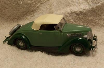

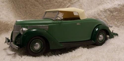

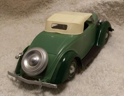

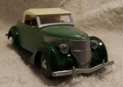

talon63 Posted December 3, 2016 Posted December 3, 2016 (edited) Welcome to the Forum. I also have a small fleet of the Lindberg 1:32 scale vehicles like these from earlier posts on the board: Very few of the Lindberg kits are full detail, and I've not had much luck in the aftermarket arena for parts. With a little patience, you might try making your own. I've had some luck sourcing parts from flea market/yard sale finds, or just making parts myself. You might also try looking in the Aftermarket or posting in the Wanted sections of the forum. Edited December 3, 2016 by talon63
