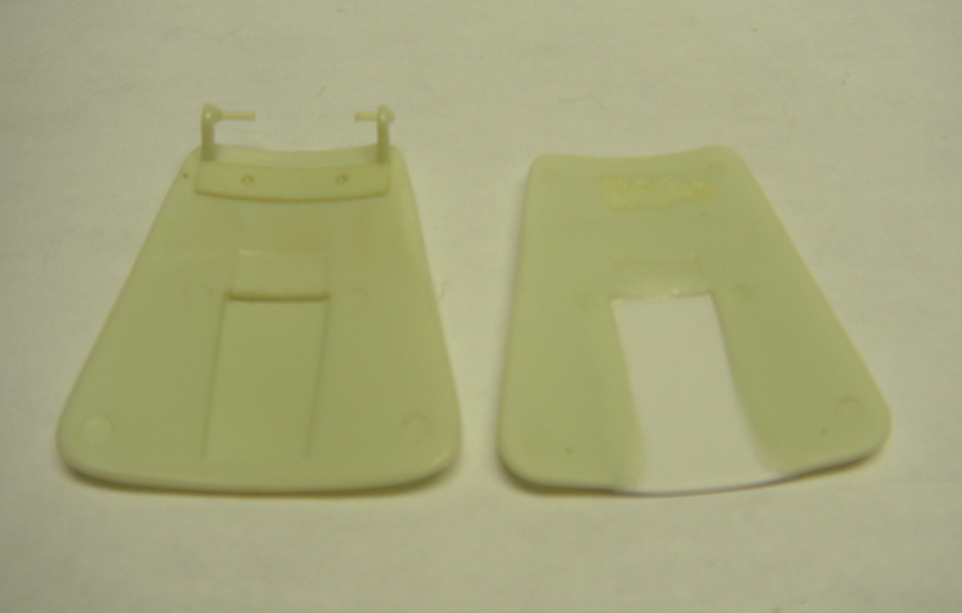

afx Posted December 24, 2016 Author Posted December 24, 2016 This car ran a bulge in the hood with an air extractor similar to the Cobra Daytona Coupes. After cutting out the hood scoop I cut and shaped the bulge from .030 sheet. I'll hold off cutting out the air extractor until after I have completed the blending on the bulge.

afx Posted December 26, 2016 Author Posted December 26, 2016 (edited) Thanks Dann. I enjoy your builds as well. Air extractor cut into the hood and the hardtop permanently installed. Edited December 26, 2016 by afx
