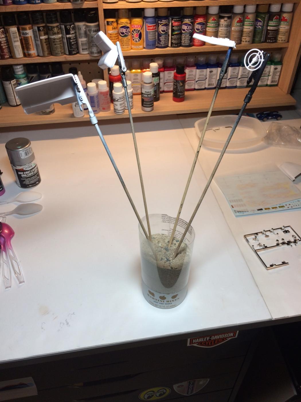

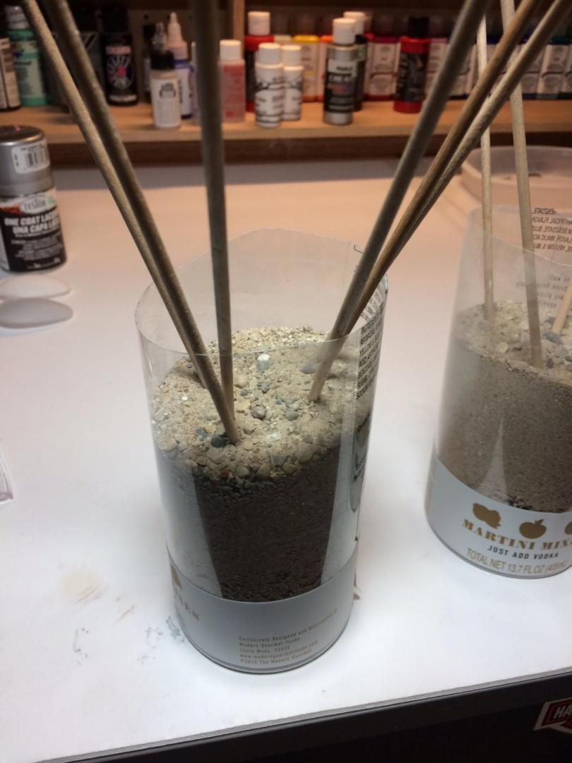

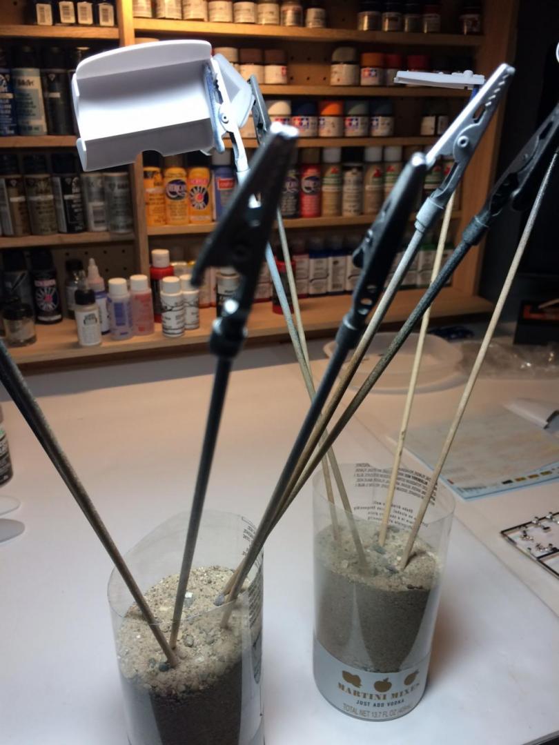

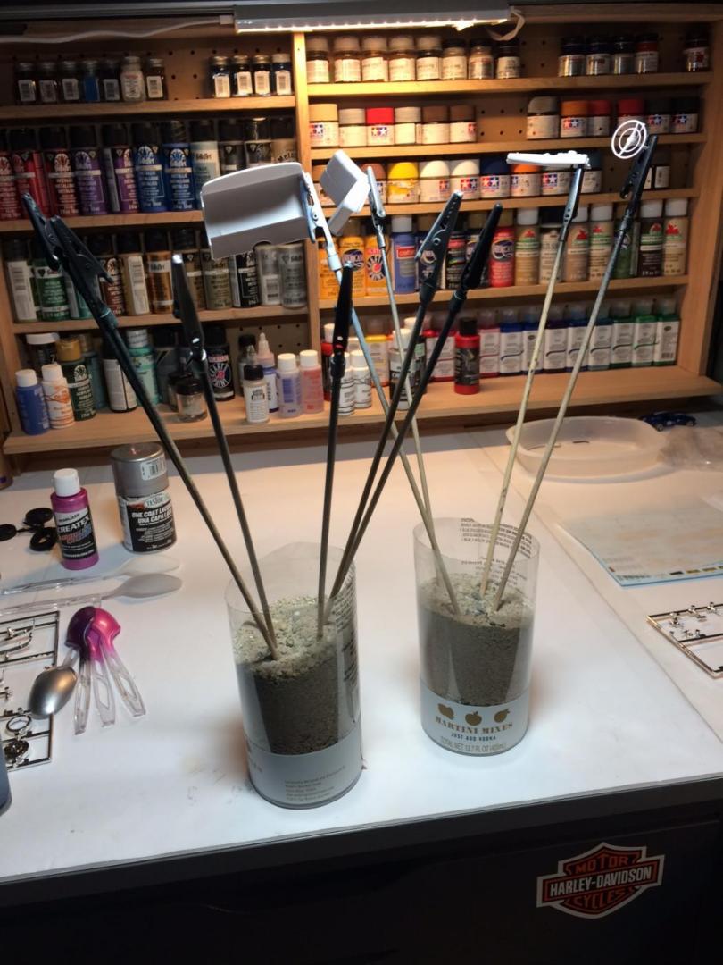

hedotwo Posted December 28, 2016 Posted December 28, 2016 I would often have trouble dealing with airbrushing (or rattle spray) smaller parts and then putting them down to paint additional parts. I found a couple of plastic tube-type containers that I cut off to about a 7-8" height and then filled them about halfway with plain ol' sand. I use long wooden skewers with alligator clips attached securely to hold the parts. Placing them in the sand is a snap, and the sand holds them really steady so they don't touch each other when you move the container. Another nice thing is that sand doesn't stick to the skewers when you remove them. The pix aren't the greatest, but you probably get the idea.
