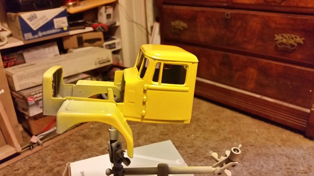

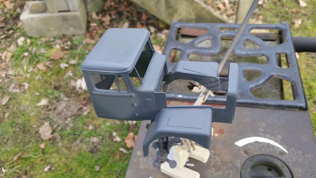

Its been unseasonably warm here in the great white north, so I stole a chance to take the Husky outside for a shot of primer..and COLOR !! Taking advice from Dave I sprayed the cab with duplicolor primer, then after drying overnight a light coat of Tamiya white to brighten the upcoming color coats.

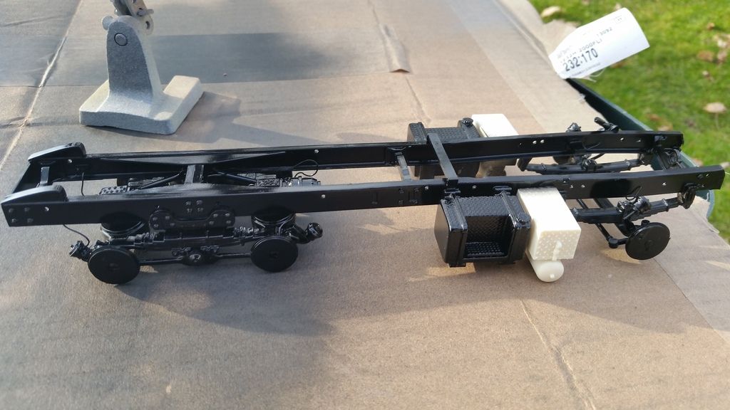

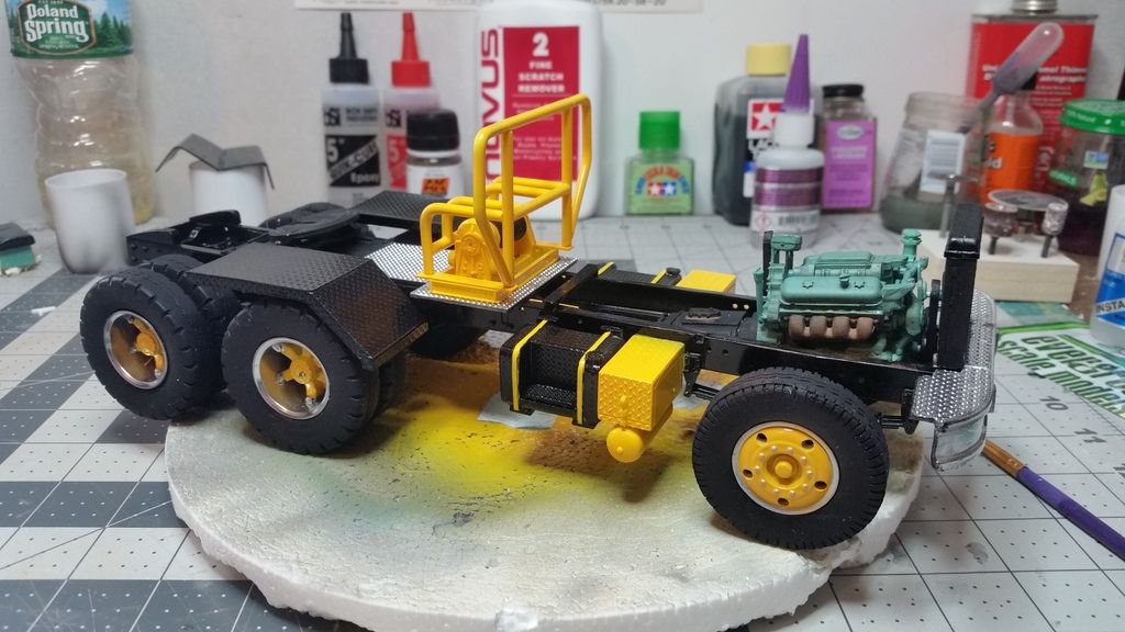

I grabbed the chassis heading out the door also , decided the frame would look good in black..the battery boxes will be yellow like the cab.
Hopefully you can see my attempt at adding a few airlines to the brakes, not up to the level of other builds here.
The cab after its first coat of paint , bear in mind the hood and fenders will be black.

Wow!! That is looking great!! I like yellow almost as much as JT likes orange.
lol I knew you'd appreciate the yellow cab !! I almost went red ,but the yellow works really well on it. My biggest concern is keeping it from looking like a bumblebee!

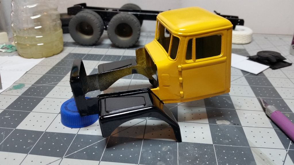

I picked up a set of diamond plate fenders from AITM, absolutely pleased how they look . I actually cut one in half , making quarter fenders keeping the theme going. A quick coat of deep gloss black.
any comments welcome !!

Nice work, this is looking excellent! I picked one of these up from AITM and was really impressed how thin the casting was, hardly any clean up at all. Your color choice is perfect!

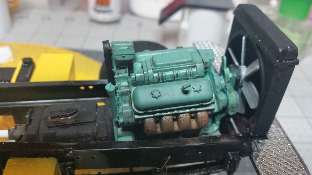

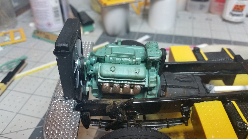

I gave the engine a light wash of engine grime pigments to give it a few road miles cause these trucks actually worked ! I'll dust the exhaust once more w rust powder before closing it up.

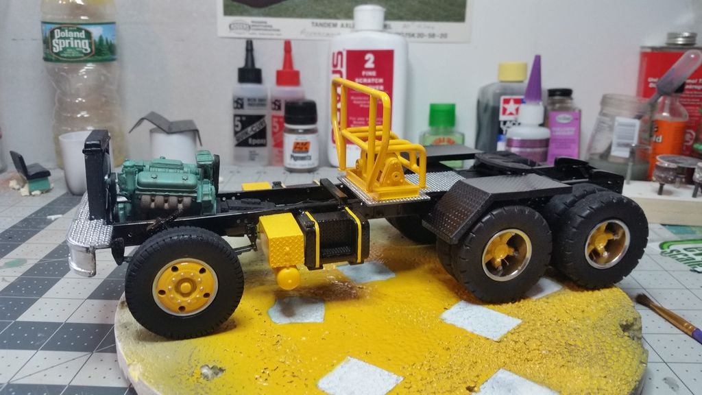

The rear fenders were hung for good after grinding tons of resin from underneath..arggg. I used a set of dm 800 hangers for them

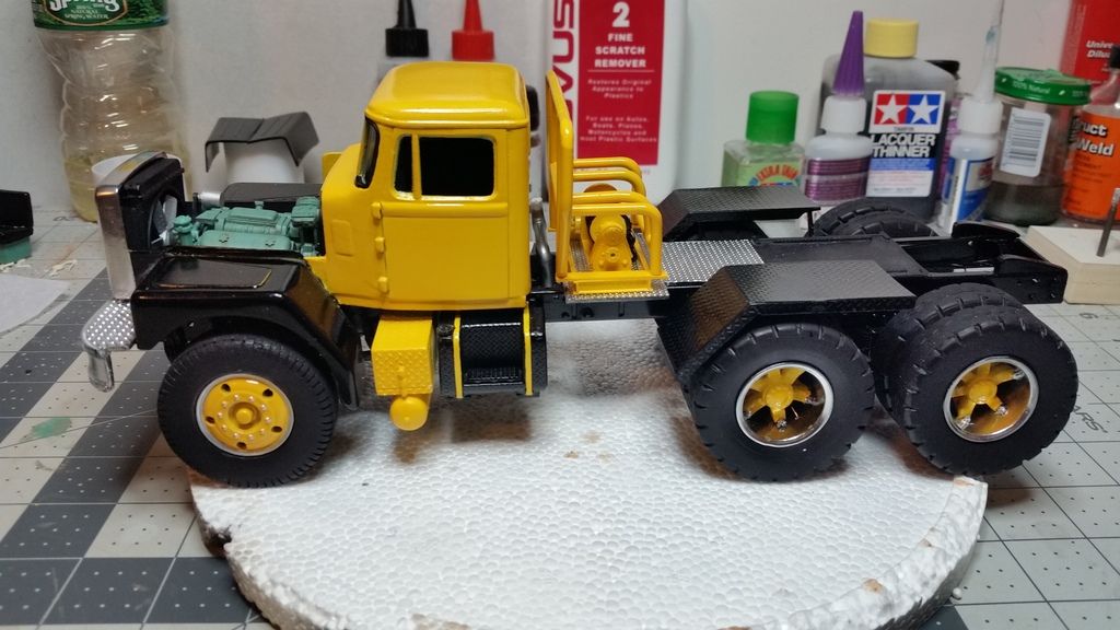

The one part I was putting off was the curved "glass" windshield panels, but turned out much easier than I expected .Everything was secured w white glue then a coat of future to seal them in and hide any fine blemishes. One more test fit before installing the interior and bolting down the cab !
I fabbed up the exhaust pipes from 1/8 rod and robbed a stack from the autocar . everythings waiting for chrome now
