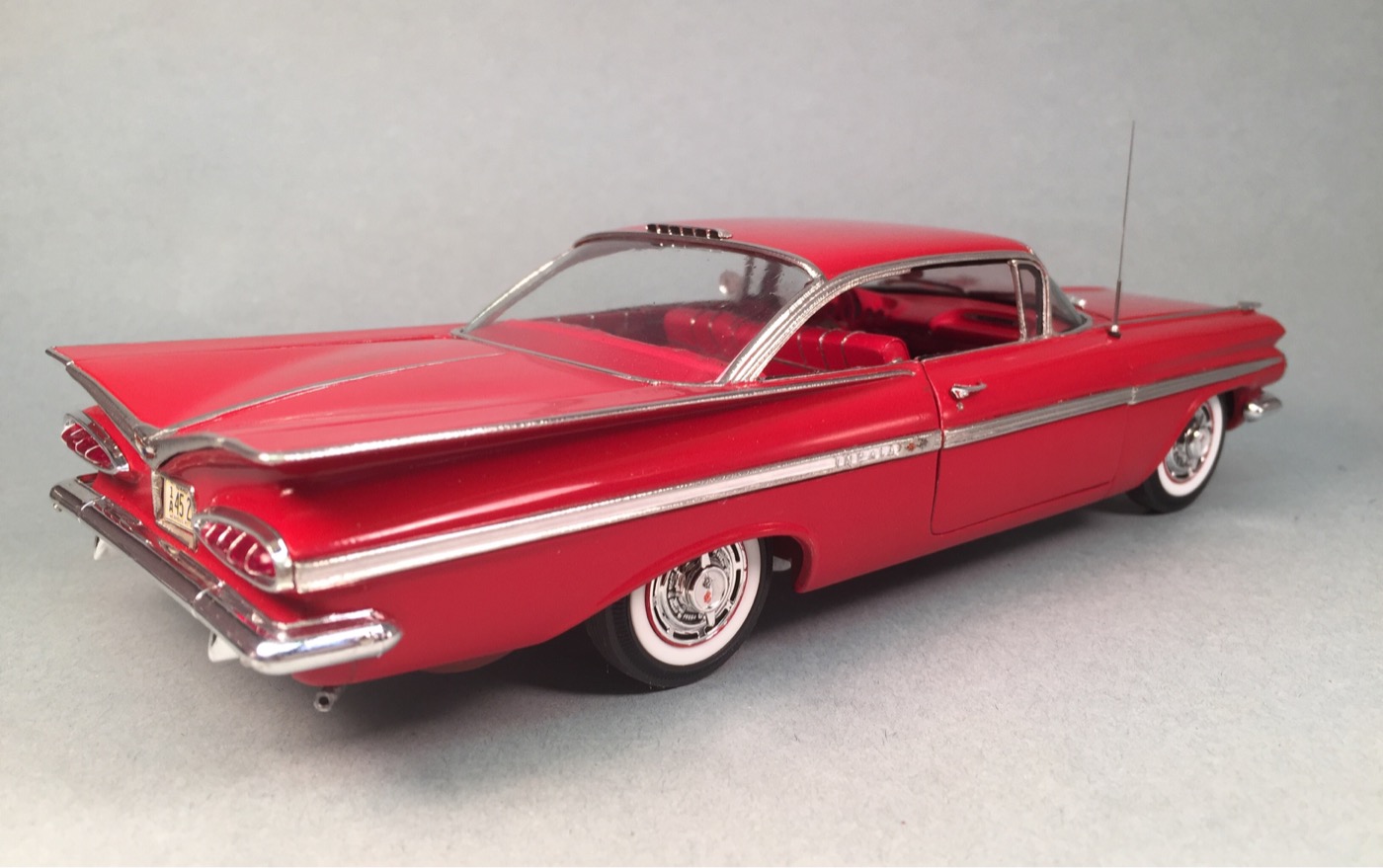

I don't know if you've seen it........but here's my '59 Chevy that I painted using the method I described. LOTS of bodywork went into this as there was a total roof swap involved as well as opening doors and trunk. The build pics can be seen here.......
13:48192169363135:481921715376
As you'll see in the pics leading up to painting, a barrier coat was put on the body before primer, then I used several coats of Plastikote Sandable gray as the undercoat. The color coat is automotive Dupont Roman Red which a local paint jobber mixed for me. I let the body thoroughly dry for about a week or so, then the paint was rubbed out with Detail Master polishing cloths, and then polished with Meguiar's Car Cleaner Wax with a chamois cloth.

I don't know if you've seen it........but here's my '59 Chevy that I painted using the method I described. LOTS of bodywork went into this as there was a total roof swap involved as well as opening doors and trunk. The build pics can be seen here.....As you'll see in the pics leading up to painting, a barrier coat was put on the body before primer, then I used several coats of Plastikote Sandable gray as the undercoat. The color coat is automotive Dupont Roman Red which a local paint jobber mixed for me. I let the body thoroughly dry for about a week or so, then the paint was rubbed out with Detail Master polishing cloths, and then polished with Meguiar's Car Cleaner Wax with a chamois cloth.
Had the pleasure of seeing that in person last year in new jersey... amazing work!  and great advice!
