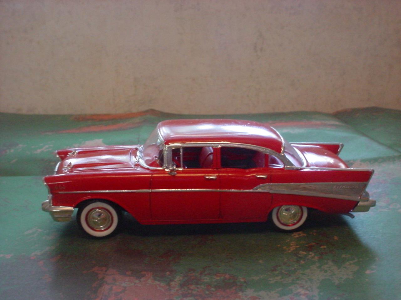

57peppershaker Posted March 29, 2017 Posted March 29, 2017 Oh the distant memorys of 50 quid (£ vs $ lol) cars Ray. All great in the mists of time.Like you, i was interested in the look but not the detail when i started converting a 1/12 Monogram 57 chevy into a 4 door coupe that i had as my wedding car. The good people at Monogram sent me extra door handles as well as all the chrome sprues (3 sets on the 1/12) following a nice letter (no internet then). Scribing the door lines went ok but the door corners didnt go so well.The model didnt get fnished but the marriage did. Lost the inspiration to finish it now so thinking about a 2 door conversion.........
