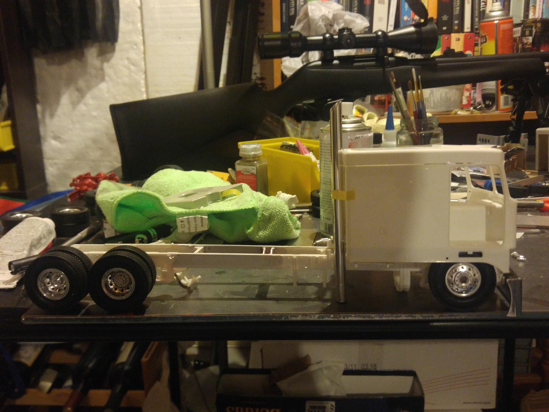

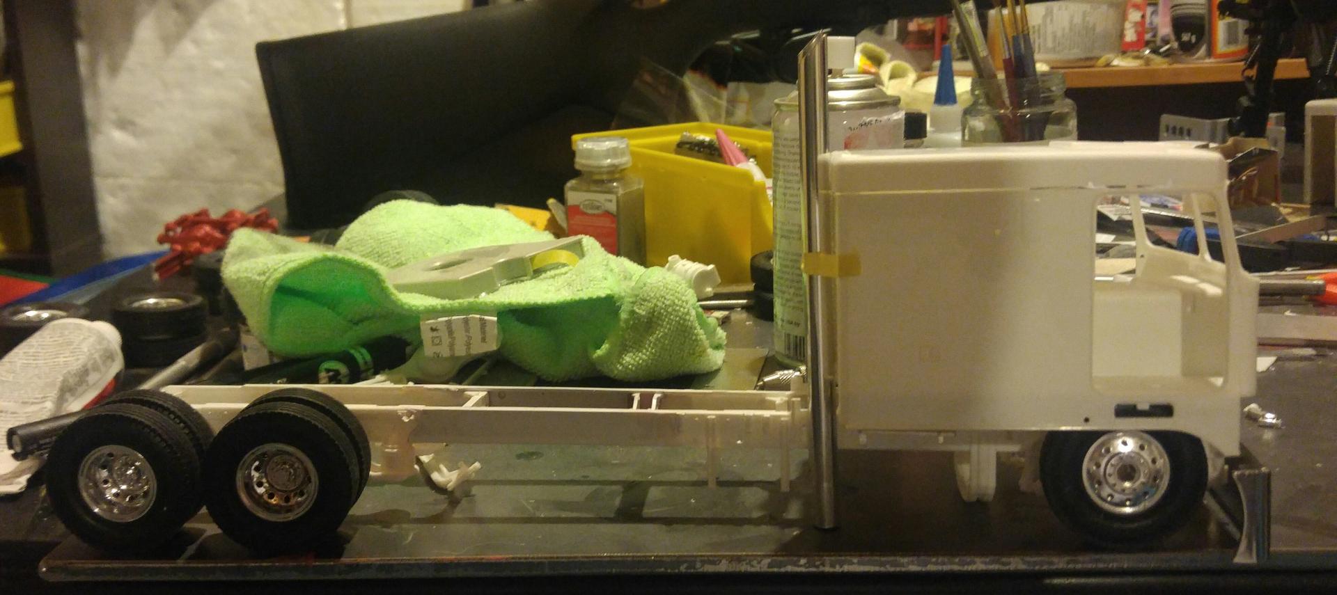

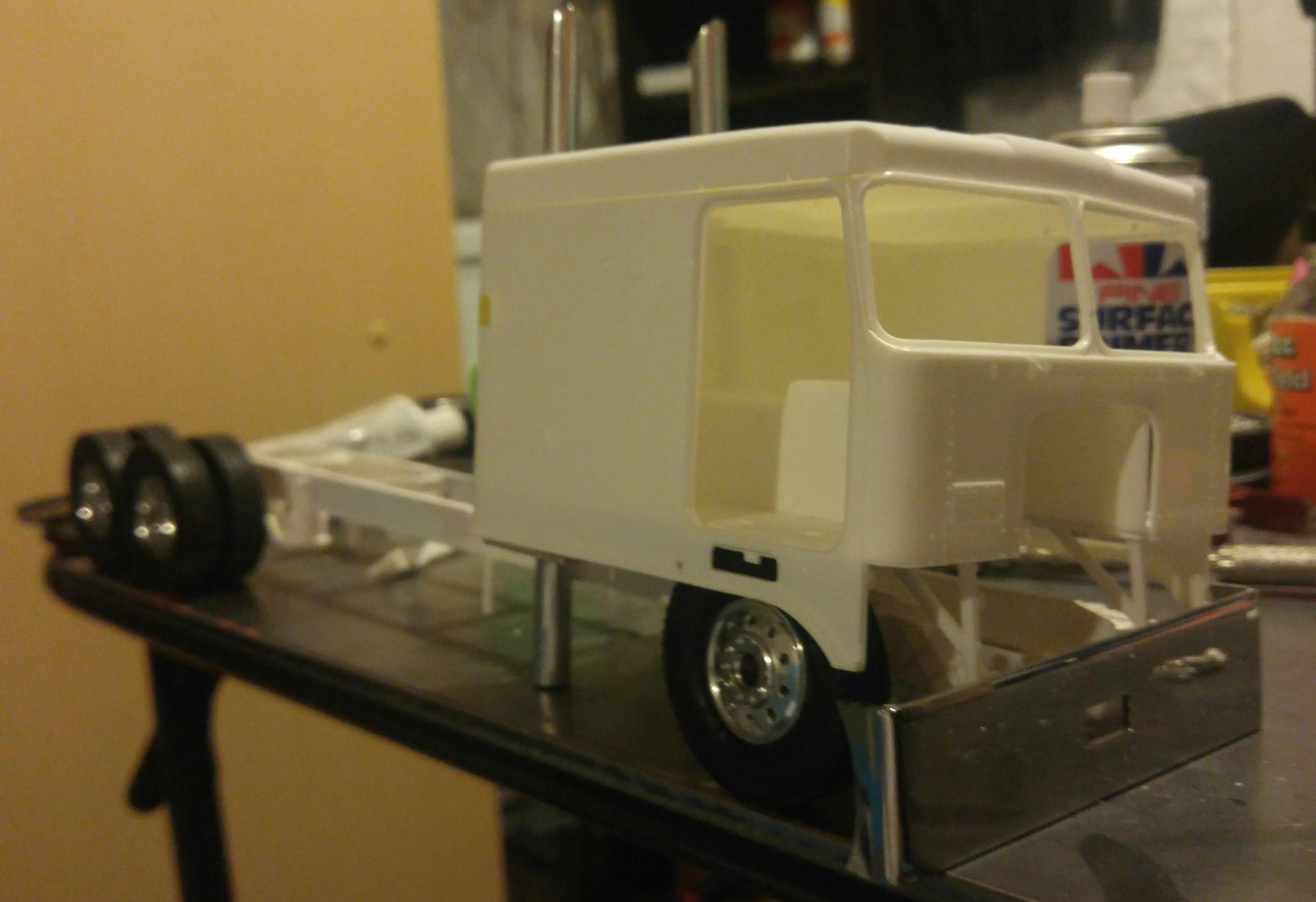

MachinistMark Posted April 28, 2017 Posted April 28, 2017 (edited) Stretched 72", custom stainless front bumper, early work in progress. Edited February 12, 2018 by MachinistMark
trick my mixer Posted April 28, 2017 Posted April 28, 2017 This is going to look good...Nice bumper...The Moose is Loose.LOL!!

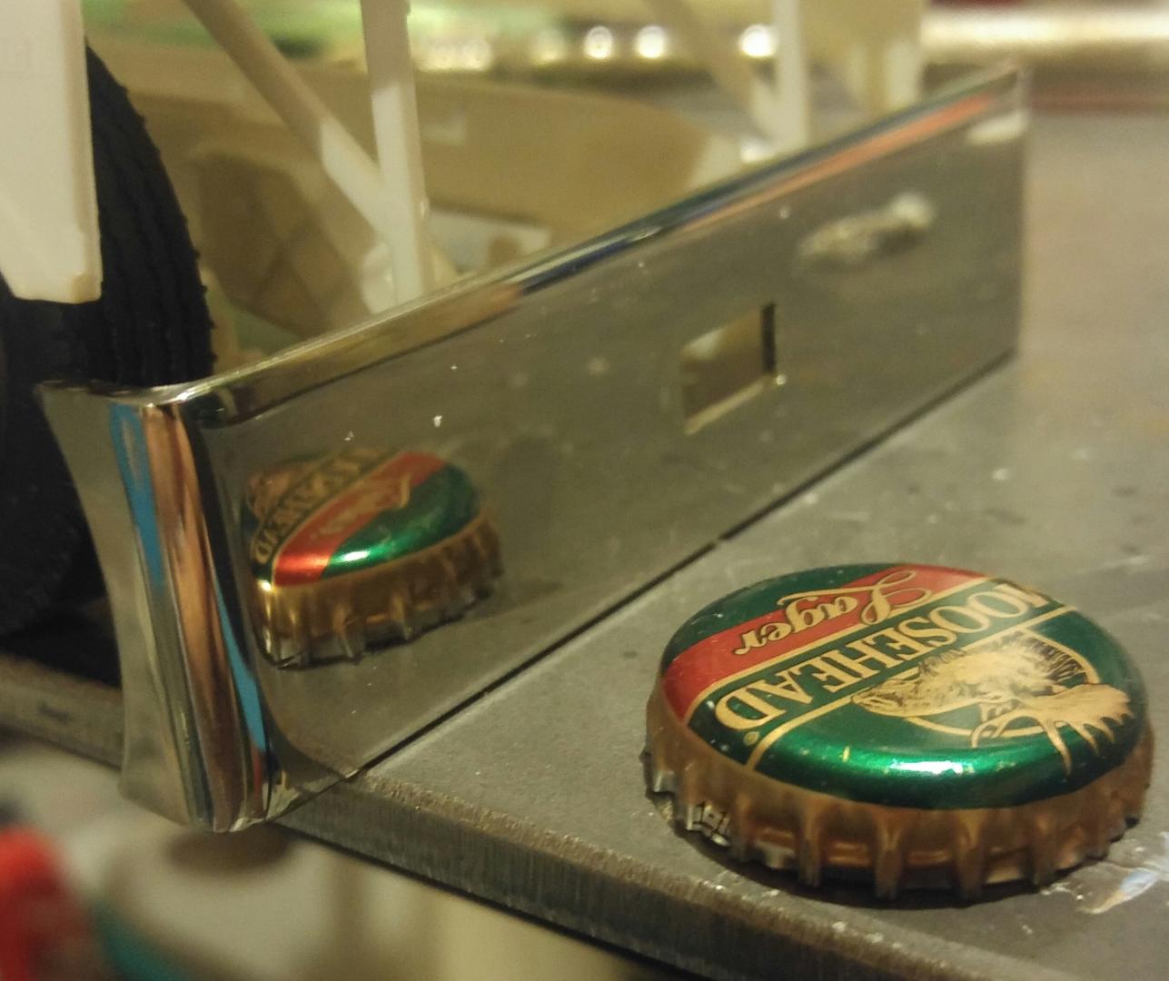

vincen47 Posted April 29, 2017 Posted April 29, 2017 Great start, I'll be watching this one. The bumper is awesome, did you make it?
MachinistMark Posted April 29, 2017 Author Posted April 29, 2017 Yeah. I drew it in cad and cut it out on the cnc laser I run at work. Had one of the ypungfellas we have at the shop bend the ends up for me, then polished it. It's 304 stainless steel. Sanded it with an orbital sander starting with 150 grit paper, then 240, 320, 400, 500 grits, then onto the buffing wheel and finished with autosol metal polish and a microfiber towelIt's not an easy material to work with, stainless. But not sure is pretty

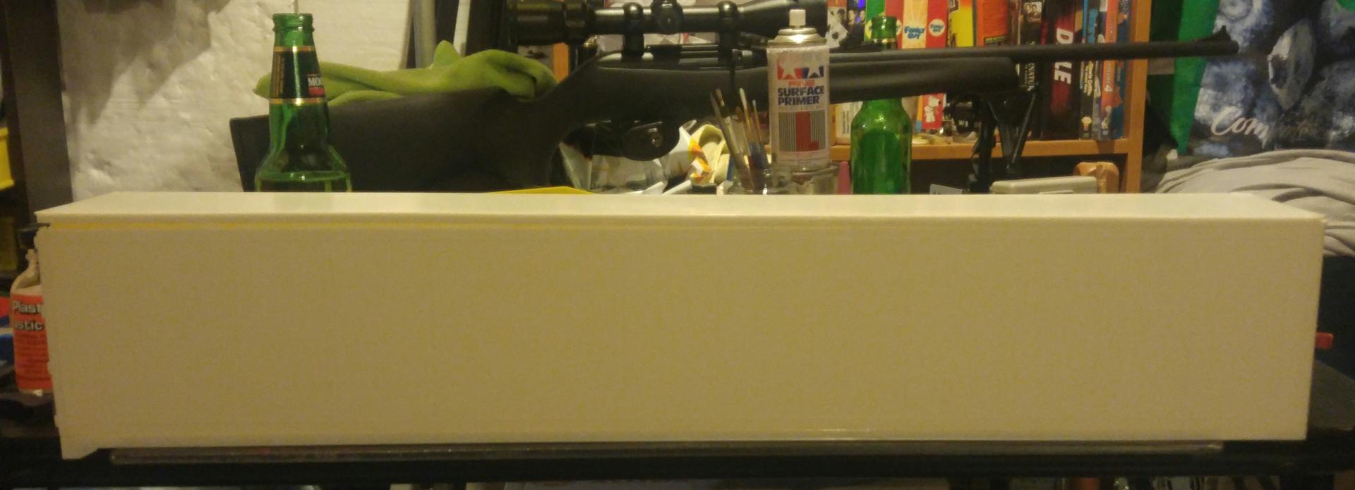

MachinistMark Posted May 13, 2017 Author Posted May 13, 2017 Sprayed the box aluminum today, I'll mask off what's gonna be painted body colour tomorrow maybe.

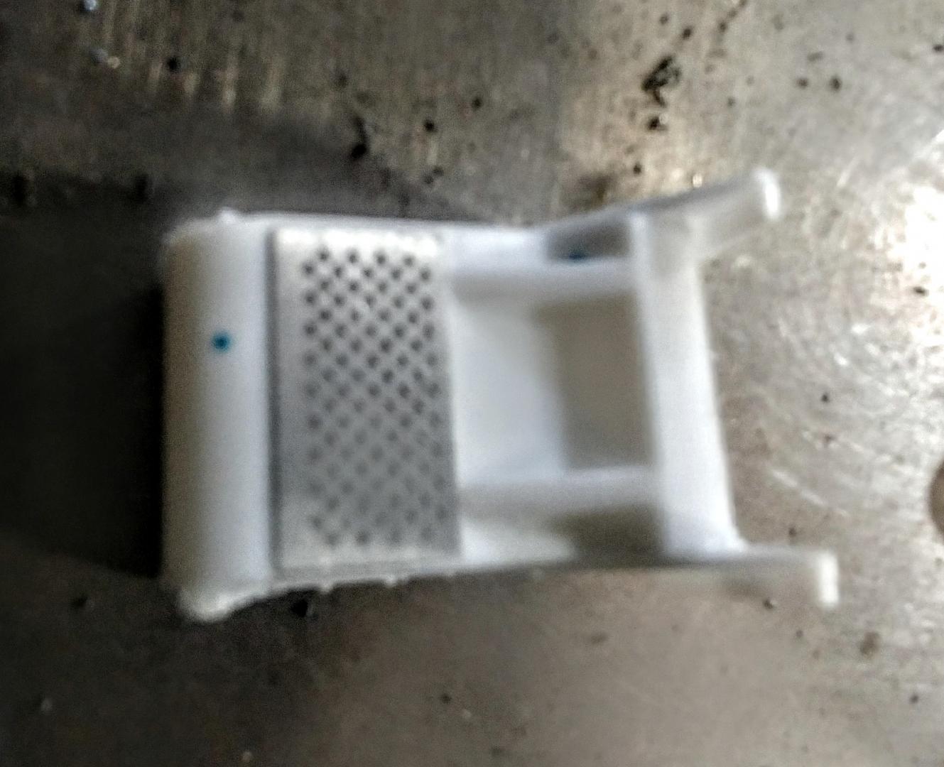

MachinistMark Posted November 21, 2017 Author Posted November 21, 2017 Been a little while.... Some progress.. Real mesh radiator and an aluminum insert for the battery box step
