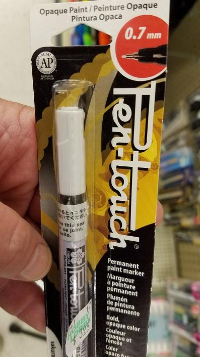

Jon Cole Posted July 30, 2017 Posted July 30, 2017 With the Molotow Chrome pen being so popular, I keep looking in Hobby Lobby to see what else they have for paint markers. Tho I have no use for a white pen, they do have this. Anyone try these?
DrKerry Posted July 30, 2017 Posted July 30, 2017 I use silver Sharpie Markers for trim that I do. Not sure what else. I also use Sharpie Markers in different colors for touch up and coloring various parts too!!!

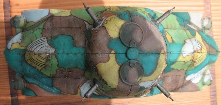

Mike999 Posted July 30, 2017 Posted July 30, 2017 I did the thin brown separation lines between the camouflage colors here with a Sharpie marker. This is a 1/35 scale Skoda PA-II armored car. A few more pix of it are in "All the Rest."

BigTallDad Posted July 30, 2017 Posted July 30, 2017 That's an opaque pen, which would probably allow the cover underneath to show through (somewhat). So much for whitewalls.

Snake45 Posted July 30, 2017 Posted July 30, 2017 (edited) In the same HL aisle as the Molotow, I found a Pentel silver gel pen with a very fine point that is working amazingly well for small details like nameplates. I didn't think it would lay down and stick to plastic or polished enamel, but it does.In the same aisle was a fine-point Pentel black gel pen that turns out to be absolutely perfect for doing the slots in Chevy Rally Wheels. Again, it lays down on everything including chrome plate. I'm sure I'll find dozens more uses for it, too. Where has this thing been all my life?Of course I'm almost notorious around here for my unabashed love of the Silver Sharpie. I bought two more of them at Walmart yesterday. I'm building up a nice stash/reserve of the things. They don't last forever, and I live in fear that someday they'll discontinue them, at which point I would have to give up car modeling and go back to airplanes. Edited July 30, 2017 by Snake45

Foxer Posted July 30, 2017 Posted July 30, 2017 (edited) I haven't tried a paint marker for white, but I used a Gelly Roll gell pen to do the raised piping on a black rubber seat and the coverage was spectacular. These are now my go-to for white pen on anything. The one I have is marked 08 for tip size while the link I gave is a MED point. Not sure of the difference. Mine looks like the point on that paint pen you showed. seem to have missplaced photos I took of the seats, sorry about that, but these are by far the best white markers I have encountered. Edited July 30, 2017 by Foxer

Jon Cole Posted April 2, 2018 Author Posted April 2, 2018 I have wasted so much on gel pens over the years. They just don't function. Nothing I do can get them to leave a mark, be it on plastic, or paper. The silver Sharpie markers are ink, not paint. I find them to not cover well. Very translucent. For chrome, nothing seems to top the Molotow Chrome pen. The fine point paint marker shown at the top looks interesting.
BigTallDad Posted April 2, 2018 Posted April 2, 2018 (edited) On 7/30/2017 at 2:44 AM, Jon Cole said: With the Molotow Chrome pen being so popular, I keep looking in Hobby Lobby to see what else they have for paint markers. Tho I have no use for a white pen, they do have this. Anyone try these? Expand It says it is a paint marker; does the packaging indicate what kind of paint (oil based or acrylic)? Depending on the type of paint, white-wall tires or raised letters/numbers on tires come to mind. Edited April 2, 2018 by BigTallDad
Snake45 Posted April 3, 2018 Posted April 3, 2018 On 4/2/2018 at 10:57 PM, Jon Cole said: The silver Sharpie markers are ink, not paint. I find them to not cover well. Very translucent. Expand They seem more like paint than ink to me. And yes they can take two or three coats to cover well. But it dries so fast, by the time you get to the end of a line, you can go right back and lay the second coat on--no waiting for drying. Oh, they DO get more "translucent" when they're running out. That's how you know it's time to bust a fresh one loose!
