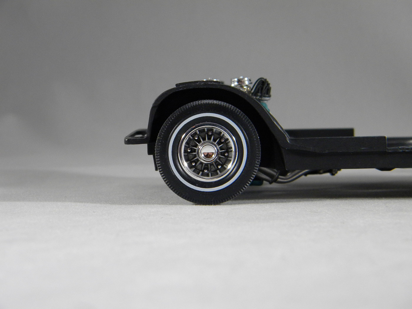

andy12646 Posted August 4, 2017 Author Posted August 4, 2017 Thanks, Guys! I plan on trying each of the suggested methods. I want to get results like that in the photos. I read somewhere on the forum that suggested clear coating the chrome item before applying a wash. I tried that once but the clear coat seemed to somewhat "fill" the low areas where I wanted the wash to accumulate. Any Thoughts?
