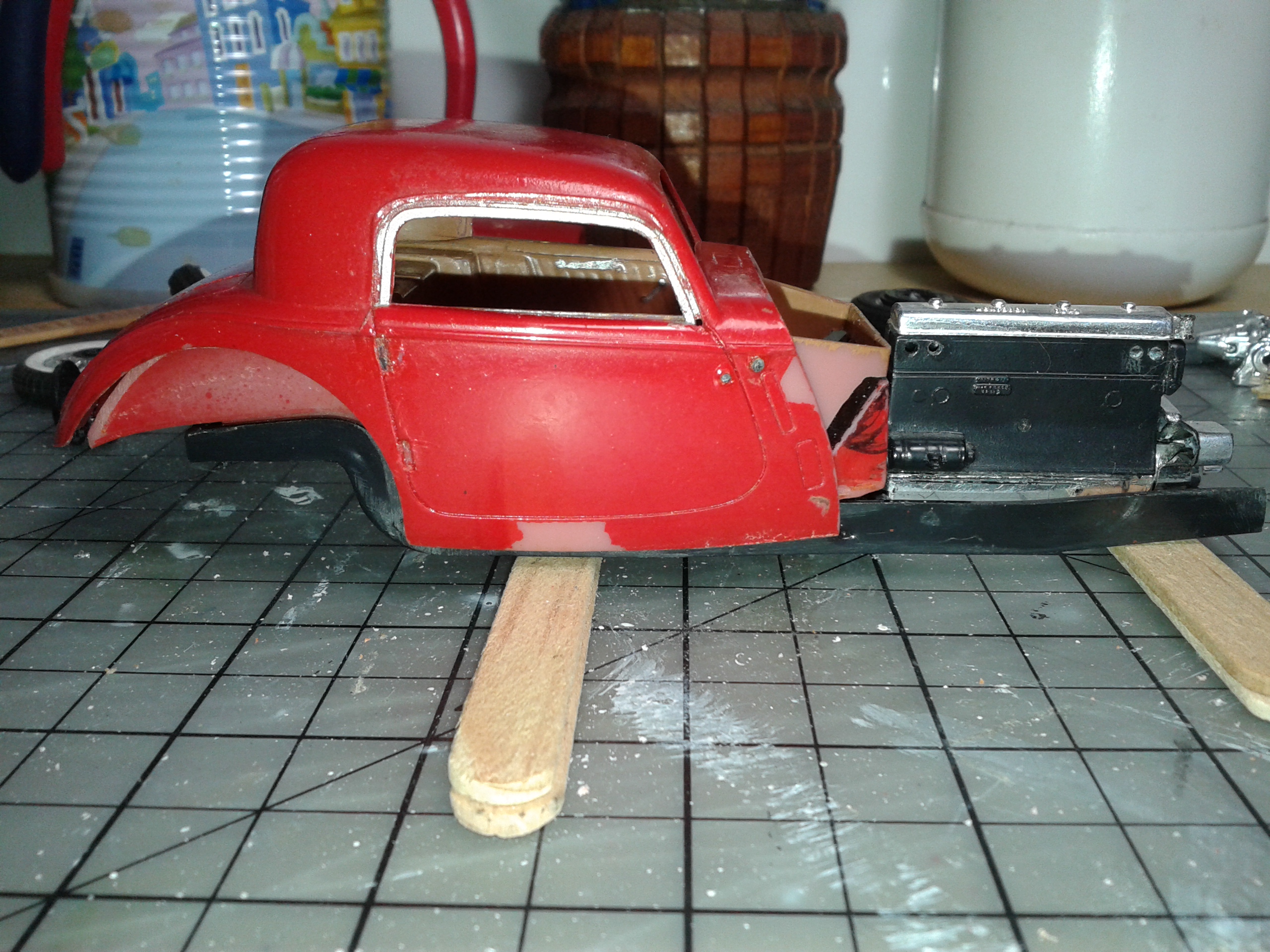

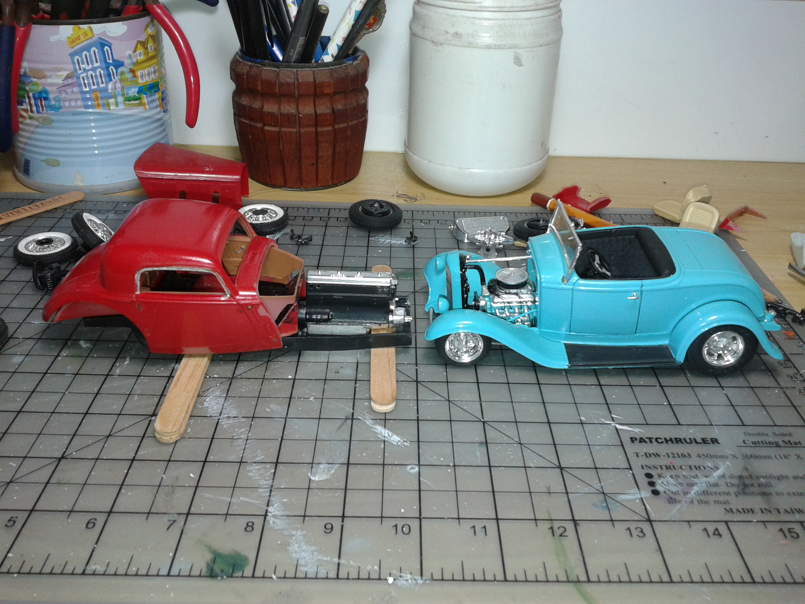

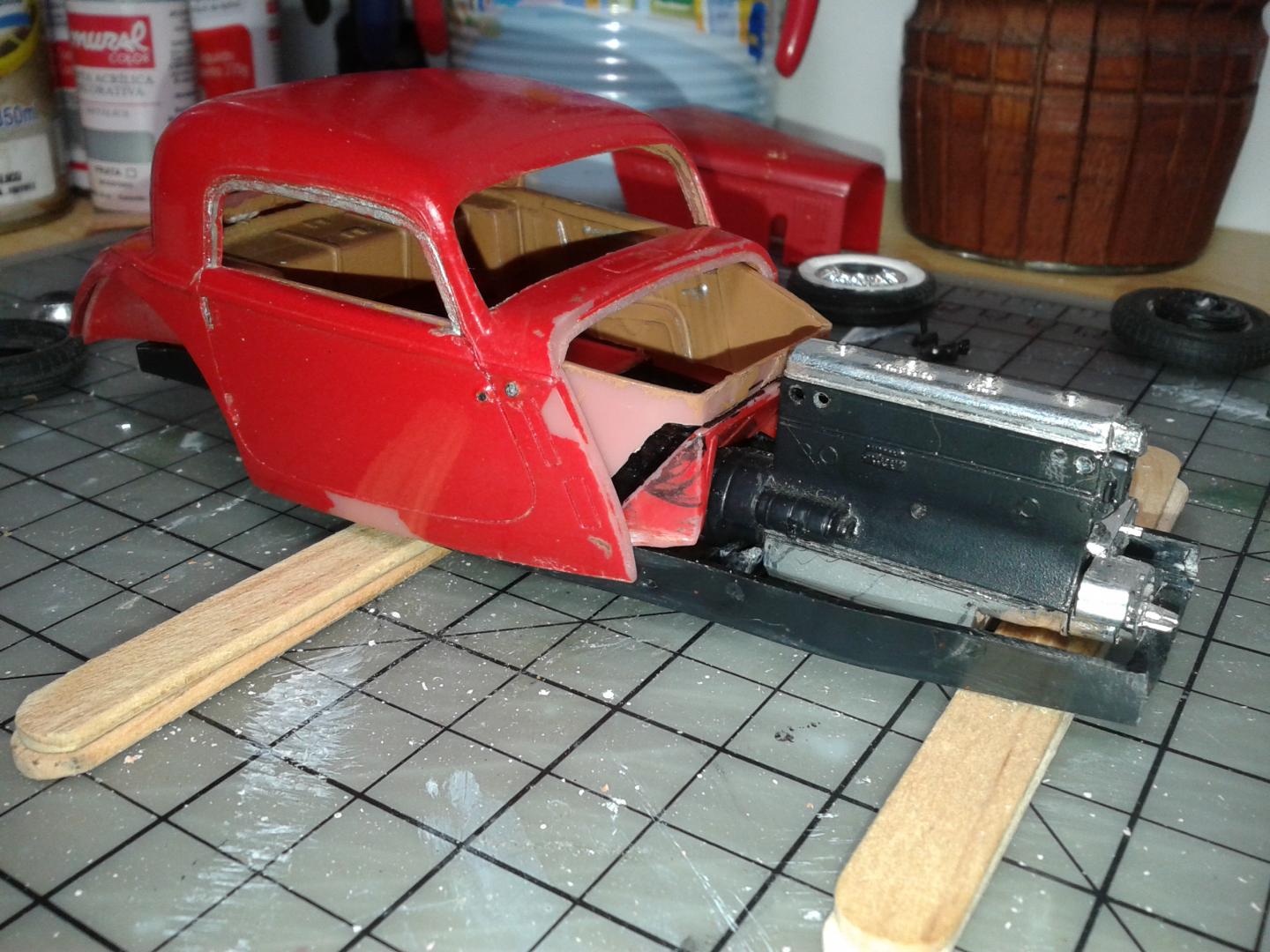

Joca Posted October 4, 2017 Author Posted October 4, 2017 Hi there. I would like to say thank's for all your visits and comments. Very kind of all of you. A little update, see on the phtotos please: have removed all the front suspension looking a way to build a very low front end; following the suggestion from misterNNL removed all the huge front cowl, now I need to redone the interior firewall panels and shorten the chassis and more other things are coming from sure. The best thing about all this stuff is I'm having a lot of fun with this build. The last photo is only to compare the size between the Mercedes and my '32 Roadster. See you soon...

misterNNL Posted October 8, 2017 Posted October 8, 2017 Nice work cutting down that cowl section. The angle of the cut is perfect.In case no one explained the American slang term "digging it",it definitely means he likes it. Glad to see you are enjoying your project.
Joca Posted October 9, 2017 Author Posted October 9, 2017 Nice work cutting down that cowl section. The angle of the cut is perfect.In case no one explained the American slang term "digging it",it definitely means he likes it. Glad to see you are enjoying your project.Thank you Tom. Glad you liked the cutting. I followed your suggestion and this result and a very different visual effect. I'm going in a good way with your expertise.Appreciate your help to I improve my english with the meaning of the term above. And yes I'm enjoying this project and this is better with your help.Regards.

misterNNL Posted October 10, 2017 Posted October 10, 2017 I have been thinking about what I might be tempted to do next if this were on MY work bench.I believe I would shorten the interior bucket to be more in line with that newly redesigned cowl you did so nicely to open up that area just behind the engine.The next thought is just what to do with all that space that is now available just behind the engine.......HMMMMM...lets see..shortening the frame rails would work of course...Or do something really unusual and original and fabricate something unique in that space like some turbo chargers.You could route the engine exhaust to the turbos then to the intake manifold and carbs.Could be a real eye catching set up that would take some work of course but would look very neat.Dare to be different I say!!

blunc Posted October 11, 2017 Posted October 11, 2017 On this particular project, I would advise against cutting open the doors. That would put the body in a very fragile state and if broken might cause you to give up on this build. I feel it would be safe to open the trunk but it will add a level of complexity due to the need of creating the trunk interior space. I'm not trying to discourage you...I'm just pointing out one the realities of opening the trunk, and it's really no harder to resolve than you will have to do with regard to moving the engine bay firewall. Regarding engine induction, just about any side draft style carb system will look great on this, SU's (Jaguar carbs), Webers, Carters (early Corvette), various injection types...or belt driven superchargers like a Magnacharger style or direct drive like Mercedes or Duesenberg. Your choice of style may make it easier to choose features of your hot rod. Period correct would dictate speed (hot rod) parts available at the time the car was produced, Restomod generally means original styling with newer and safer engine, chassis and suspension. Currently, with the changes already made to the body... you have ventured into the traditional arena of "custom car" rather than just a car that has been "hot rodded" with performance parts. If you have the time or desire, try doing some drawings or photoshopping of pictures to see how changing the body lines make an unforgettable car, or a car you'd rather forget.
misterNNL Posted October 11, 2017 Posted October 11, 2017 I hear what you are saying about levels of skill.I have been building models for about 60 years so am fairly comfortable with my current skill level but I see some things on these forums that are truly amazing such as engines made completely from scratch out of metal and know that I will never be able to do that.I am completely OK with that and admire those capable of such things.If you were going to consider those turbos I am sure there are builders on these forums that would more that willing to assist you with that kind of thing.You mentioned opening the truck and doors.Have you ever done that before? Personally I think the trunk easiest but a close look at those door lines tells me there is too little material between the door glass and the roof or the rear door edge for me to attempt that.I see things like that done with great skill but the effort simply is not worth it to me personally.The main thing to remember here is that you should always build to suit yourself and what ever you decide to do will the right thing to make this project into what you want it to be.Is your native language Spanish?
