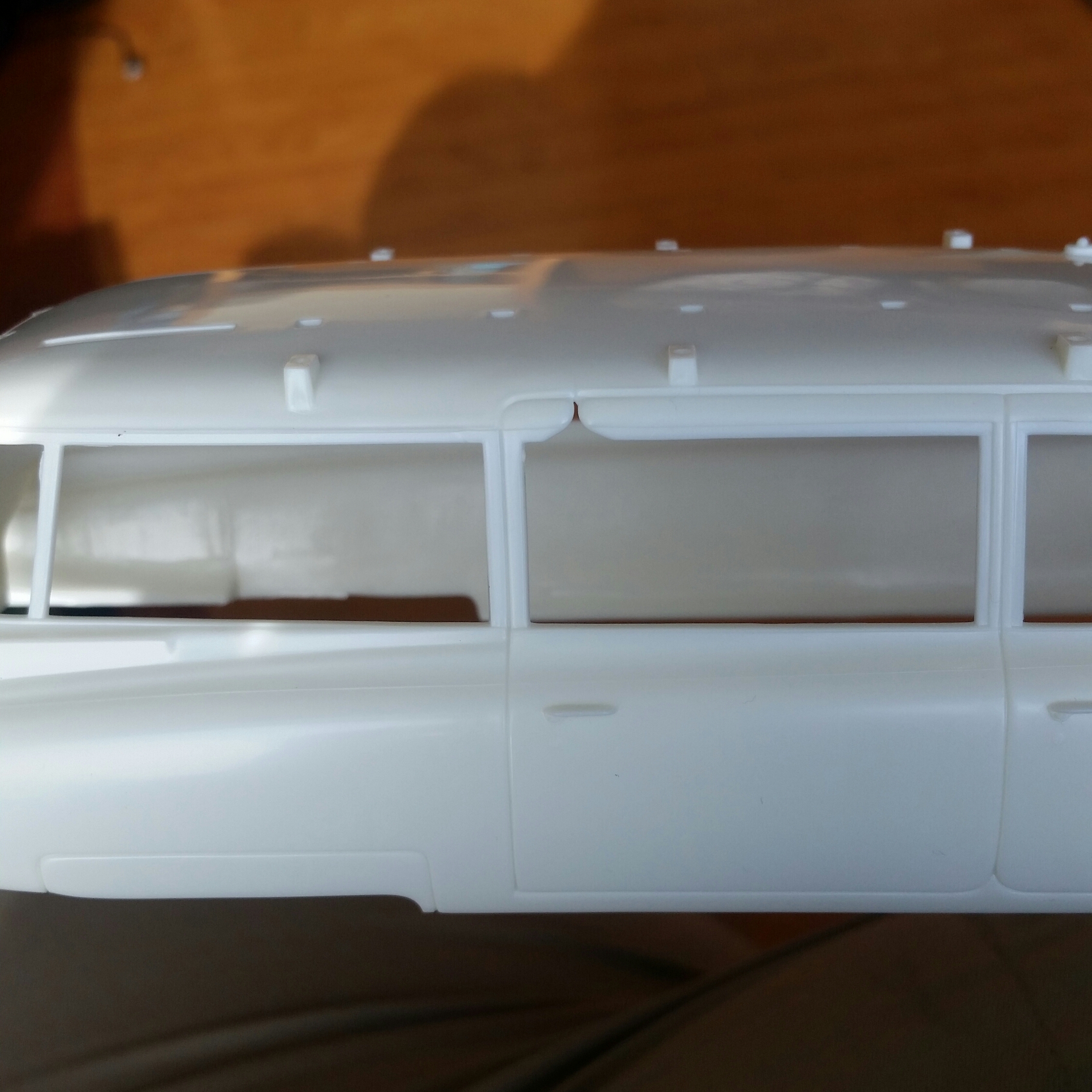

Joe Handley Posted September 17, 2017 Posted September 17, 2017 Any recommendations on how to fix this short shot or should I just email R2? It's the AMT Ecto-1a kit and the store I aquired it from (got a KITT and General Lee glue kits for my birthday and I returned the GL) and it's a bit of a haul to get their.
Jantrix Posted September 17, 2017 Posted September 17, 2017 No I think that's doable. I'd just cut a similarly shaped piece that's thicker, and weld it in with some Tenax. As the plastic softens, really jam the wedge in there to fill the whole notch. Then let it dry and plastic re-harden. Sand to shape and thickness, filler as necessary.
Ace-Garageguy Posted September 17, 2017 Posted September 17, 2017 What Rob said, but file the edges of the missing area straight before you make your insert patch. That way, you don't have to match the curves and depth exactly, as you would otherwise.Simply match the angle, leaving some material sticking down at the bottom for a 'handle'. Plenty of liquid cement, do just as Rob says...really push it in there when it's wet.Let it dry at least overnight, file off the extra from the bottom, and shape.
Joe Handley Posted September 18, 2017 Author Posted September 18, 2017 Thanks guys, that's what I was thinking of doing, I was just hoping for something a bit easier and quicker. I had wondered about getting a second one and maybe chopping the top a wee bit then using a section of roof from a second body to stretch that and patch that hole at the same time. I also have a couple Revell '59 Eldo coupes with crushed roof pillars, will the grill and bumpers fit these bodies?
Snake45 Posted September 18, 2017 Posted September 18, 2017 No I think that's doable. I'd just cut a similarly shaped piece that's thicker, and weld it in with some Tenax. As the plastic softens, really jam the wedge in there to fill the whole notch. Then let it dry and plastic re-harden. Sand to shape and thickness, filler as necessary.I was going to suggest filling the divot with Loctite Superglue Gel and then filing/sanding to shape, but that would work, too. Probably even better. R2 owes you a good body, if you want to contact them and wait for it. But this little divot is VERY fixable.

Joe Handley Posted September 18, 2017 Author Posted September 18, 2017 I sent a message to R2 after I got home from the hospital last night and got an email back this morning, they'll be sending a new body for my Ecto-1a kit.
Joe Handley Posted September 24, 2017 Author Posted September 24, 2017 The new body showed up on Thursday!
Joe Handley Posted September 30, 2017 Author Posted September 30, 2017 Good deal, and the best fix of all.Maybe I need to pick up a second the next time I'm at Michael's or HL with one of their coupons and try my hand at chopping one of these now too!
