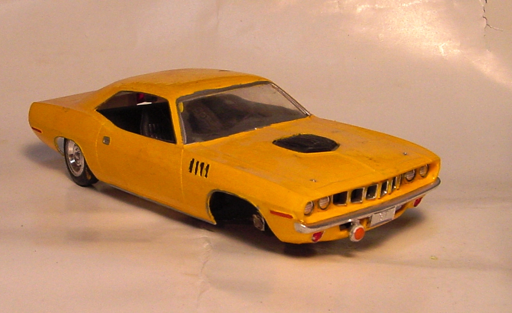

afx Posted September 24, 2017 Posted September 24, 2017 Modified the 1/24 Revell grille to fit the new tool Cuda. Grafted on the lower valance and reworked it to shape.
Can-Con Posted September 24, 2017 Posted September 24, 2017 Looks good JC.Did you have to do any mods or did the parts fit right in? I can't see any cuts.
afx Posted September 24, 2017 Author Posted September 24, 2017 Thanks Steve. I first had the separate the grille from the valance, the 1/24 scale kit has them molded as one piece. Then sectioned the grille in between the headlights at both ends to reduce the length. Then reshaped it to fit the grille opening on the 1/25 scale body.For the valance I had to remove a section, its molded integral to the body and graft in a section of the 1/24 scale part. Then worked it to shape.Definitely not a drop in parts swap.

afx Posted September 24, 2017 Author Posted September 24, 2017 I've been asked to better illustrate how I made the grille. Here is a photo of the 1/24 scale grille and valance. After separating the grille I removed a section of material between the headlights. This moved the headlight openings closer together and reduced the overall length to allow it to fit the 1/25 scale body.

afx Posted September 26, 2017 Author Posted September 26, 2017 (edited) Your welcome Jeremy and thanks Marty & Kevin. I choose the Revell 1/24 scale grille over the Johan as I think it is more accurate. The Johan grille is an arc rather than the correct V shape. Edited September 26, 2017 by afx

espo Posted October 9, 2017 Posted October 9, 2017 Must be nice to have DEEEEP POCKETS. I like the look of the 1:1. Your grill surgery looks just like it should.
