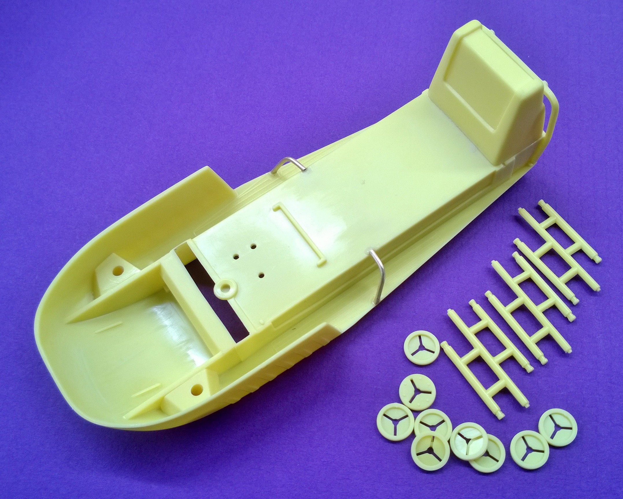

Casey Posted August 5, 2018 Author Posted August 5, 2018 (edited) Good ideas, guys, thanks. I decided to skip making a new steering support bracket and stick with the box stock piece, but I still need to address the fuel tank. I haven't made a ton of progress, but have kept busy off-and-on by sanding and preparing all of the parts for paint-- mold seam and ejector pin mark removal, etc. I also replaced the styrene foot loops (not sure what the correct term is) with brass tube as the box stock pieces had some deep ejector pin marks: Edited August 5, 2018 by Casey
