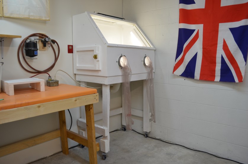

Miatatom Posted January 7, 2018 Posted January 7, 2018 Considering your situation, Jeff, the cake cover thingie is probably perfect for you. Cheap too! As for a paint booth, are you really using an enclosure or just one of the exhaust fan systems that many folks call a booth? To me, a booth is an enclosure with some sort of control over air flow, filtration and exhaust. Here's a pic of it originally. I've made several modifications to it since I first built it. I'll post some pics sometime.

DiscoRover007 Posted January 7, 2018 Posted January 7, 2018 On 1/7/2018 at 2:36 AM, Miatatom said: Considering your situation, Jeff, the cake cover thingie is probably perfect for you. Cheap too! As for a paint booth, are you really using an enclosure or just one of the exhaust fan systems that many folks call a booth? To me, a booth is an enclosure with some sort of control over air flow, filtration and exhaust. Here's a pic of it originally. I've made several modifications to it since I first built it. I'll post some pics sometime. Expand Wow that is an epic set up. What did that cost you and do you still have the dimensions? Would love to mimic that one day.

Miatatom Posted January 8, 2018 Posted January 8, 2018 (edited) On 1/7/2018 at 3:28 PM, DiscoRover007 said: Wow that is an epic set up. What did that cost you and do you still have the dimensions? Would love to mimic that one day. Expand Initially, I had about $230, but the modifications I've made have added to the price. Probably around $300, I guess. Some of the things I've done is add much, much, much more lighting and enlarging the door. I'll post some more pics and a description. Edited January 17, 2018 by Miatatom
Miatatom Posted January 8, 2018 Posted January 8, 2018 Oh, dimensions are 2' deep, 3' wide and 3' tall.
Cornpatch Posted January 8, 2018 Posted January 8, 2018 On 1/7/2018 at 2:36 AM, Miatatom said: Considering your situation, Jeff, the cake cover thingie is probably perfect for you. Cheap too! As for a paint booth, are you really using an enclosure or just one of the exhaust fan systems that many folks call a booth? To me, a booth is an enclosure with some sort of control over air flow, filtration and exhaust. Here's a pic of it originally. I've made several modifications to it since I first built it. I'll post some pics sometime. Expand Oh heck no I don't use anything that elaborate., that is a great looking booth. My father built mine, seems like a hundred years ago now. It's built out of cheep plywood, it's far far from perfect but it works now as it did than. It was made to keep the paint from getting all over the garage when I was younger, a lot younger. Has a little hole where you put the hose in and a small blower (original blower) turn it on and out goes most of the over spray. Line the inside with newspaper and change as needed. Crude but it works. When you relay on Social Security for a lot of your income, you sure as hell can't afford anything like yours,. You said that you built it, hey wood ain't cheep. 200.00 hell if I spent that, my dogs wouldn't get to eat for a couple of months, and that ain't going to happen, they eat first than I eat the scraps. LOL LOL Jeff
Miatatom Posted January 9, 2018 Posted January 9, 2018 Thanks for the compliments, Jeff. Since I work in the basement and spray lacquers a lot, I had to build something to get the fumes out and provide some sort of dust control. No method is perfect but this booth helps.
