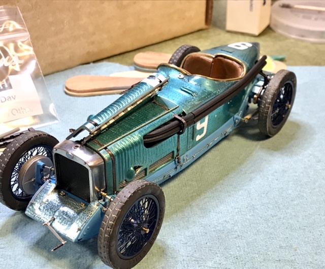

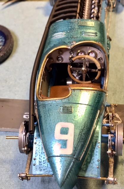

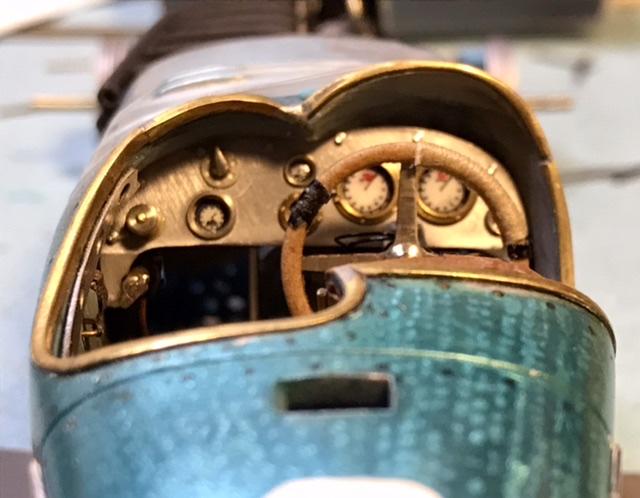

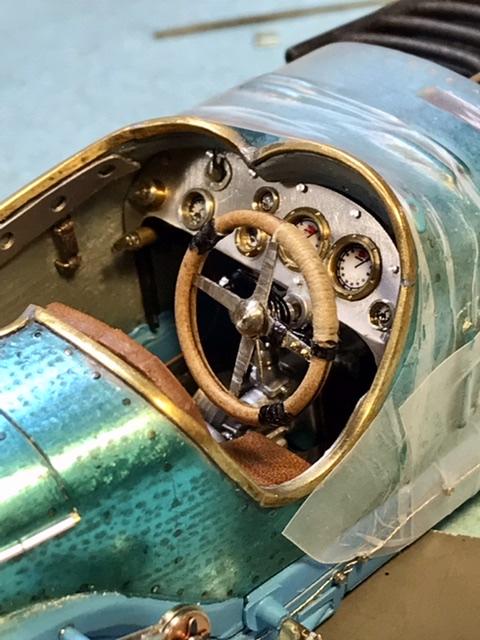

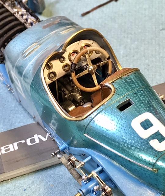

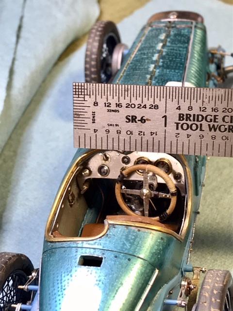

absmiami Posted November 19, 2022 Author Posted November 19, 2022 I’ve learned a thng or two also - but my geography is still dismal - wedding was in North Adams - steering wheel - which had been sitting in a parts bag for too long - is finally installed …

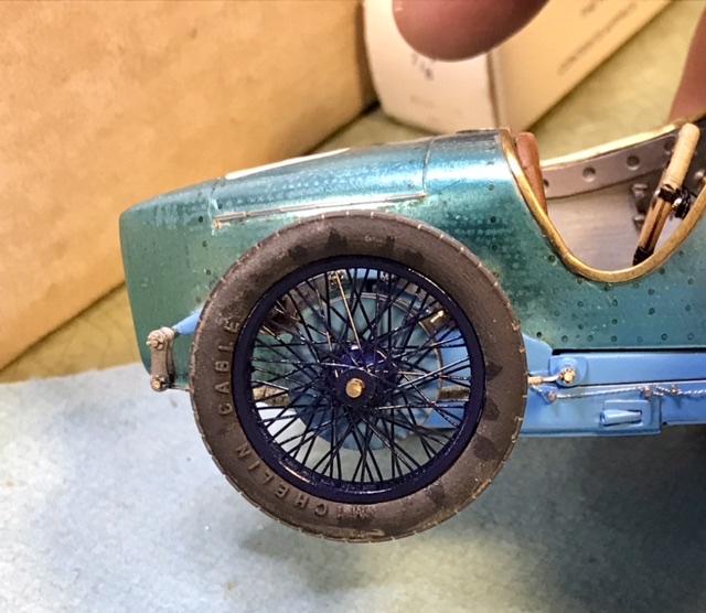

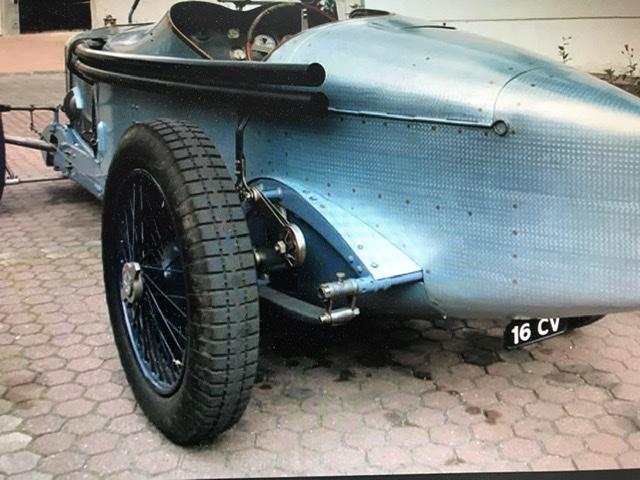

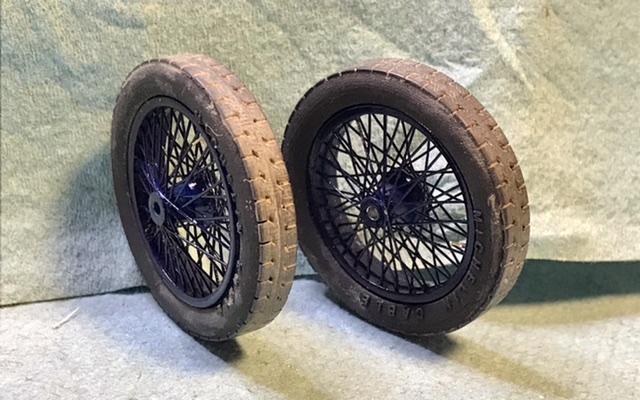

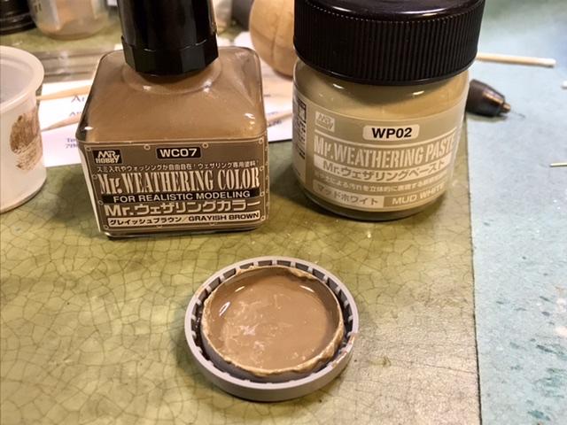

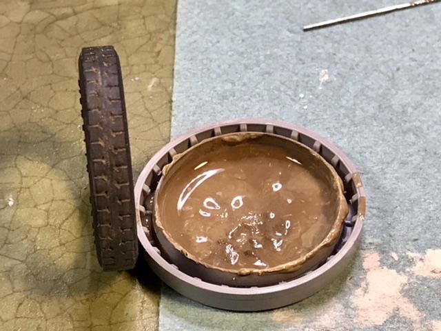

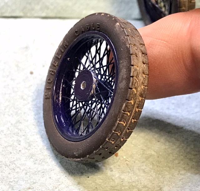

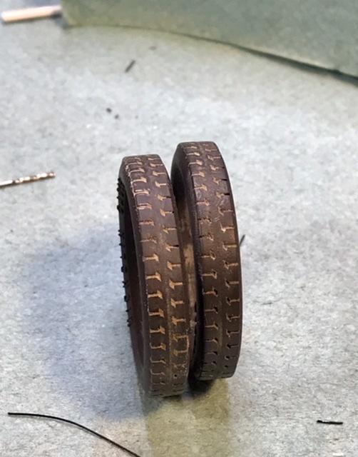

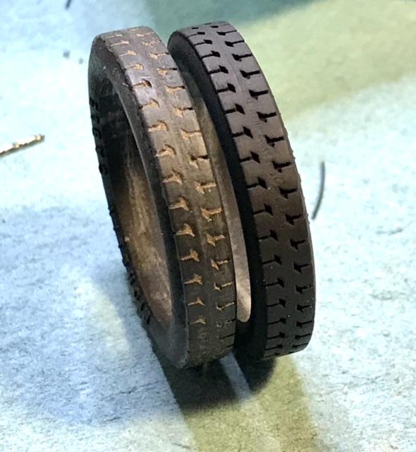

absmiami Posted November 19, 2022 Author Posted November 19, 2022 Tire treads need some unpaved road course muck - i’ve mixed a stew of two paints that military modelers use alot - with some added pumice - just brushed it on and toweled off the excess …
absmiami Posted November 19, 2022 Author Posted November 19, 2022 Gotta check my limited references again - think the tire lettering is unpainted but not certain …
Straightliner59 Posted November 19, 2022 Posted November 19, 2022 2 hours ago, absmiami said: Gotta check my limited references again - think the tire lettering is unpainted but not certain … Yer killin' it with this project, Mr. Sapiro! Wheels and tires are magnifico!
absmiami Posted November 20, 2022 Author Posted November 20, 2022 Thank you Mr Straight much credit to Pico for these tires - which he 3D designed and printed following his careful research ….
Pierre Rivard Posted November 20, 2022 Posted November 20, 2022 Andy, the cockpit has come together in such a beautiful way. Amazing considering the scale. The whole dashboard on this thing is what, maybe 1.5 inch wide?

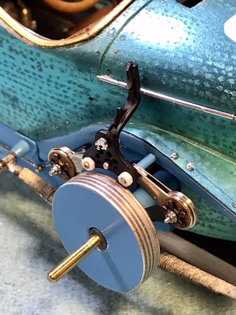

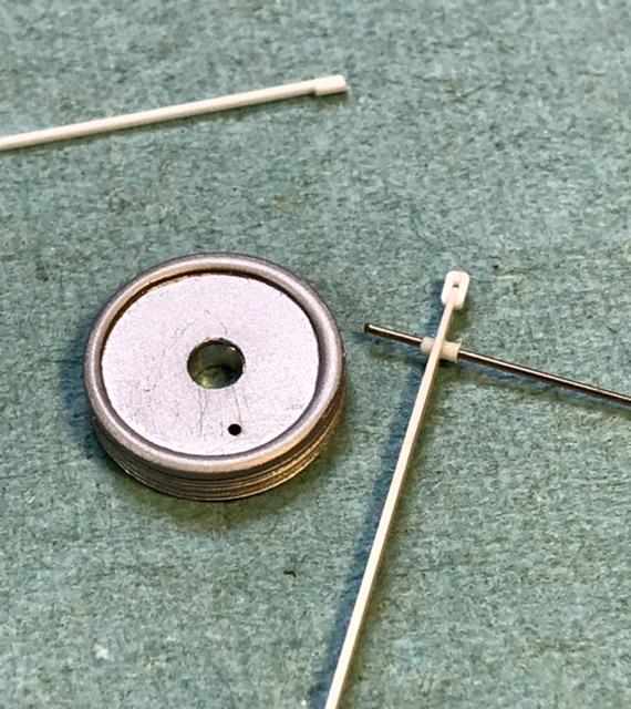

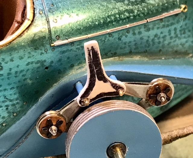

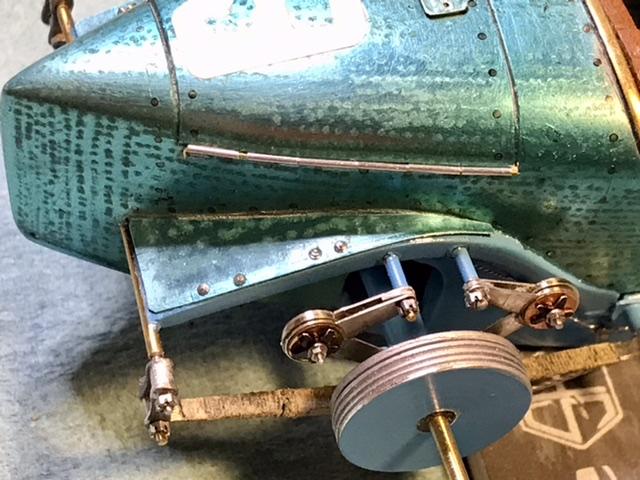

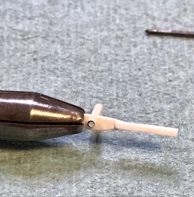

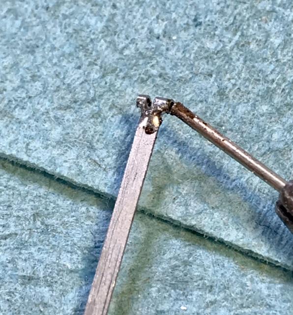

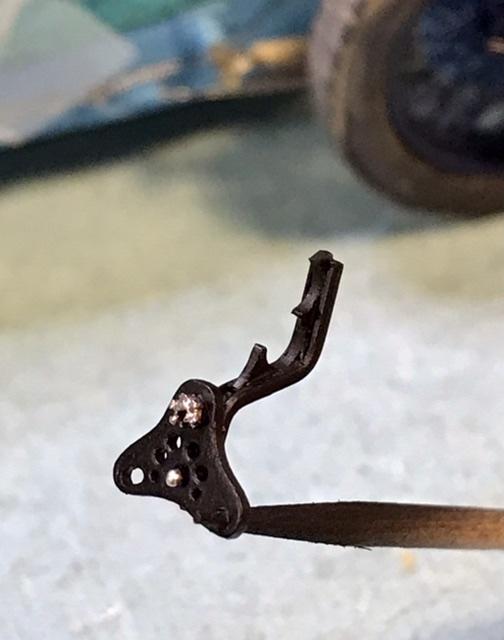

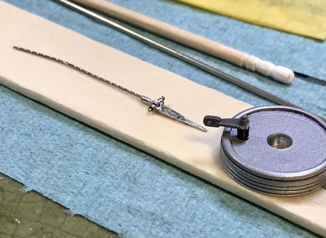

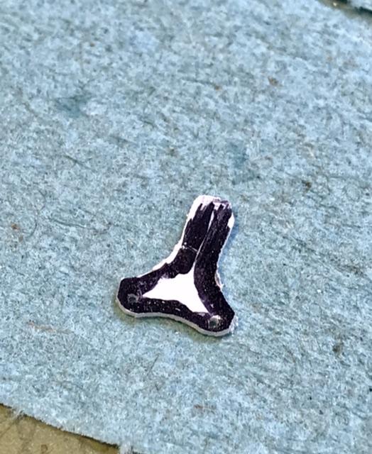

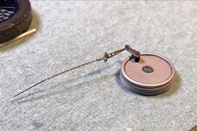

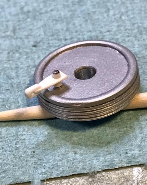

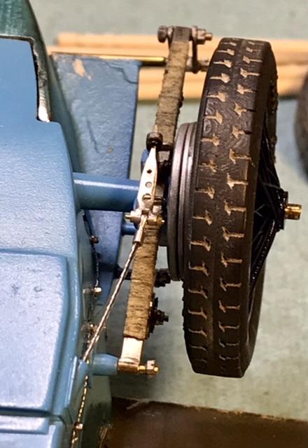

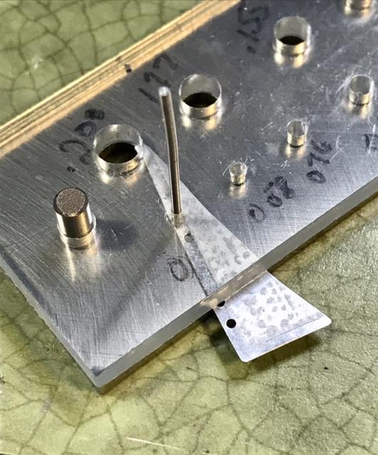

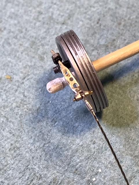

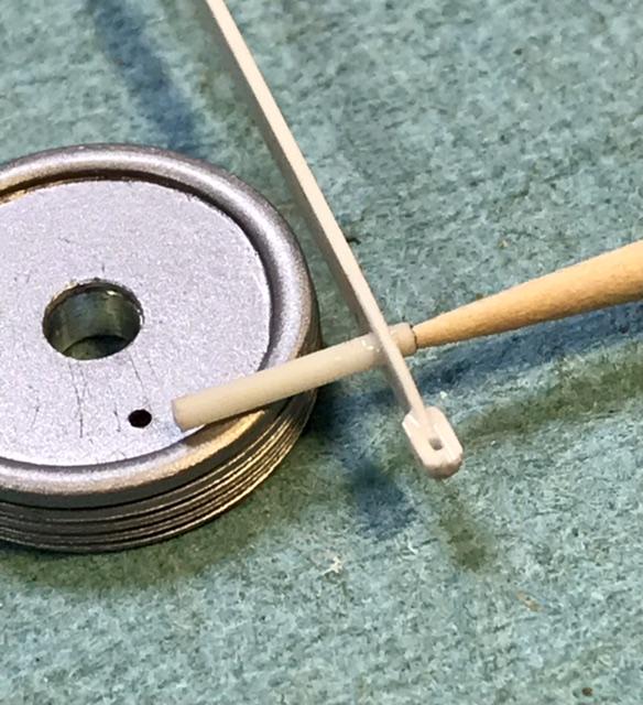

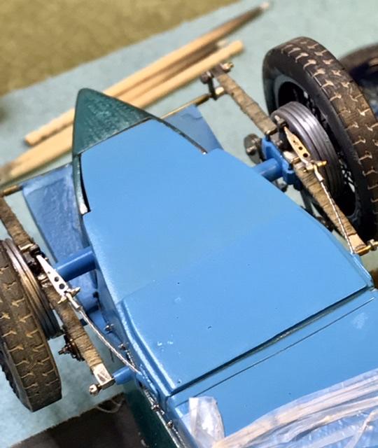

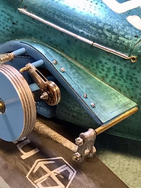

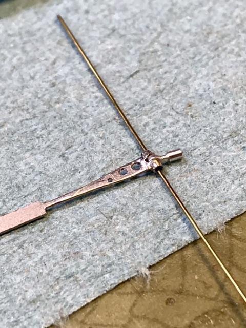

absmiami Posted November 22, 2022 Author Posted November 22, 2022 The rear brakes are cable operated - like the fronts - made levers from Evergreen stock -

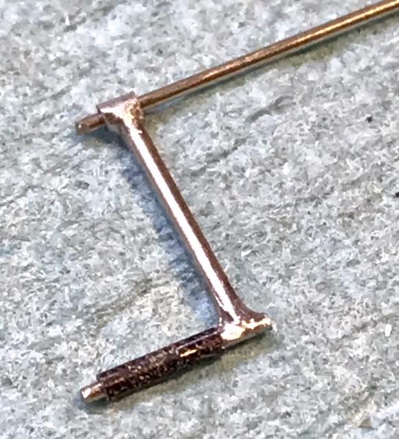

absmiami Posted November 22, 2022 Author Posted November 22, 2022 The cable wire is fastened - glued - into a couple of RB Motion banjo fasteners - the fasteners are then bolted to a couple of nickel silver “guides” that slip into the eyelets in the two levers …

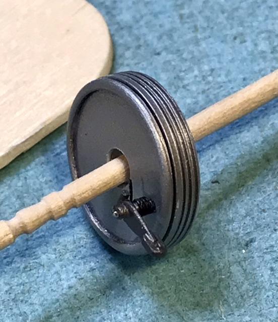

absmiami Posted November 22, 2022 Author Posted November 22, 2022 With the brake drums glued to the axle - finally -

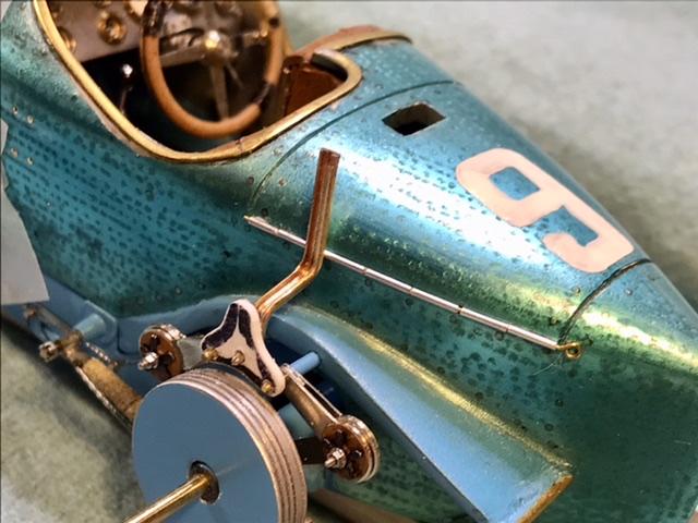

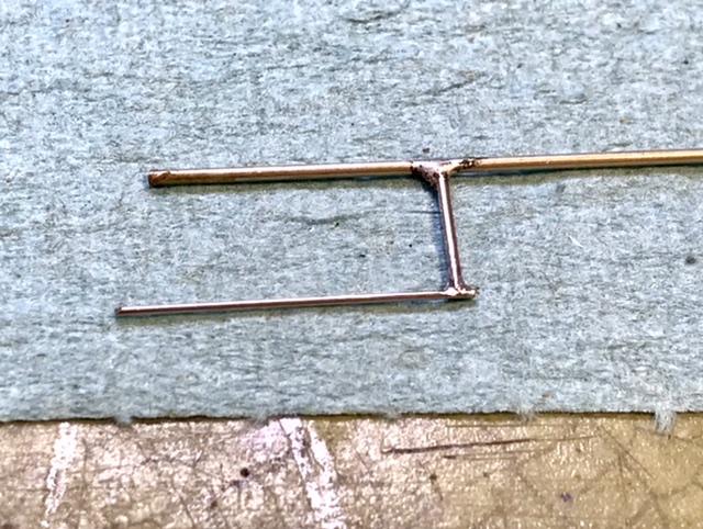

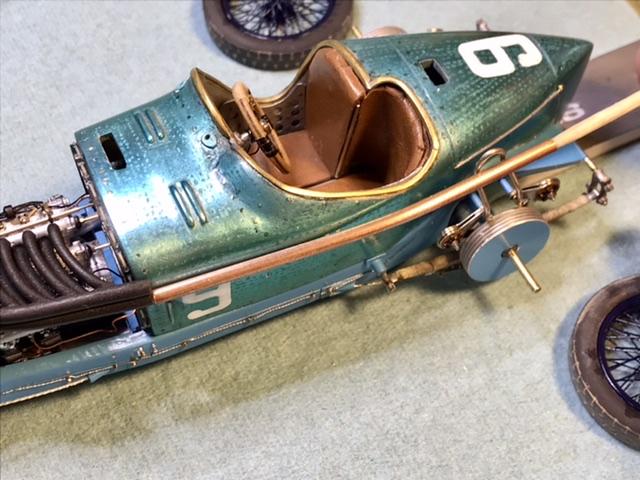

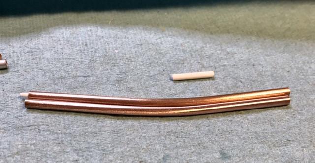

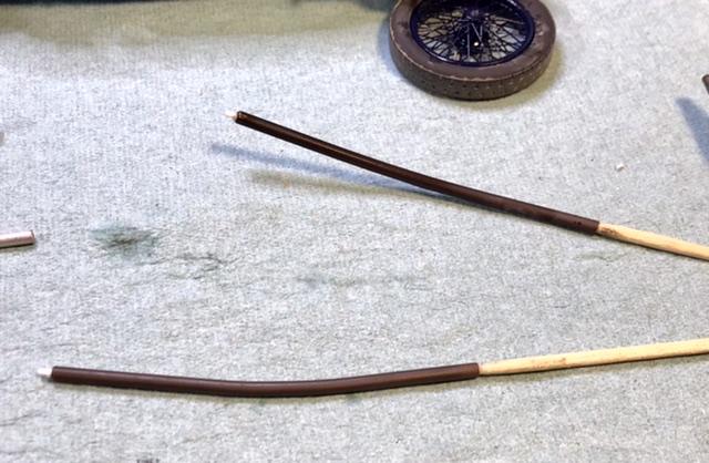

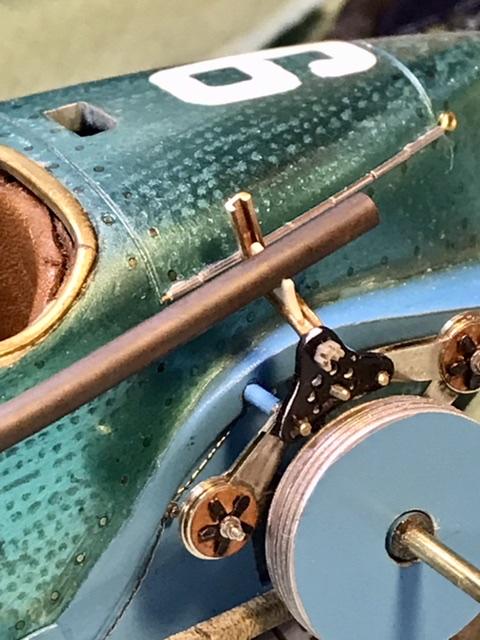

absmiami Posted November 25, 2022 Author Posted November 25, 2022 Thanks Mr C … the exhaust pipes were made from equal lengths of .092 copper tube - just over 2 inches in scale- each has a slight bend - after they were annealed -
absmiami Posted November 25, 2022 Author Posted November 25, 2022 The finish needs to match the exhaust headers - first by dipping them in Blacken-it - then painted with gun metal -

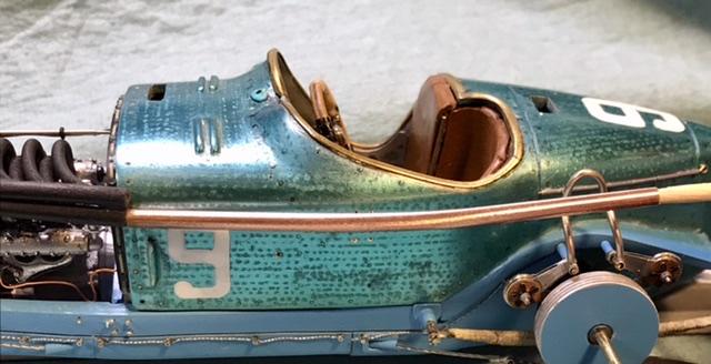

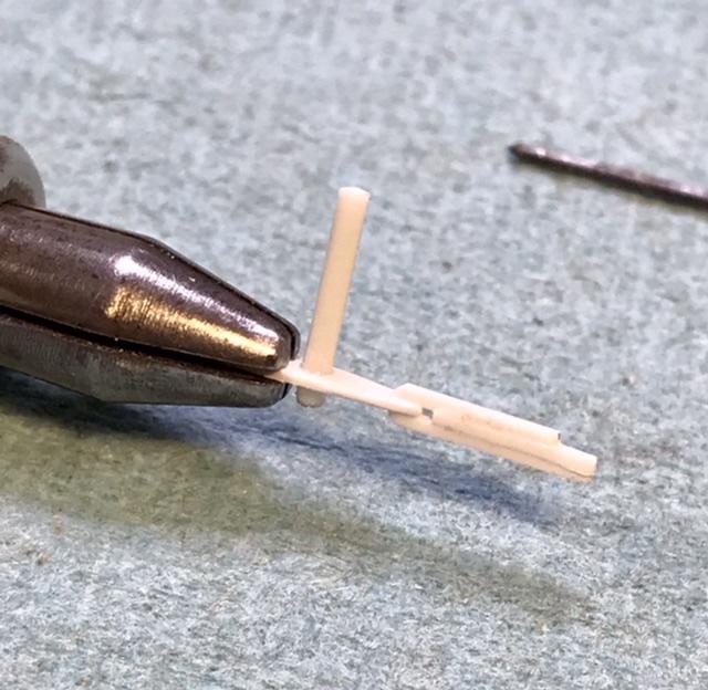

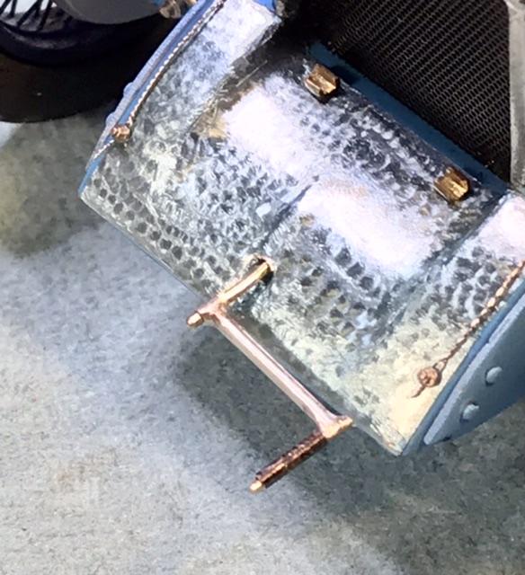

absmiami Posted November 25, 2022 Author Posted November 25, 2022 The pipes are held at the ends by a bracket that bolts on to the pegs that secure the tips of the friction shocks - my initial stab at this part was …. A turkey … a device made from nickel rod that just wasn’t spec - the correct part is visible in this picture peaking out from behind the tire ..
absmiami Posted November 25, 2022 Author Posted November 25, 2022 So the spec part is a 2 peice affair made from some .030 Evergreen sheet and and some brass channel - w some plastic guides glued into the channel to grasp the pipes …
absmiami Posted November 25, 2022 Author Posted November 25, 2022 This is the mock up of the assembly - but before its attached …

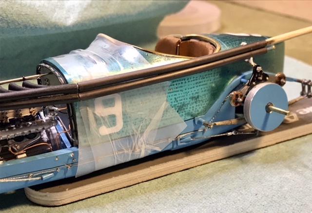

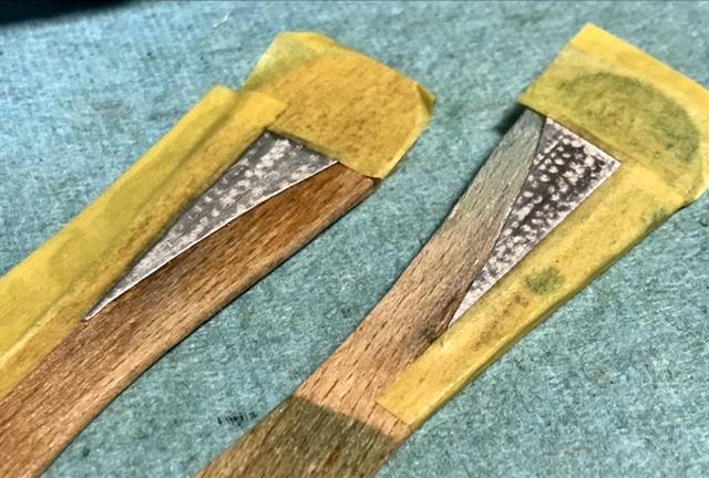

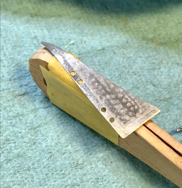

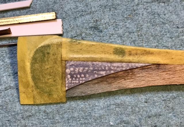

absmiami Posted November 25, 2022 Author Posted November 25, 2022 I need to do some final engine turning - this time on two panels that cover the final lengths of the frame members ….
Bainford Posted November 25, 2022 Posted November 25, 2022 Andrew, this just gets better and better. Lovely detail work. I'm really enjoying this build.
absmiami Posted November 25, 2022 Author Posted November 25, 2022 Thanks again Mr B - panels on - left and right - with some bolts fr the AnyZ line -

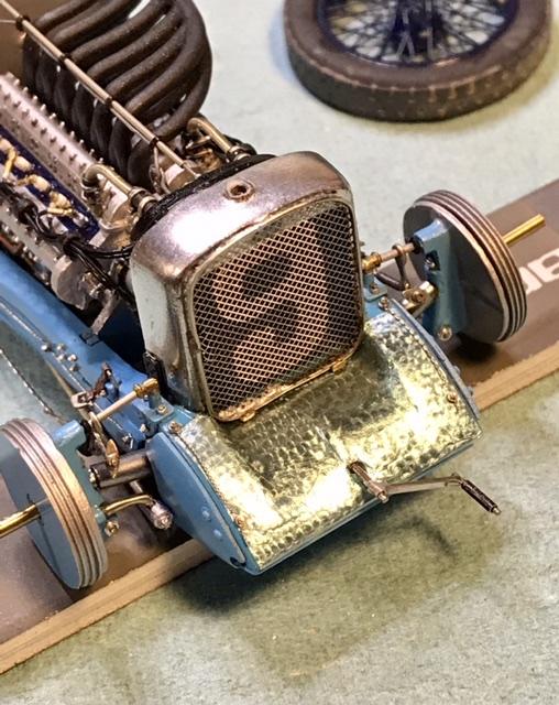

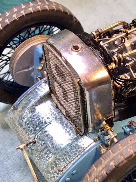

absmiami Posted November 25, 2022 Author Posted November 25, 2022 Radiator screen installed - it sits in two brass slots at the base and is glued to two small pegs at the top - so it sits about 3/4 scale inch clear of the rad shell …
