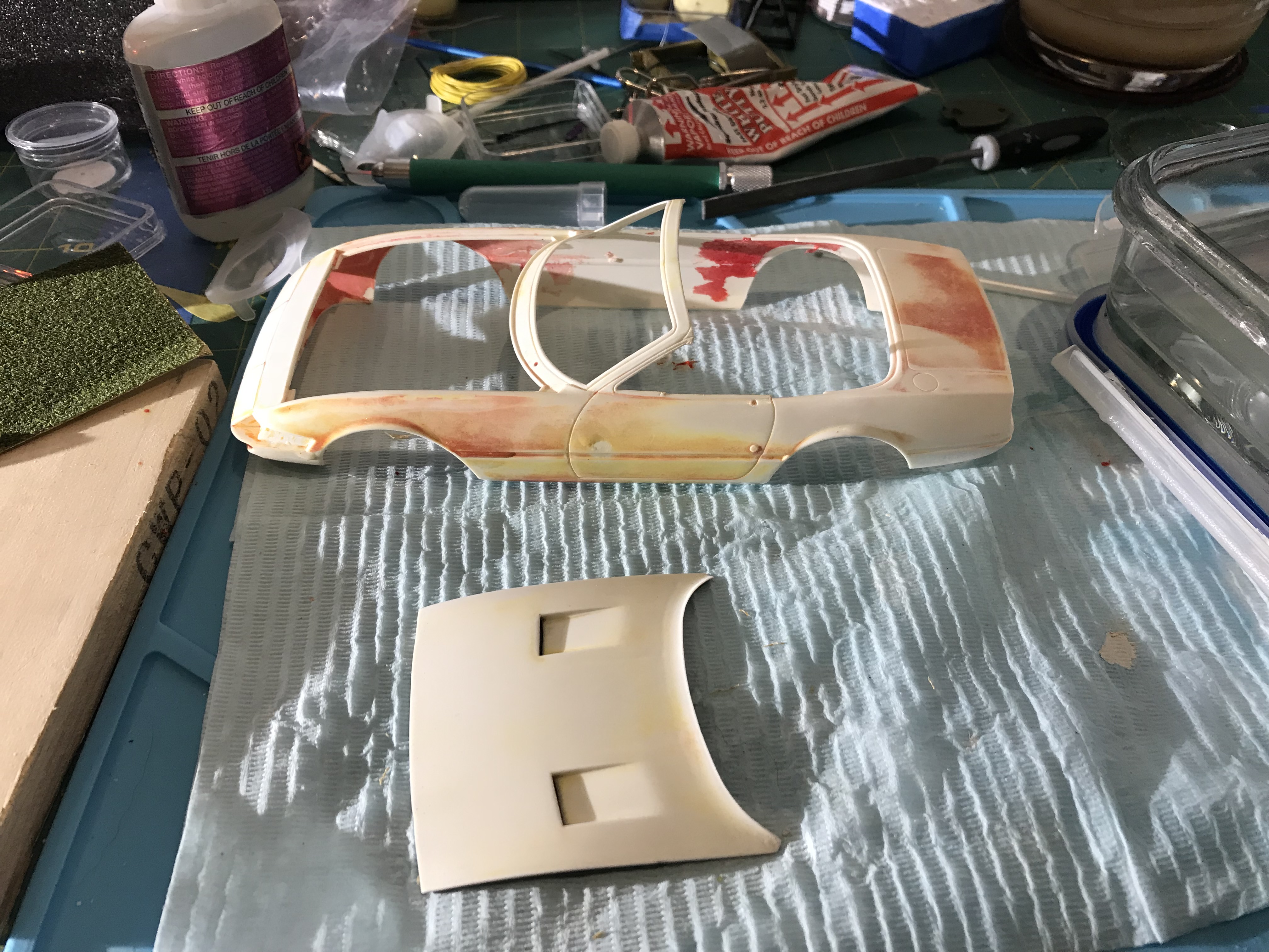

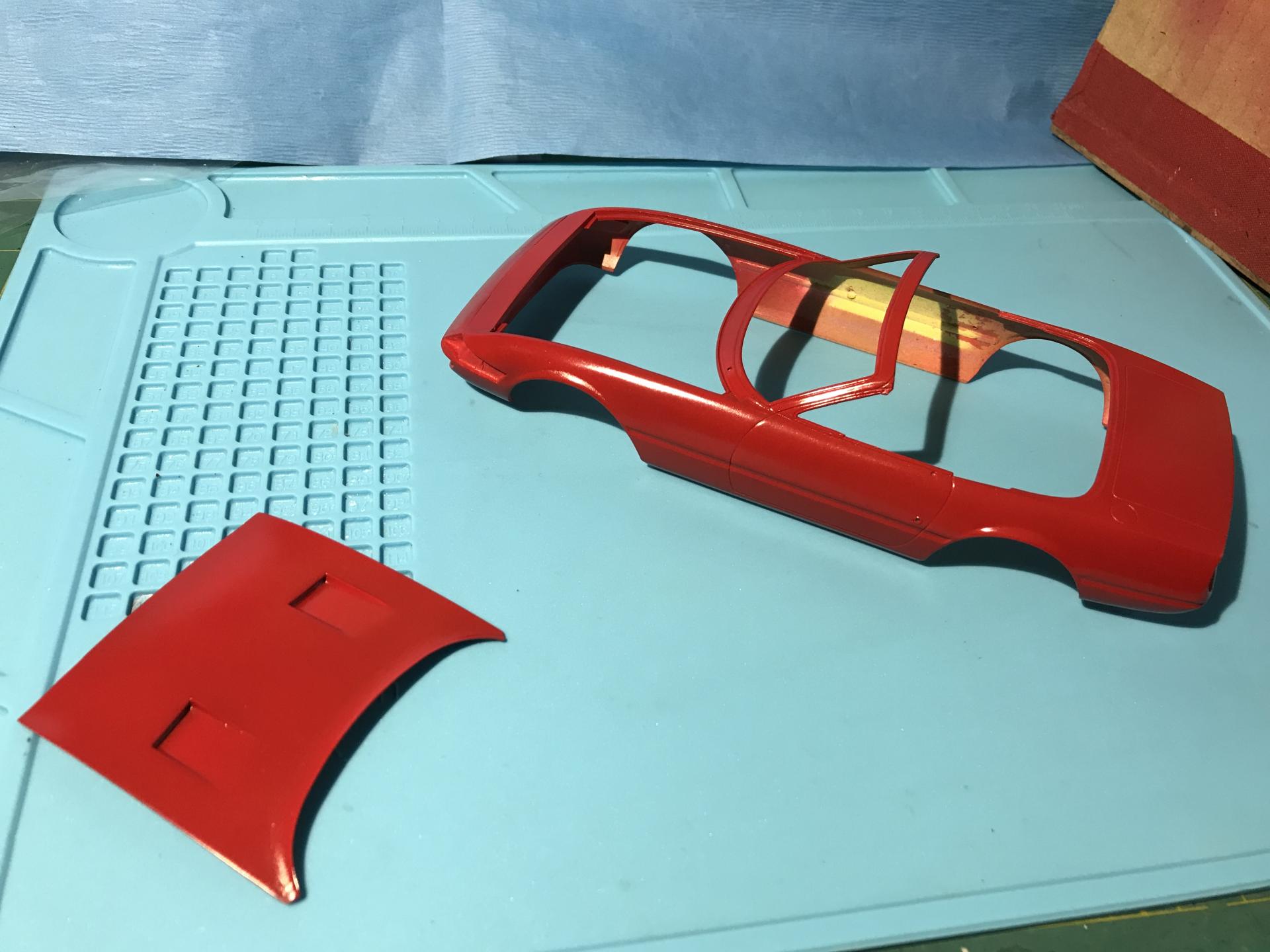

A bit of a setback on this build.

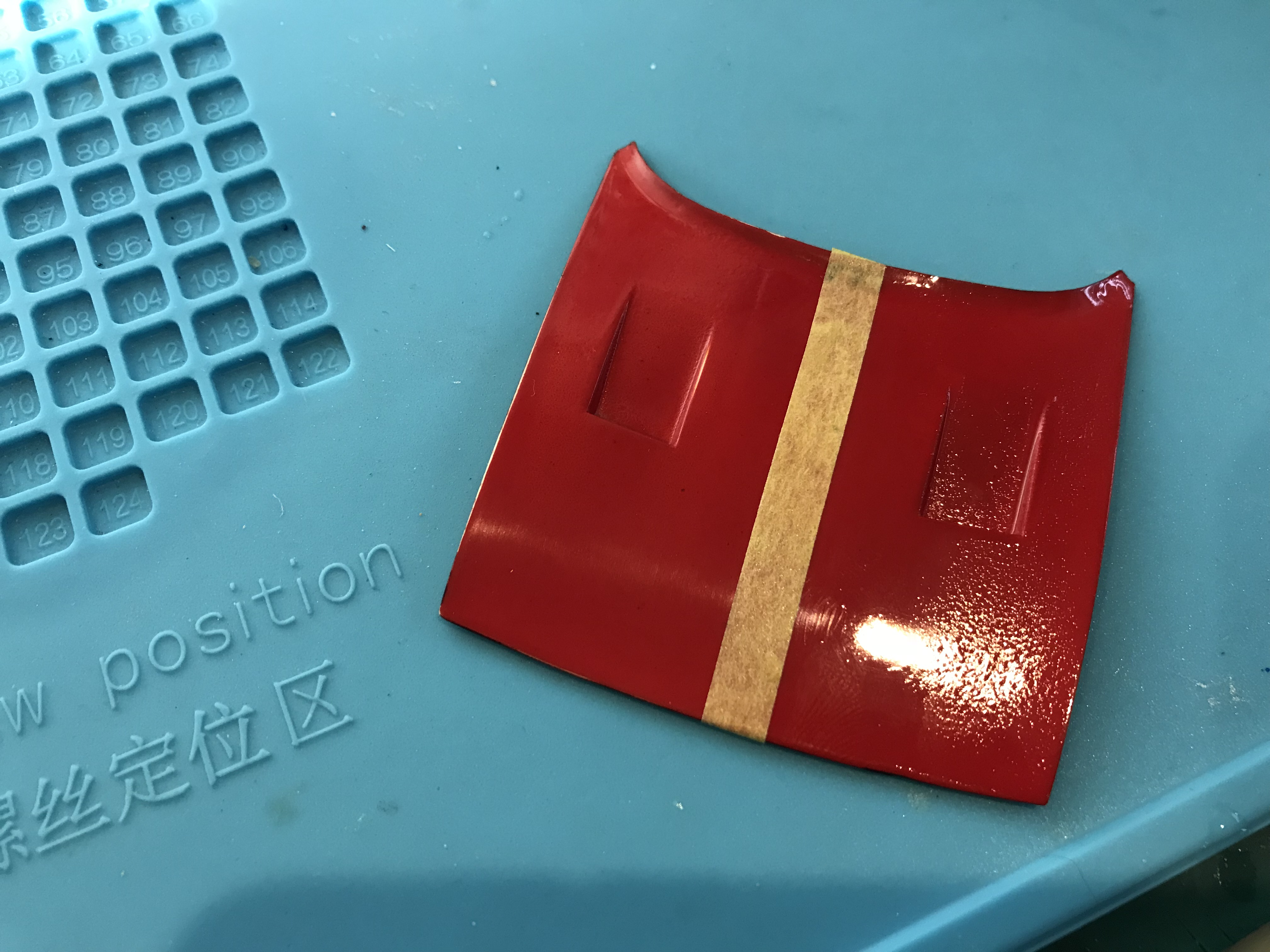

I have FUDGED up the Gravity Clear coat somehow...my suspicion is water contamination as my trap had standing water in it after the disaster and painted on a pouring wet day.

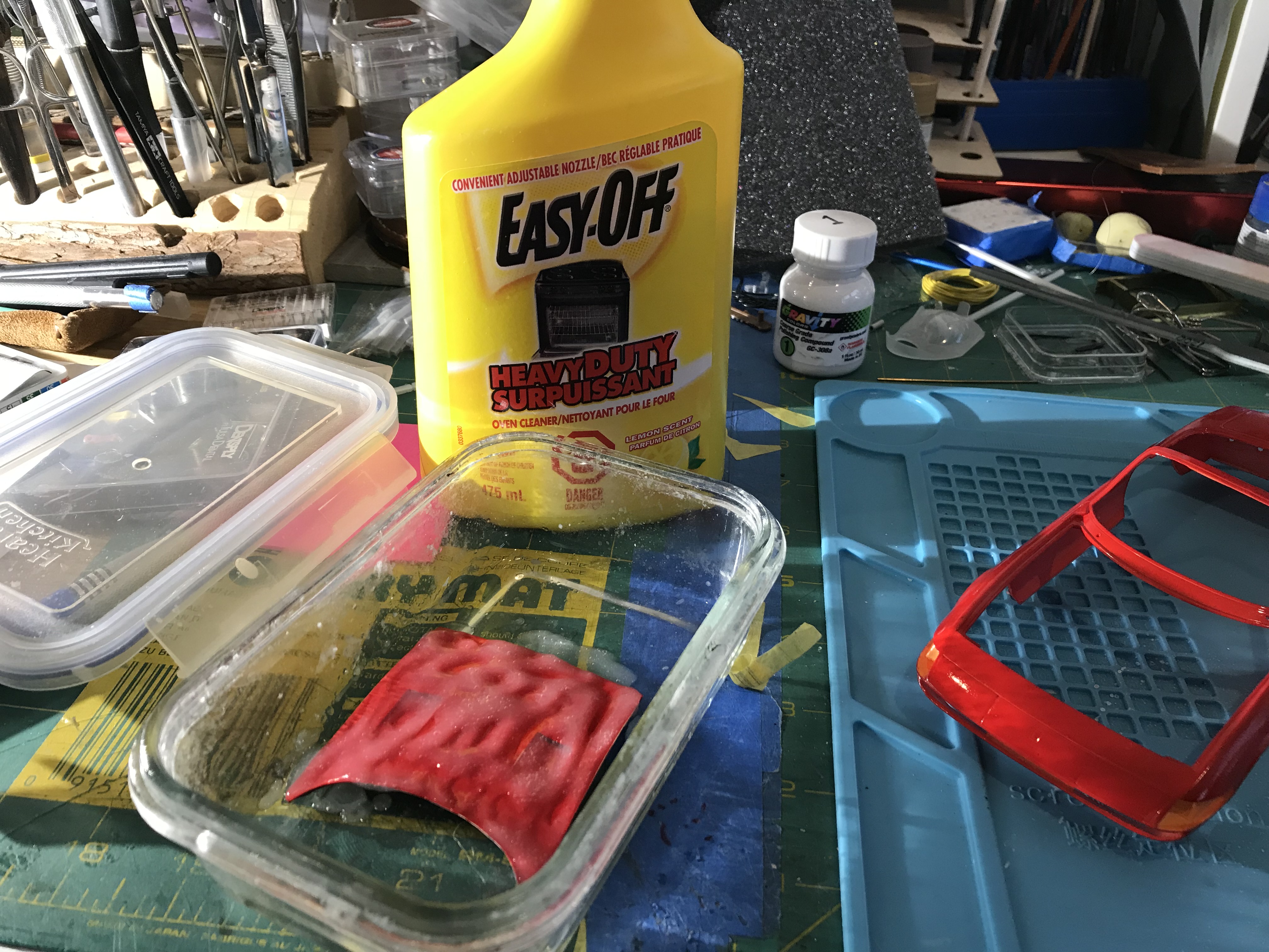

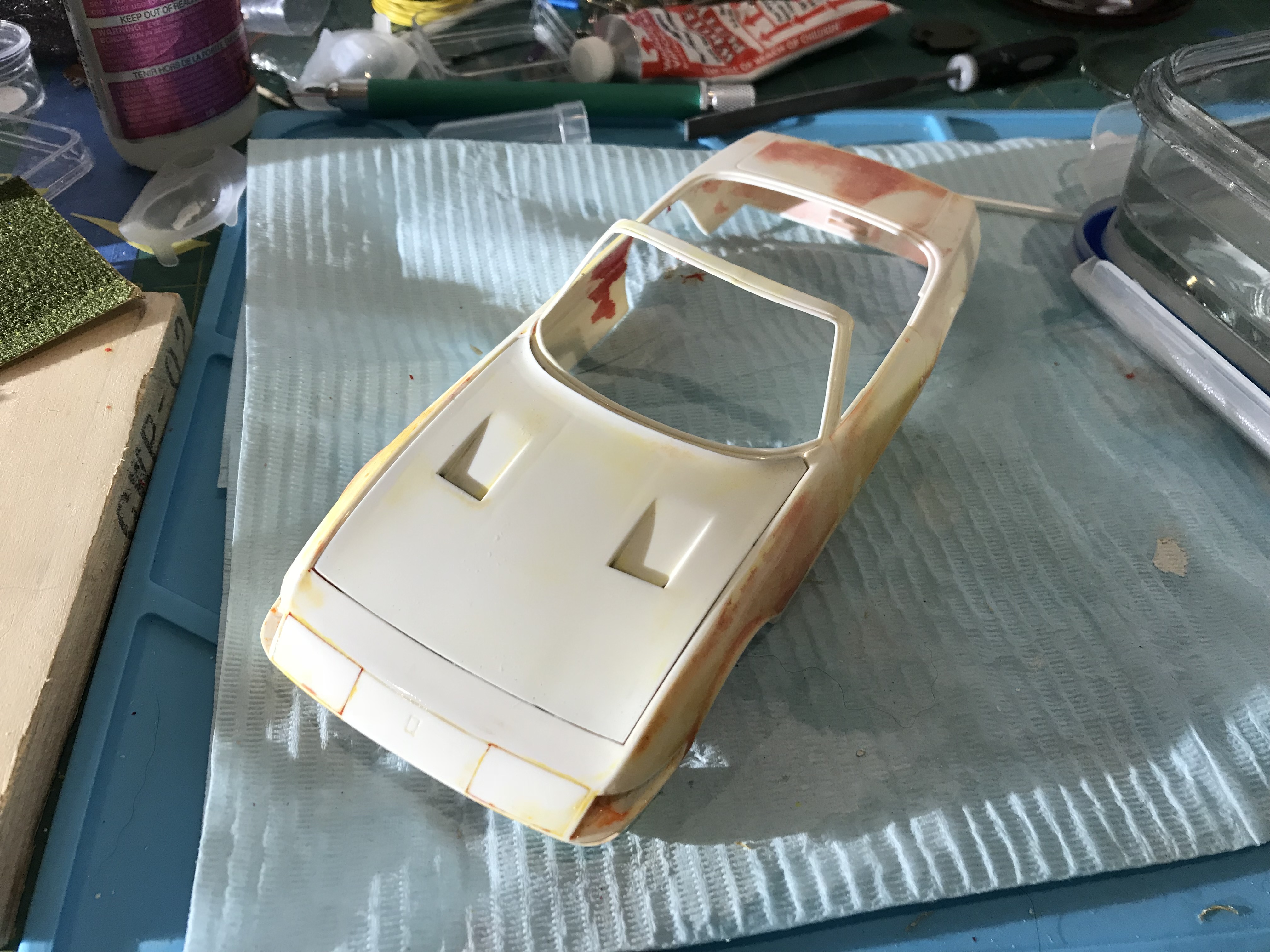

I tried a sand off, but cannot get the paint shiny enough and it would be a pain to sand the entire body...so oven cleaner, strip and repaint
Edited by Twokidsnosleep
Nope it is the body as well
Thought it was the red paint layer, but I am suspecting some water in the air line and the clear went wonky.
You are dead on; I will strip it, repaint and clear and make it even better

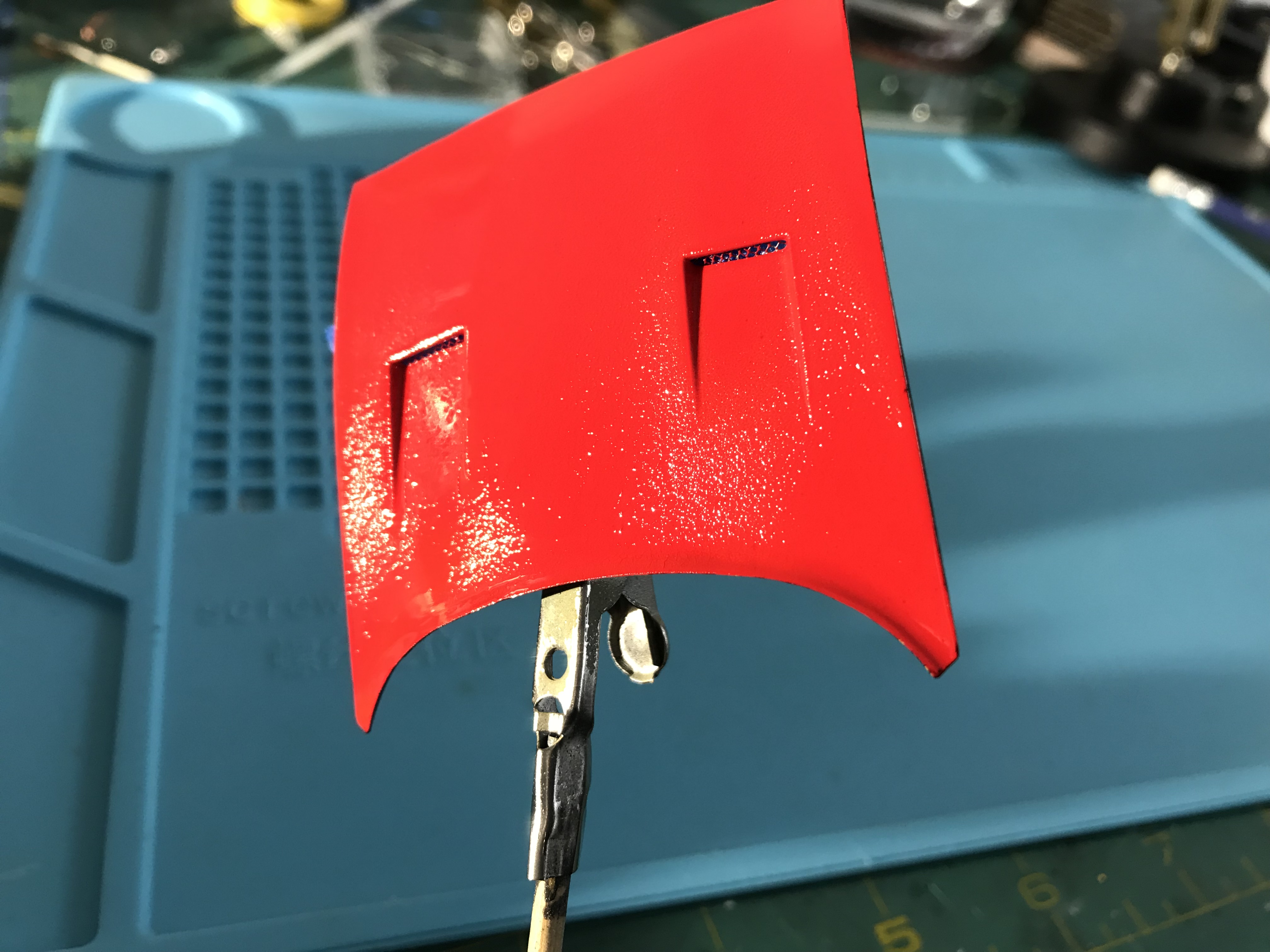

My guts say it was water contamination not the clear itself. Some areas of the body were perfect, smooth and shiny, others wrinkly and orange peeled

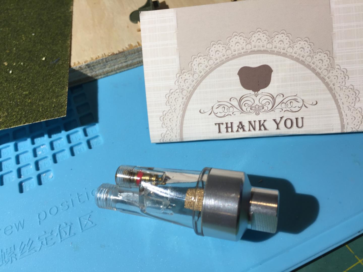

So I bought a little in line filter and tested it out.....cheap off of AMAZON97496178-92D0-4F7A-97F5-1848FA16B450.thumb.jpeg.8eb5b96890be571333668ace9f54fed4.jpeg
After doing a test spay, I tore it all apart just to have a look.....my main moisture trap is soaking wet again, there is moisture on the top o-ring of the in-line filter and when I blow air  without the airbrush attatched, it blows wet air out:blink: so definitely a water issue with me spraying.
I tore it all apart to  let it dry out.
So I am pretty positive I got moisture contamination spraying the 2k
I know this is a silly question, but does your compressor have a tank, and if so, have you drained it? It's amazing how much water will accumulate in a tank in a short time.
No tank with this compressor
On 2018-04-22 at 12:01 PM, Dann Tier said:
I'm glad you got that figured out, bud!!
Ya, I know what to watch for in my equipment now. A bit of moisture isn’t a big deal for Stylenrez or Tamiya, but it is a killer for the 2 part epoxy clears!

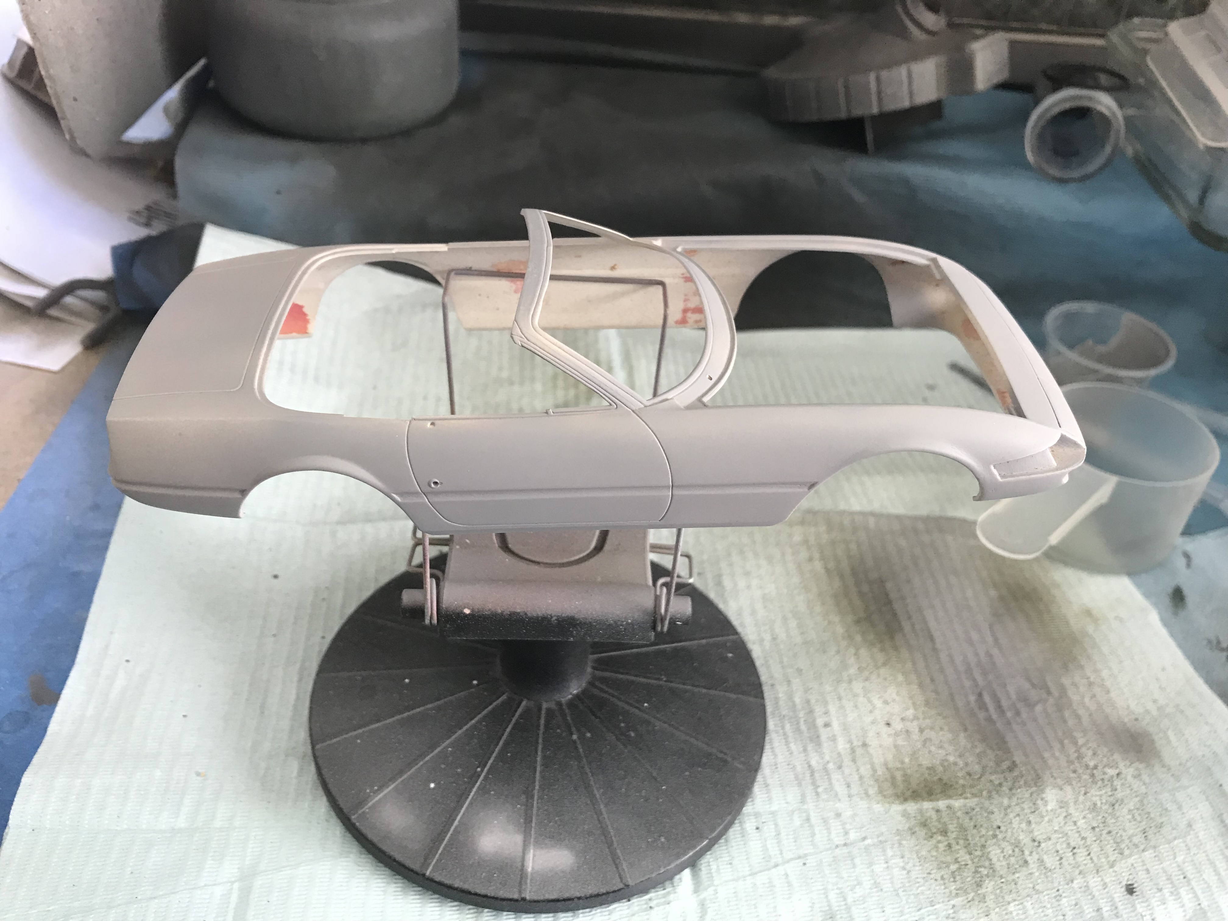

I have the body and hood sprayed in a light yellow layer.
Decision time....same Tamiya with Mr levelling thinner; TS-Italian red out of spray spray can; TS IR decanted and shot through the airbrush
Not sure yet what I will do, letting my primer/base layers set up well. Likely will go for the latter one if I can find the right straw for decanting.
