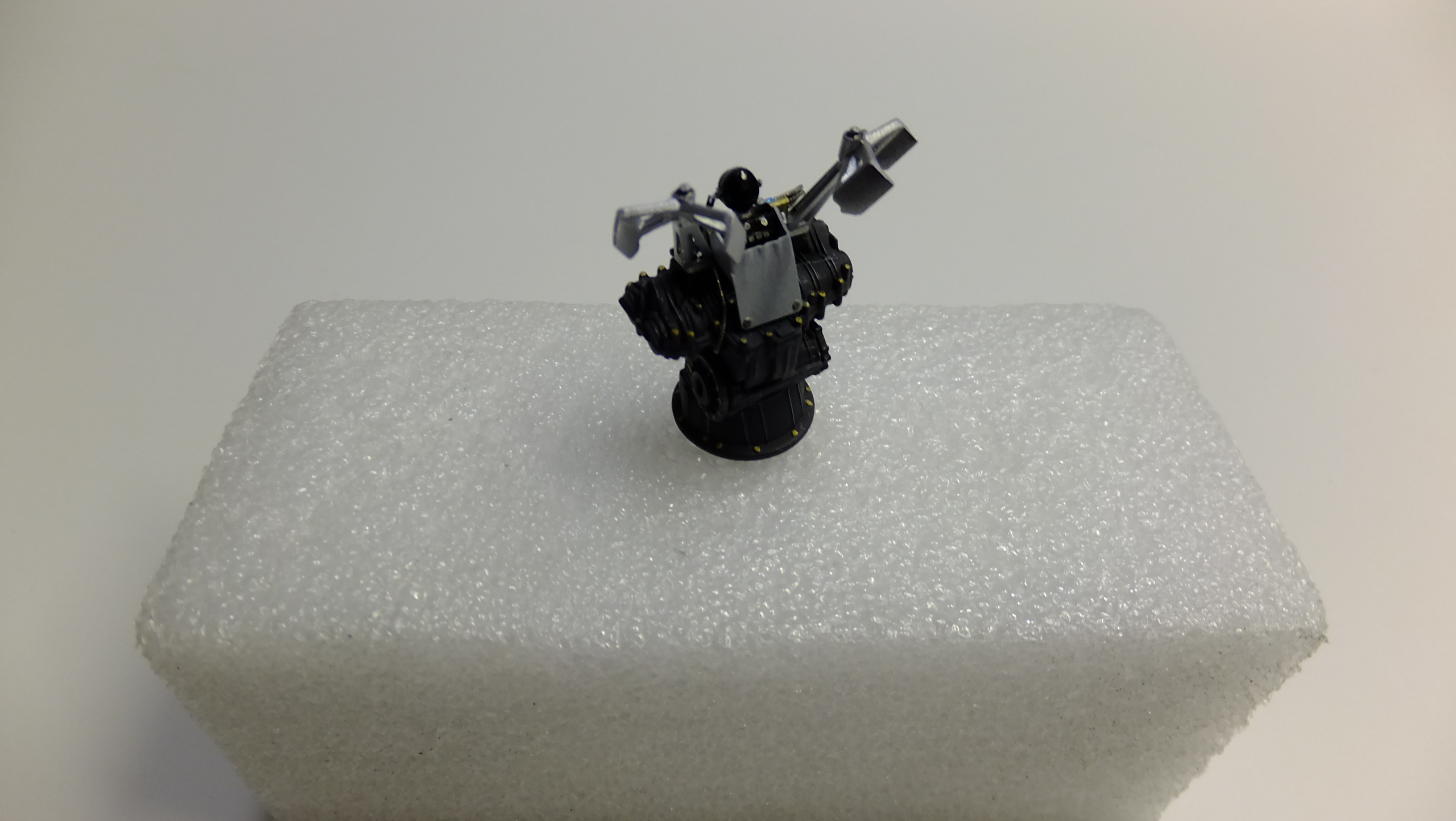

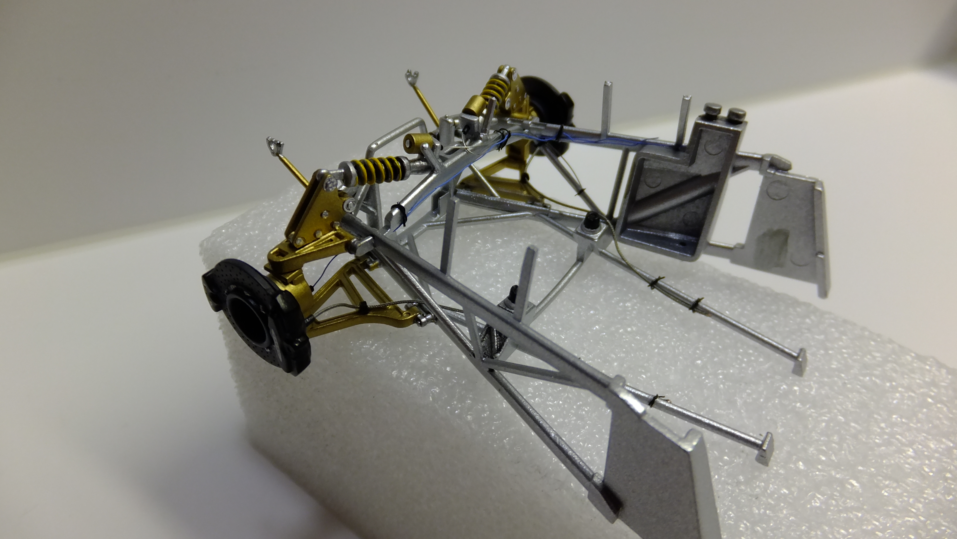

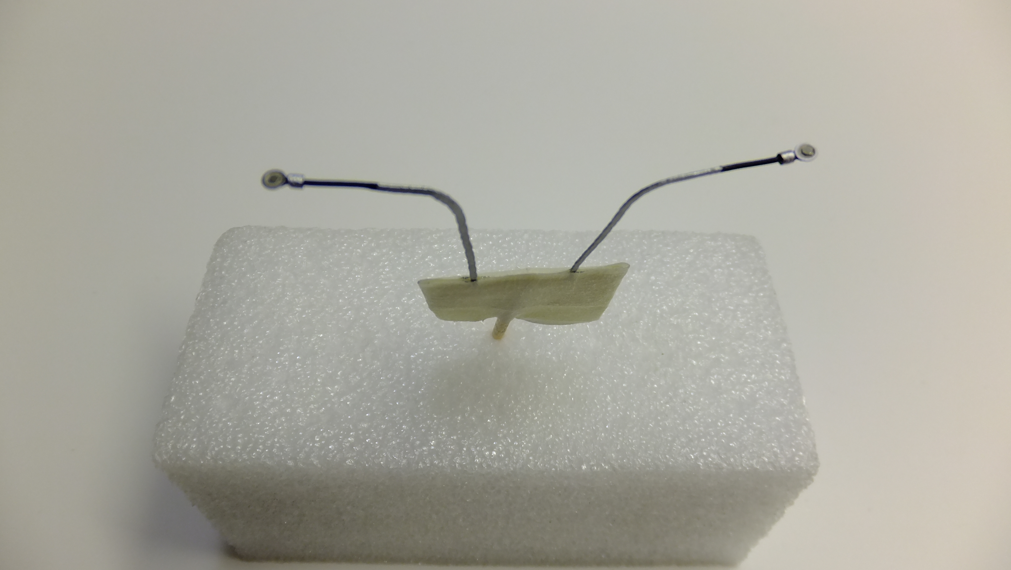

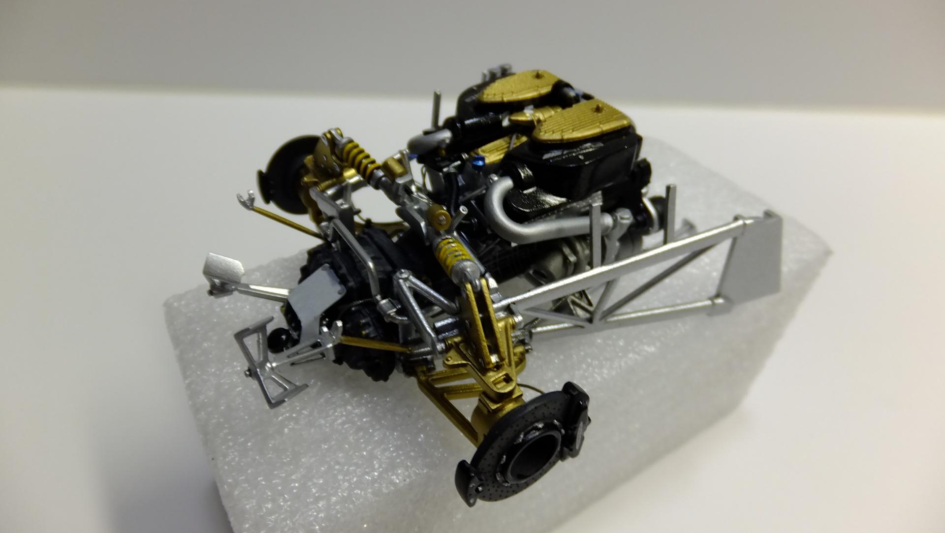

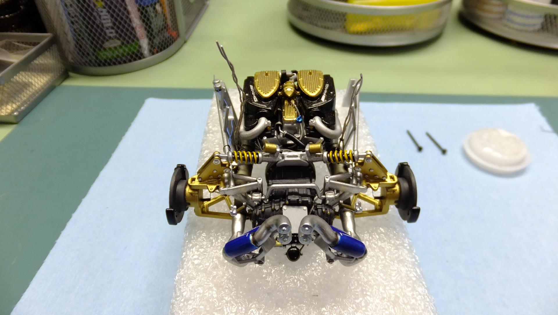

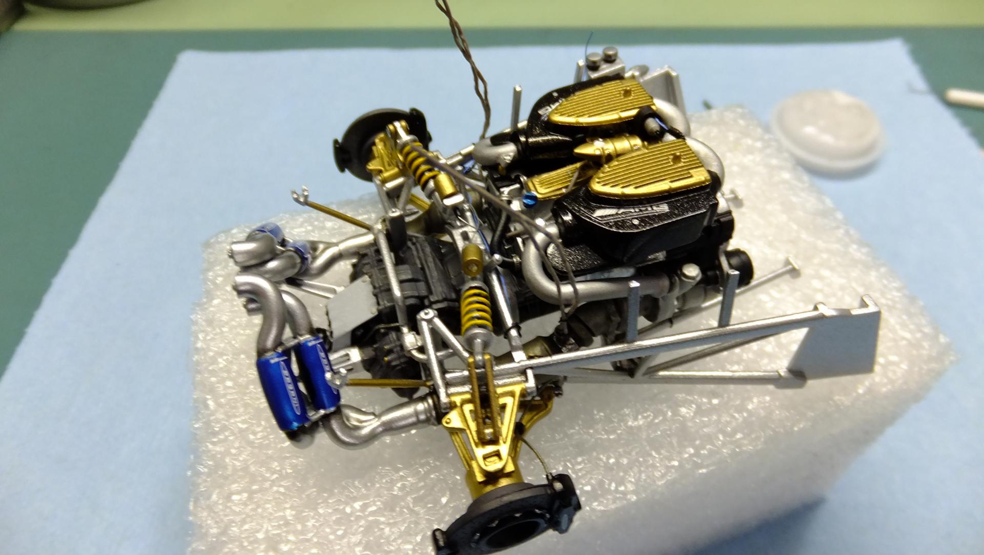

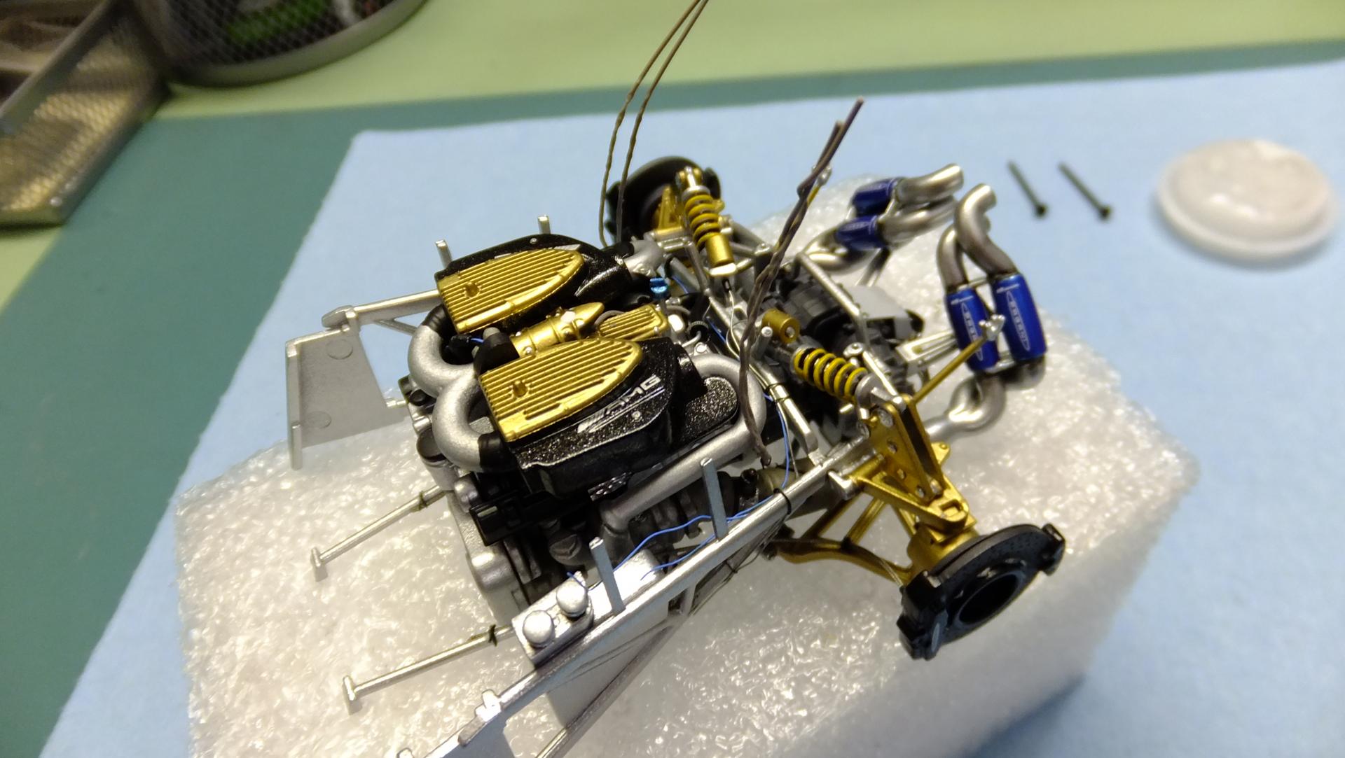

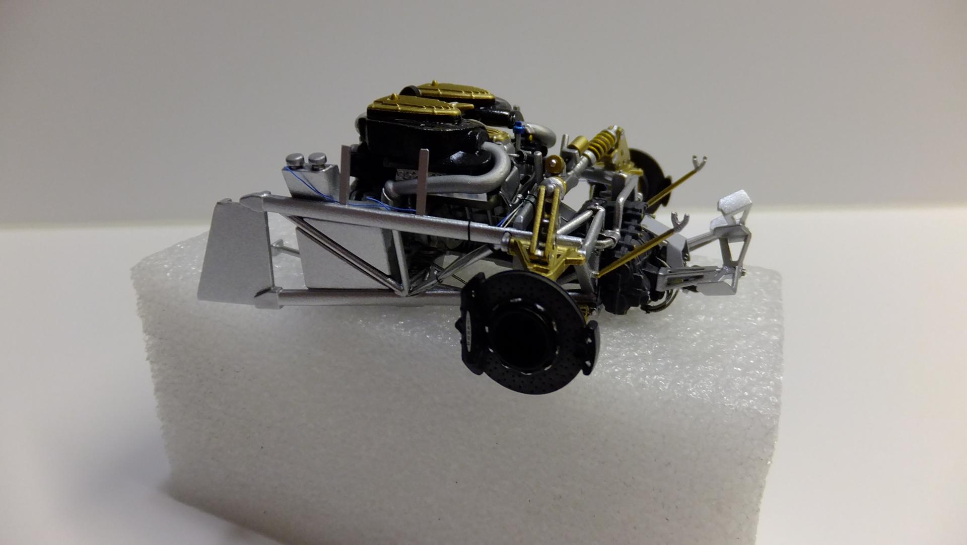

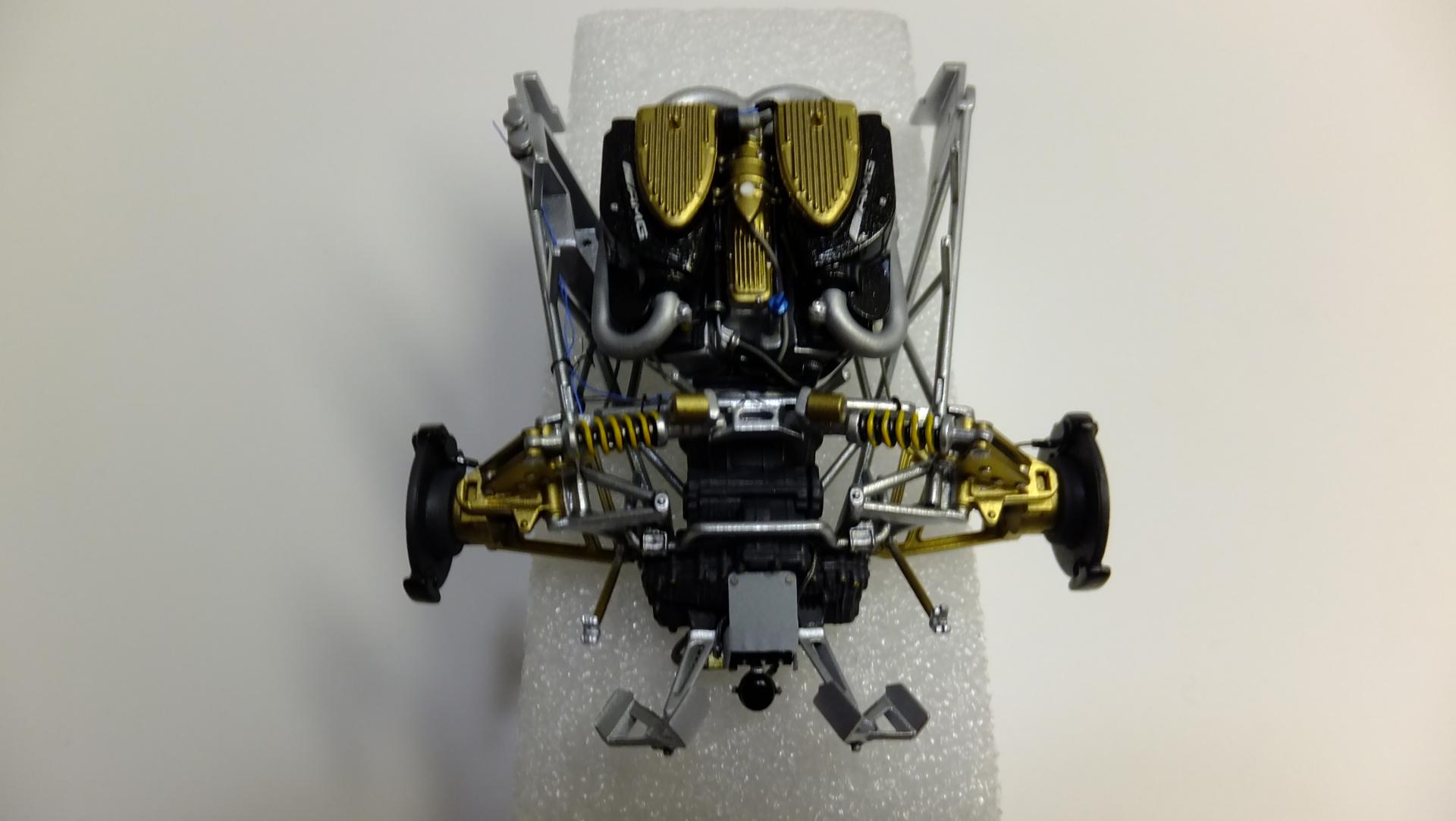

Dann Tier Posted April 18, 2018 Author Posted April 18, 2018 I finally have an update!!! I scratchbuilt some E-brake cables, better fuel injectors, wired-up a bunch more, added bolts to the bell housing so that the tranny looks like it was actually bolted on.....cant believe that the rest of the tranny has CRAZY detail.....30 molded in bolts, but 0 for the bell-housing!?!! wth?!! next I will be attaching the exhaust pipes!!

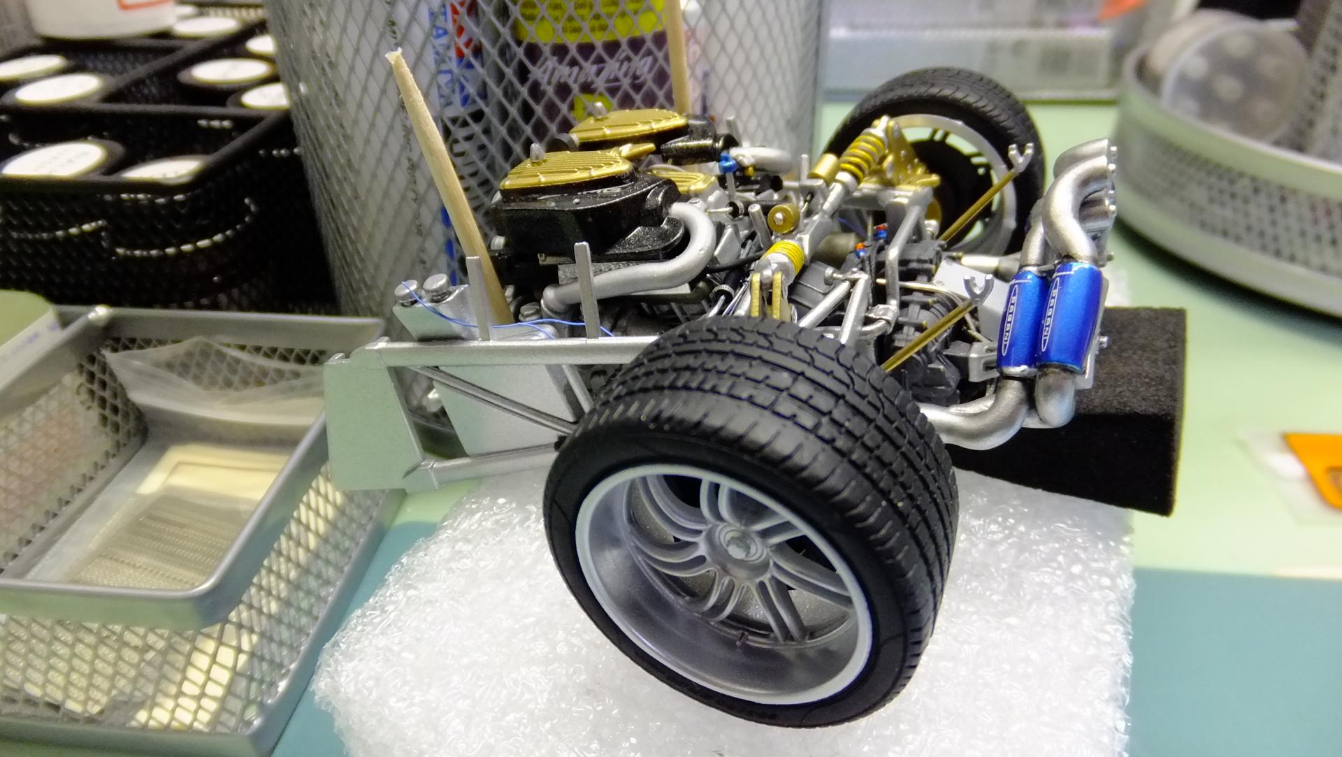

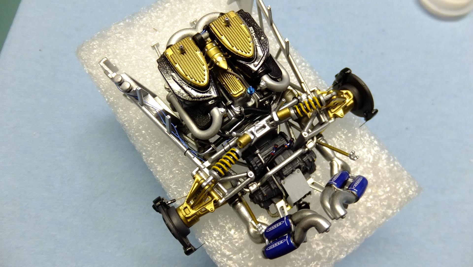

Dann Tier Posted April 19, 2018 Author Posted April 19, 2018 Another "Intermission" update here; I have the exhausts installed, and was pleasantly surprised at how easily they went in, considering the O2 sensors, and other extra details I added. the trick to making the exhaust step easier, is to NOT add glue first!, get them fit where you want them, and then flow super glue into the VERY slight gap at the turbos. Don't use Tamiyas thin glues, they wont work, and you need the super glue to not only fill the gap, but also be strong enough to hold while you flex the four tailpipes together. It doesn't take much to flex them together either, which is a nice surprise!...I wont be doing this step until much later, in case I have to tweak the exhaust tips, and flange/collector.....it very possibly could be part of the rear cowls fitment issues. Before I forget, I still HAVE NOT glued the exhaust to the hangers, I will do that later, after i'm 100% sure everything is spot-on.

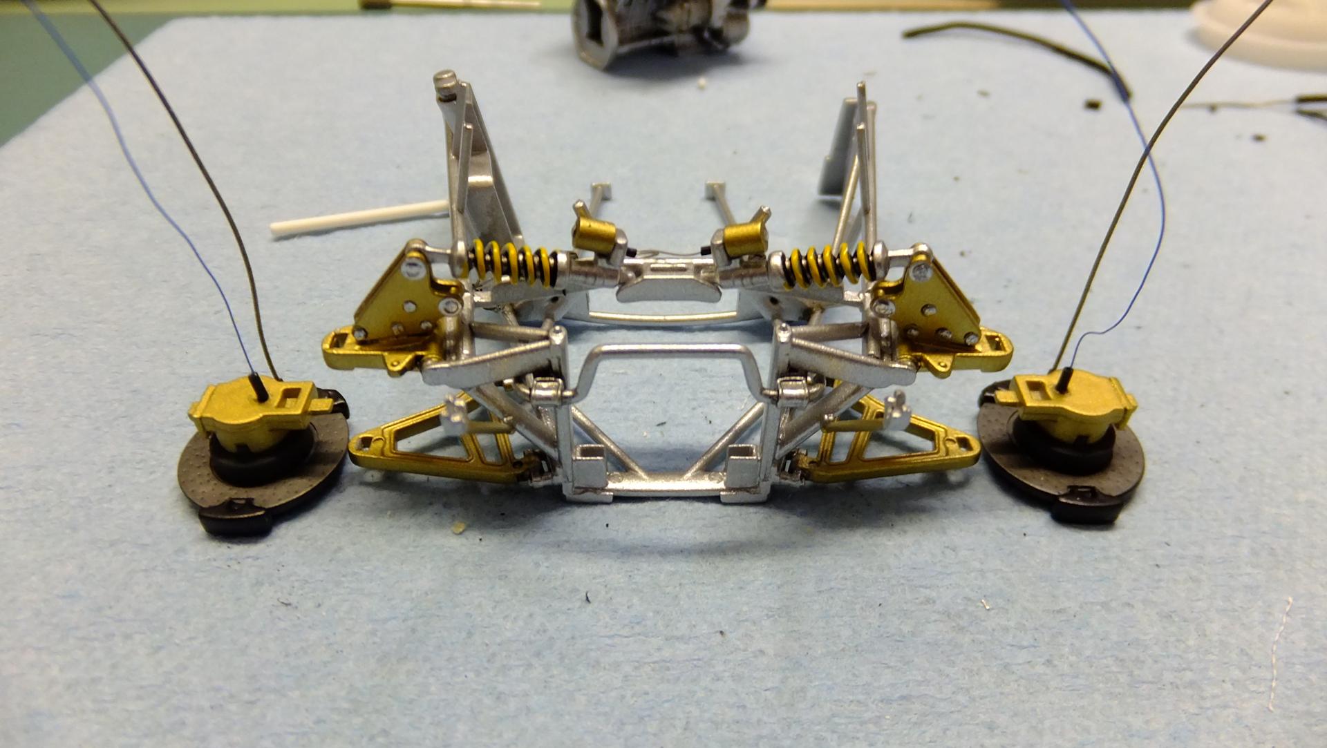

afx Posted April 20, 2018 Posted April 20, 2018 Great work Dann. Where did you source the super fine wire? Does it come plastic coated or did you paint it?

Dann Tier Posted April 20, 2018 Author Posted April 20, 2018 4 hours ago, afx said: Great work Dann. Where did you source the super fine wire? Does it come plastic coated or did you paint it? Thanks, JC!, I got it from Detail Master, and it IS coated!

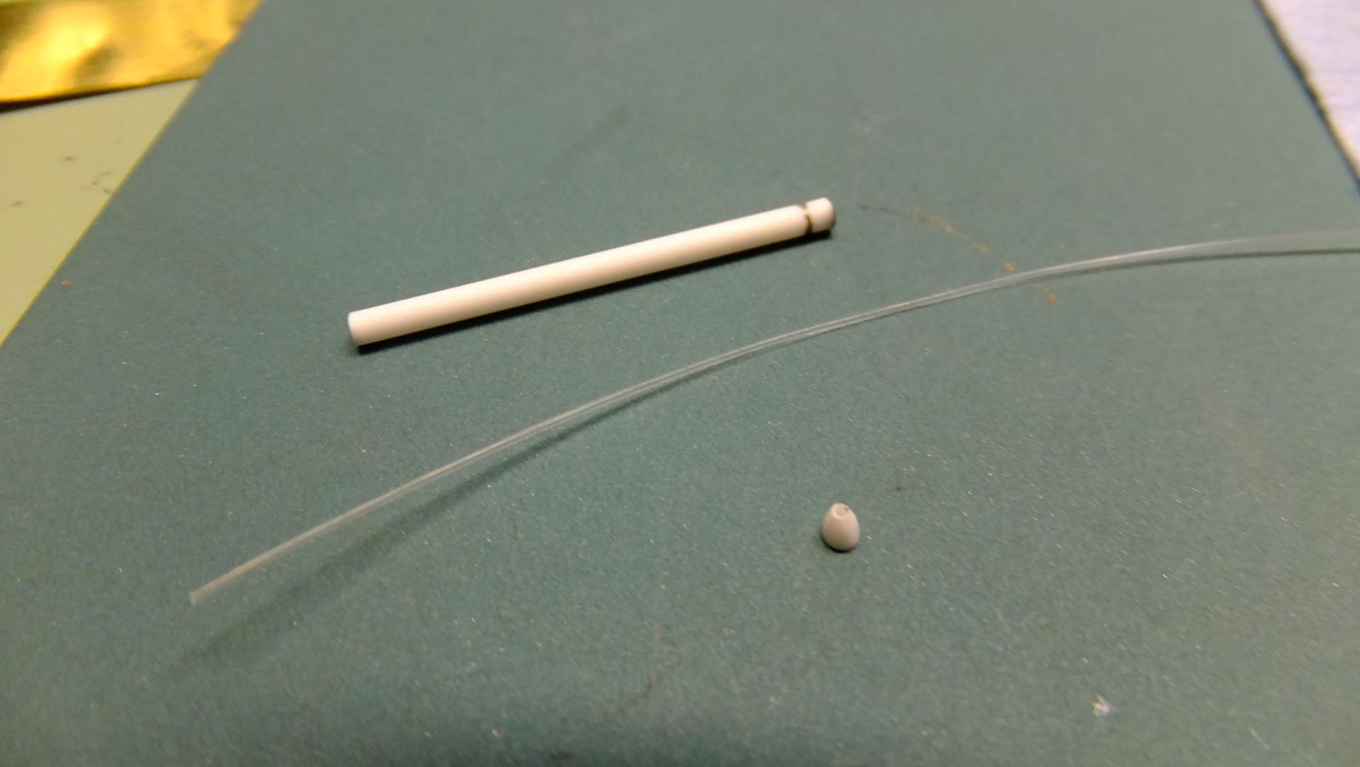

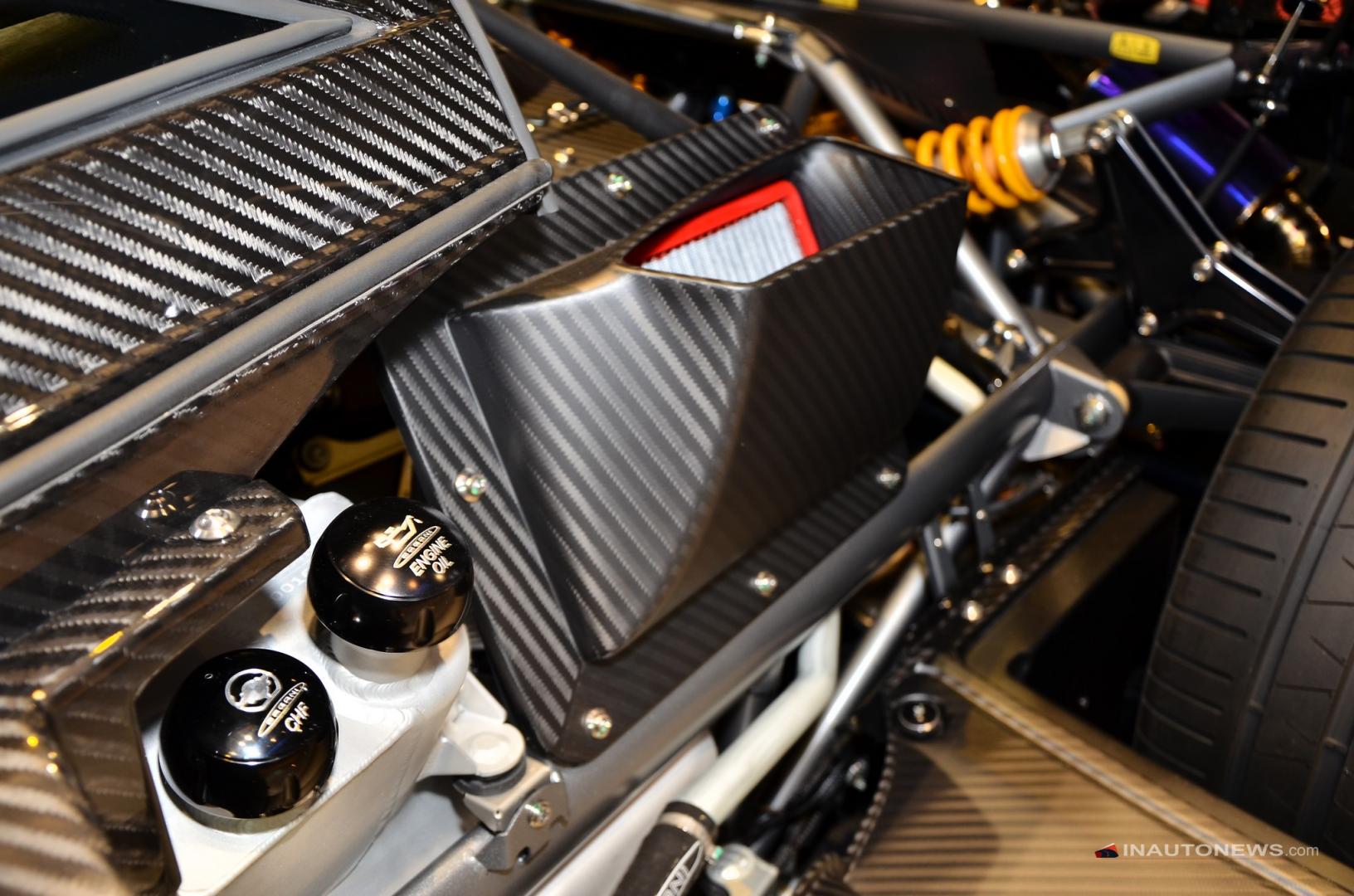

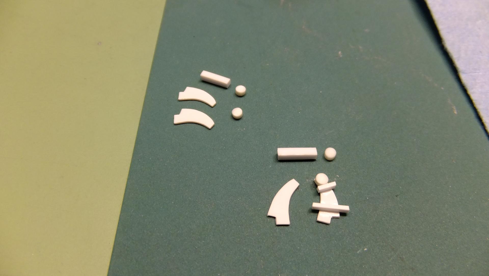

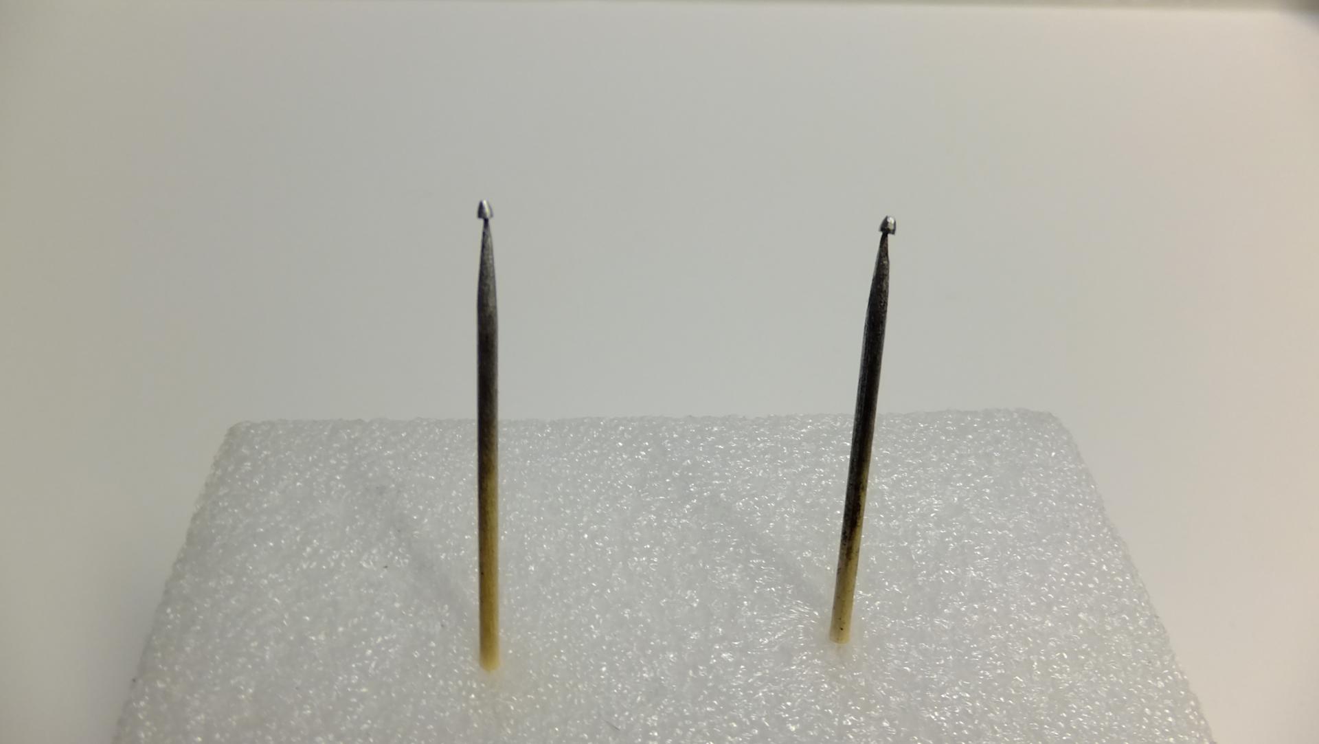

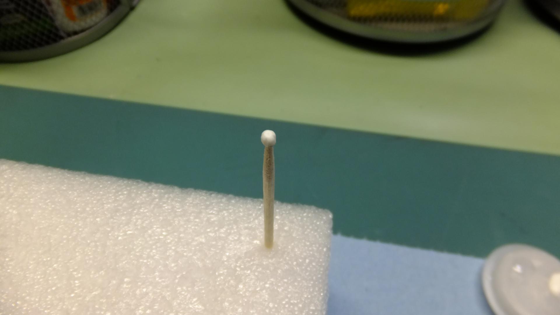

Dann Tier Posted April 20, 2018 Author Posted April 20, 2018 Thought i'd give an "intermission" update as I watch paint dry. Finished wiring-up the engine, and tiding things up. Almost done with the E-brake brackets, and now decided to scratchbuild more factory-like fluid caps with tiny notches around them. Its too bad you can barely see them, but they are there. I literally had to glue them upside down with canopy glue, just so I could sand them all uniformly. The rest of todays mission is: paint the belly-pan, paint the driveshafts, finish the fuel lines, and scratchbuild the two rear Control-arm supports that are missing. Thanks again for looking-in!

Codi Posted April 21, 2018 Posted April 21, 2018 Enjoying the way you're documenting your build Dann. The pieces you're fabricating next to the real deal pics are stunning. I don't know where you got your reference pics, but they're incomparable. cheers

Dann Tier Posted April 21, 2018 Author Posted April 21, 2018 2 hours ago, Codi said: Enjoying the way you're documenting your build Dann. The pieces you're fabricating next to the real deal pics are stunning. I don't know where you got your reference pics, but they're incomparable. cheers Thanks, Tim!!!, i'm glad you are liking it!, I just wanna show people that this kit CAN be built the way they intended it to be.....with necessary mods. I get my references from all over the interweb, and youtube.

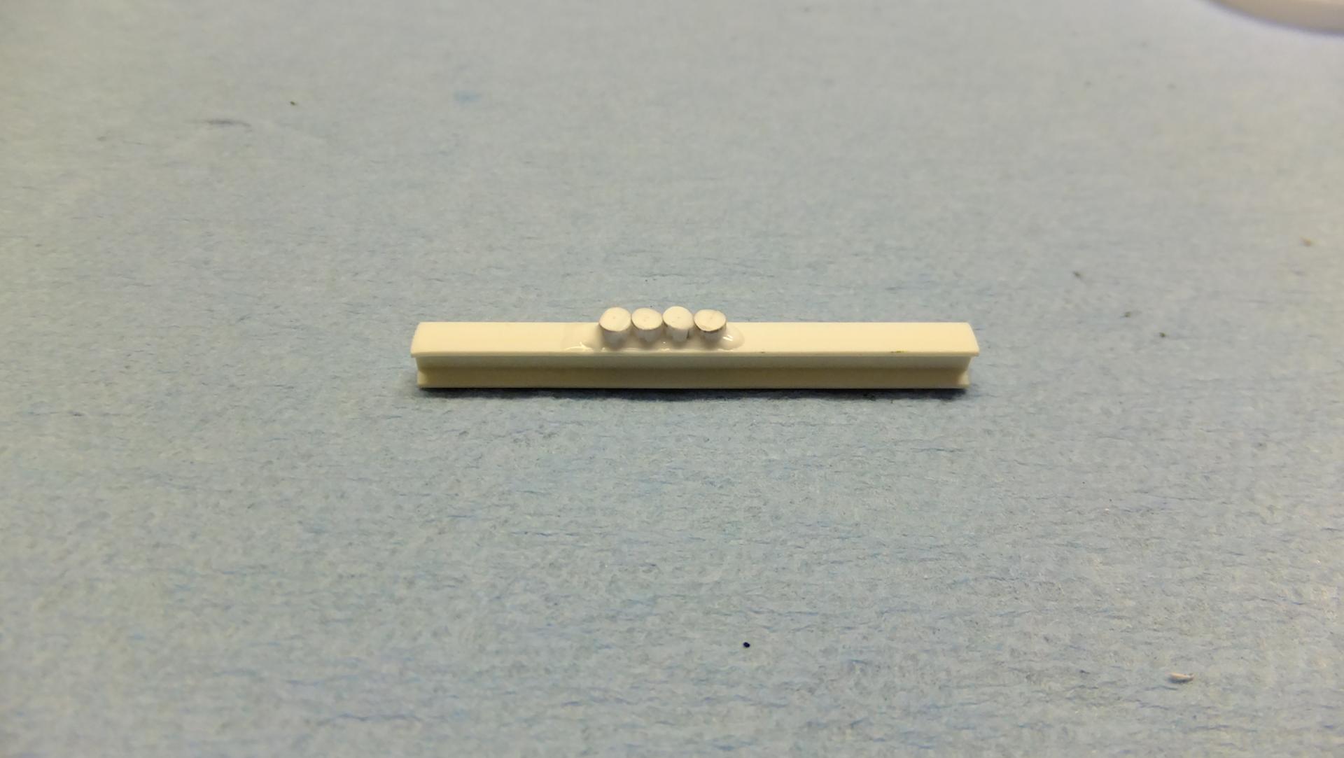

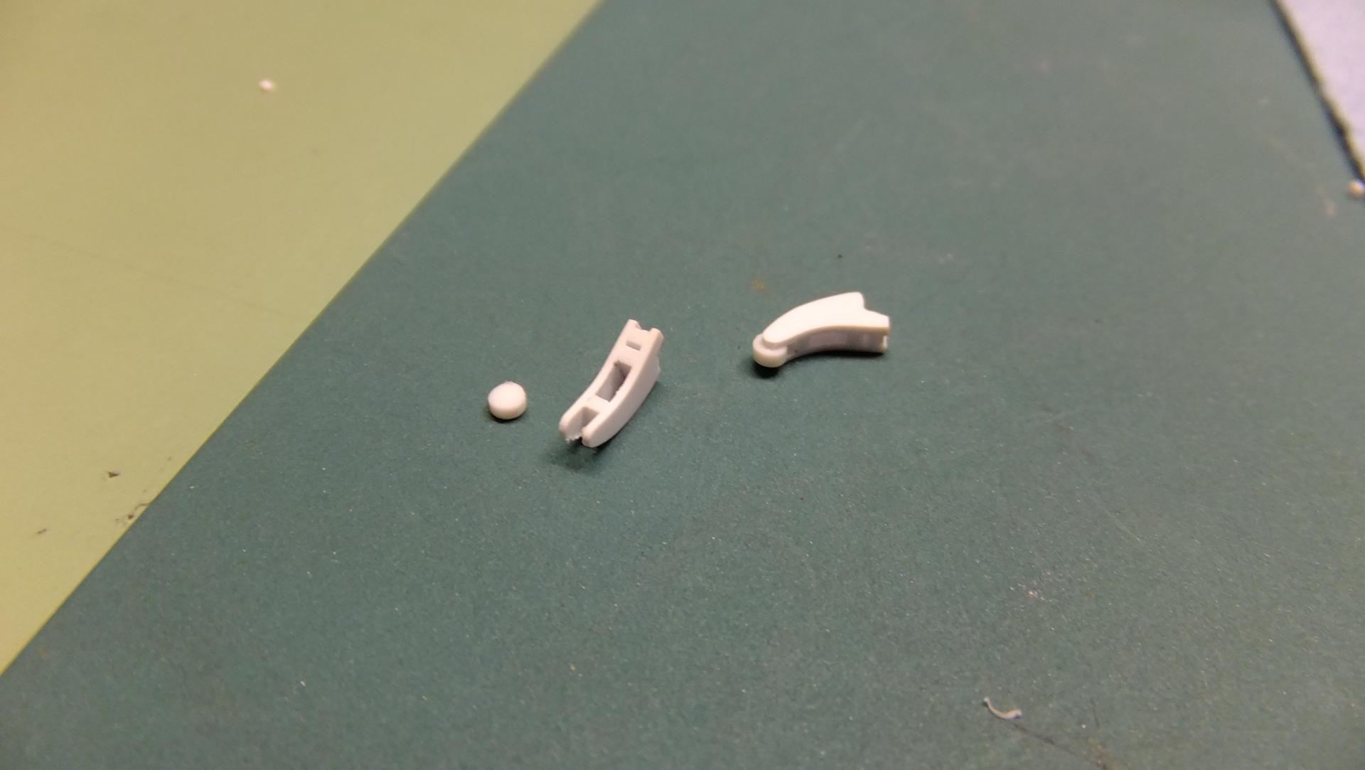

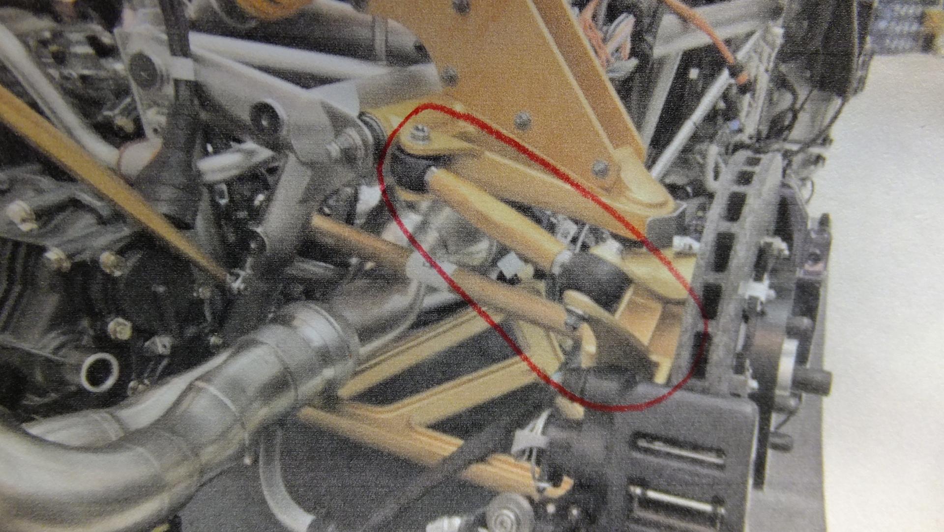

Dann Tier Posted April 21, 2018 Author Posted April 21, 2018 Heres the mission statement for today......finish scratchbuilding the control arm supports, and paint all the recent parts so that I can move onto the final phase......the body!!
Dann Tier Posted April 22, 2018 Author Posted April 22, 2018 Didn't get as much done as I hoped, but I did get the hardest part done, and a mock-up photo....
