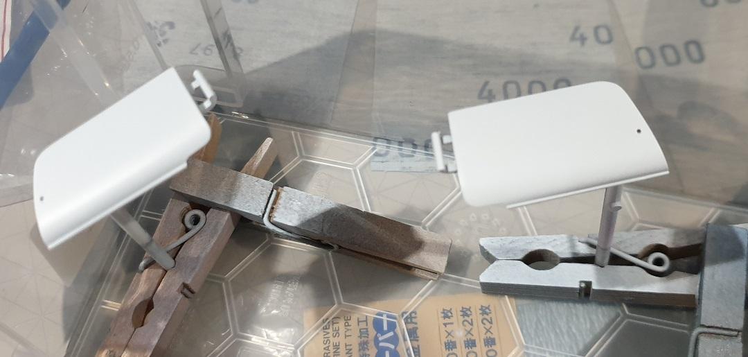

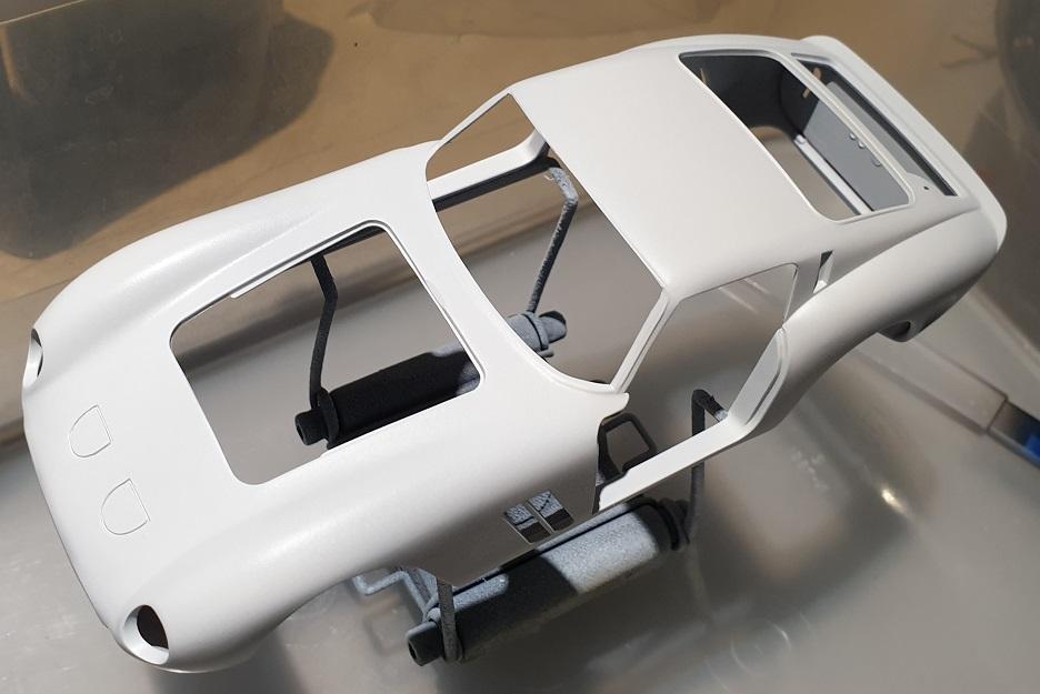

Thanks Dann, and it's been the best part of 6 months, in limbo with my pending house move, but I have managed to get a few coats of Zero grey, lots of sanding an fillng & finished with a few coats of tamiya white primer - current status is ready for finish paint - it's going to get done today hopefully, I will use tamiya Red aerosol as I have 2 cans of it lying around - those cans have been with my for about 7 years too!

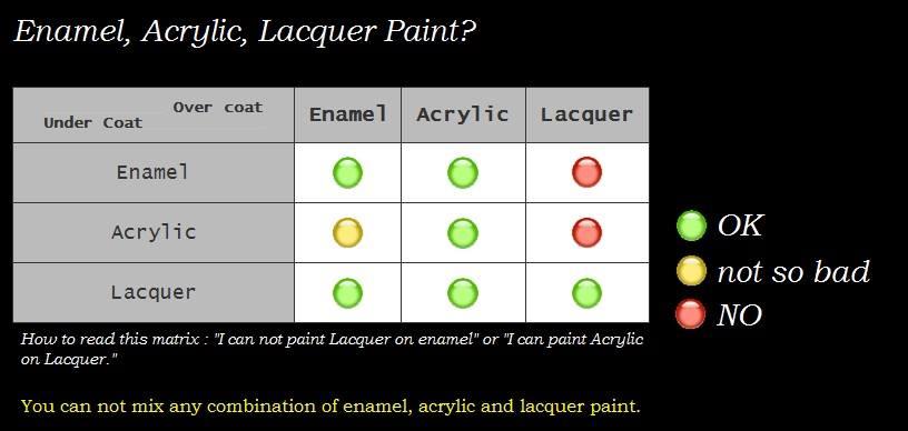

Prolly too late to help, but I stole this chart awhile ago.
5 hours ago, 89AKurt said:
I'm cringing while reading from the beginning, but looks like you have made it over the summit!  Some projects just want all the attention.  I'm not familiar with this kit, so look forward to watching it get done.
yeah, i've learned a lot through the process, thanks for the chart, it makes sense!

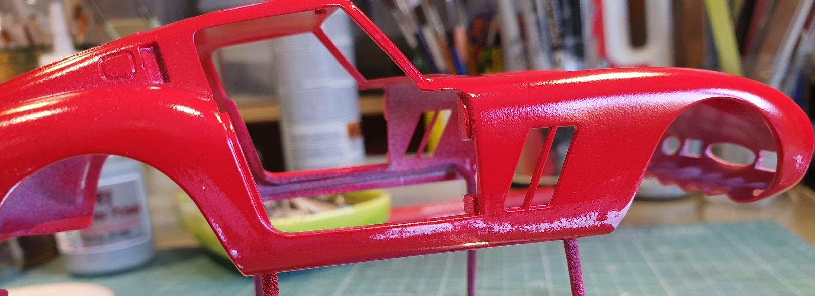

just to keep the saga going, I was half way through coating with tamiya aerosol, and i dropped it!
so I've waitng for it to dry, given it a light sand with 1500 grit & will be painting again tomorrow!

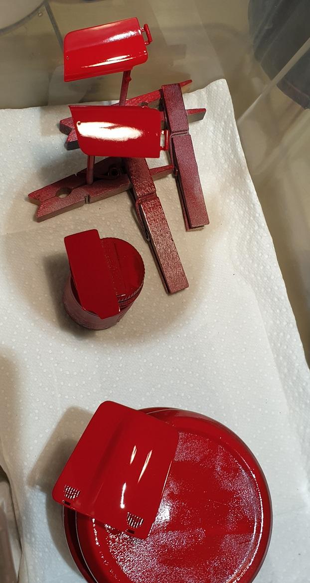

this tamiya sray has a very rough finish to it, like fine orange peel. I think I'm spraying too heavy on each coat.
I've had plenty of days like that, bud....i feel your frustration, and i'm glad that you will still carry on with it! About the paint; did you sand your primer coat before the red?...which primer did you use?...it may not be a heavy coat. I use their rattle cans, and find that it levels itself out. it looks textured when it first goes on for me, but then smooths-out as it dries.
Hi Dann, I used tamiya white primer, lightly sanded.
I'm in 2 minds as to what to do more. I might sand and respray... Or try to coat with tamiya clear, and see if it levels out somewhat...
Looking at you tube videos, others do appear to lay quite heavy costs too...

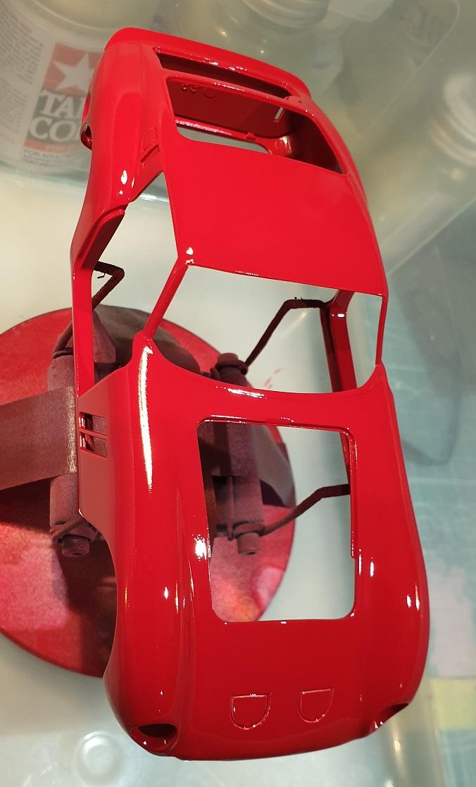

This is my first attempt at using Tamiya TS for a good finish. I've also never used the clear before.
after a few light coats of italian red I've added the clear, and the results straight off the bat are impressive. It's cold in my converted garage this time of year, but it turned out acceptable. I'm considering to just polish and not sand at all.

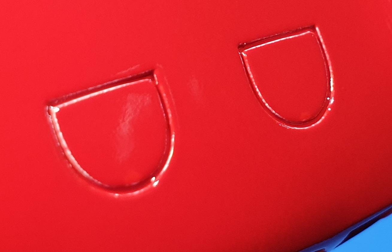

one strange effect was the receeding of the red away from the edges of the vent ducts on the nose. this is only weired as it was fine when it was just the red, but upon adding the clear, it drew it back. it's difficult to see in the image as the reflection of the light makes it look worse than it actually is.

Thats weird for sure. I use their cans all the time without that result. Nobdy is gonna look at it that close....i wouldnt be bothered, bud -its looking KILLER!!!!
The paint pulling back is from adding too much clear in one session. It happens to me on panel lines from time to time. Its an easy fix if you have an airbrush. Just mist a little bit of paint to fill the line and buff out the rest of the area.

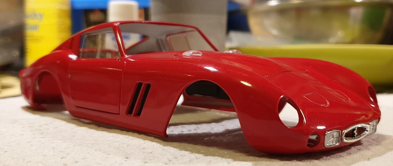

the finish is a little rough... see pic.Before.jpg.69ea0751db5b56b90d5a6f23b9b16f1a.jpg
but I hadn't put enough layers down to sand... so I've polished out ith novous polish 3, 2 & 1, it's not super smooth, but it'll look great in the finished cabinet:
after1.jpg.6b76703d1e9493cd9149906bf8e2a4b6.jpgAfter3.jpg.09da0d55c2600f54834b541b398ccf6e.jpgafter4.jpg.1d605744fa3f595988a187b6ef407775.jpg

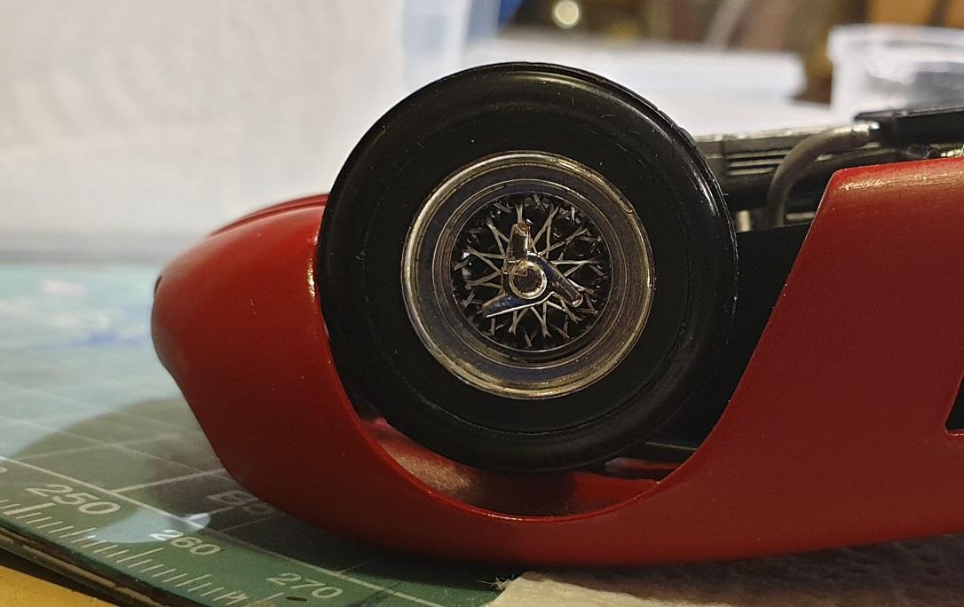

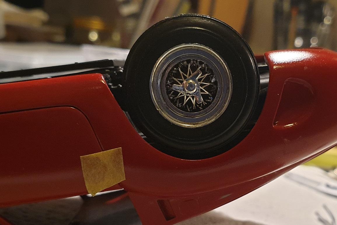

THis build continues to challenge!
I did a dummy fit test for the chassis in the OLD body - the one with the poor paint job. It took ages to get in, and a few bits fell off - but that's the good news, the bad is that the rear wheel sits perfectly in the middle of the wheel arch, but the front wheel touches the arch at the front. More so on one side than the other. it is rather strange, but there is little I can do about it now. I really just what to get this together and sit it on the shelf!
I've also polsihed the final shell with Novus "clean & shine" and started doing final assembly - just lights and windows now... I will sort out a rear licence plate - but much later in the year...
I've encountered strange things like that before as well, and no matter how many times i measure, it still looks off. Thats when i compromise with the placement of it. It really is looking Fantastic, Bud!!!!
As you probably know, these Ferraris were hand made cars with rather obvious side to side differences.  All the good people at Monogram did was to try their best to accentuate this feature! "Duh...I meant to do that!" Its all you have to say for story #1. For story #2 you could say the 1:1 was wrecked at the track. This is looking great. No matter what you do, yours will look 100 times better than that turd Monogram put on the box! Don't give up now.
Edited by Eric Macleod
