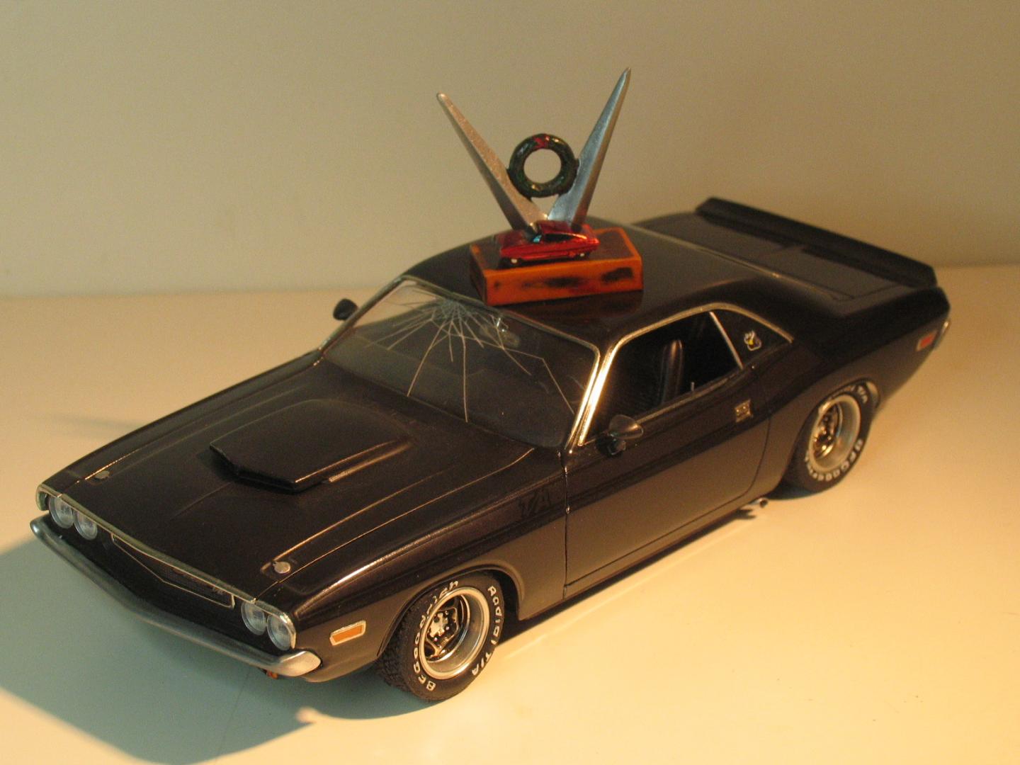

El Roberto Posted April 15, 2018 Posted April 15, 2018 8 hours ago, Casey said: Could be. A more specific and descriptive post title and body would alleviate the ambiguity. Yup, you're right, and apparently he hasn't replied to clear things up. On the subject.........how would one make broken glass for a model? I know the windshield with the tempered glass would be practically impossible but maybe other windows for older subjects.

BigTallDad Posted April 15, 2018 Posted April 15, 2018 8 hours ago, El Roberto said: On the subject.........how would one make broken glass for a model? I know the windshield with the tempered glass would be practically impossible but maybe other windows for older subjects. Take a picture of a broken windshield and use it to make a decal (using clear decal paper, of course). Maybe several decals to simulate gunshots...just kidding.

Belugawrx Posted April 15, 2018 Posted April 15, 2018 (edited) Scribed with the back side of an old #11 exacto blade Edited April 15, 2018 by Belugawrx
