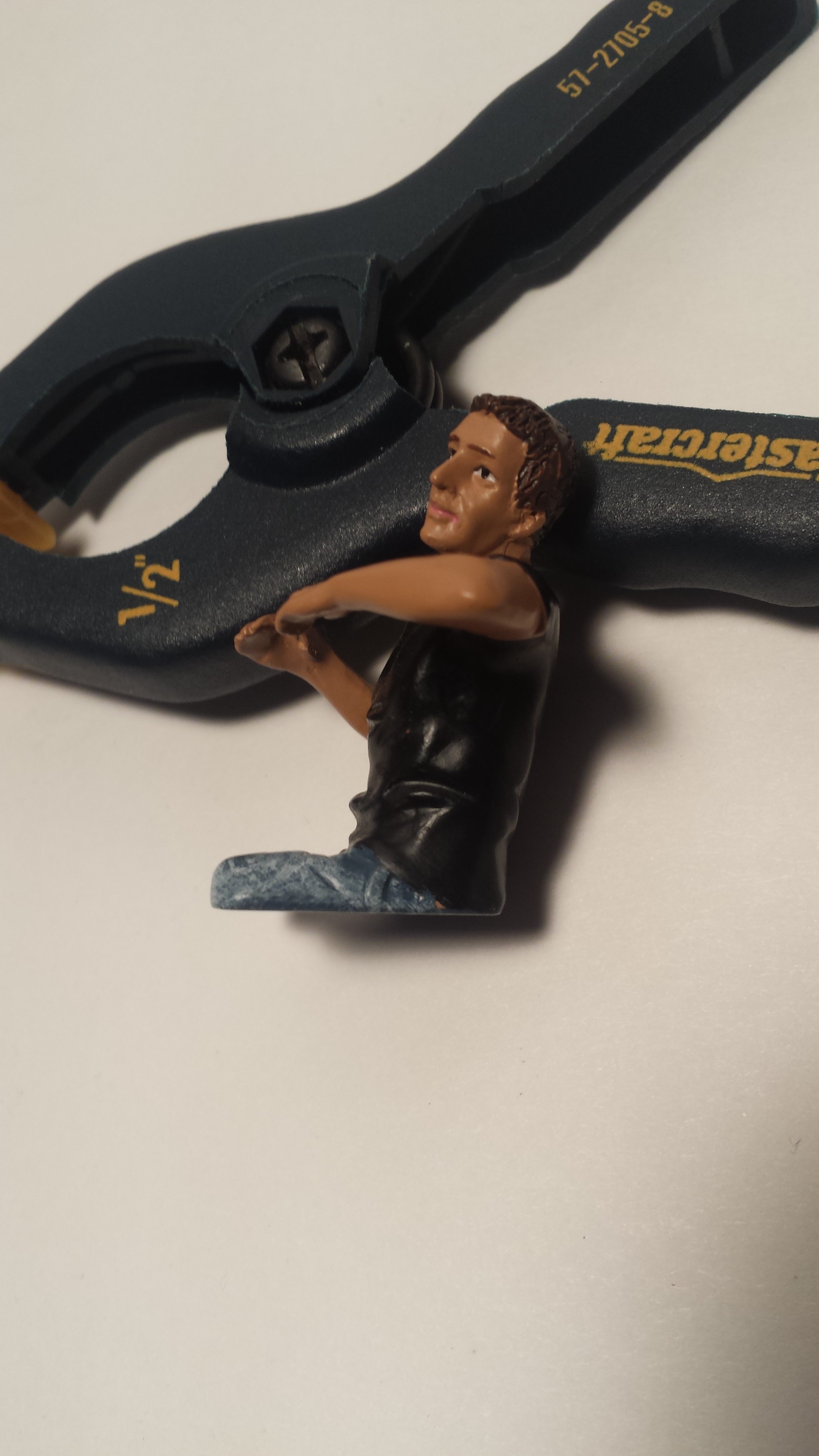

i am nearly finished with my rally car build and i put my two rally figures in the interior of the car and i found that the arms are too long for the interior, the legs are too long, and generally just dont fit.
how do you guys typically get people to fit inside of cars, do you cut the arms and legs and reglue them? how do you get them to look proper

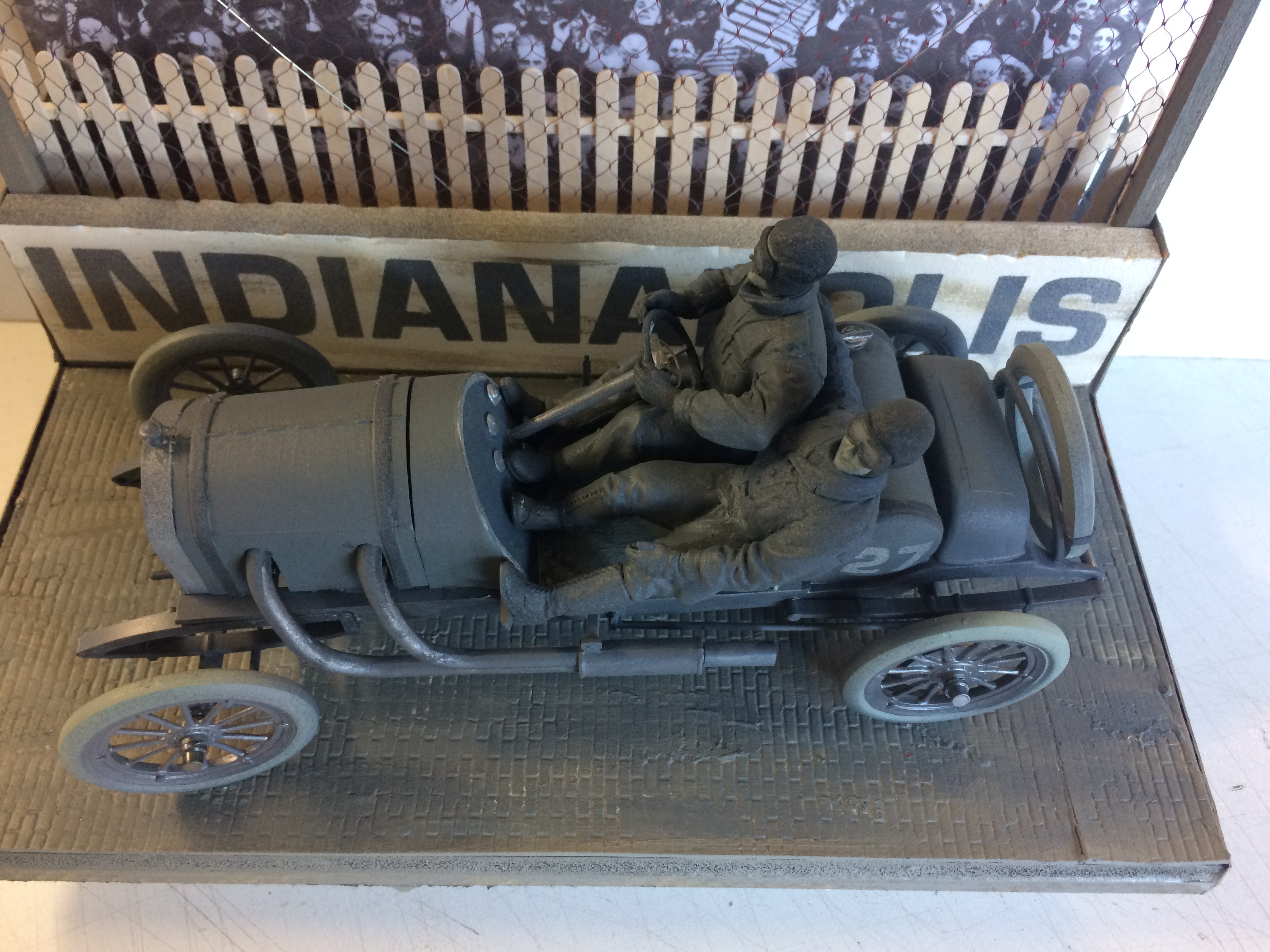

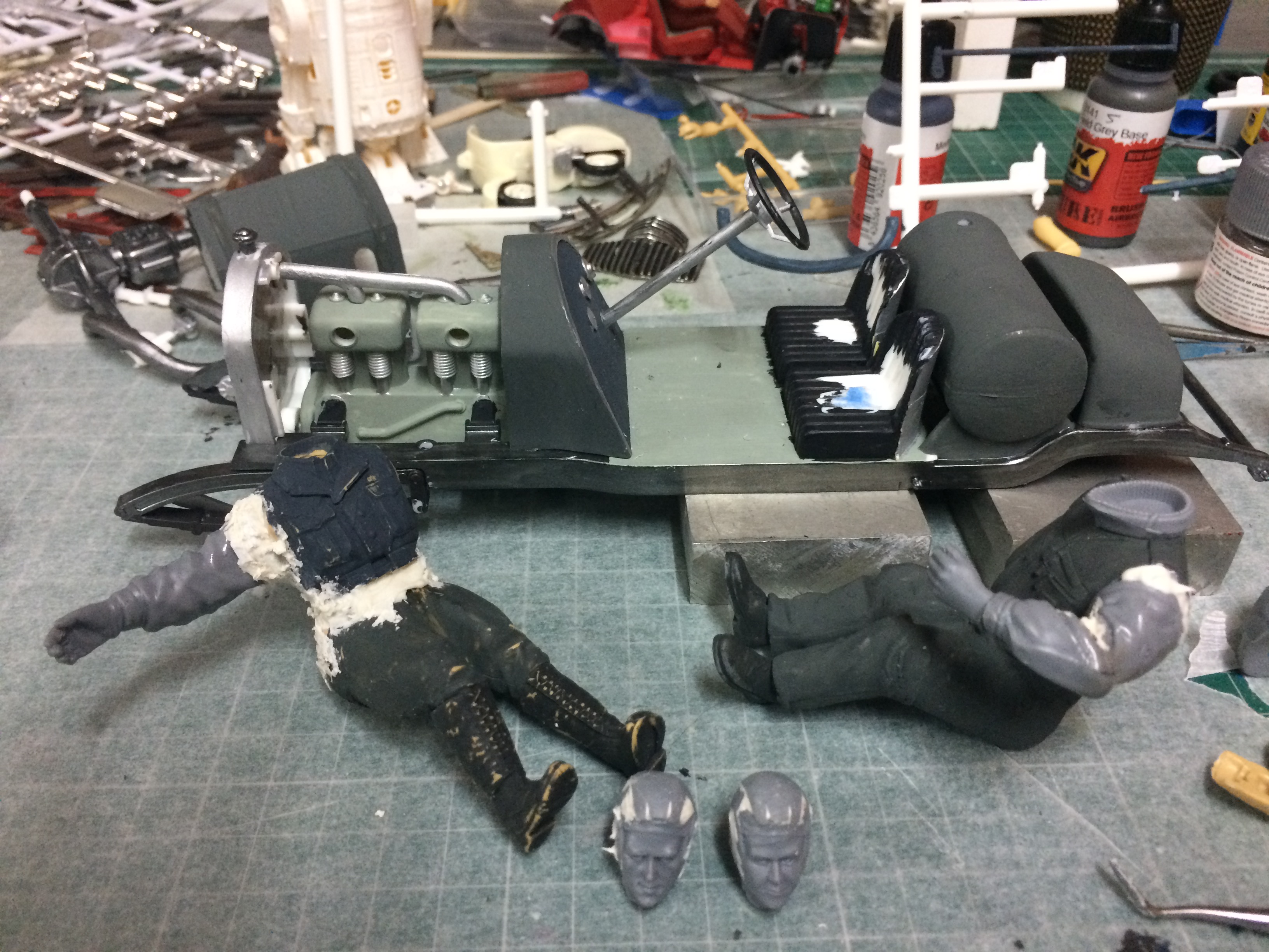

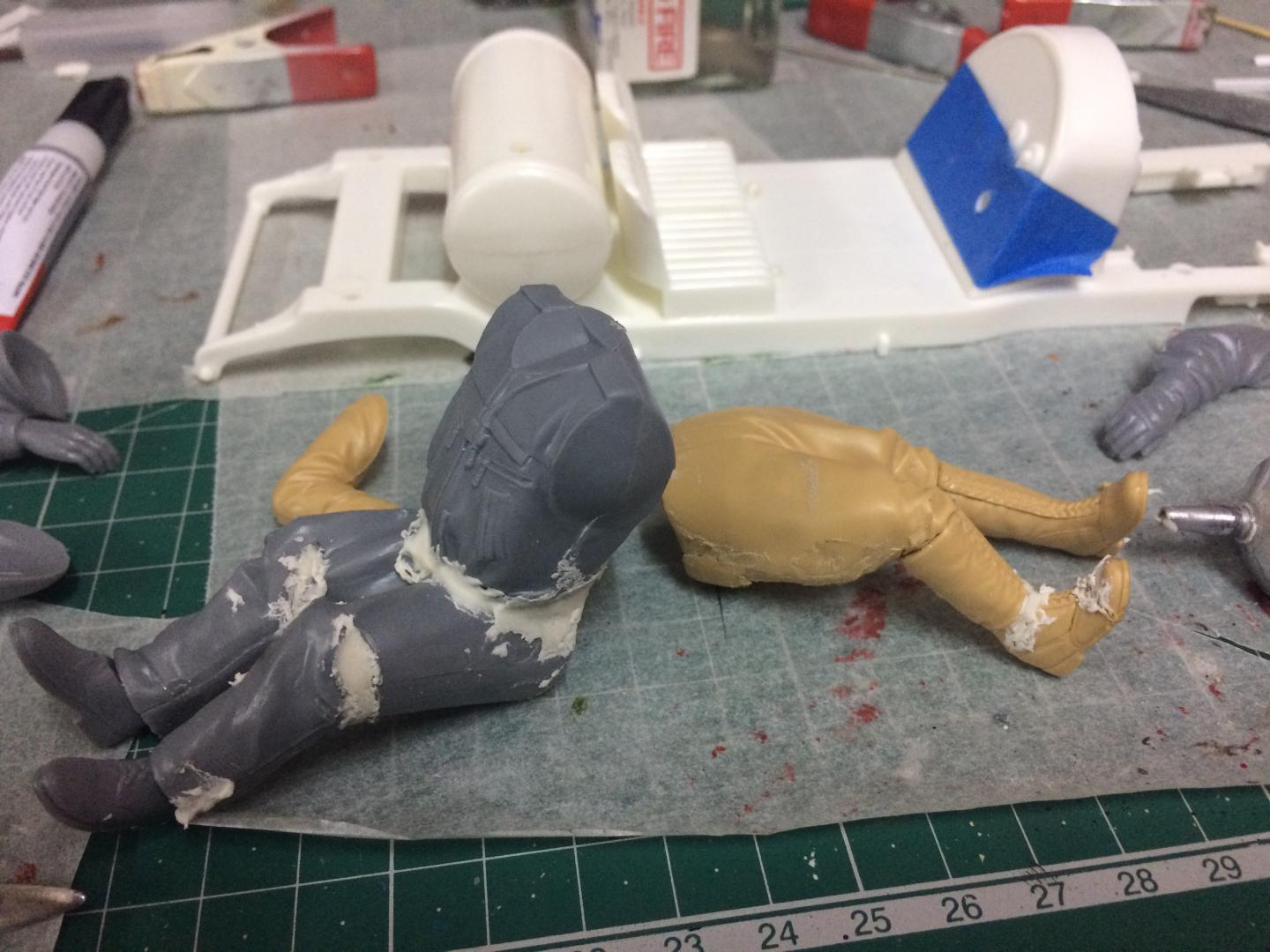

So yes, you will need to "cut and shut" the arms and legs at Shoulder/elbow and Hip/knee. You probably don't need to cut right through the "joint", just cut a wedge from behind the knee, for example, leaving the kneecap in place. Then heat the kneecap carefully and bend the knee to the right position. You can then fill the remaining gap lightly with your filler of choice and file or sand to finish. For the hips you can also separate the torso at the waist and take a narrow wedge from the front, or even add a wedge from behind below the kidneys. The sanding doesn't need too be to fancy or accurate because it will generally look like folds in fabric anyway.
Here are some examples where I have done this:
Admittedly, these particular figures were 1/16 so a bit easier but they started standing up straight and I have done 1/24 and 1/35 successfully.
See more pics here and here
Hope that helps.
