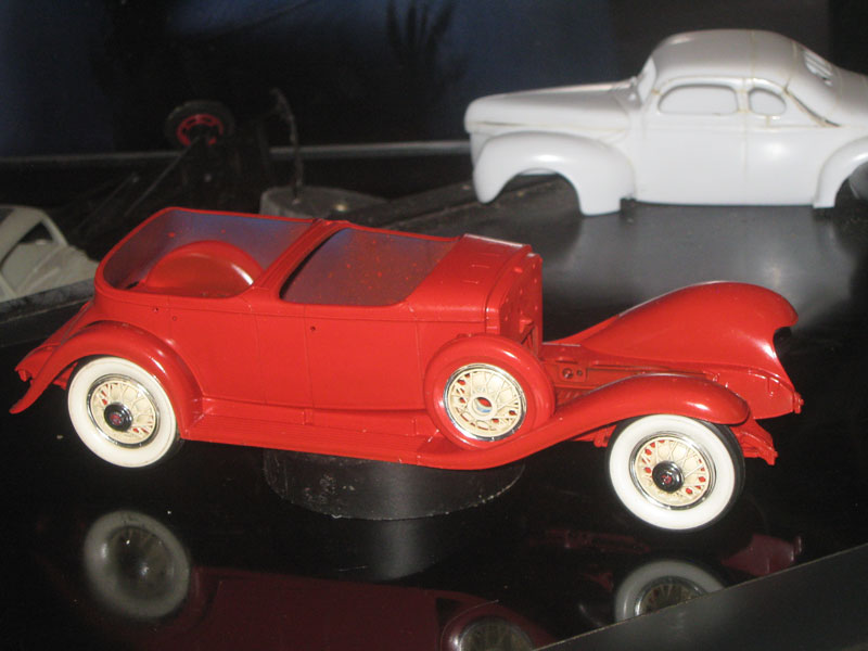

Richard Bartrop Posted July 6, 2018 Posted July 6, 2018 (edited) The weather's finally warm enough for painting, so I've been laying some paint on a few projects that need them. Based on a car that was owned by a Mrs. Little, who eventually donated the car back to GM. Testor's Model Master Ford Engine Red turned out to be a decent match for the "Satan Red" exterior, while the interior is Humbrol #60 Matt Scarlet. Humbol Ivory was a close enough match for the "Puritan White" wheels on the original. Edited January 21, 2023 by Richard Bartrop

Eric Macleod Posted September 27, 2018 Posted September 27, 2018 I have seen the 1:1 in person a couple times. You nailed the color. I am watching this with great interest.
Richard Bartrop Posted September 27, 2018 Author Posted September 27, 2018 31 minutes ago, Eric Macleod said: I have seen the 1:1 in person a couple times. You nailed the color. I am watching this with great interest. Thanks, that's reassuring. When all you have is photos to work with, it's not always easy to tell how close you're getting. I don't suppose you remember if the brake drums were painted the same colour as the rest of the body?

Richard Bartrop Posted October 19, 2018 Author Posted October 19, 2018 Adding foil to the rims, and painting the hubcaps.
Eric Macleod Posted October 20, 2018 Posted October 20, 2018 Very nice. How accurate do you wand them though?

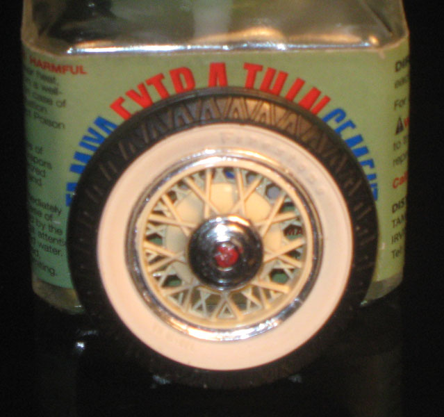

Richard Bartrop Posted October 20, 2018 Author Posted October 20, 2018 (edited) Fairly close. I had tried set of whitewalls from one of the Monogram classics, but they're a little oversized. I suppose the best answer would be as accurate as I can make it without incurring too much expense. I do have an idea bout how I might make the taillights more accurate. Edited October 20, 2018 by Richard Bartrop
Richard Bartrop Posted October 25, 2018 Author Posted October 25, 2018 (edited) I took another look at the Monogram tires. The fit the Cadillac wheels well enough, but their outside diameter is a little larger, and I wasn't sure about how they filled the wheel wells. So I took another look at the original, and that's close to what they're supposed to look like, so I think I'll go with there. Here's hoping I can scrounge up two more. Edited October 25, 2018 by Richard Bartrop

Richard Bartrop Posted February 26, 2019 Author Posted February 26, 2019 Thanks to a generous donation of Monogram tires from Eric Macleod, it's now up on all four wheels. Here's the chassis on display at Modelmania during the Family Day weekend. I glued together 16 thin styrene rods together, and formed them into the bundle of ignition wires.
