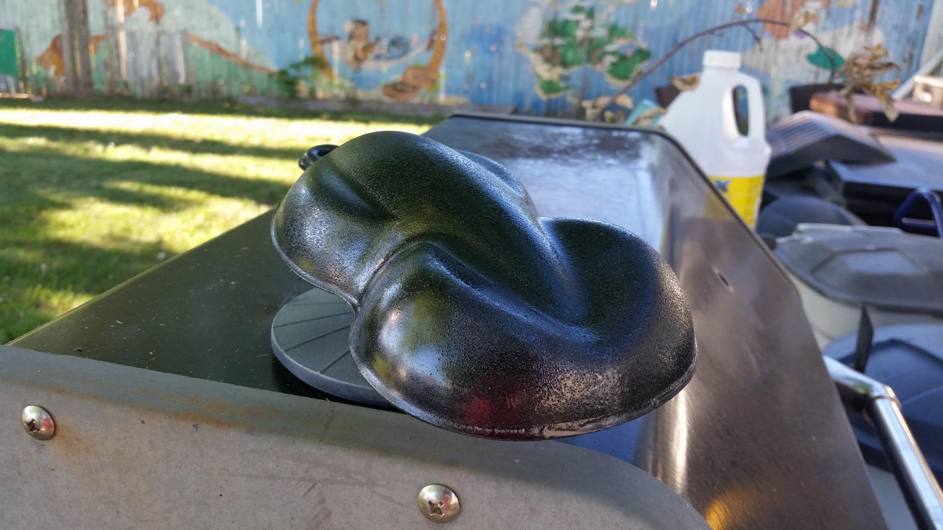

Joe Handley Posted August 1, 2018 Posted August 1, 2018 Look into these. https://www.dipyourcar.com/collections/speed-shapes I picked up a few to play with, they're cheap and appear to be vacuum formed sheet styrene
peteski Posted August 1, 2018 Posted August 1, 2018 On 8/1/2018 at 1:55 AM, Joe Handley said: Look into these. https://www.dipyourcar.com/collections/speed-shapes I picked up a few to play with, they're cheap and appear to be vacuum formed sheet styrene Expand Those styrene shapes are a great idea, but unless you are going for the "hippopotamus skin" effect. that paint job is horrible! Good thing it is on a test piece.
Joe Handley Posted August 1, 2018 Posted August 1, 2018 On 8/1/2018 at 2:00 AM, peteski said: Those styrene shapes are a great idea, but unless you are going for the "hippopotamus skin" effect. that paint job is horrible! Good thing it is on a test piece. Expand Yeah, that was an experiment with embossing powder that didn't pan out, got something else to try, but I'l do that on a spoon first. I do have a friend that uses those embossing powders for carpet though!
peteski Posted August 1, 2018 Posted August 1, 2018 Yeah, from what I see embossing powder works well for scale carpeting.
