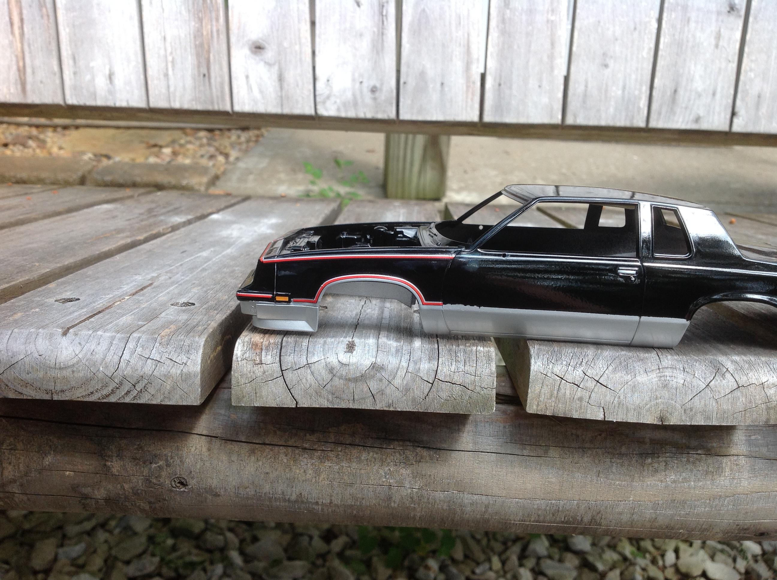

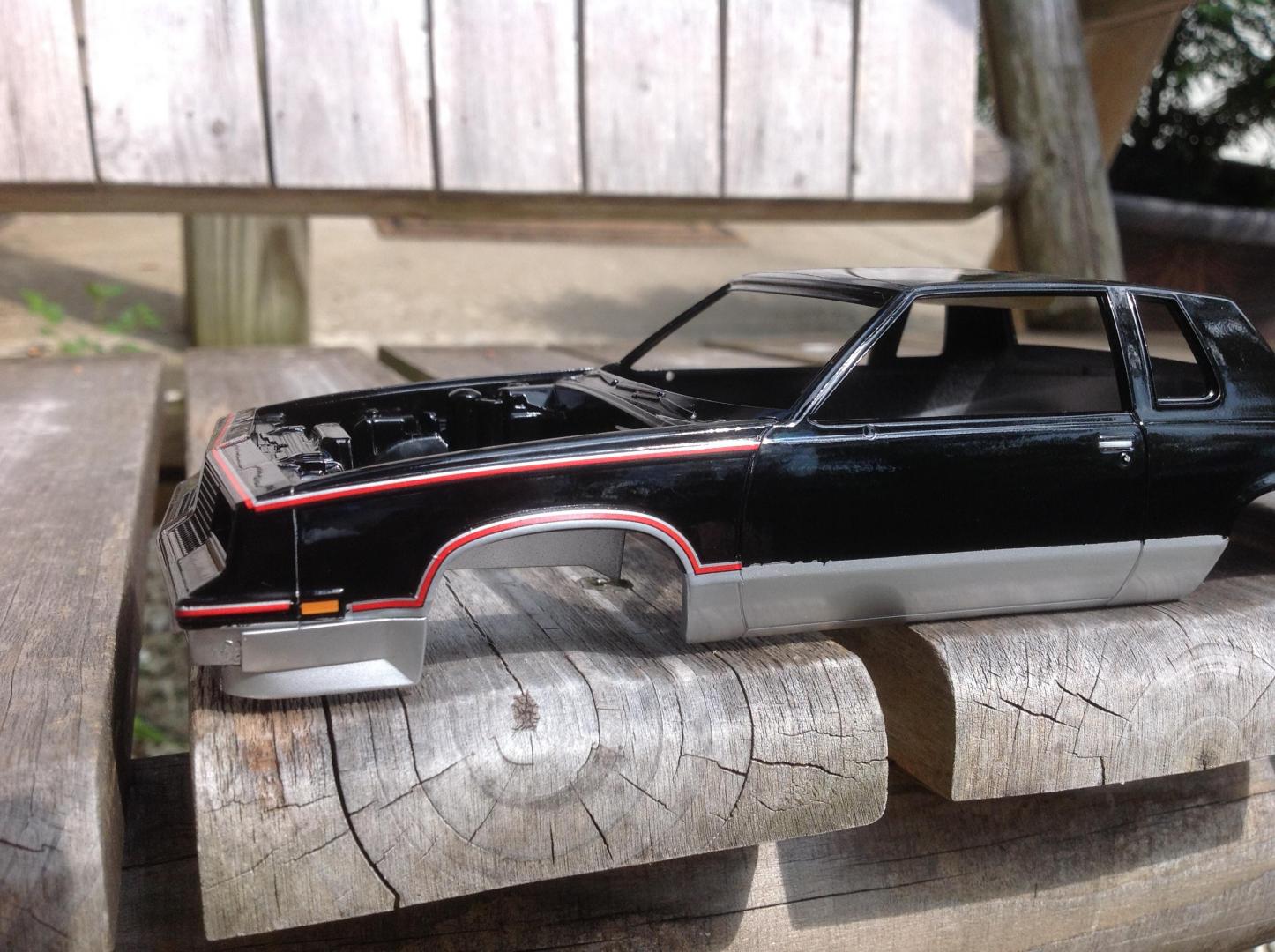

shoopdog Posted August 12, 2018 Posted August 12, 2018 (edited) I am in the process of decaling my Hurst Olds and saw I'm getting splotches on my black finish. I'm using Model Master solution for complex surfaces. In my photos you can see underneath the windshield pillar and front of the fender. I've tried wiping off with clean moist cloth and have tried a small amount of isopropyl alcohol mixed with water but it won't clean up. Has it eaten into my finish? Black paint is Model Master laquer and Tamiya clear with Future on top of that. Everything was well cured and solution didn't sit on the paint for more than 10 minutes. Can anybody recommend a solution to remove these spots? I hate to continue decaling with my decal set and I have a lot more to go? Edited August 26, 2018 by shoopdog
Snake45 Posted August 12, 2018 Posted August 12, 2018 2 hours ago, shoopdog said: ...have tried a small amount of isopropyl alcohol mixed with water but it won't clean up. Has it eaten into my finish? Black paint is Model Master laquer and Tamiya clear with Future on top of that. Iso alcohol in any concentration is death on Future (so is ammonia and anything with ammonia in it, such as Windex). Full strength alcohol will strip Testor lacquer and I'm not sure but suspect it will strip Tamiya clear too. You might try recoating with Future. A new coat might fill in the damage and make it disappear, but I can't promise you it will. Worth a try, though. Especially since the only other thing I can think of is strip back to bare plastic and start over. This is why I don't use Future much anymore. It's way too fragile, and there's little if anything you can do to fix it. Sorry I don't have any happier advice.
peteski Posted August 13, 2018 Posted August 13, 2018 Decal setting solutions can soften and attack Future. Why didn't' you wait until after decaling to apply the clear coat? How about applying another coat of Future after decaling to blend things in?

shoopdog Posted August 13, 2018 Author Posted August 13, 2018 14 hours ago, Snake45 said: Iso alcohol in any concentration is death on Future (so is ammonia and anything with ammonia in it, such as Windex). Full strength alcohol will strip Testor lacquer and I'm not sure but suspect it will strip Tamiya clear too. You might try recoating with Future. A new coat might fill in the damage and make it disappear, but I can't promise you it will. Worth a try, though. Especially since the only other thing I can think of is strip back to bare plastic and start over. This is why I don't use Future much anymore. It's way too fragile, and there's little if anything you can do to fix it. Sorry I don't have any happier advice. Thanks Snake, looks like I got lucky with alcohol. Will give the last coat of future a try after last decal. 10 hours ago, peteski said: Decal setting solutions can soften and attack Future. Why didn't' you wait until after decaling to apply the clear coat? How about applying another coat of Future after decaling to blend things in? 3 hours ago, yh70 said: u should have did decals before u used the future..hope for the best and apply another coat of future.. I have used this procedure many times in the past without any problems but this will probably be the last. All the others have been light colored though. Hopefully the final coat will help. Ten decals to go !

shoopdog Posted August 26, 2018 Author Posted August 26, 2018 First off I like to thank everyone for there comments and suggestions. I have applied my second coat of Future and the imperfections from the decal solvent have disappeared. Now I just need to post in the wanted section for some upper red stripes seeing as how I messed mine up.
