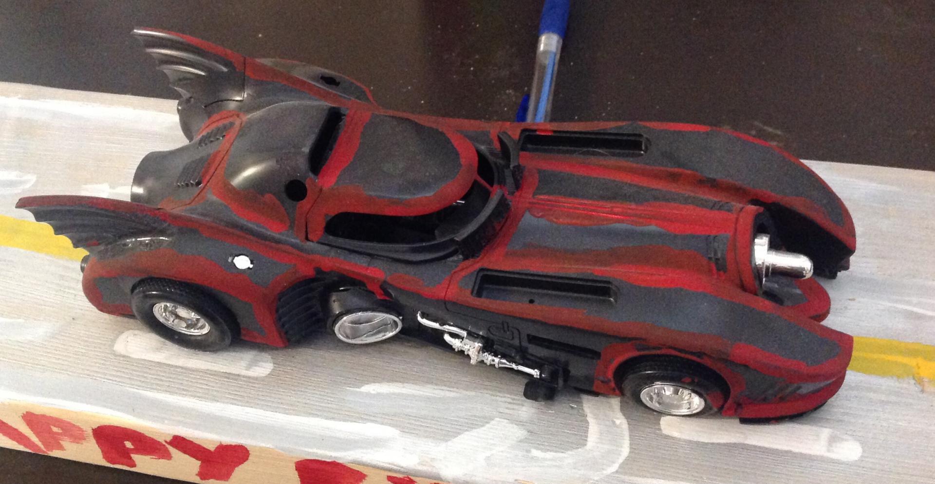

Who doesn't like this car, an iconic redo of the classic TV car. I will be doing is up with bright orange pinstripes like the TV car.  My wife's niece who I had given one of these kits to built it up in her vision which was the orange/red strips like the TV car. . She is a high functioning special needs person with a great imagination. She's 22, yet has the mental capacity and understanding of someone between the ages of 8-12 depending on the task and complexity. I won't be bothering with the interior, windows will be tinted out.

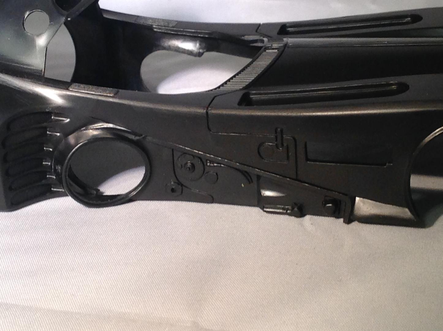

So right off the hop the side panels need to be tweaked to fit properly.

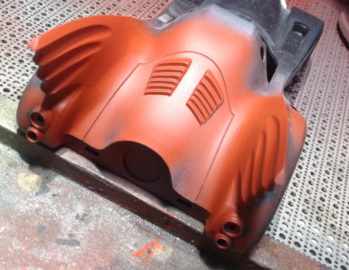

The first pic is of Sara's build, my inspiration.

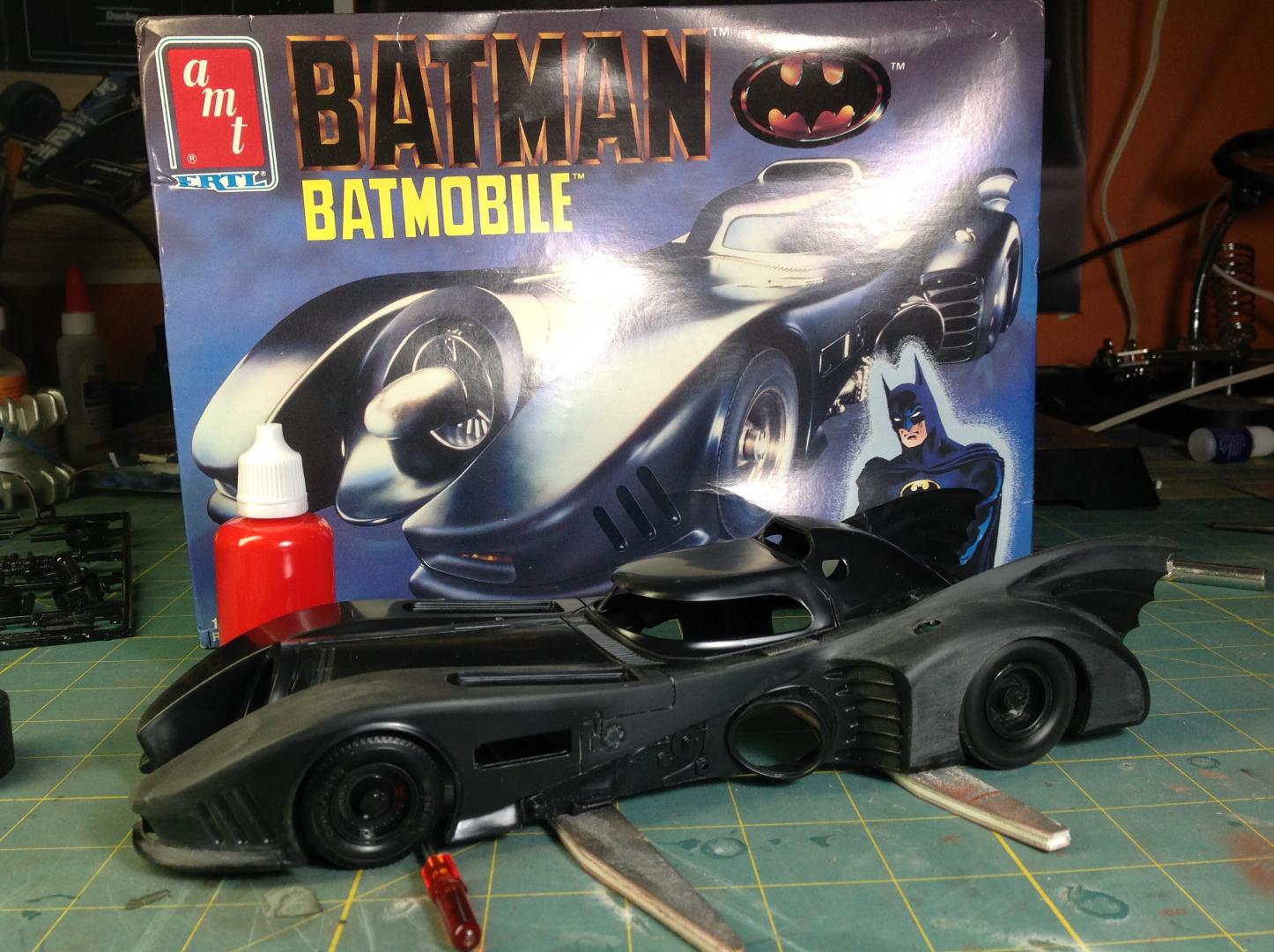

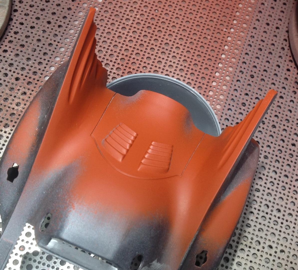

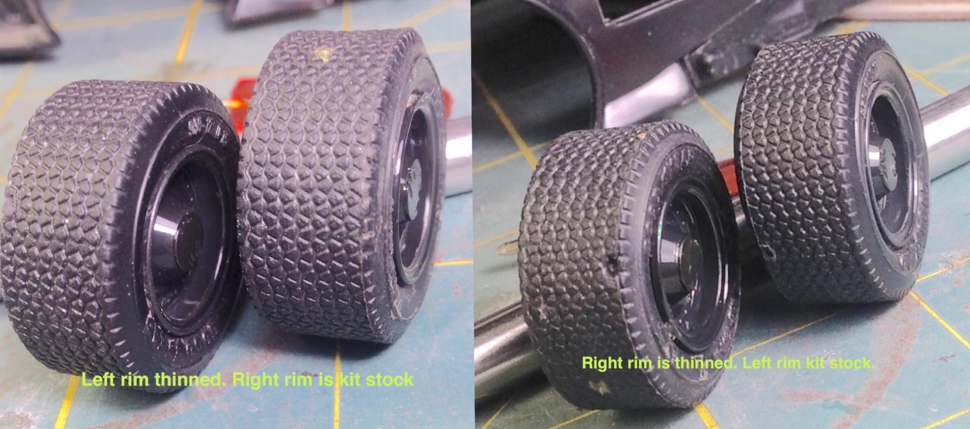

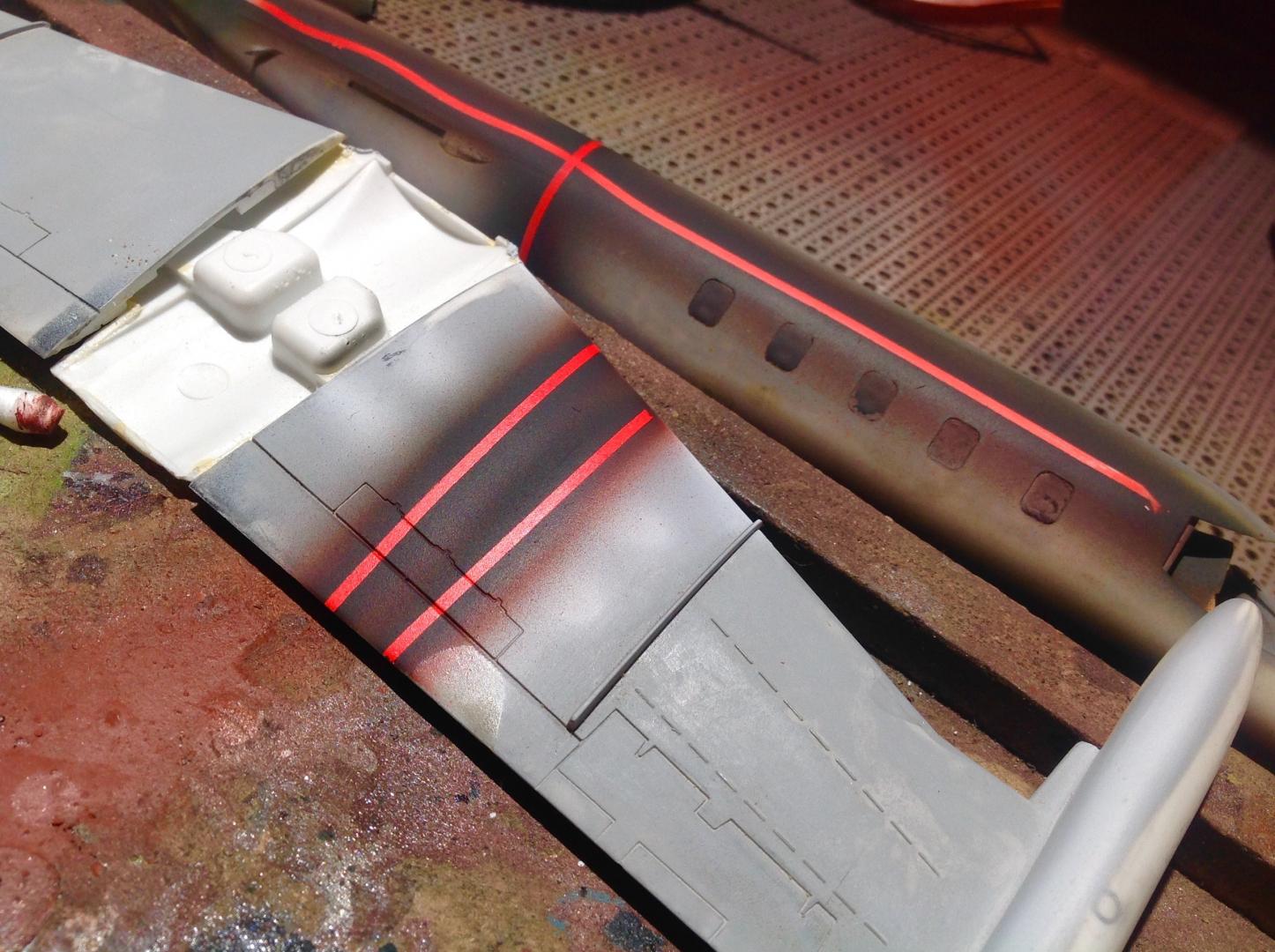

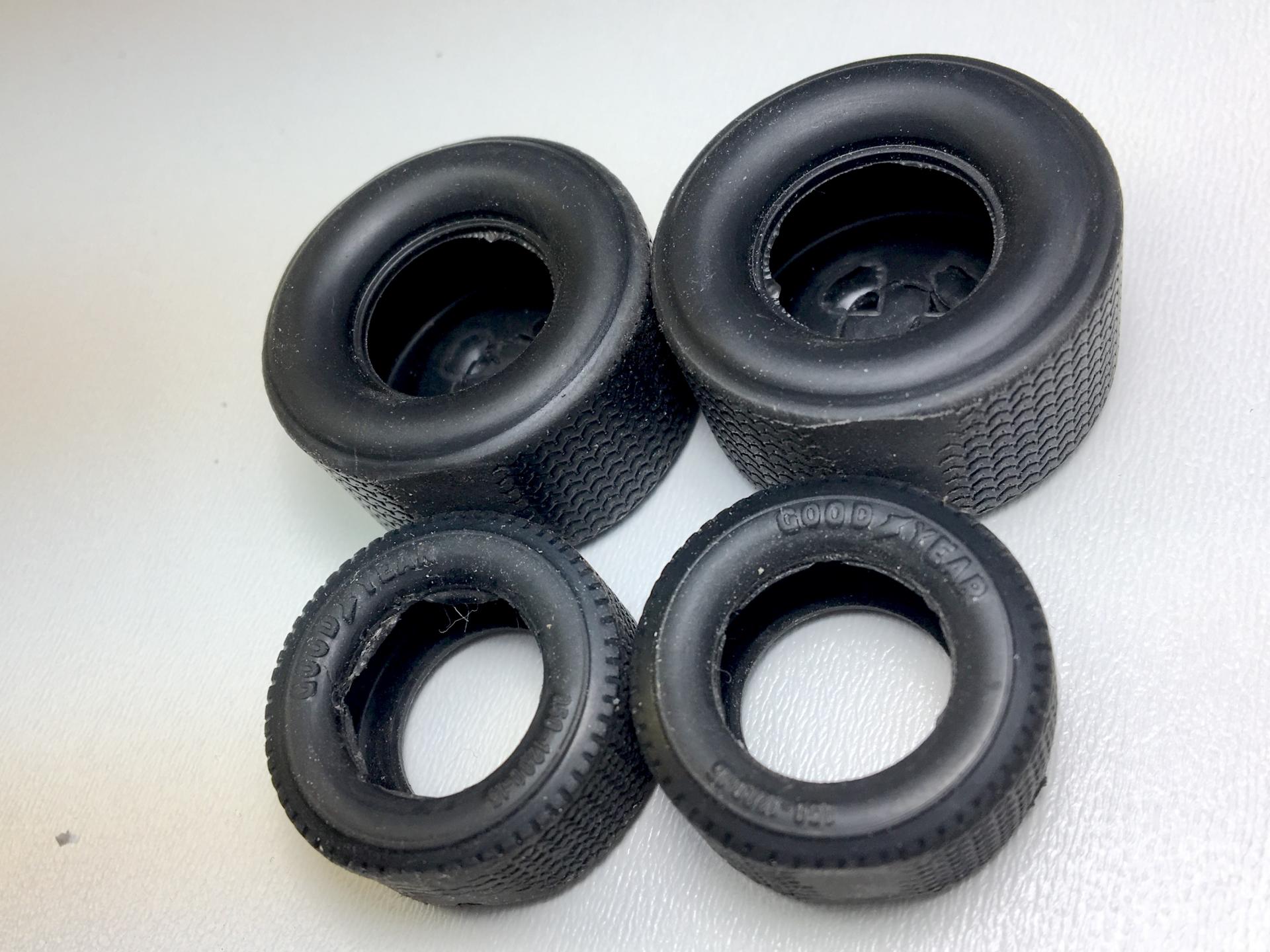

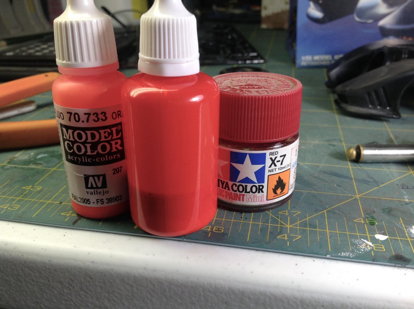

A small up date, started block sanding and removing molding lines. Stripped the chrome changed up the kit front tire's for some parts bin tire's. Also started thinning the rims outer edge. This is one aspect of scale building that really kills a great looking build for me. There are so many great looking wheels/rims included in kits that have huge outter rings. They are either too wide or too thick or both. I've posted two pics of the same wheels for comparison in the light. I will let the rest of the pics speak for themselves. I also mixed up some paint for the pin stripping. I wasn't sure if the two brands would mix without reaction, no issue. Sprayed nice on initial testing, dried flat.  The paint looks more orange in life then in the pic, should work out for a close match to the red/orange used on the original TV car.

Totally brings them into scale.

Mixing Tamiya and Vaejo?!? I had no idea that could be done.
Veru cool project!
Thanks. Me either, but it looks to be stable,.
I will have to do a full mock up test before I actually paint the shell. Not sure how this concoction will bond to the base coat of ZeroPaints white so as not to lift with the masking.

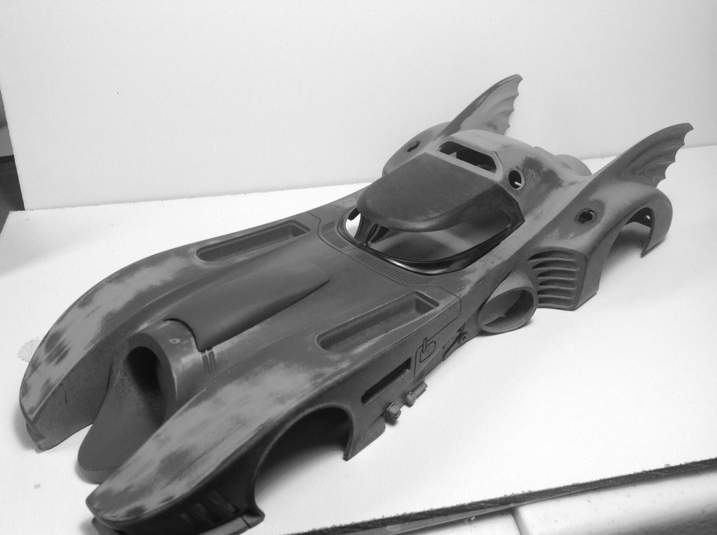

Small update.

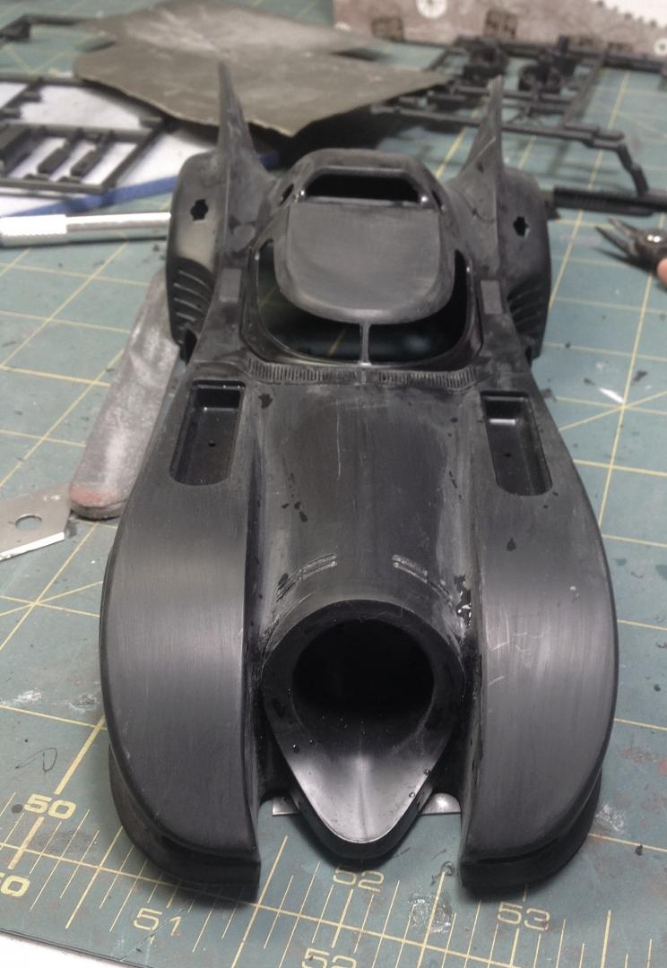

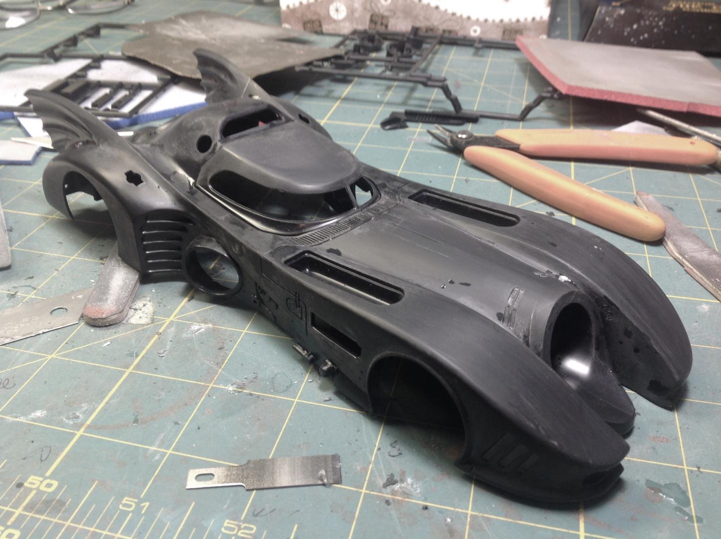

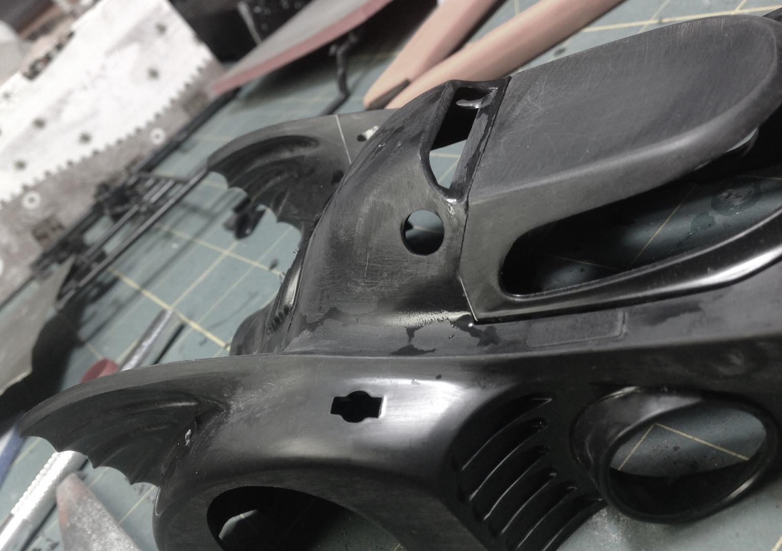

4hrs of sanding a scraping the shell. I flat scraped the top of the fenders. Also reshaped the tail fins to give them a crisper knife edge. The hood trim/roof track was removed. Thinking about an omauge to the TV car by adding a hood scoop, very tiny. Block sanded the sides of the rear fenders, block sanded the top of the roof for an hour to pancake it. Some filling will be in next.
Also flat spotted the tire's, rounded the edges and dressed down the script.
All comments welcome, thanks for looking in.
Another small update.
Two rounds of filler later and we still need more. I am hoping a final  round of filler then a shot of filler primer should bury these seems.
Thanks Dan.

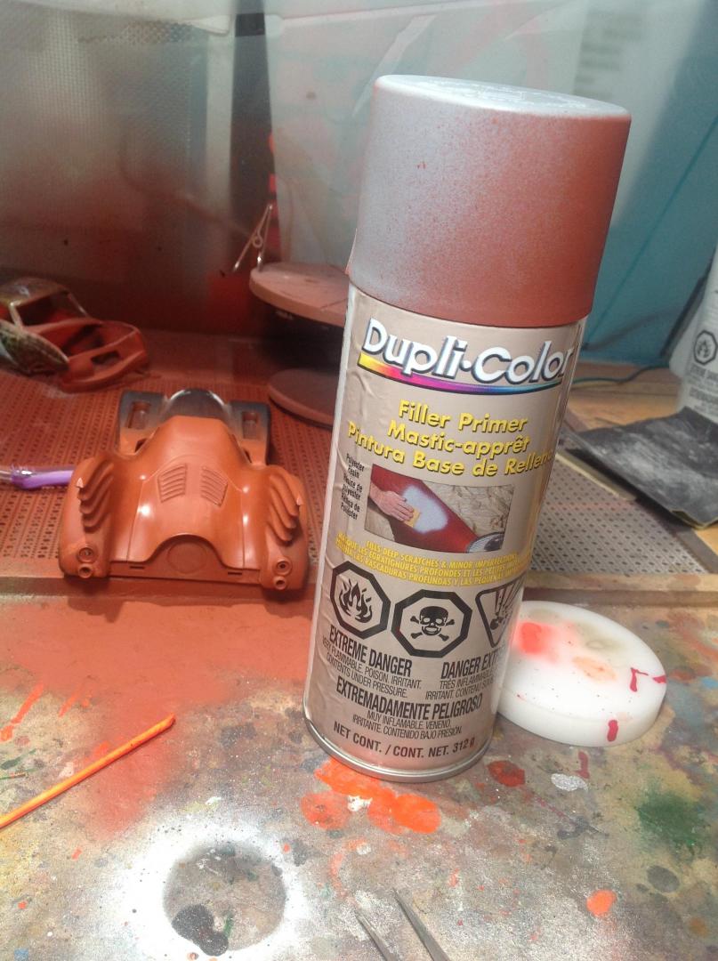

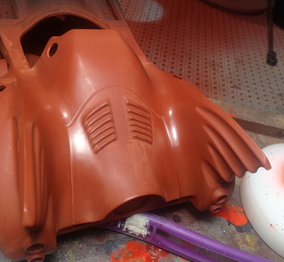

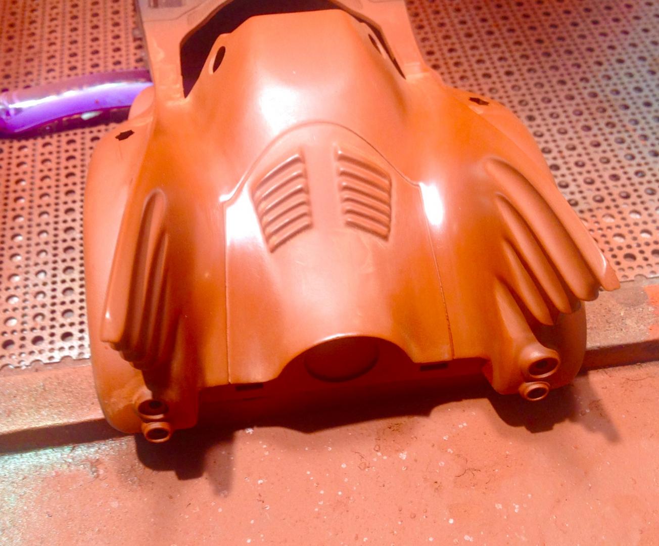

I spent about 30min wet sanding down the Duplicolor filler primer with 500-600 grit foam backed sanding pads.
Yesterday while working on the house I would drop into my studio and shoot some  primer. As per the instructions I wait at least 10-15min between coats.  All in all I think I shot about 14-16coats.
This stuff is sooo awesome, I can't recommend it enough.  It can fill imperfections up to a 1/16" deep without shrinking or cracking. So for our needs it's pretty much perfect.
I've been using it for about 8yrs with much success.
As you can seen it buffs up when wiped down with a cotton cloth. I'll have to scuff it up some before painting.
Thanks for looking in.

I've used this primer for about 25 years now too, and it IS awesome!!….cant wait to see kolor on this!!

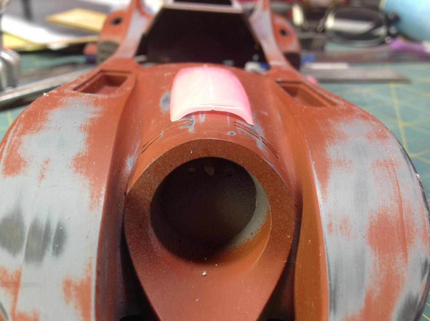

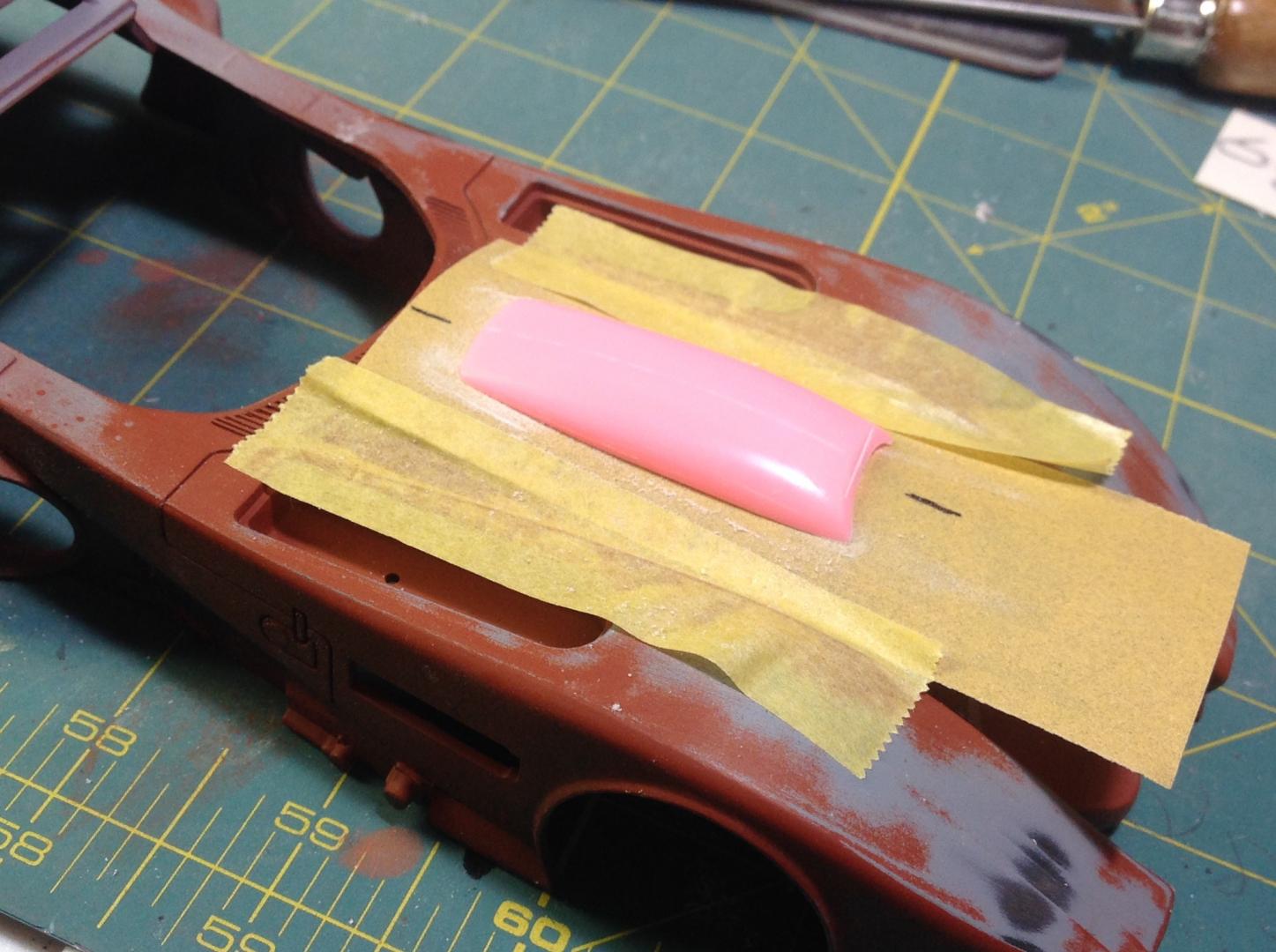

In my quest to make this a collaboration of the Barris TV car and the Burton movie car I decided it needed a hood scoop. So in search of a donor hood scoop I went on a search into the stash and found an old Pro Street kit that had already been kit bashed.
The scoop was ripped down to a 1/4 of it's height shortened with the intake being beveled, then radiused.
In order to get the scoop to the shape of the hood I tried a few large containers then it hit me, use the hood. So I taped some 320grit down and went at it. Not sure if I will add more shape to the intake to replicate the TV car or not.

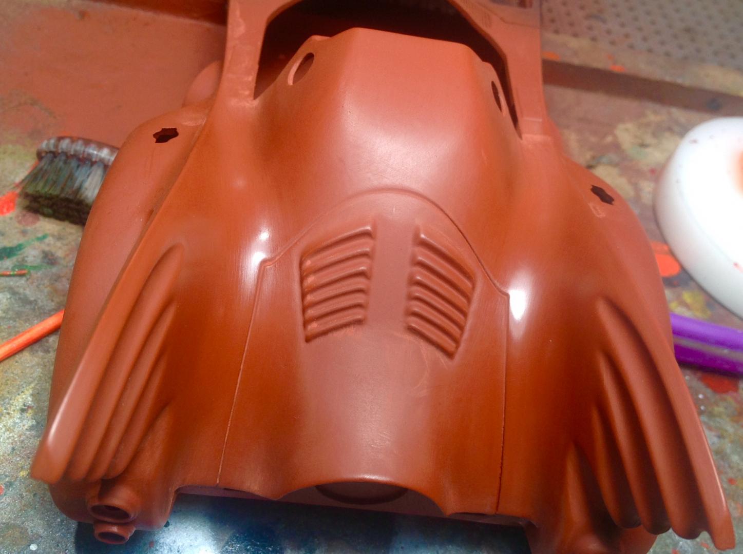

Tonight's  progress.

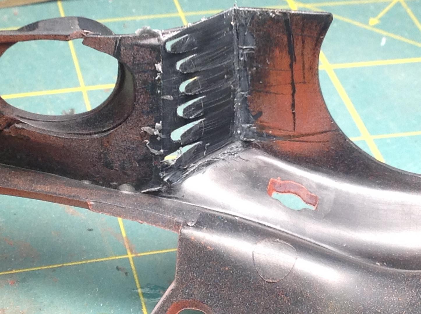

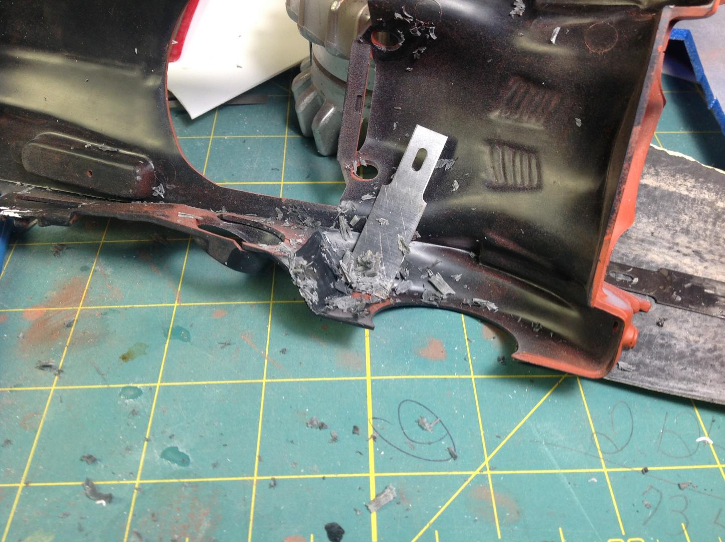

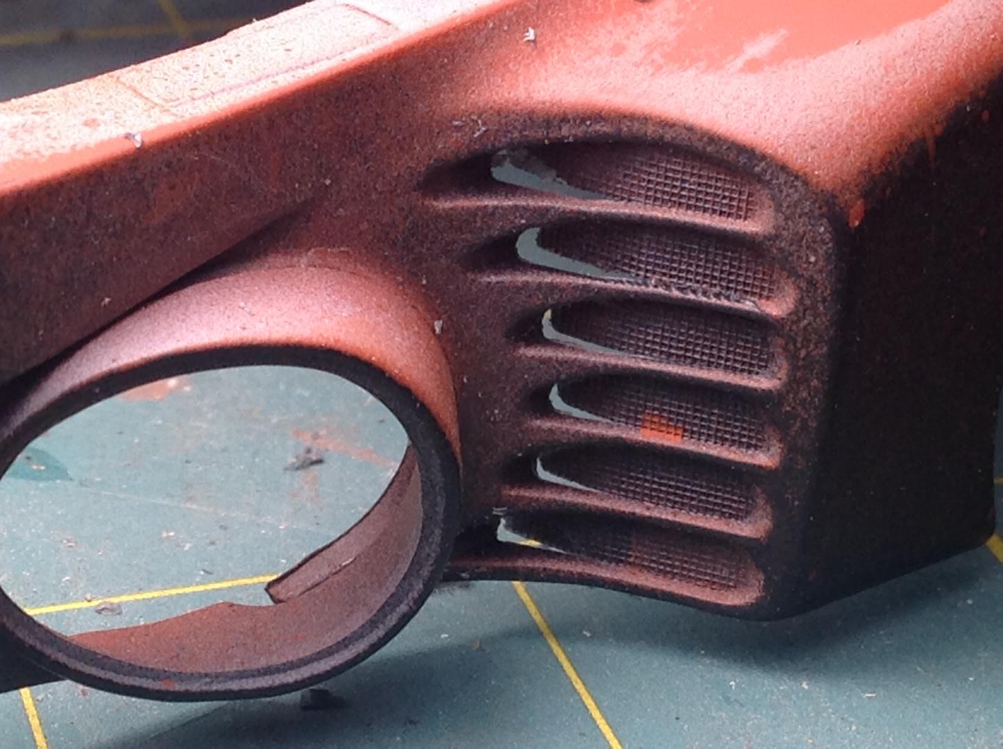

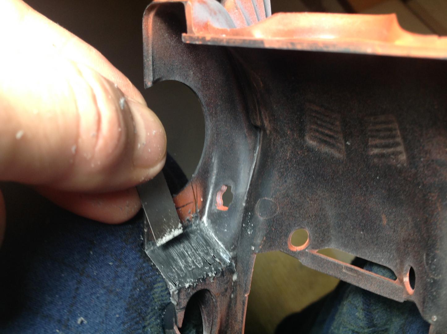

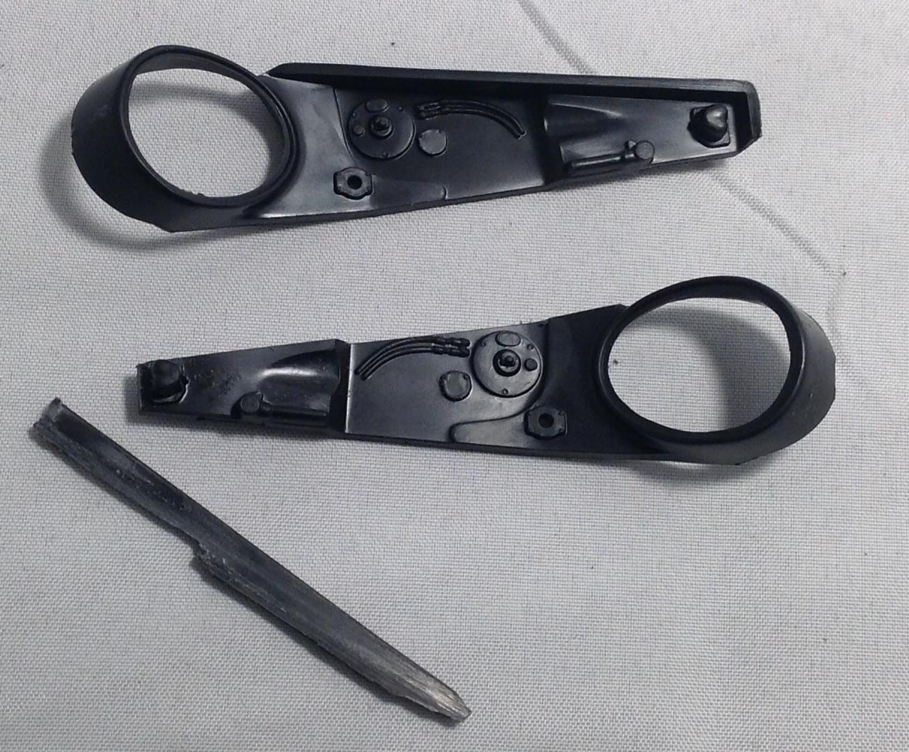

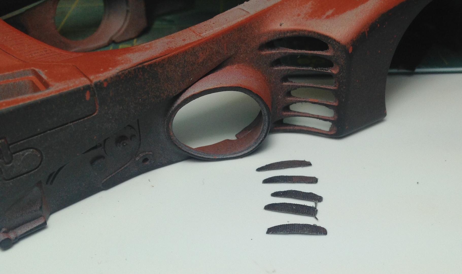

Deciding to open the grills in the side body panels was the easy part. Actually getting them out took about 2hrs so far and I only have one side done. I thought about drilling and sanding the opening. A method I have used in the past. This tends to lead to a mis-shapened opening as I seem to always be chasing the desired shape from a bit too much over sanding.
I decided to shave the back out of the panel with the plan to just 'pop out' the grill.
This turned out to be the ticked. The other side is well on it's way.
Edited by Rider
8 hours ago, Belugawrx said:
Love the chisel tip..!
takes trim down to the panel...qquick
Nice work Lloyd...
hope to run into you in London
Great tip isn't it.
Thanks Bruce, I'll cya there. Will PM ya later in the week about a meet up there.
7 hours ago, Dann Tier said:
Excellent job!!!, every situation needs its own technique, and this was the best one for this situation!
Thanks Dann. Totally, there's so many different techniques to learn and develop in the world of model building.
