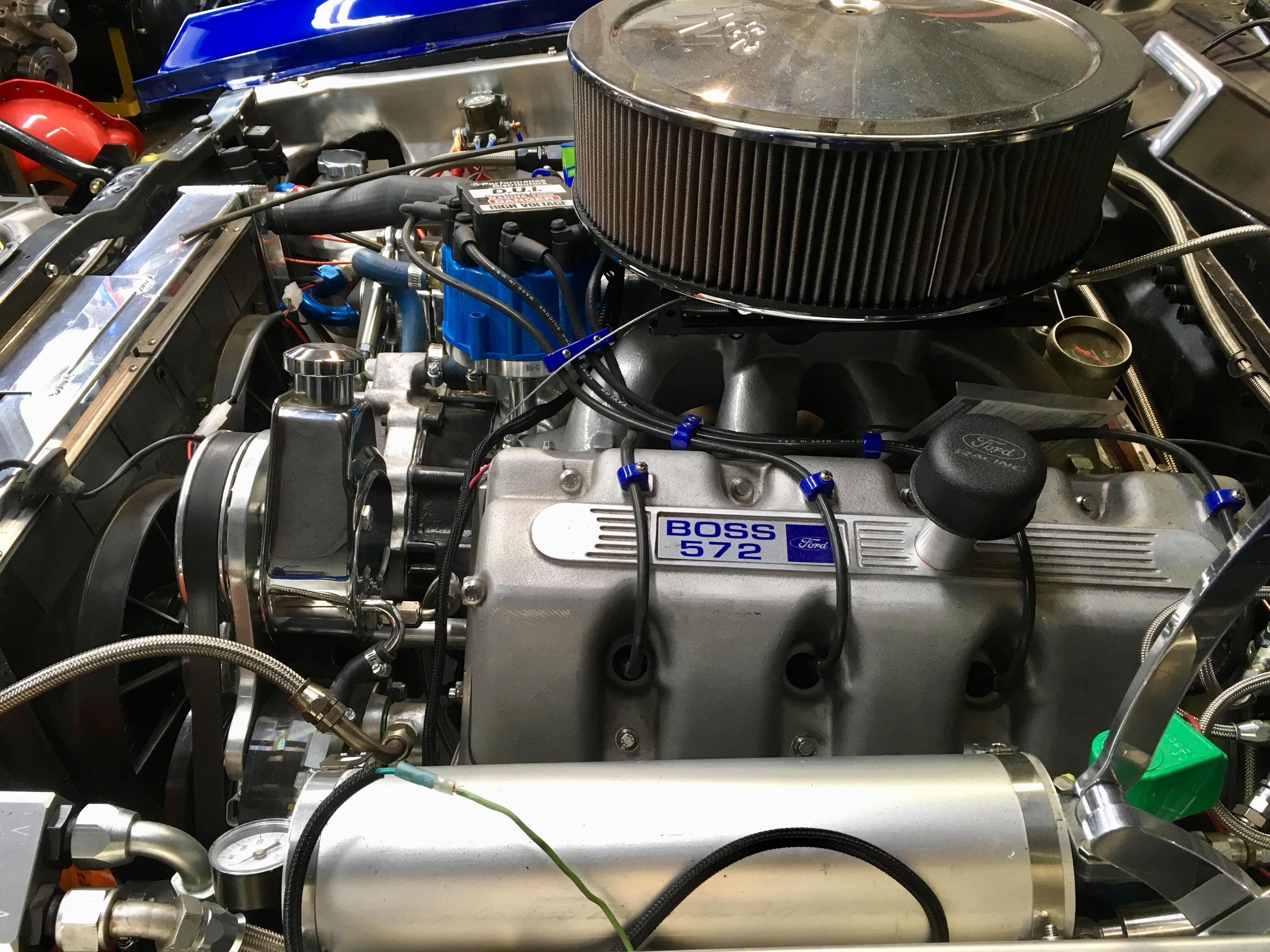

Brudda Posted January 8, 2019 Posted January 8, 2019 If you make a resin motor, I’m in. Looks great!!! Not a sohc but this is in my friends 1970 Torino. 2
