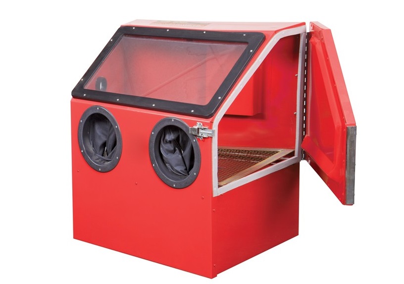

r60man Posted December 3, 2018 Posted December 3, 2018 So for years I have wanted a paint booth and I have seen various ways to make one. But I got my new Harbor Freight catalog the other day and spied this. I am thinking of mounting a sparkless fan on the left side outlet. It is made for blasting media, but I think I would work well for a nice dustfree paint environment. What do you all think? I can get everything I need for under $100, which is pretty nice.
64SS350 Posted December 3, 2018 Posted December 3, 2018 I built a paint booth like that using MDF and even purchased the gloves with retaining rings. The gloves are to stiff and bulky, I cut them back several times to make 'finger' gloves, then all the way back to the wrist. It then sucked in shreds from the glove liner and created a heavier vacuum around my arm bringing in anything on me(lint) and close to the cabinet. Make sure to groud the metal cabinet to help not generate static. Will need to add a filter bed. Keep in mind screen surface when setting painted parts as it will be an unstable surface. Hope this helps.

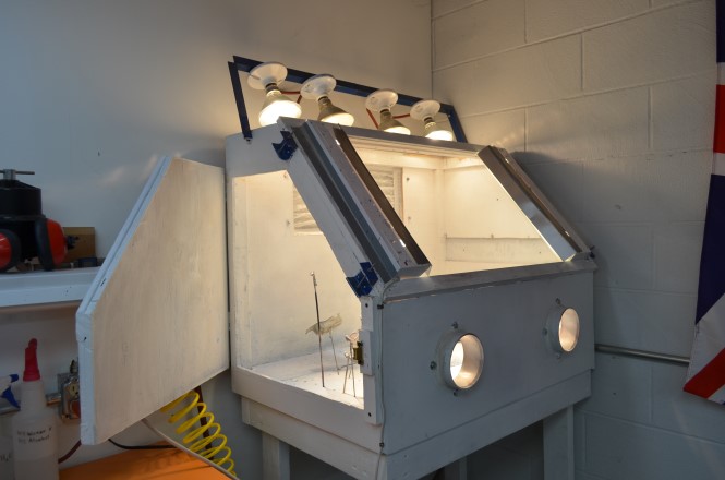

oldnslow Posted December 3, 2018 Posted December 3, 2018 John , it will do , it's just going to take a little additional work . You'll need a fan or fans of sufficient strength to evacuate the paint fumes from the booth ( probably from the bottom ) , filters mounted to allow dust free circulation ( back or top ) , a light or lights to see with ( front and top ) and figure out how you're going to keep the overspray off the inside of the glass . You my also be limiting yourself to painting one piece at a time if you don't want to open the booth until the part is dry ( and what do you do with the air brush when you're done ? ) or take a chance on overspray on the other parts in the booth ( to paint multiple parts ) and the gloves my be a problem moving your part around to be able to get full coverage with the glass being at the top , so a really secure handle would be needed . If you just want a dust free container for the parts to dry in , an old vegetable dehydrator may be a cheaper option . I built a spray booth out of a large projection tv cabinet , it's not enclosed but it works well and I probably have $40 in it .

r60man Posted December 3, 2018 Author Posted December 3, 2018 I have used open type boxes in the past, however the fans never collected all of the fumes, and my wife complained of violent headaches every time I painted a car. She can not use nail polish either. SO that was why I wanted to go fully enclosed.

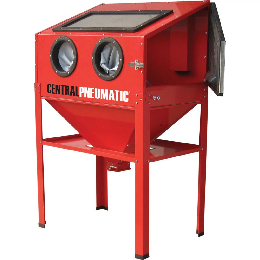

Miatatom Posted December 3, 2018 Posted December 3, 2018 I built one out of wood that's about the same design. If you go with that one, I'd suggest trying to modify it to a downdraft design. That's the preferred method. I looked at the dimensions and it's pretty small. Mine is 3' wide, 2' deep and 3' high at the back and sometimes, still not big enough. I use a 170 cfm bilge blower to evacuate the inside. It works fairly well. Personally, I'd pay an extra $60 and get the Abrasive Blast Cabinet https://www.harborfreight.com/abrasive-blast-cabinet-62144.html It's a downdraft and much more roomy. I've got well over $230 in mine. Wish I'd looked around and found the blast cabinet first.

aurfalien Posted December 3, 2018 Posted December 3, 2018 1 hour ago, Miatatom said: I built one out of wood that's about the same design. If you go with that one, I'd suggest trying to modify it to a downdraft design. That's the preferred method. I looked at the dimensions and it's pretty small. Mine is 3' wide, 2' deep and 3' high at the back and sometimes, still not big enough. I use a 170 cfm bilge blower to evacuate the inside. It works fairly well. Personally, I'd pay an extra $60 and get the Abrasive Blast Cabinet https://www.harborfreight.com/abrasive-blast-cabinet-62144.html It's a downdraft and much more roomy. I've got well over $230 in mine. Wish I'd looked around and found the blast cabinet first. Wow, its pretty substantial;
